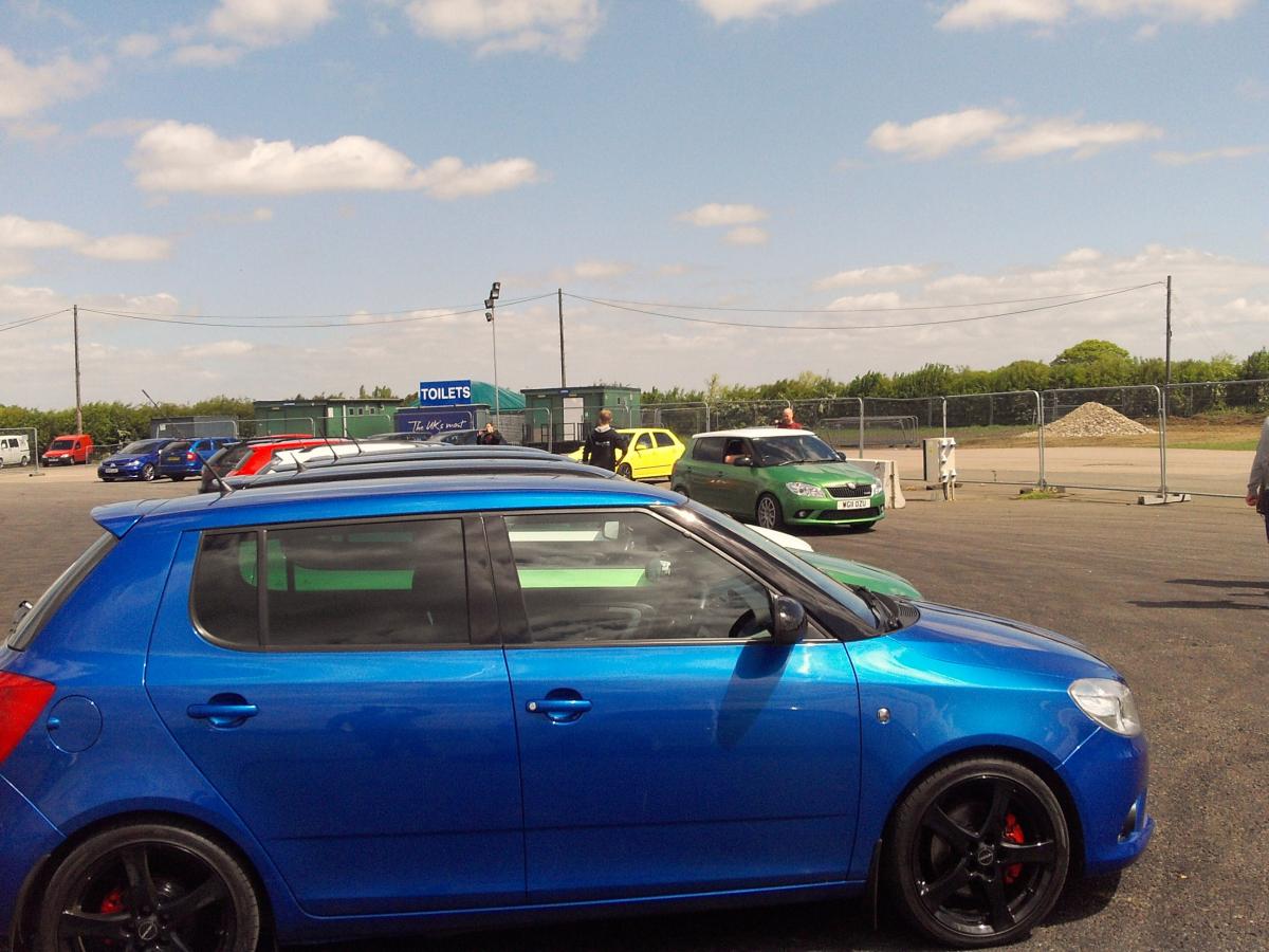

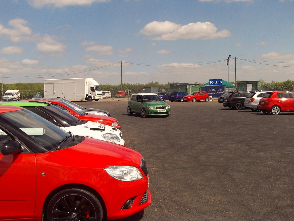

It's Andy3270's car - which has been remapped. Good history seems a great car.
Wonderful car.
Very very nippy.  If he says it is good then it will be.
Green with white roof and wheels, in middle of the picture.
