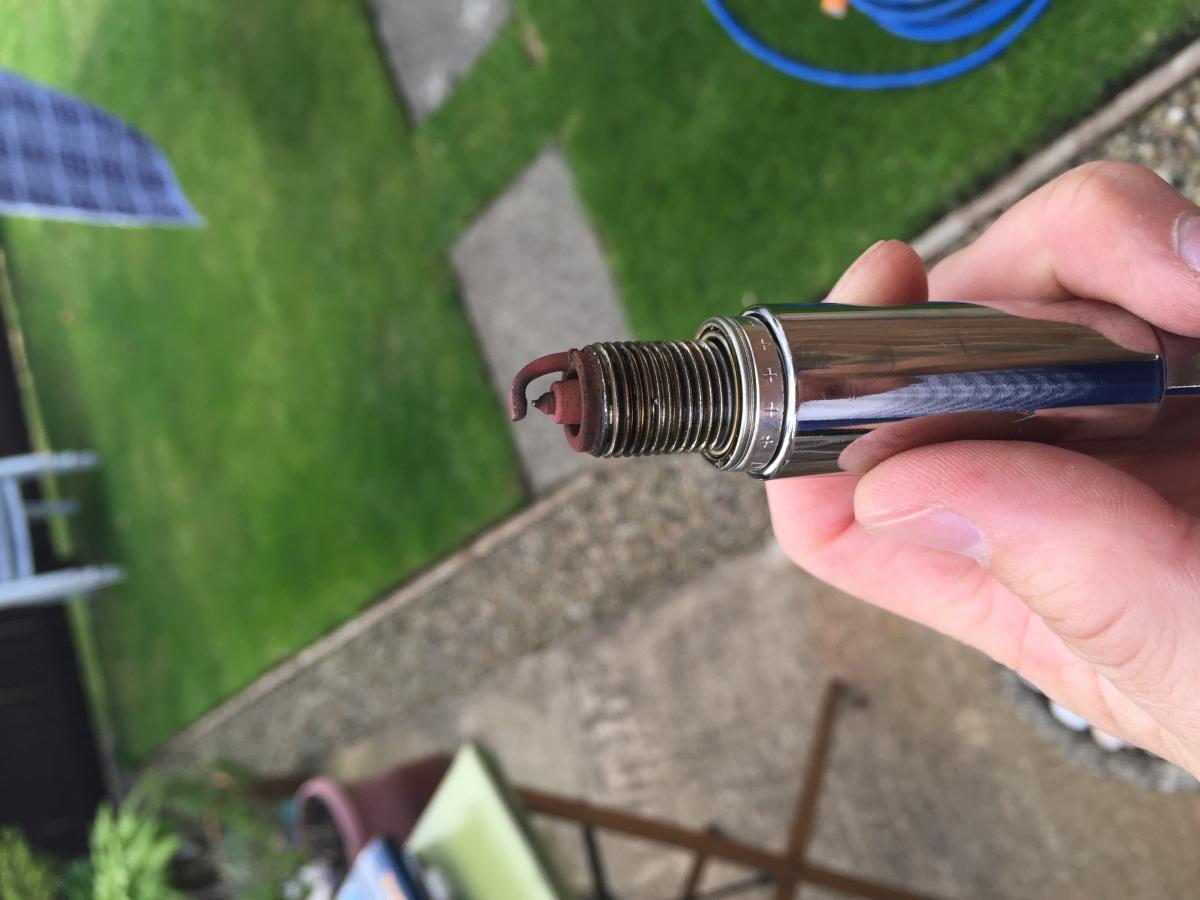

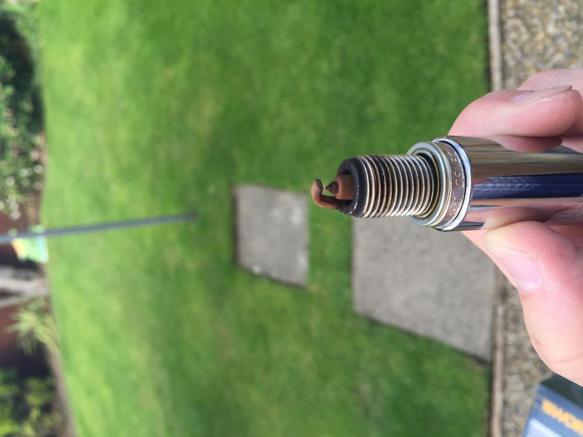

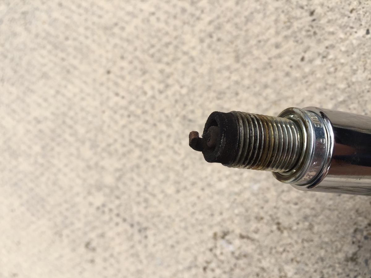

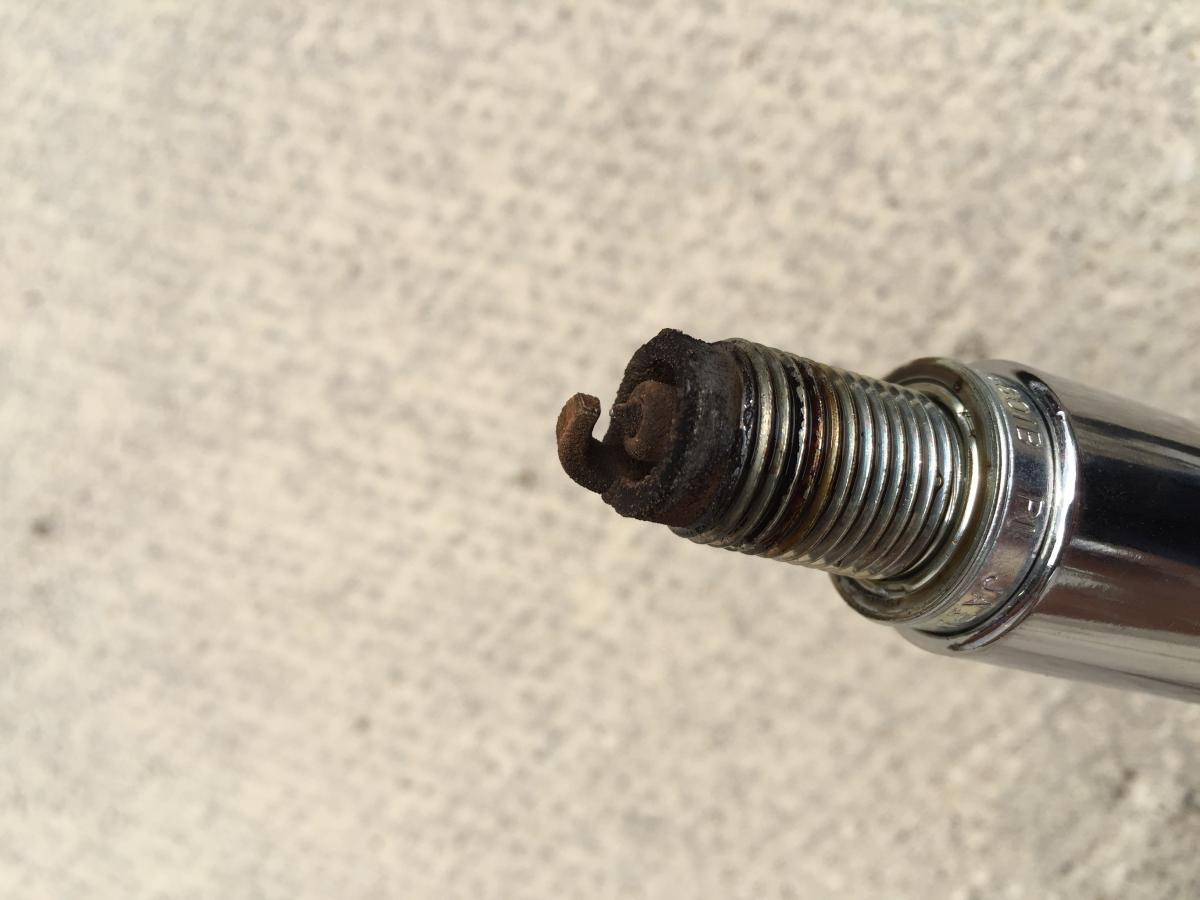

Still haven't got my oil figures from the other week infront of me, but took chance to check a couple of plugs today.
Before the breather/ spray jets they were soaked in oil and caked in carbon fouling!
I'd say these looks a lot better! Oil level hasn't budged in 700 miles too!
Edited by mac26
Same cylinders- 3&4 pre fixes!
I did replace these manky plugs for the denso's above, however they did a good few miles before the fixes were done!
