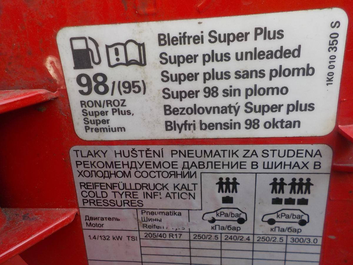

The fuel type is irrelevant to oil consumption and meant to imply it is getting what Skoda recommend. I.e 98 ron fuel.
<SNIP>
I believe that Skoda recommend fuel from 95 RON to 98 RON - 97 RON is well within that range and as you say, it is unlikely to have anything to do with oil consumption.

Skoda / VW do not recommend a fuel from 95-98 Octane.
Please link to or post some document where they do.
They recommend 98 Octane and you can run on 97 or 95 Octane because to get EU Type Approval and for EU testing they are run on 95 Octane.
As 98 Octane is not available widely or at filling stations in the UK then 99 ron minimum is a good choice for many.
In Mainland Europe those that run 100-102 ron which is widely available might like to give their experience between using that or 95 ron.
You are looking for more efficient running, and you are looking to reduce Bore Wash with an engine that is very prone to Bore Wash & wear and tear.
This is why Long Life Oil and Variable / Long Servicing / Oil & Filter changes might not be 'Simply Clever'.
http://volkswagen.co.uk/need-help/owners/Fuel
They say GTI / R,  but not if this includes the Polo GTI Twincharger 1.4 TSI 132kw, but then why not since as many find Super Unleaded of 98 or higher octane makes quite a difference, in emissions, efficient running and economy with fuel use, and the life of consumables like spark plugs.
