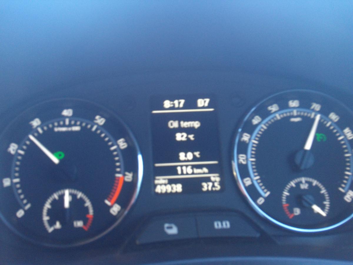

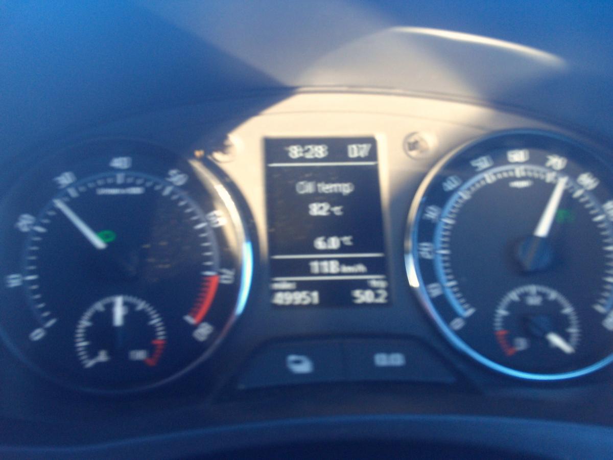

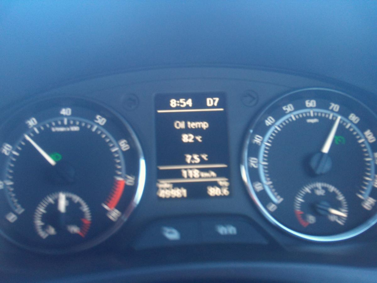

I feel that the following excellent post (by BonnevillevRS on typical Fabia vRS oil temperatures) taken from another thread justifies inclusion here. I have edited it slightly for brevity and relevance:
The minimum your oil temp will be on this engine is 90 °C as it is a coolant cooled heat exchanger, so when your coolant is 90 °C at idle your oil temp can only be as cool as 90°C if the heat exchanger is working at 100% efficiency.
<SNIP>
Oil temps lower than 110°C - 120°C on the road with good quality oil will not cause your engine to behave or wear any differently than oil temps at 90°C.....I would only start worrying if I were pulling temps towards 140°C+ on the road! Oil is a coolant as much as a lubricant and modern day oils are superb!
