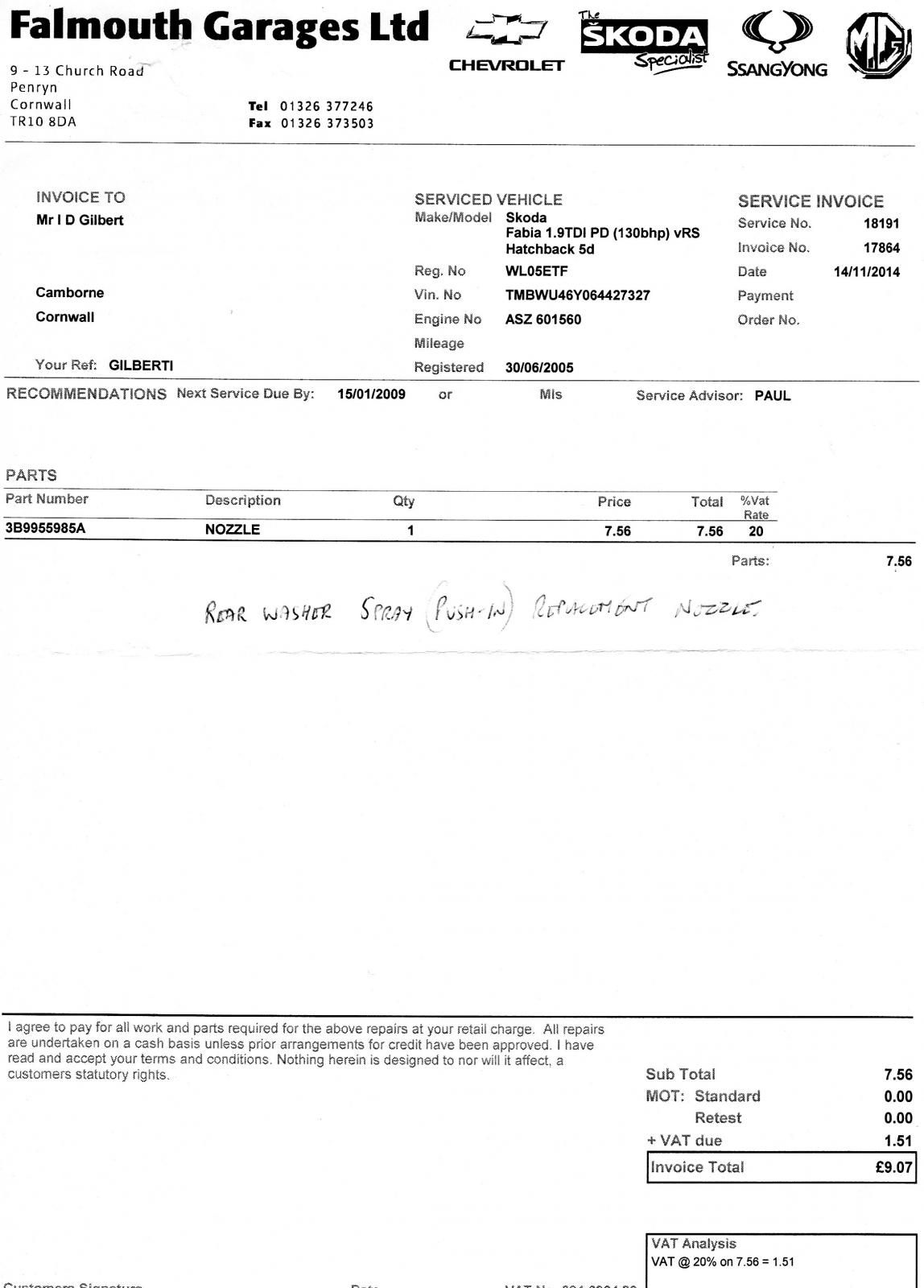

I paid £9.07 for a new rear nozzle jet for the old Fabia at the local main dealers, as I crushed the nozzle when trying to remove rear wiper blade DOH!!!
