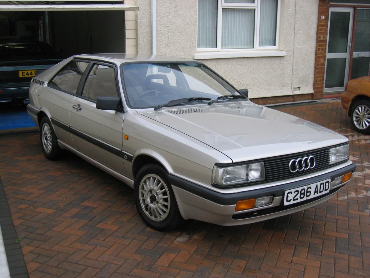

This car is just taken from Google Images,
but i did a touch up on one the same a few years back and this is the same as the Zermatt Silver i had mixed.

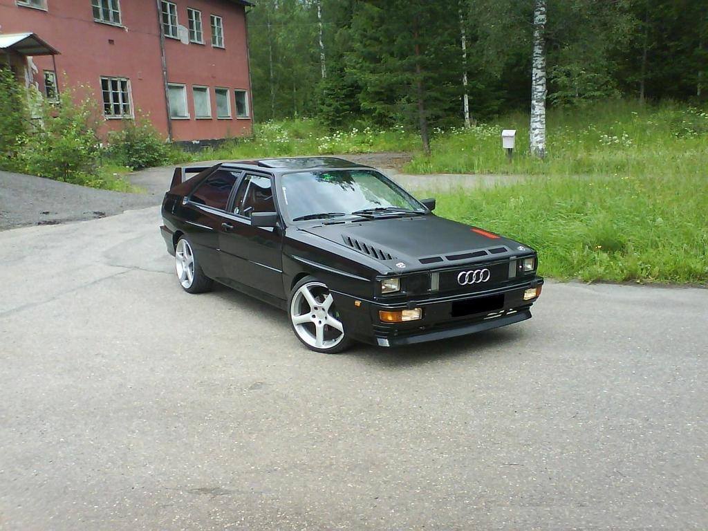

Pic of a black urq on 18s
They do look rather big.
I asked the guy for the spec of this car:
2.2l aan engine With modified 7a head, s2 uprights With kW v3 coilovers, radiator in the trunk, dry sumped, garret gtx3582r turbo, 01e gearbox currently putting in a quaife front diff in it, gearbox from an s6+ With oil cooling. Welded rear diff, urq rear axles, s2 front axles, porsche front calipers w 314mm discs front, audi a8 rear calipers With 269mm discs from 200tq avant rear. Could write alot more but thats the basics... Made 726whp on all wheels in the dyno. Plans for this season is to put the new gearbox in, bigger dry sump tank, new built engine, put in an e-brake and last year i ran a welded centerdiff, this year im going to test an oem torsen centerdiff so i can use handbrake in the togheter corners
:o
