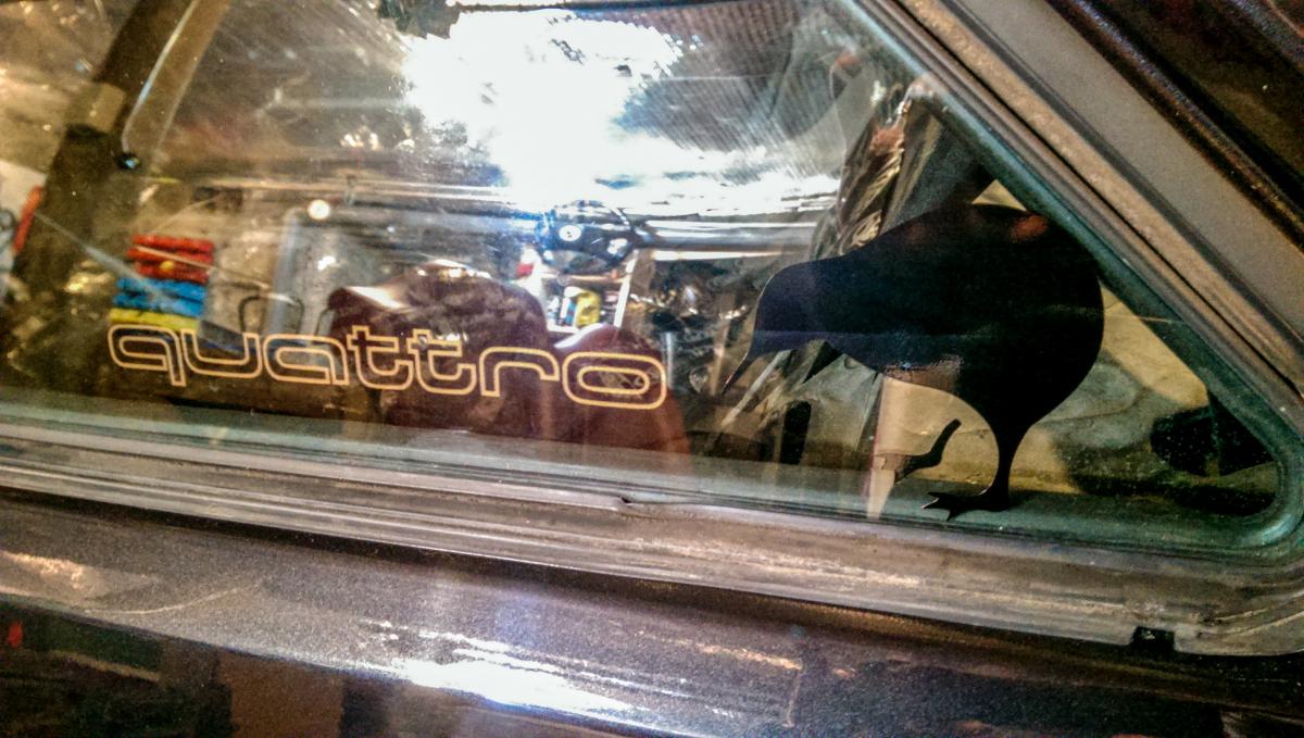

I didn't think you could improve on the original car until I saw that
Quattro +Kiwi = Yay :)
