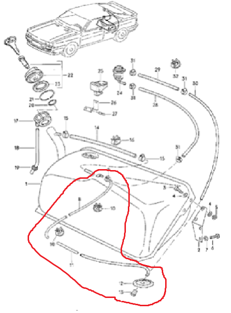

The Christchurch and Wellington crews met at Mana BP - which was a financially painful hour or so - it took me about 30 mins to get 71 litres in - I need to look at the tank vents again. I've checked everything over but either something's still blocked or kinked, or there's a design flaw here!
Maybe better to hold the trigger on about half flow? I get pressure problems if I try and run full flow.

 About 20% kinda works but it still keeps bubbling back and if I don't stop pumping for a sec it goes on the floor.

Did you trace your fuel filling issues?
I know on the TDI there was the vent pipe and a valve and whilst many people removed the valve to get more derv in, they could block up too.
I'm wondering if some old crud in the tank that's made it's way up into the vent is a problem?
As it's "only" the vent, I imagine it could be quite easily adapted to utilise one from a more modern VW group car if availability is an issue.

I haven't got to the bottom of it yet, no. There is one vent on the top of the tank which leads to a 5mm-ish plastic pipe. On later models it feeds via a gravity valve then out of a grommet in the boot floor. On mine it's just a 3m-ish long pipe with no valve - outlined in red. I pulled the whole pipe out, checked for blockages, re-routed it a bit and chopped about 75cm off the length. I can easily blow air into the pipe so it doesn't seem to be blocked. It's really odd. I have thought about the idea of making a new vent.
No. 14 on mine does not exist, and is what's needed I think.
