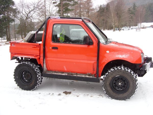

You do not have a 4x4, you have a part time AWD. (But you still want to be running the same Total Diameter front and rear.)
So if you do fit Snow Chains fit them on all 4 wheels if you are going to be driving any distance on White Hard Packed Snow or Ice even Softer deeper snow.
But seeing as you will not be driving on Black Top roads with Snow Chains on, (not only not safe but illegal in the UK,
well Police in some areas will try to say it is,
but only usually where they are stuck in unsuitable vehicles)
Maybe worth only fitting a Pair to the front drive, steer, brake wheels to get you extracted from a situation where you can not get traction, since putting them on and off is not quick or that easy at a roadside once the traffic is moving. (Maybe Snow Socks for putting on for short distances on ice would be a better option.)
so  maybe 4 chains for all tyres, on and off are not necessary unless staying on Roads that are Unploughed and closed to normal traffic and covering some distance or leaving them on for using over several days of White Top Roads.

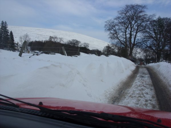

Even with Winter Tyres / Chains Fitted and a Scout with part time AWD the clearance is not great and getting through deep snow or drifts
is not going to be that much better than cars like older Ford Fiestas or Fiat Pandas on Winter tyres.
You get times where Chains are just not going to help.
& On off, On off is a PITA, where just fitting the correct tyres is so much easier for some areas of Britain.
