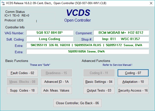

I have a 2016 MK2 Tiguan which is closely related to the VCDS coding changes listed here. I have noticed that the 09 controller required to enable rain closing has a different security code compared to what is listed here and the MK7 golf forum.
I wonder if newer Octavia and Superbs will soon see the same controller?
Anyone have any ideas what it might be? its not the 31374 one listed or highlighted in VCDS.

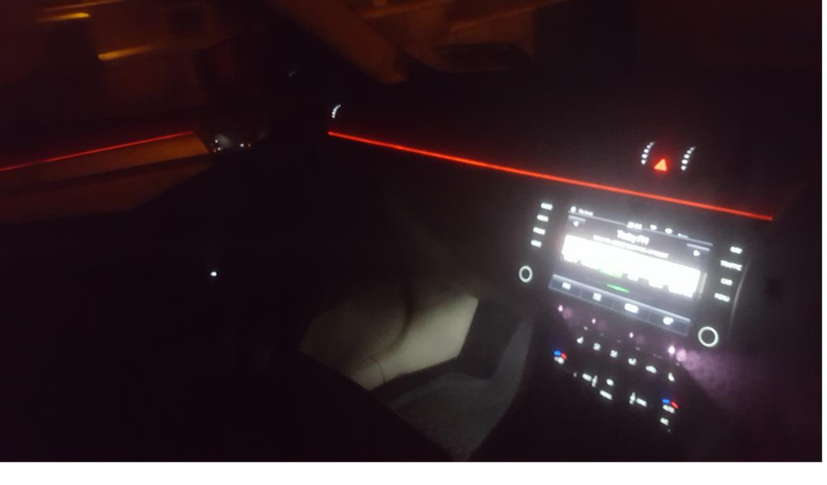

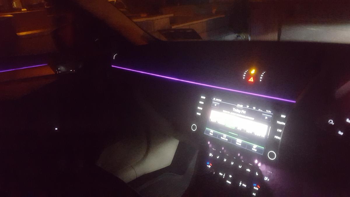

Changed the ambient colours from White & Green to Red & Purple, I kept the Blue as I like it. Did it last week but only getting around to posting now...
