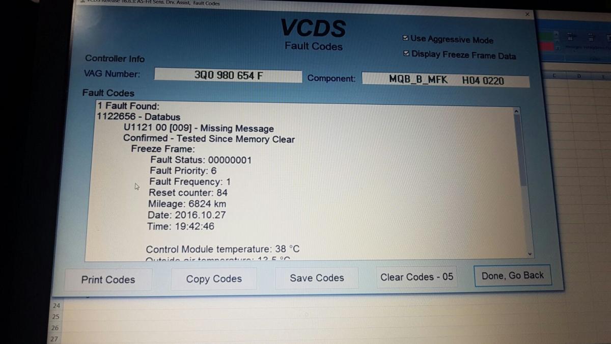

I think you don't have a 2016 model. I tryed to activate on 4 2017 models. but when cheking the option in the Columbus or gaugemenu the systeem won't want to activate (Option is at this momenterrily  not available) . I made a logfile and  find out the A5 give's a fault code: See attached file.
Resetting everything won't work. waiting for a day wont work. Made a lot of scans and logfiles but can't find the solution.
I have done this on three MY2017. If you have done all steps, you have to delete the fault codes, then turn off ignition. Wait 5 seconds and then you can turn on ignition. This is my way to activate Lane assist an always succesful
