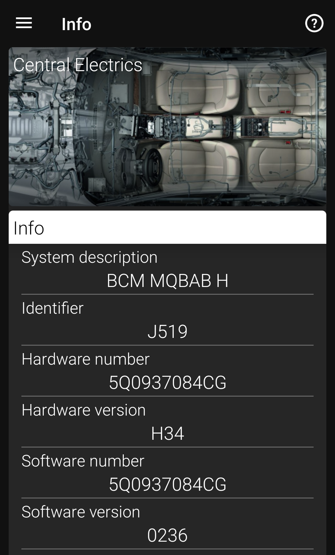

It's in the Info section in OBDeleven for the Module 09.
U can c mine below.
I too have only done the front wiper tear drop as mine didn't come with rear wipers.
Sorry for the delay. This is mine:
https://www.kepfeltoltes.eu/images/2024/01/09/188Screenshot_20240109_01.jpg
