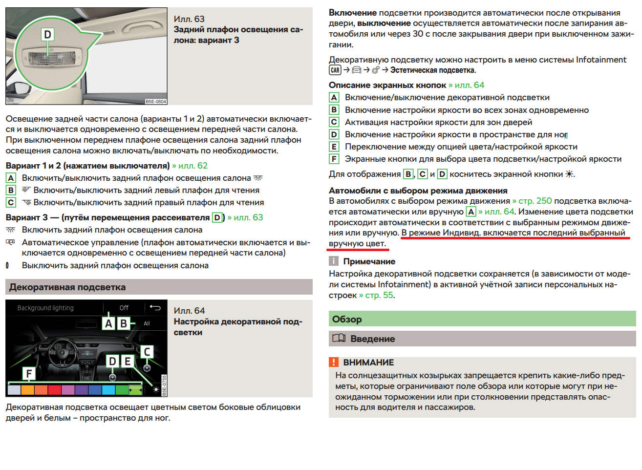

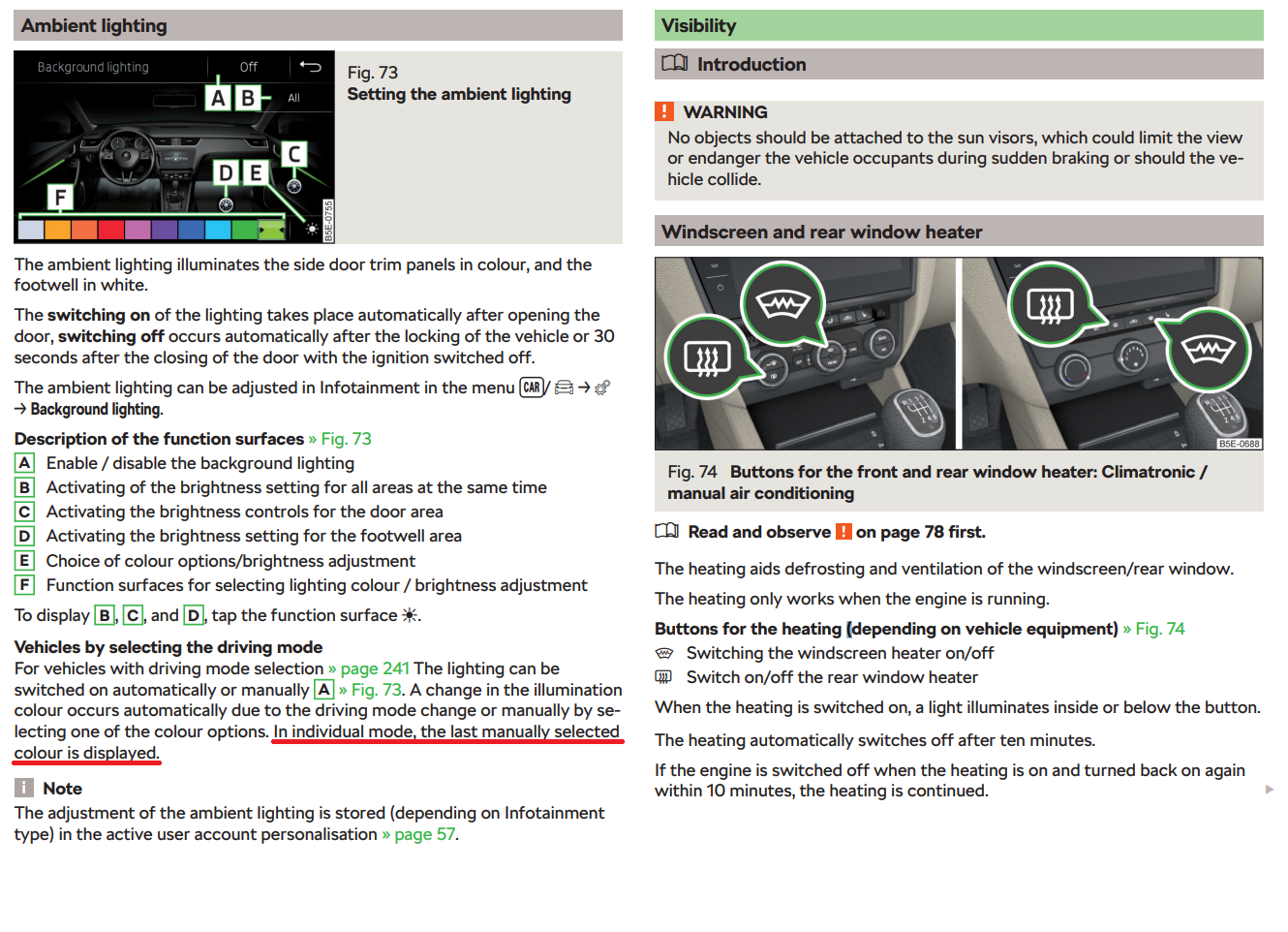

I've added extracts from both a Russian and English MY19 Octavia manual:

It seems I overlooked a tiny detail about IDE09731-ENG154511-Int. light: 2nd generation-Ambiente_Fahrprofil_Individual. My guess if I set this to a profile which I don't have - 4 for example - this disco mode should be gone. I'll try this tonight.
From the manual page shared by @igrozan I thought the color of the individual profile in automatic mode can be set using the manual mode's color.
But the hardcoded colors are fine by me, this is not a deal breaker.

Setting the IDE09731-ENG154511-Int. light: 2nd generation-Ambiente_Fahrprofil_Individual to 4 did solve my problem, the comfort mode ambient ligth works now.

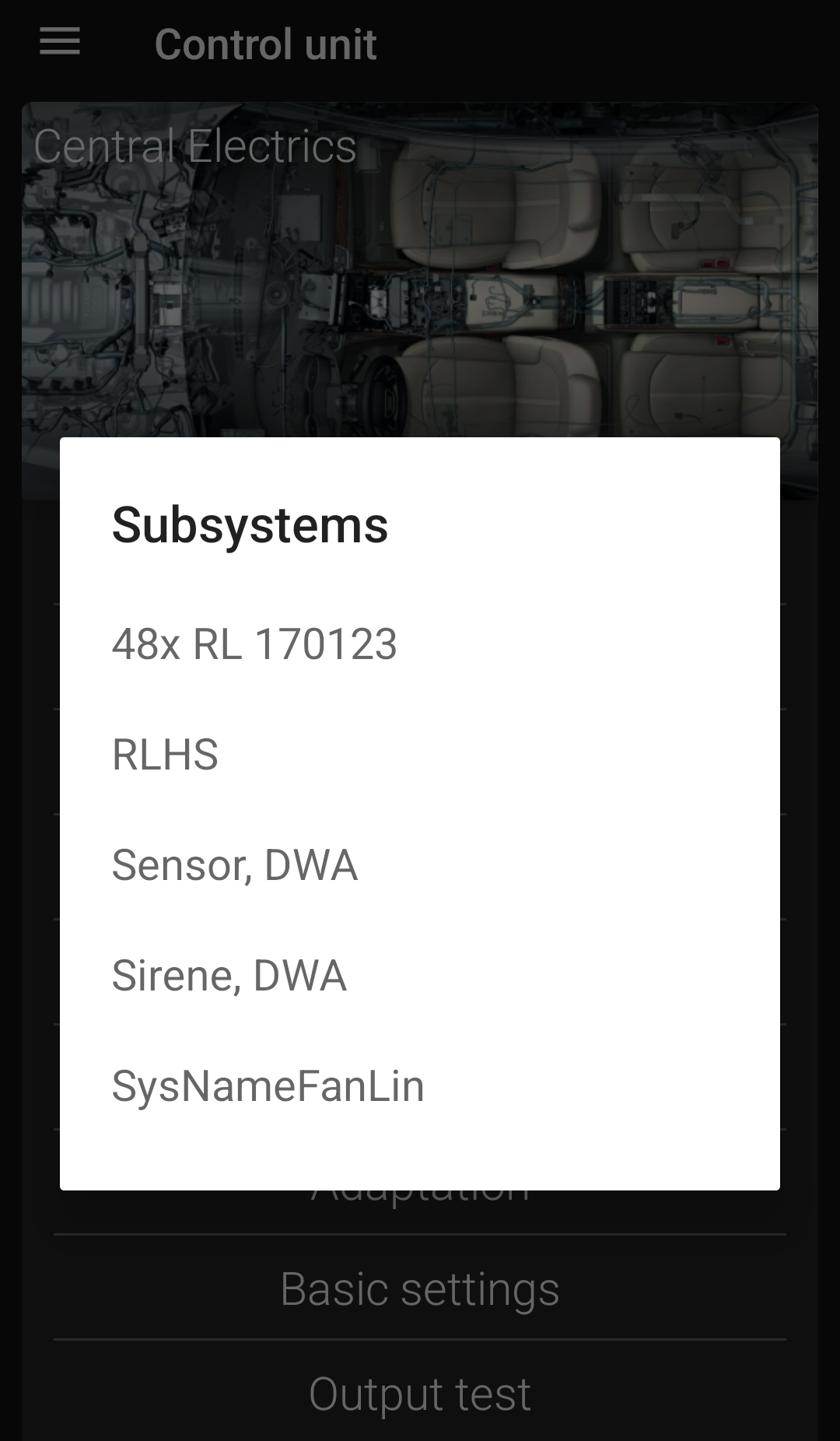

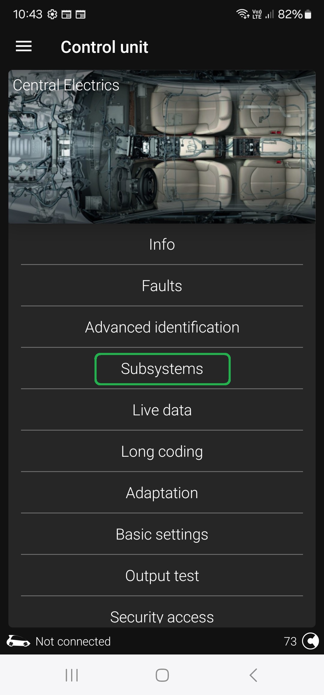

11 hours ago, enisz said:
but I couldn't find the bytes to update in long coding using OBD11
not directly `09 Central Electrics` -> `Long coding`,
but 09 . . . -> `Subsystems` -> `48x LL 221122`  -> `Long coding`
Thank you! I tried googling it but couldn't find it.

2 hours ago, enisz said:
Where can I find this BCM version number?
It's in the Info section in OBDeleven for the Module 09.
U can c mine below.
I too have only done the front wiper tear drop as mine didn't come with rear wipers.
