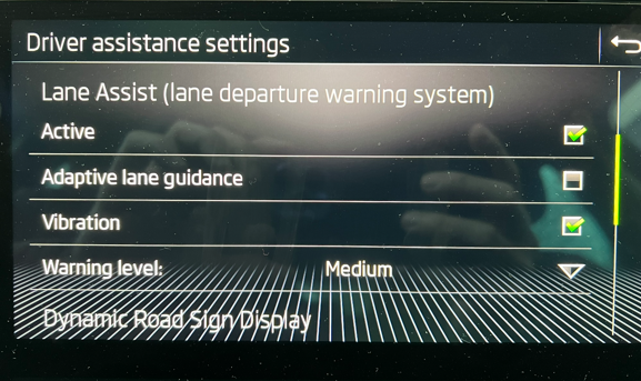

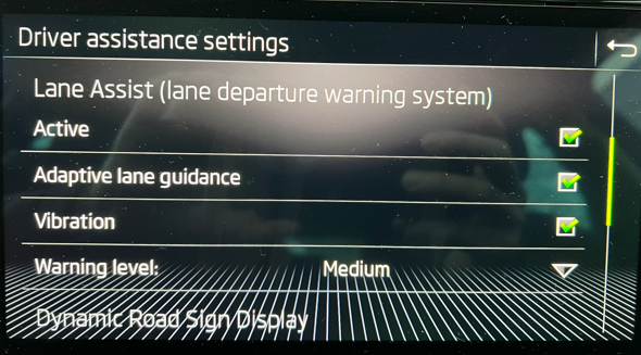

@Bap33 No worries. I will try to explain more precisely. There are different kind of Lane Assist beginning on most basic one which just warns driver about getting edge of lane with acoustic/visual sign. Another is one which warns but also can intervene once get edge (car just bounces from edge to edge) and then the one more advance which is called Adaptive it warns/intervenes but has also ability to keep car in the middle of lane what is called Adaptive lane guidance (if active, one can feels constantly small movements of steering wheel). BTW you was right in other thread this is not autonomous system and driver should always keep hand on steering wheel.
To last I refer to. There is option in driver assistance settings menu to switch on/off Adaptive lane guidance. There are situation I don't like it and I found above mentioned coding to get 'fast' access to disable/enable option. However it's not clear to me what should I expect after coding and I would like to be sure before make any changes. Hope this make case clear.
image.png.47caff0ab56c5ed7a1706b551451726f.png image.png.67f505060191f03c613eaef6b77a1c65.png

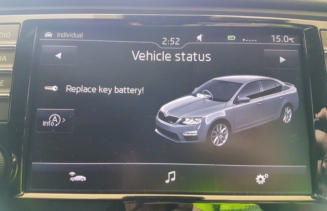

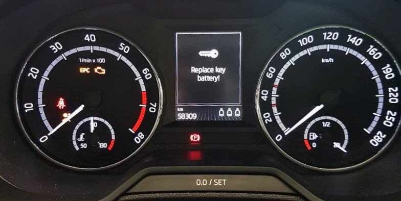

Turns out the car knows when the key fob battery is low, so why is the owner not informed via the infotainment in the Vehicle Status screen, along with other warning/errors?
Or do some model years actually show it?
The mk3 Octavia displays a low key battery warning message.
20200923_145129.jpg.c8a0420275e0cbf34a3c782572c68bcf2.jpg.4fe212d7fdd719ae1fb4163cc645beac.jpg
20200923_145215.jpg.80e164325cc942d752b026c27c85223b2.thumb.jpg.d478b7bddbcd3191babf9195658bc0c9.jpg
Is there a way to enable it to show on the Superb?

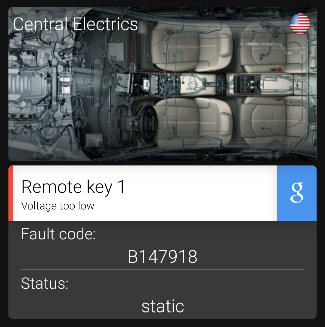

Below is wat shows up when a scan is done.

According to my info, you will get the warning when it will be needed. I get the nagging even two, three months before the battery really dies.
I had a similar message on my MY17 Mk3.
My 2021 Superb IV warned me when the key battery was low, I replaced both batteries with Panasonic batteries.
@mtl , @Bap33 - I've never seen that message in the 7 yrs I've owned the car.
Mine is MY17, with KESSY.
I know my battery is low when it doesn't lock/unlock when it should, or open/close boot when it should.
So far I've replaced my key battery 3 times, maybe 4....
The scan clearly indicates that it "knows" the battery is low, yet there is no visible user notification.
Strange.
Edited by JR RS
I get that message on my Octavia MY2015 with Kessy.
