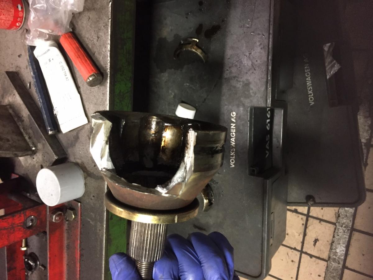

The culprit that ended the day.. CV cage broken in several places and in many pieces.

Was it a cheap aftermarket or anything?
I had similar happen on an after market one from Euro car parts that's all.
Might have to suck it up and go genuine mate, I bet there £100+
I've had the same with euro car parts cv joints
Just destroyed a eurocarparts cv on mine in 7 months (11k miles), had a friend change it at VW and he ended up cutting it off. Went for a new genuine one, they're £165 ish.
Well that confirms what I thought at least. Four of us killed Euro driveshaft components :D
Wasn't from ECP but another aftermarket one.
There was plenty of grease still in there so shouldnt have caused an issue. Looks to me like its failed as it couldnt handle the track, maybe look at a genuine one.
Have a look at J&R drive shafts. They're pretty decent and have a 2 year warranty
