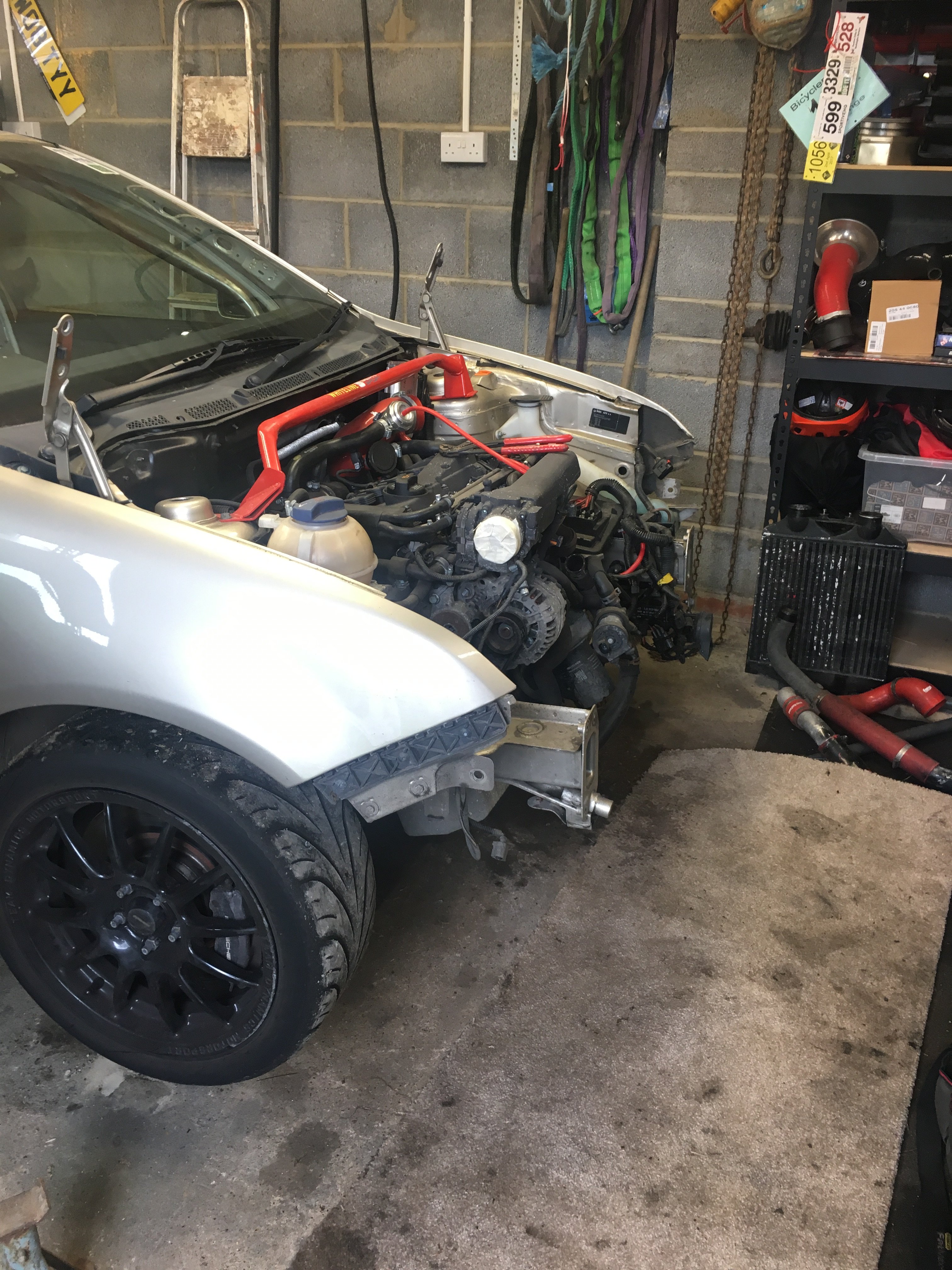

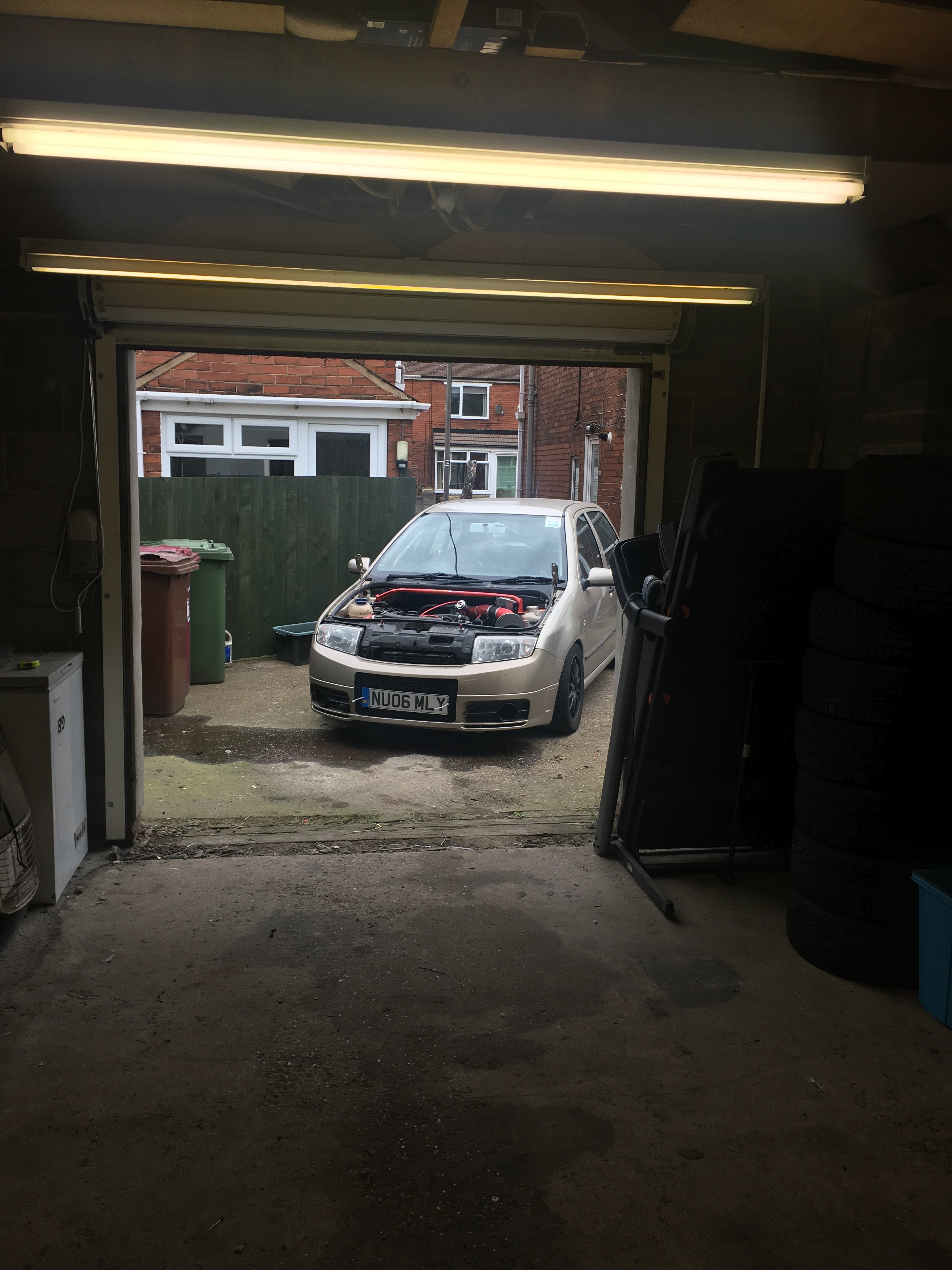

  • Fitted driveshafts and all bolted up. Wheels on and lowered to the floor. All intercooler pipework installed, just front bumper to chop up to fit.   Started it and it runs!!! WHOOOOOOO

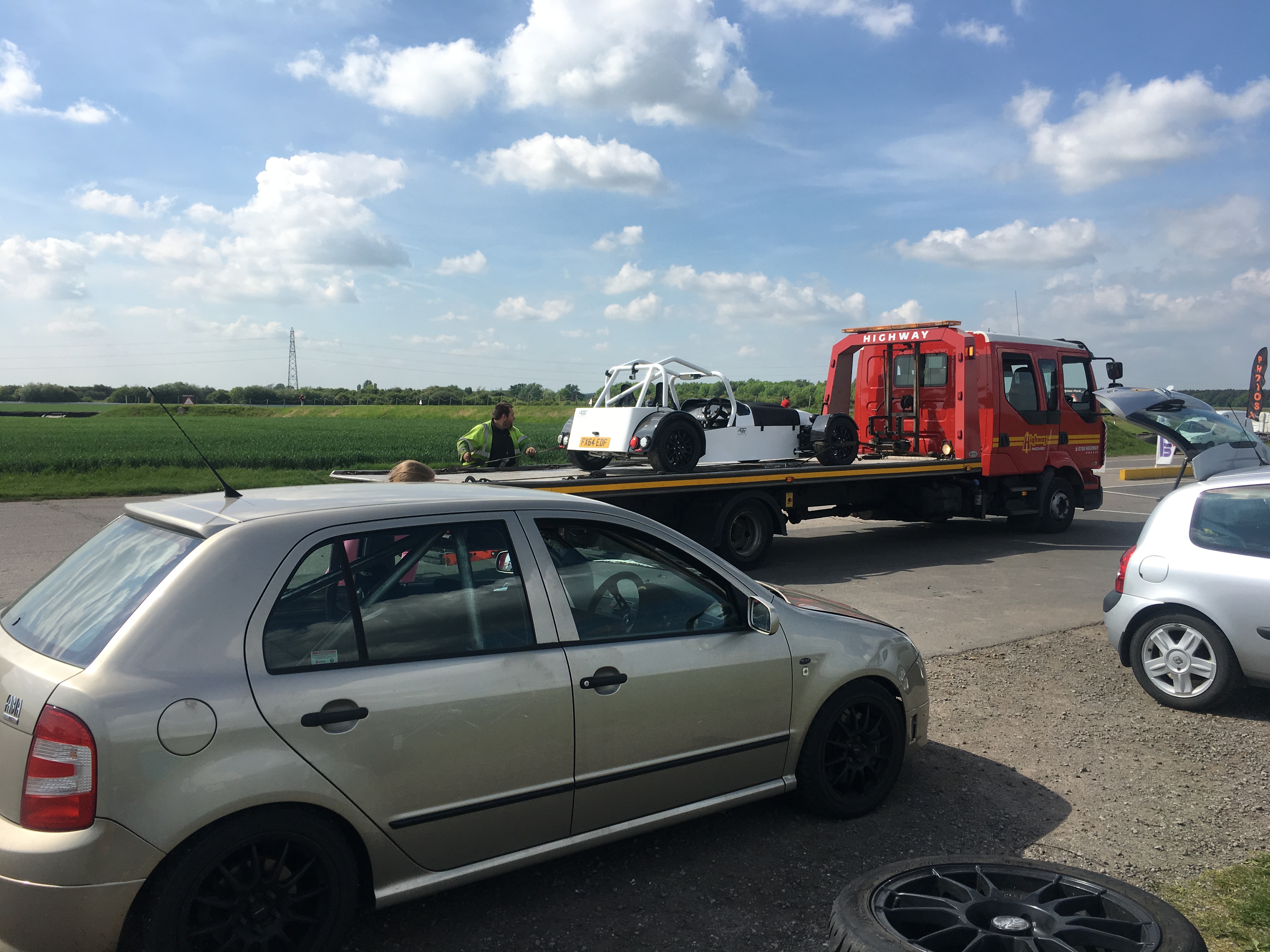

Another trackday done at Blyton Park. 107 laps on a boiling day and no issues. My mate managed to smash his gearbox on his MK Indy R.

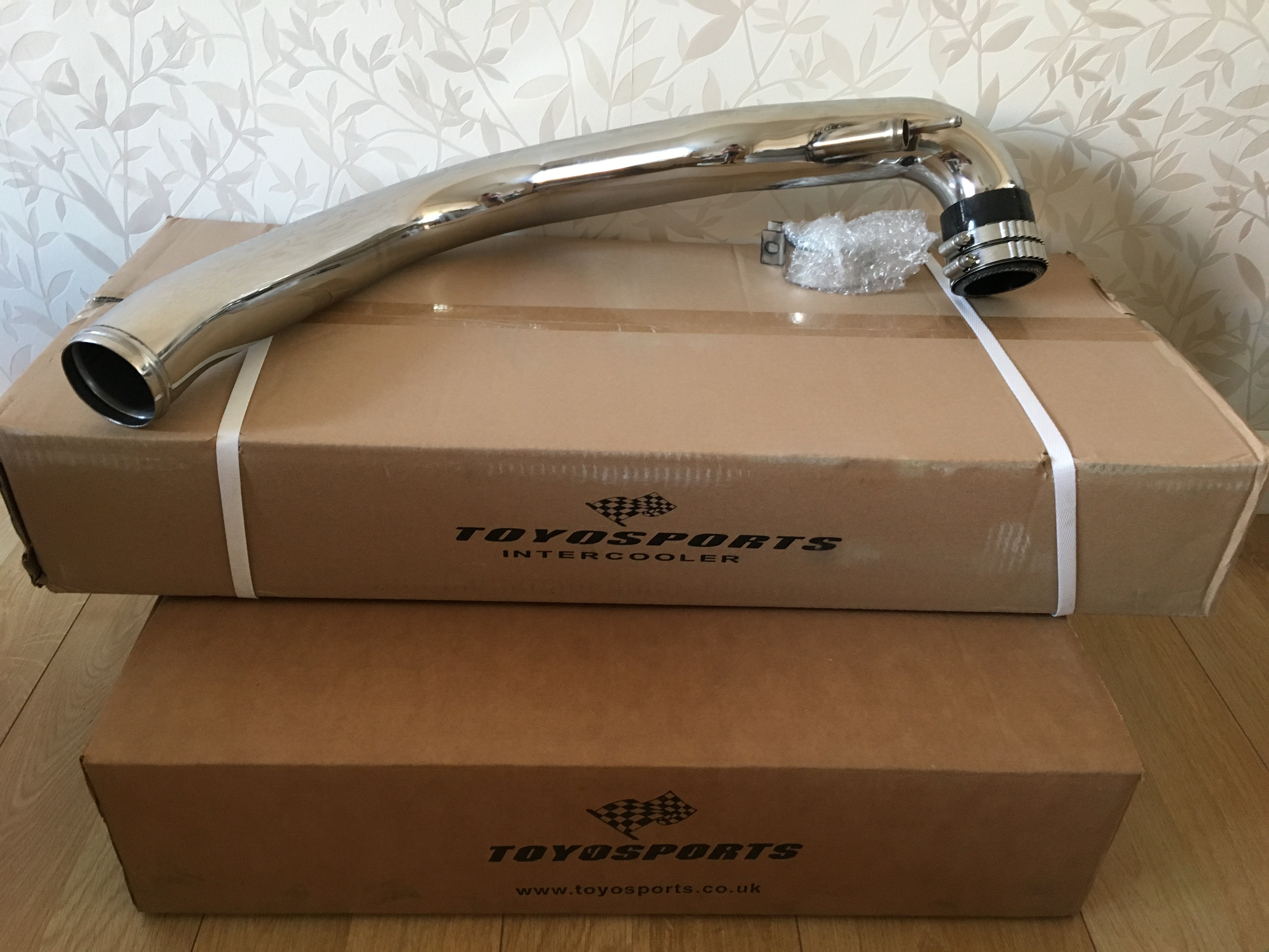

Its growing, just need to decide on a FMIC size and order that too.

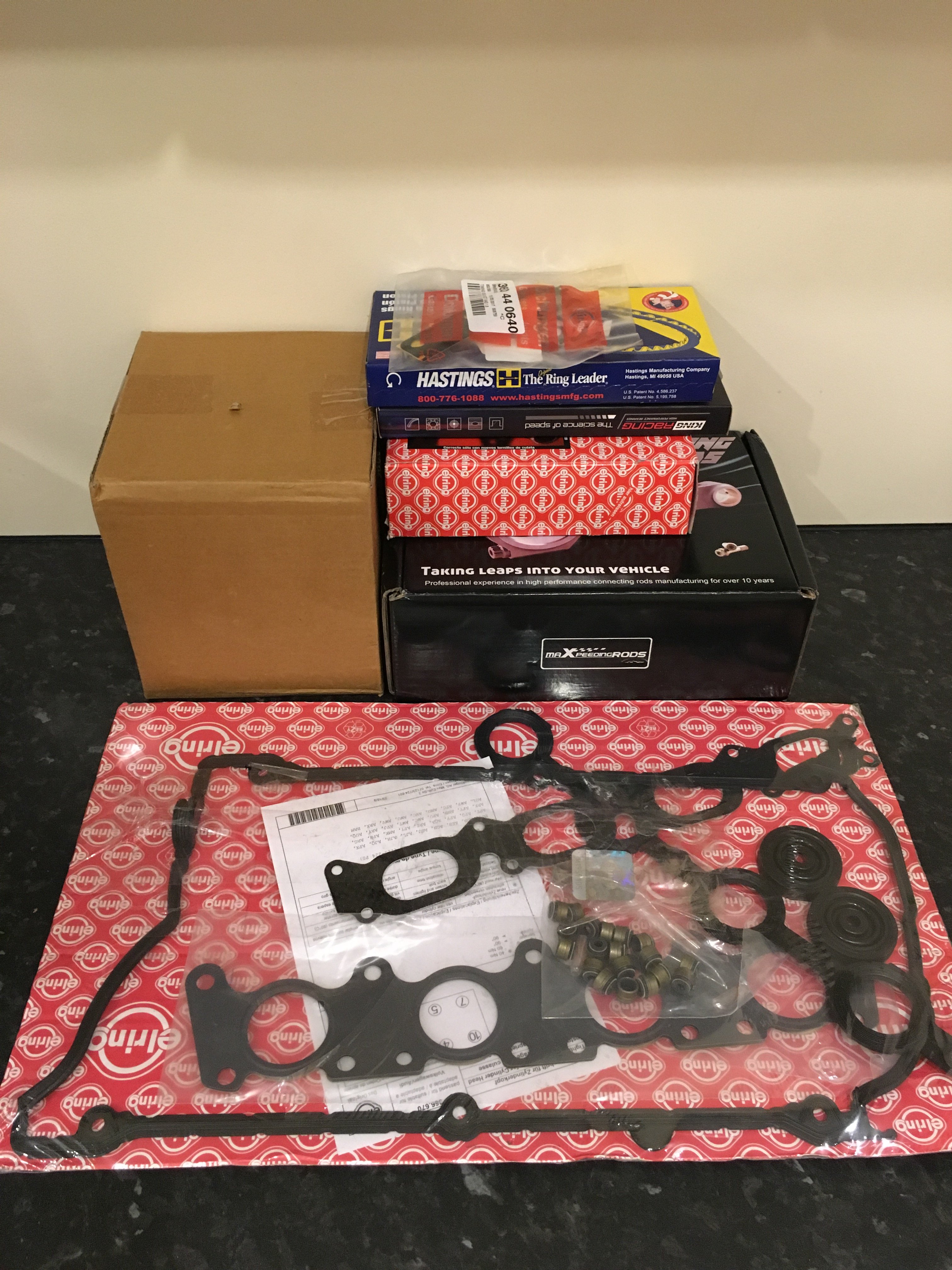

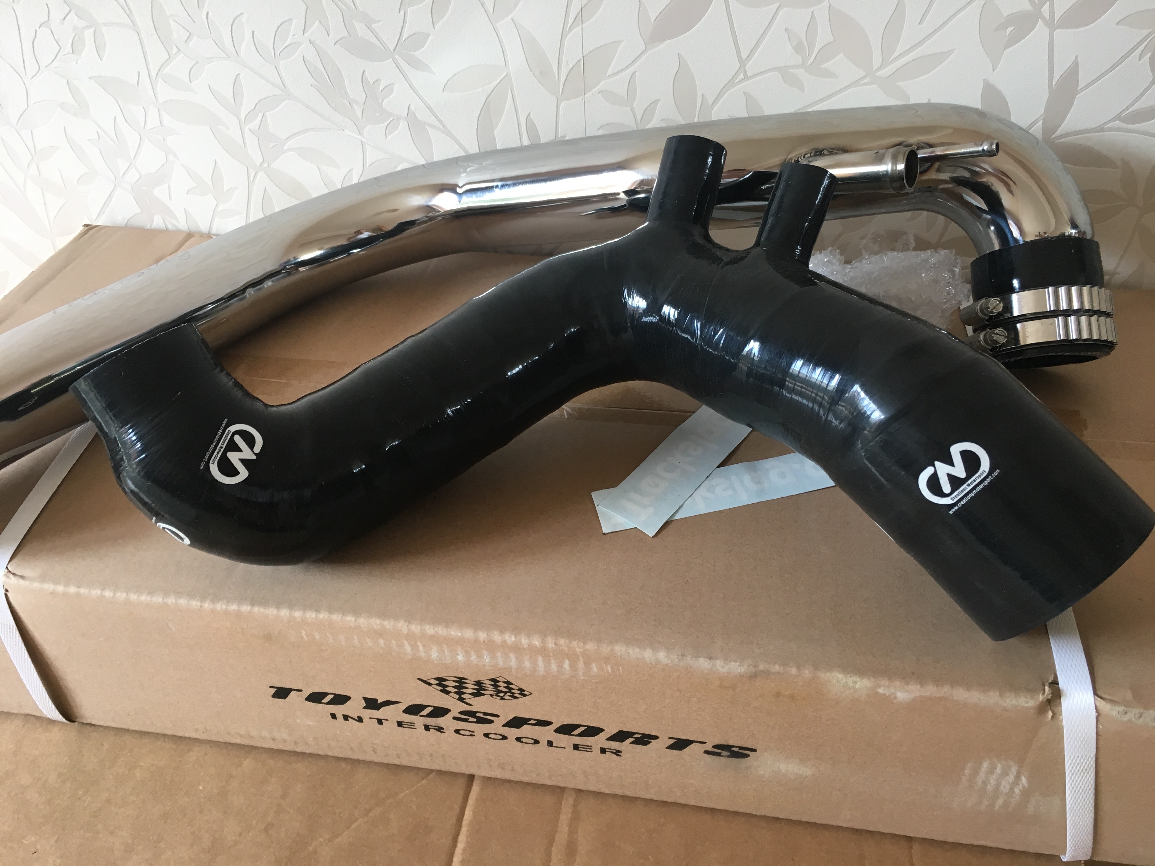

Some more goodies turned up today, some at post office too :D

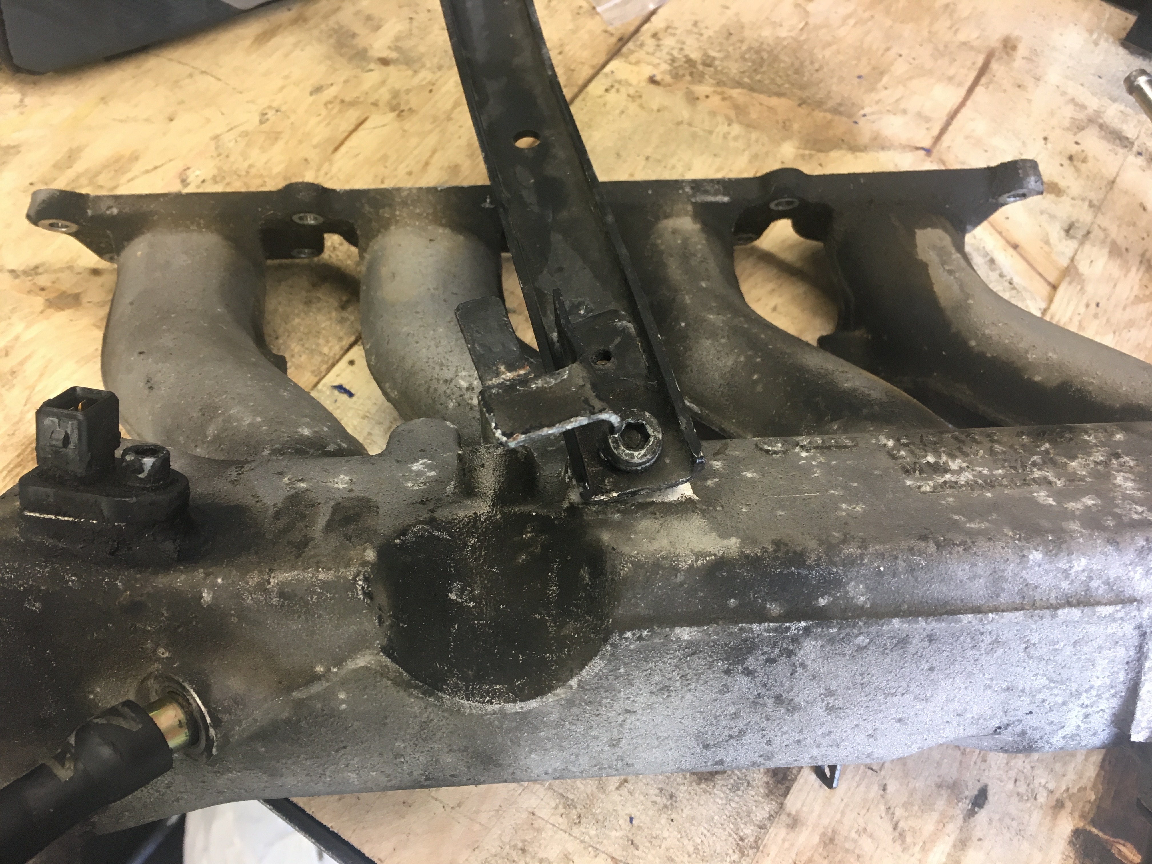

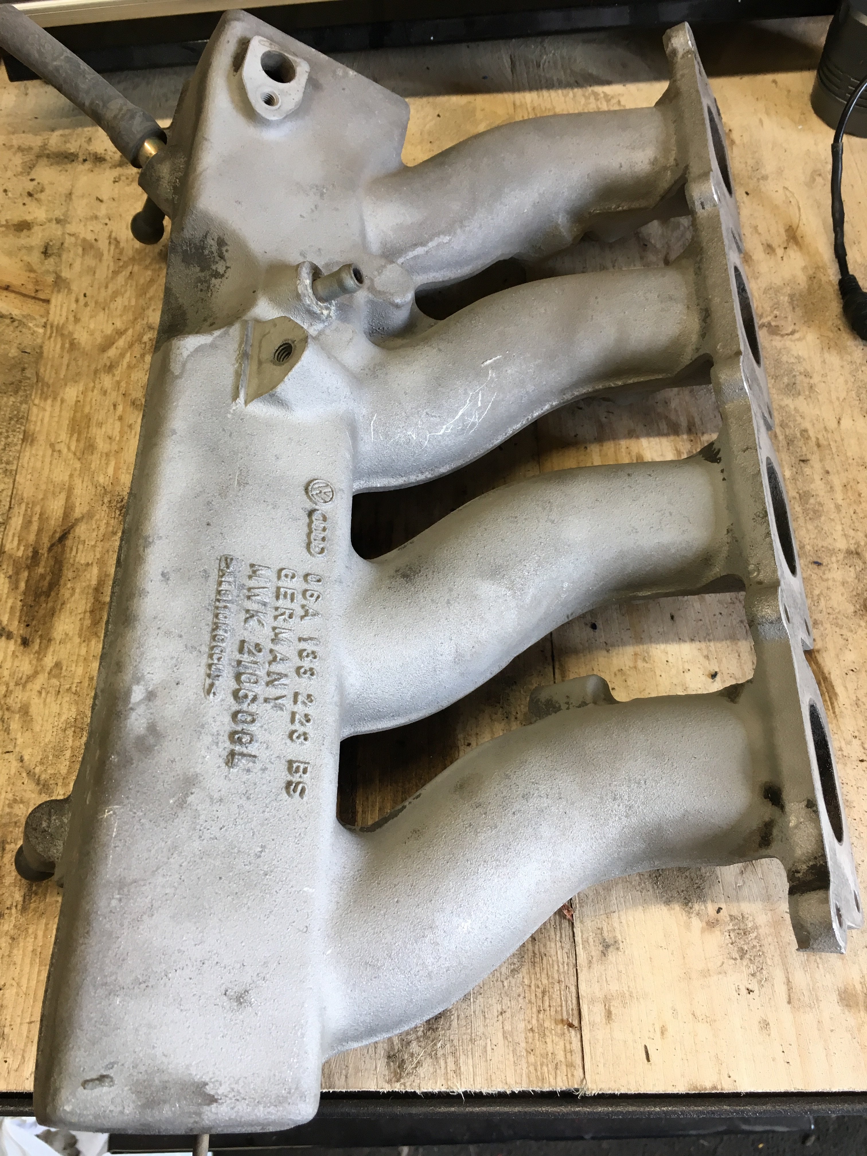

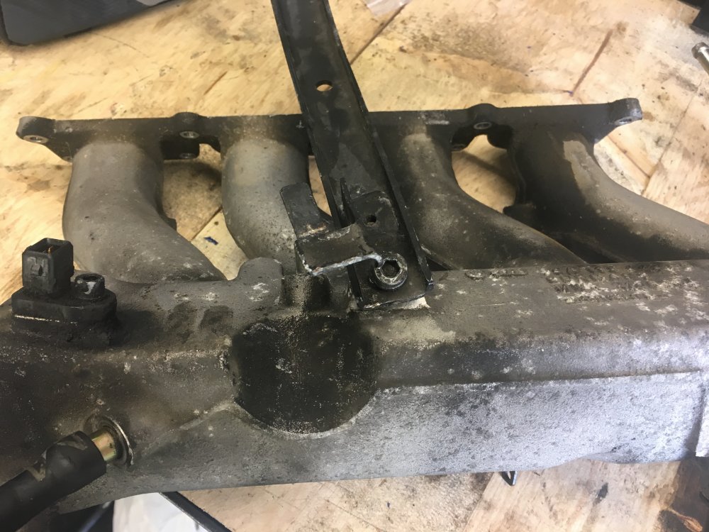

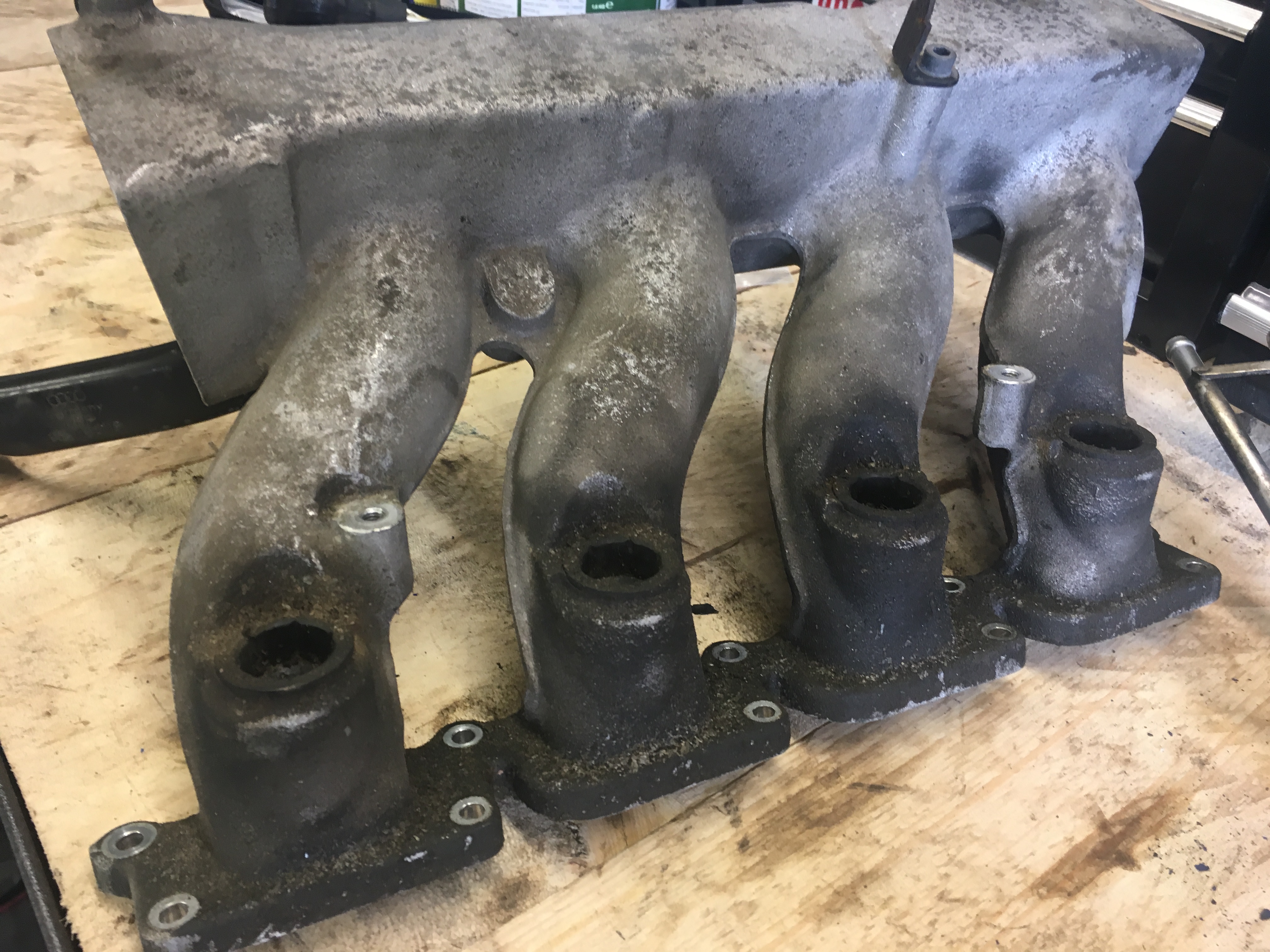

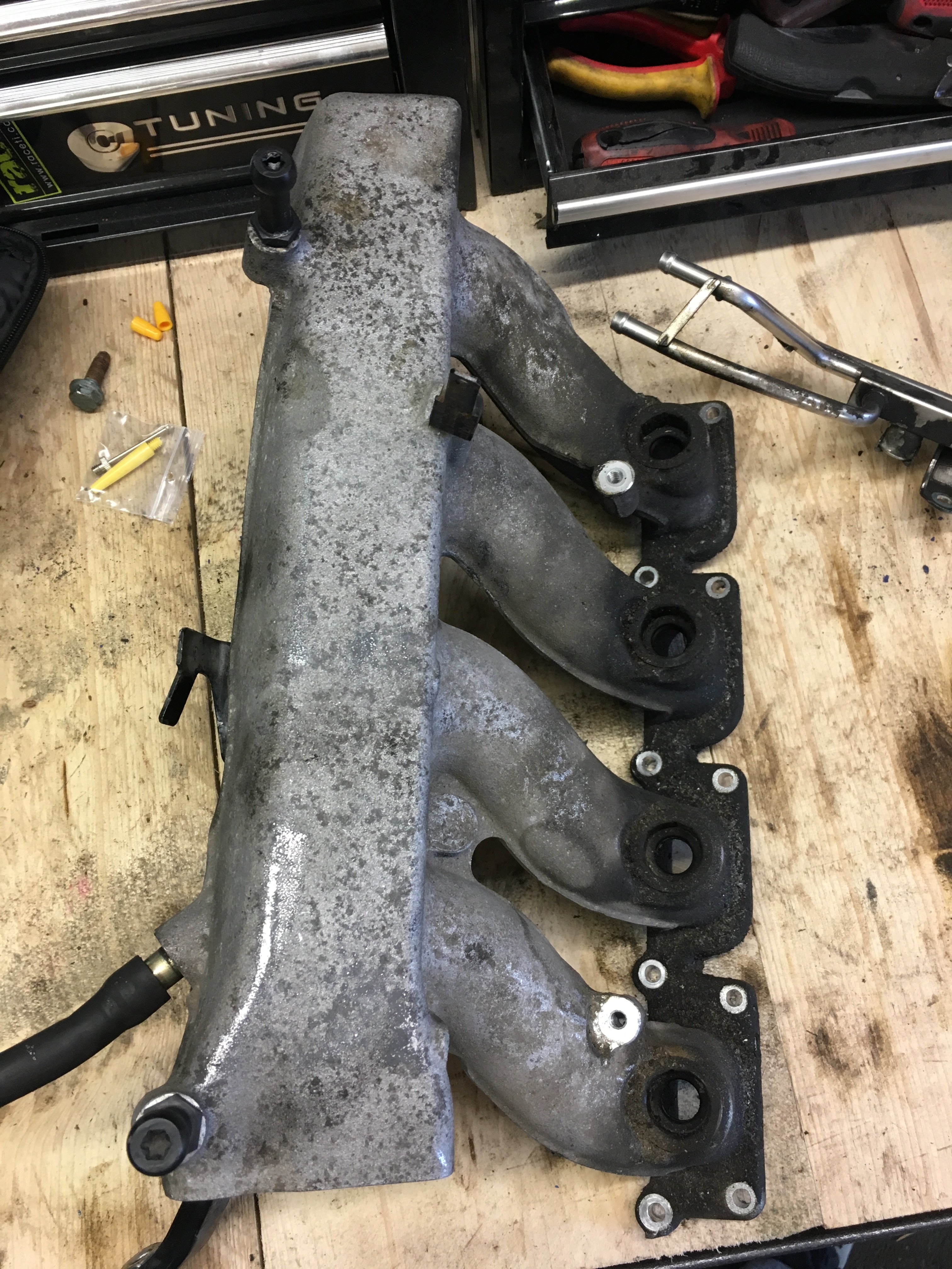

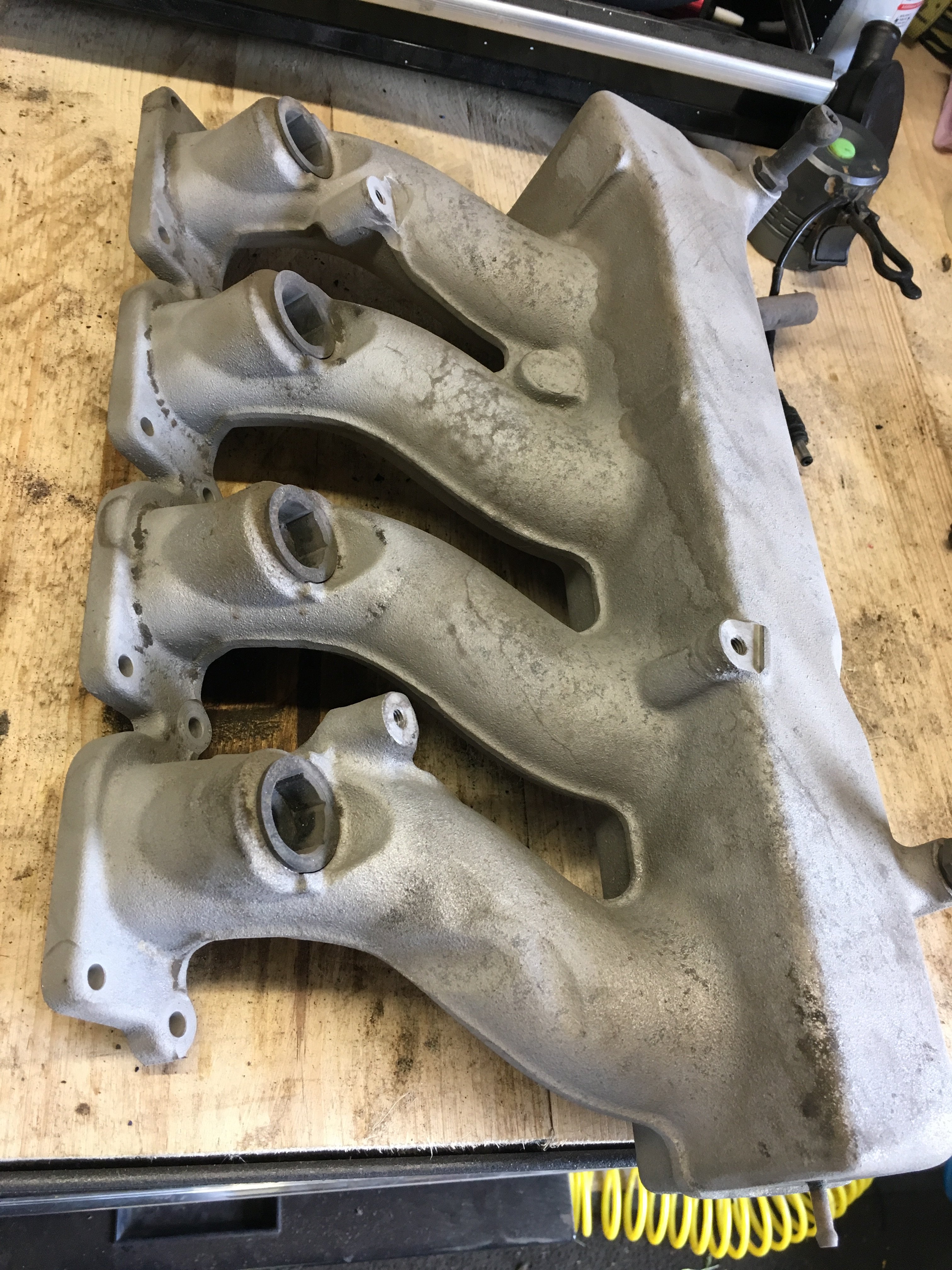

Cleaned up inlet manifold.. as far as i got before my compressor died.
before

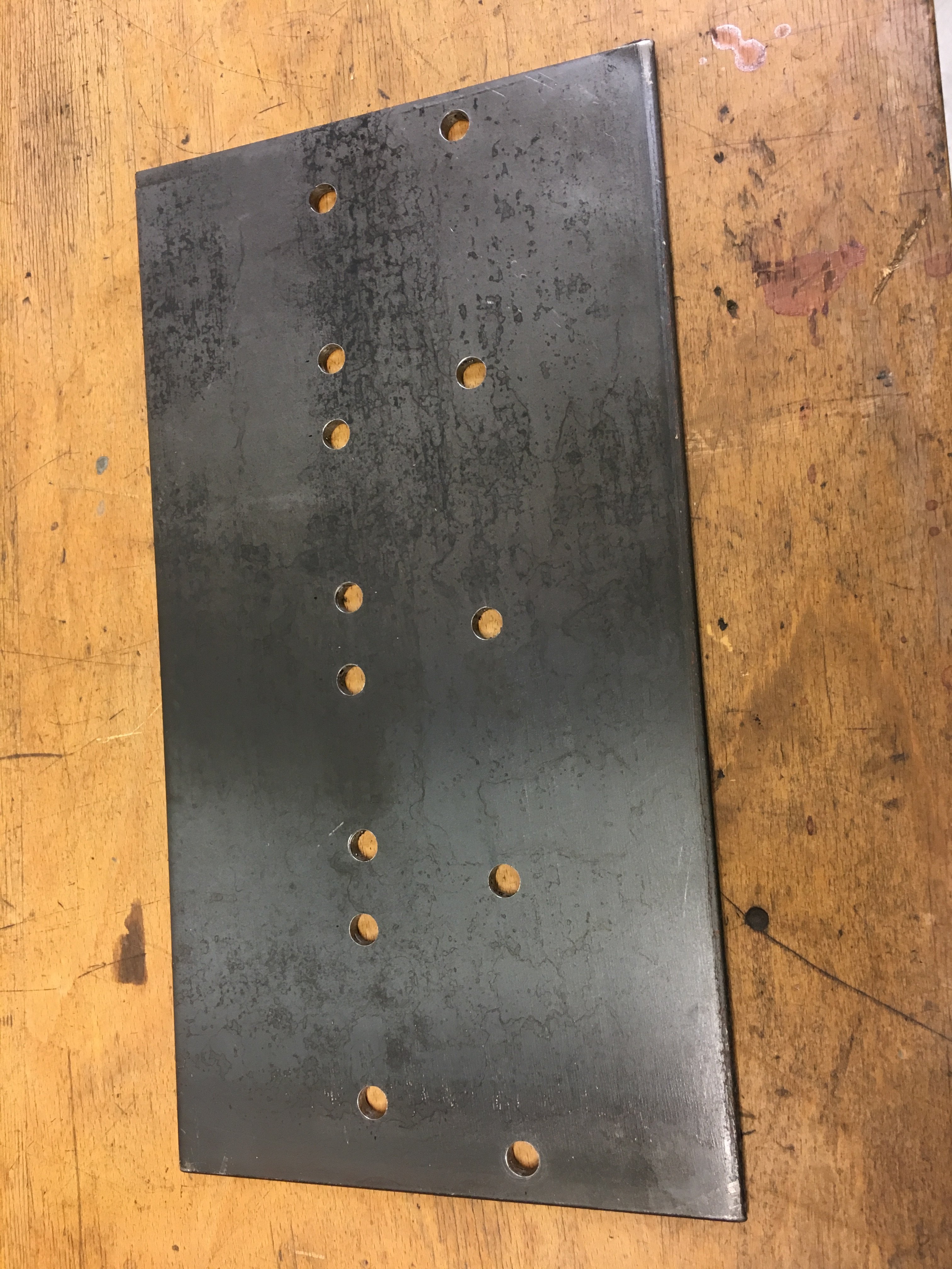

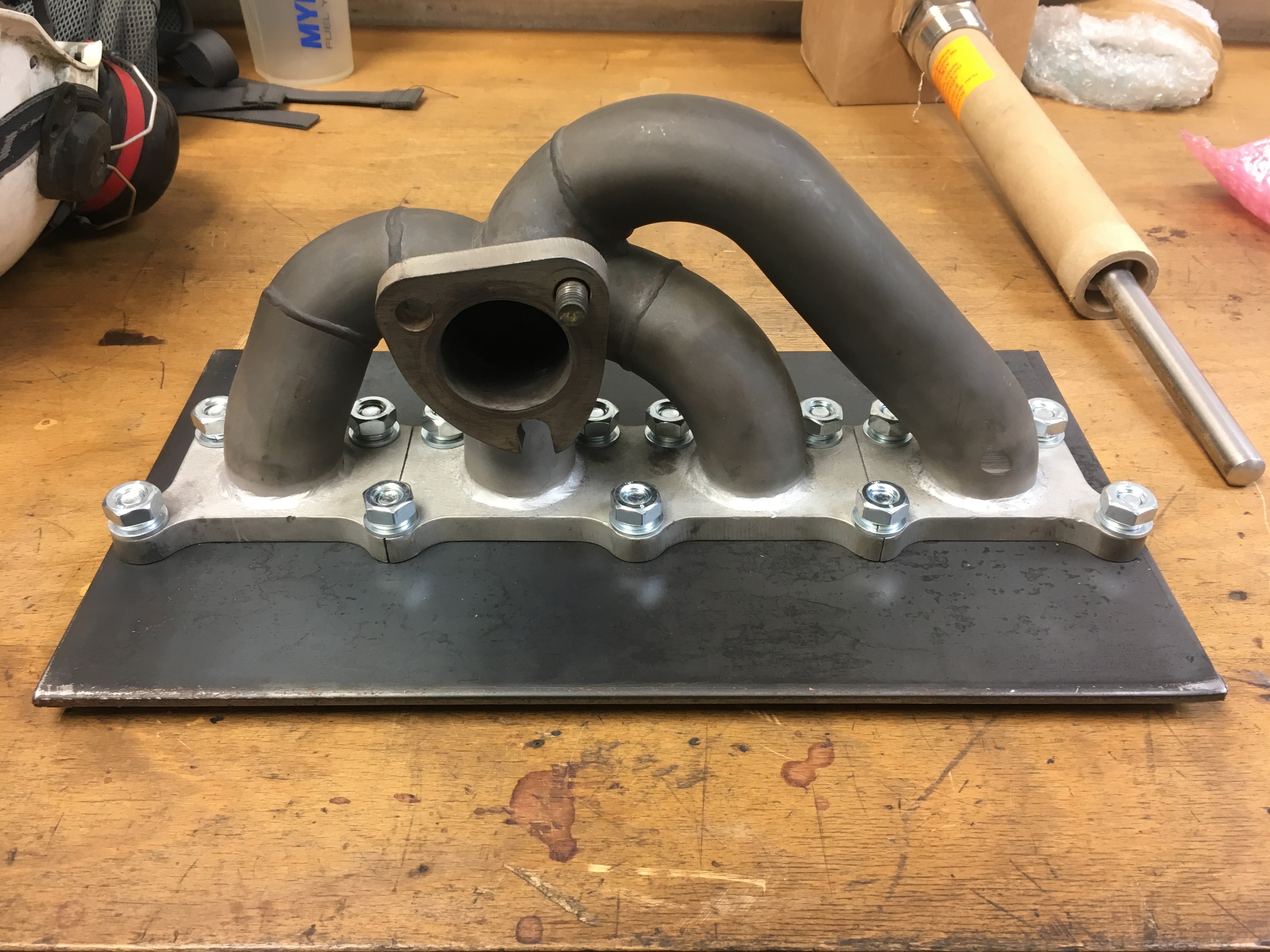

Anyone guess what this is for? :biggrin:
Manifold adapter plate?
Good effort, but not quite.
I wnted to mke sure the 4th leg sits flush when bolted up tight as its wrped slightly.  Beets working..
