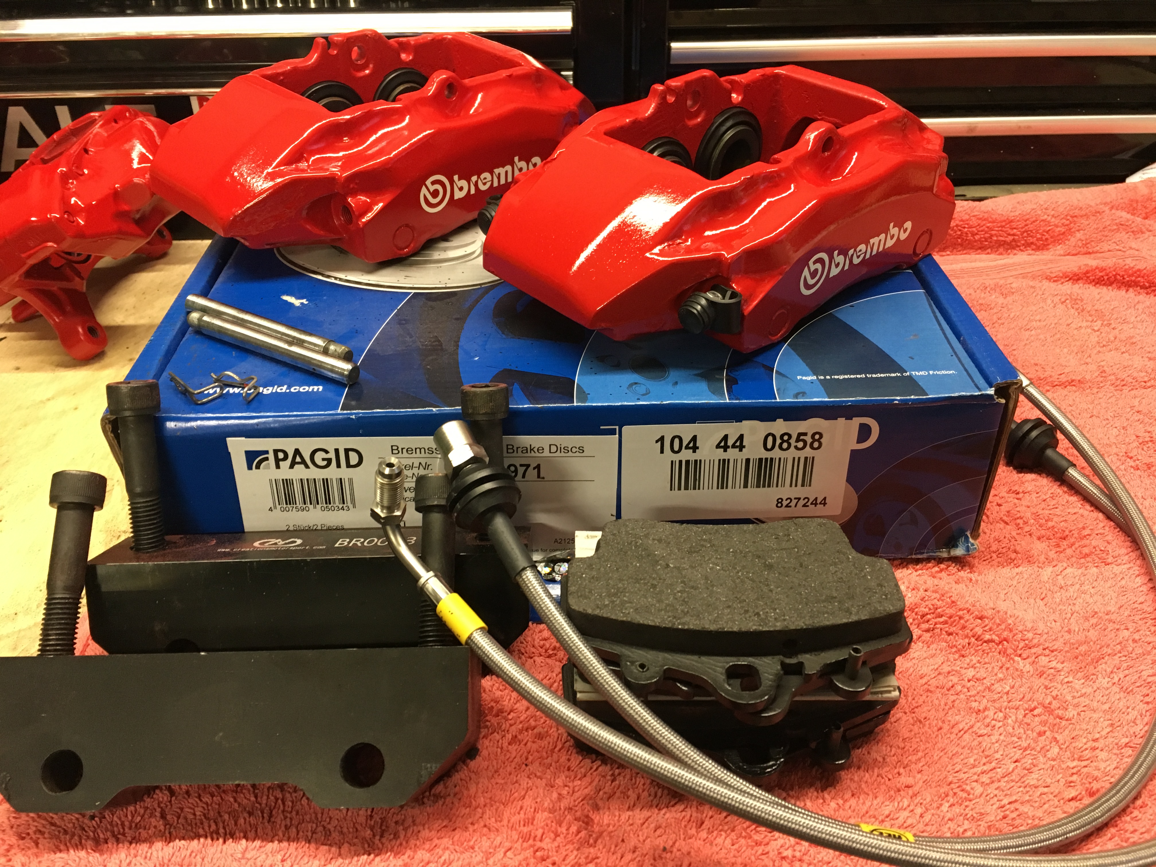

Good job with those brakes, looking good.
Fascinated to see the rear brake solution, hurry up Phil!!:cool:
Haha i am too!! Not sure what disc to use yet either. 256/288/312, personal pref would be 288 mainly for asthetics but i'm not sure yet. We will see soon :cool:
There is a firm in Germany who sells brackets to fit Porsche rear four pots onto the rear of our cars, but you also have to run the OE rear caliper as well to retain the handbrake, looks messy with two calipers on the back imo.
what you doing regarding the handbrake Phil?
Think philip had that kind of set up on his octy :)
dont need a handbrake on a race car though ;)
Phill does though because it has to pass an MOT as he drives to and from the track. So yes, he'll need a handbrake.
Fit a couple of normal calipers for one day out of the year... Jobs a goodun
I think Phil should go all out yolo, cars like the Jag F-Type have 2 so why the hell not :D just paint one black ;)
Na, paint them different colours and make 'em stand out! In fact, fit three.
Yeah I used to run 6 pots and 4 pots with R32 caliper on my octy..
But not worried about hand brake for the Fabia, so a second caliper is out of the question.
Can't you get an in car line lock for when it's on trailer etc
Why? :D
It's fine without a hand brake, just can't do crazy hand brake turns at mcdonalds
Cayenne calipers on the Octavia Phil??
Yeah. 350mm front discs and 310mm rears. Stopped well :D
What was pedal travel like and feel with them?
Exactly the same as standard, feel was perfect and very progressive. Litrally popped your eyes out it used properly.

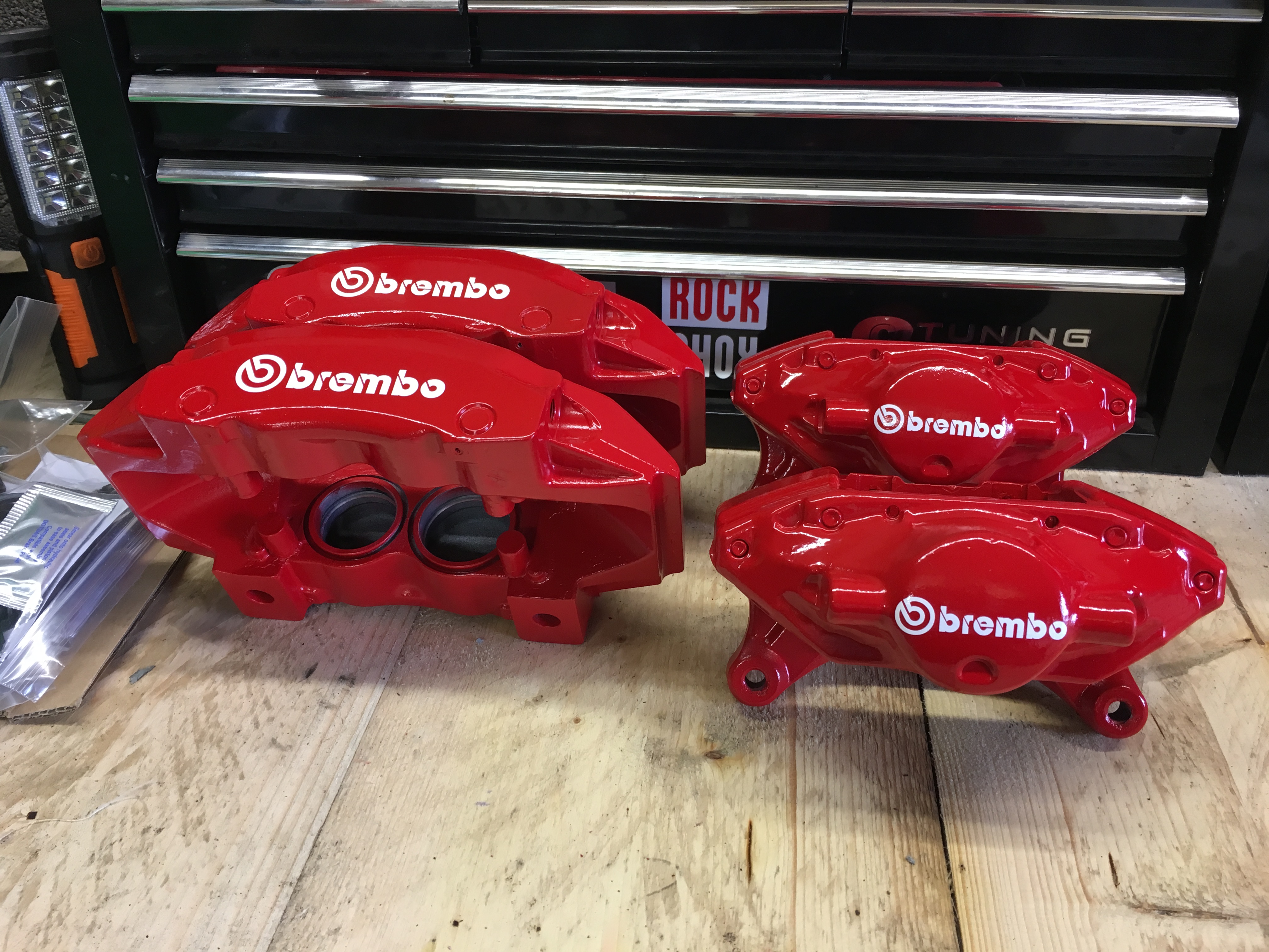

Well the Brembos are now done and up for sale. Check out the classified section ;)

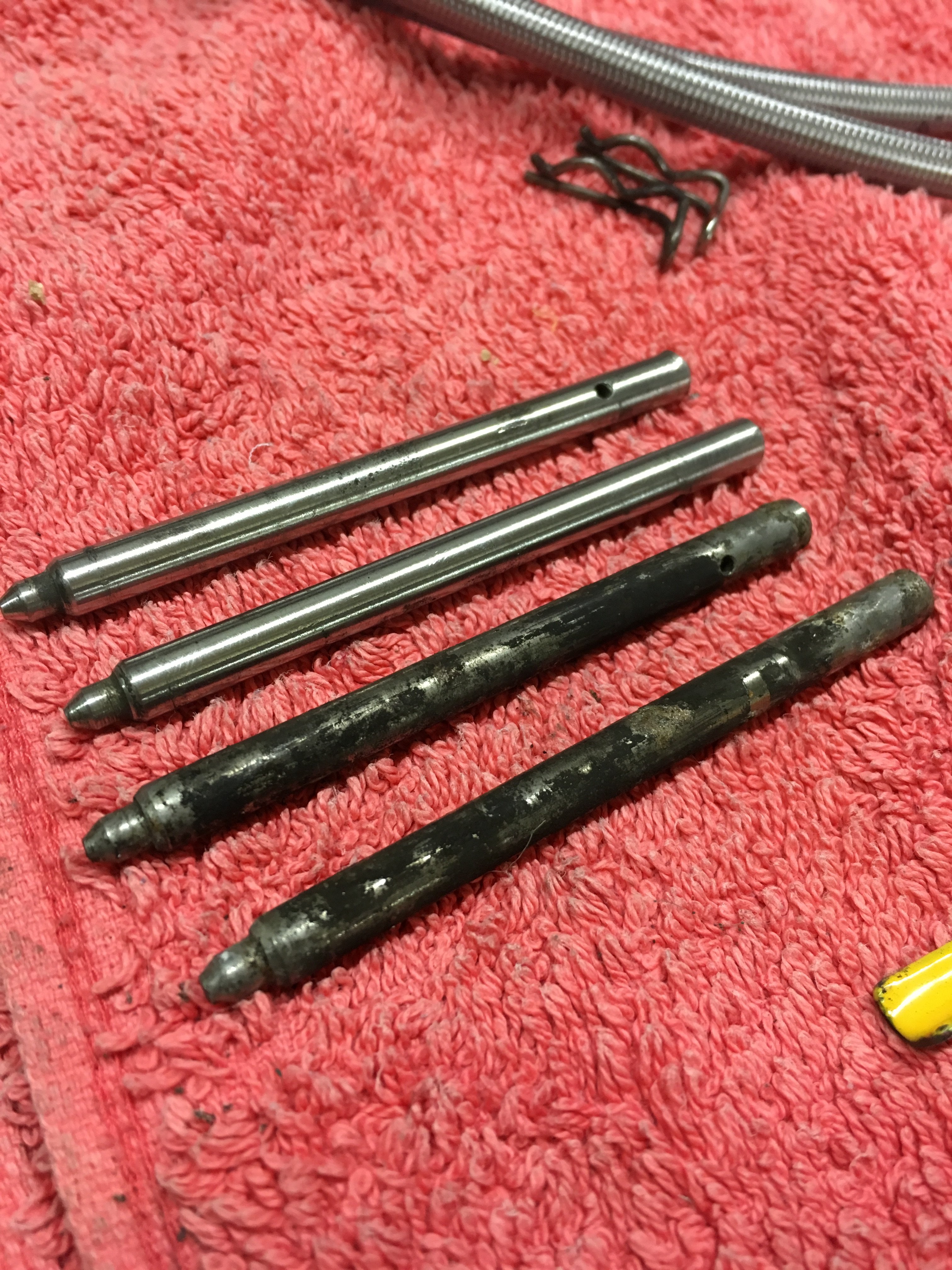

cleaned up the brake pins for my rear Brembos too whilst i was at it, should slide in better and look a lot better.

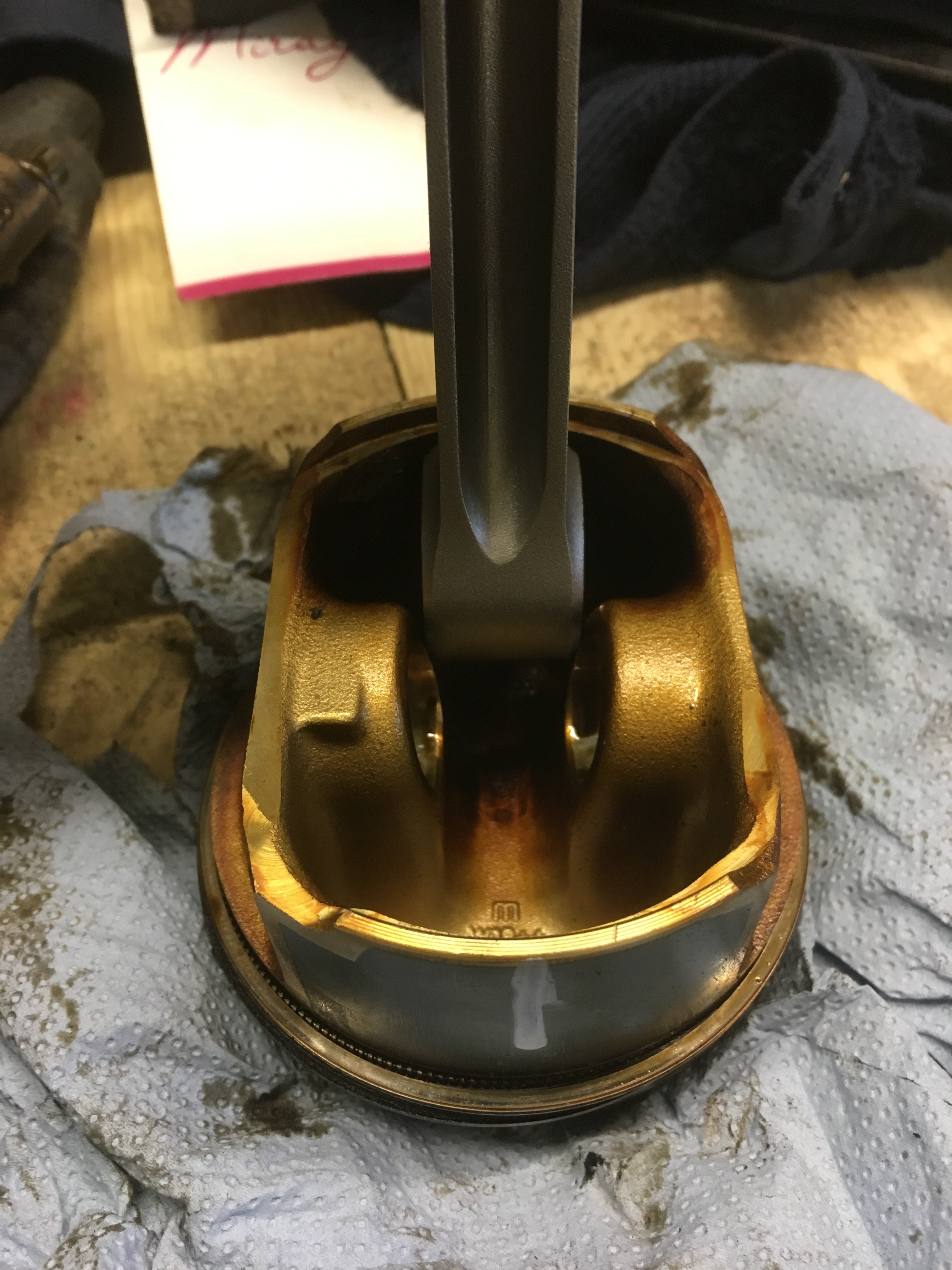

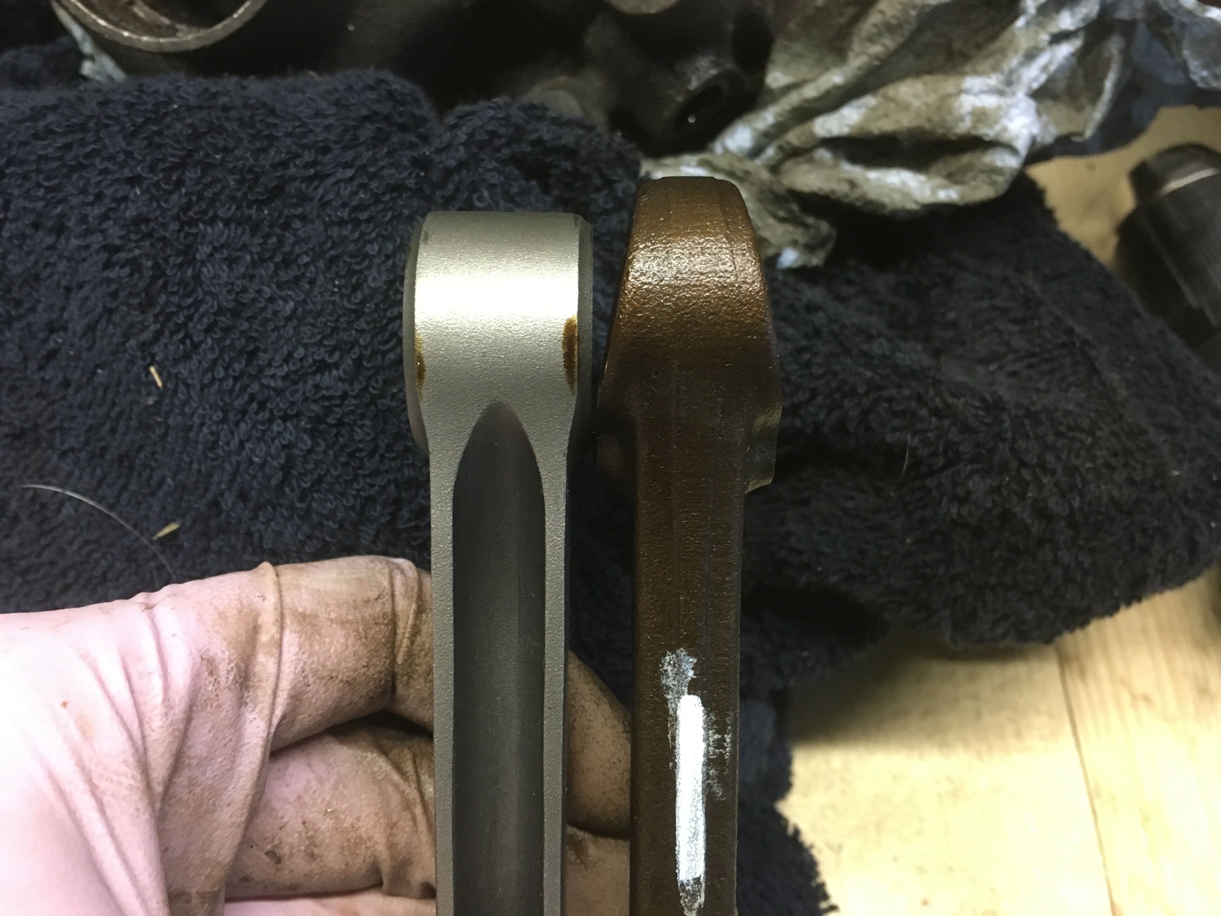

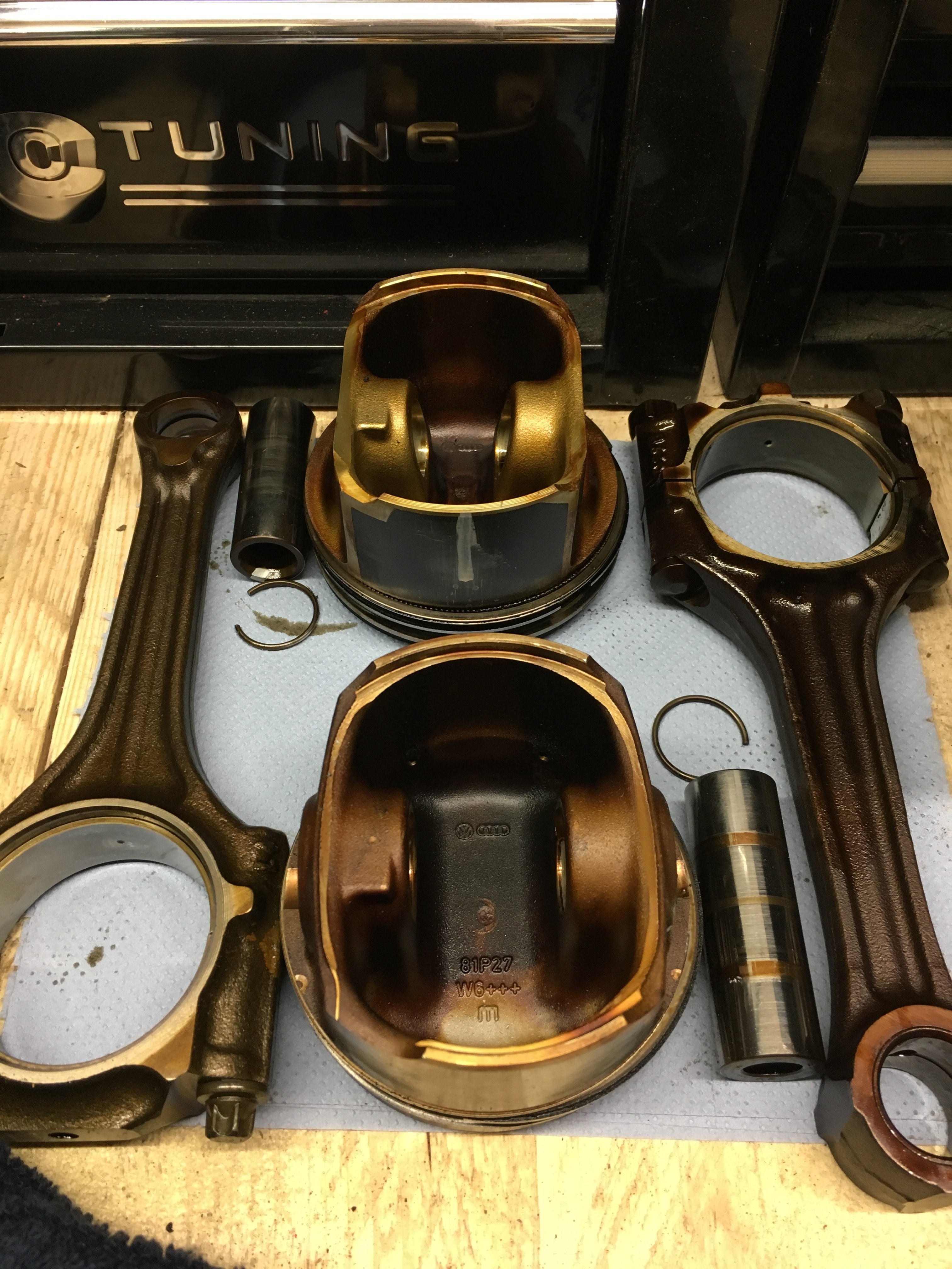

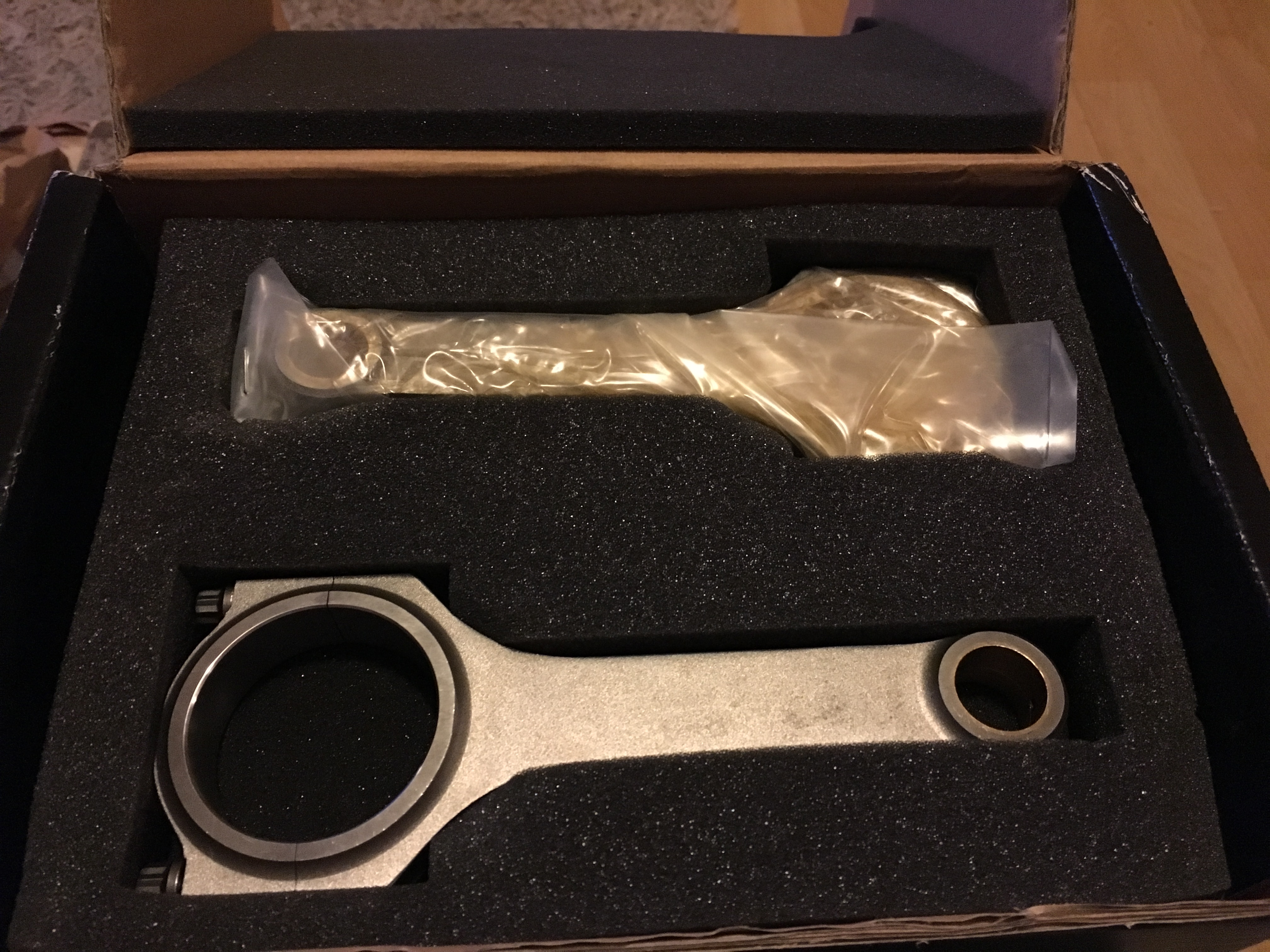

Well started on the engine and hit a snag.. the forged rods dont fit inside standard pistons. The pistons are tapered and the standard rods are tapered too, can be seen in the pics. Now i'll probably do what i planned to start with and buy forged rods with 20mm wrist pins to fit my 'spare' pistons. Last pic shows how the 20mm ones are alot wider.

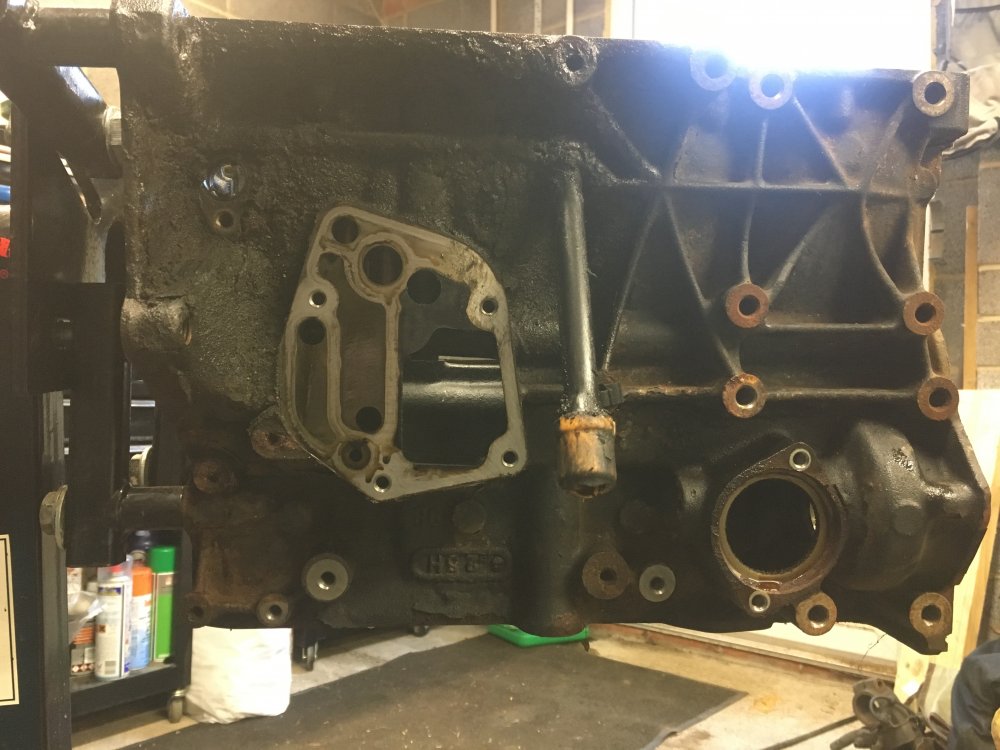

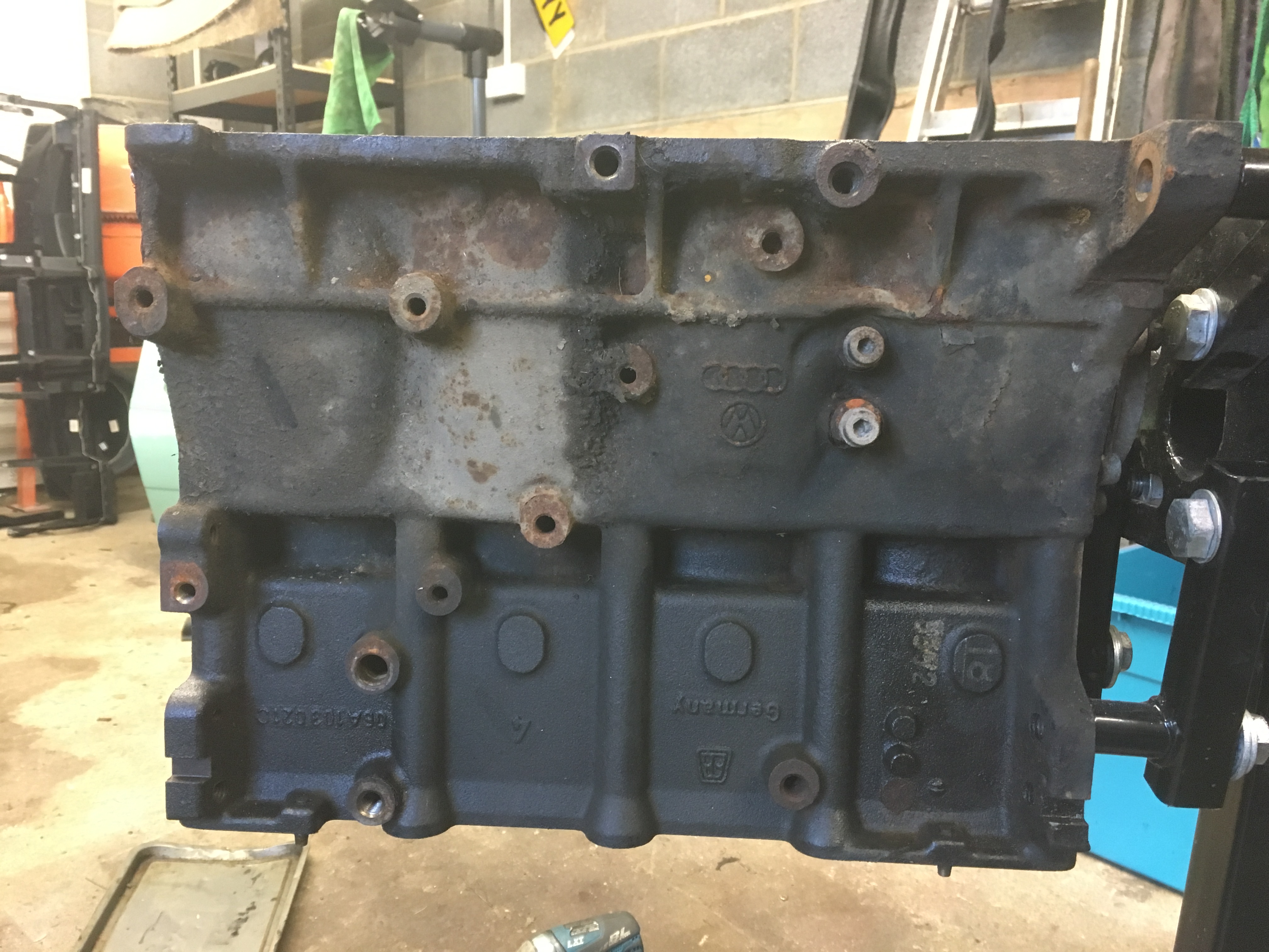

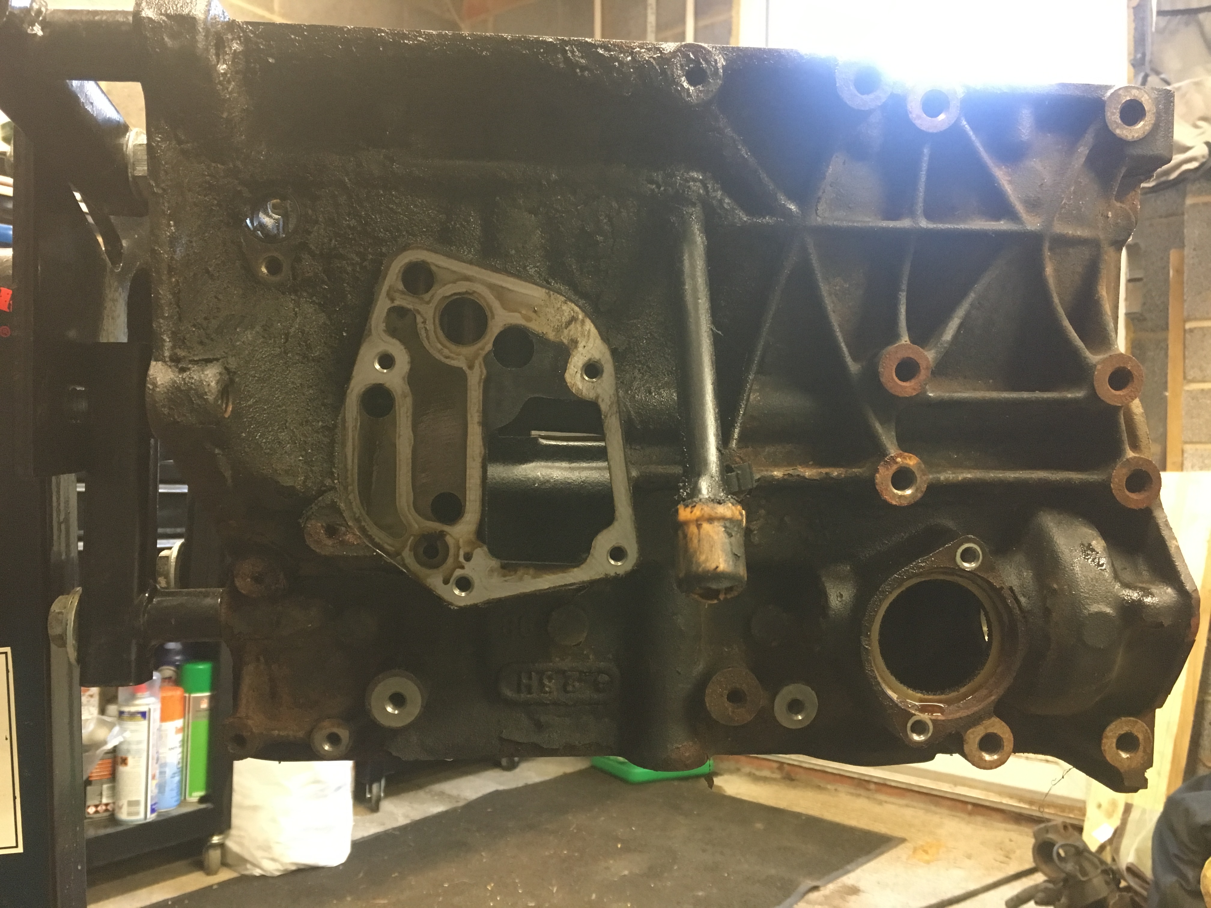

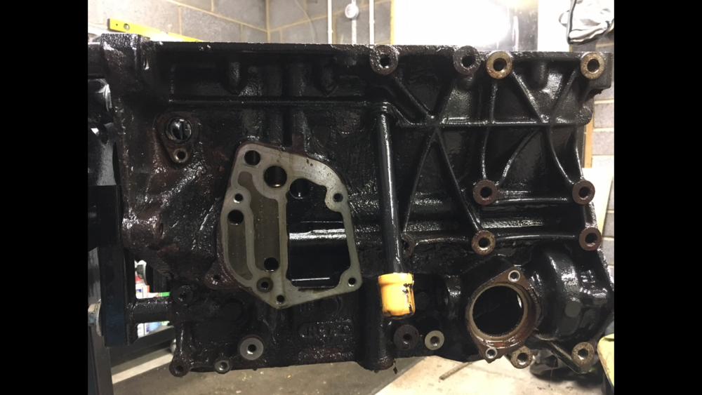

The front of the block is minging, oil and dirt. Started to clean it up, need to get some proper cleaner to get it off then some paint.
Looks like its been dropped in a river haha I'm sure you'll have fun cleaning it off...
The rear is nice and clean though.

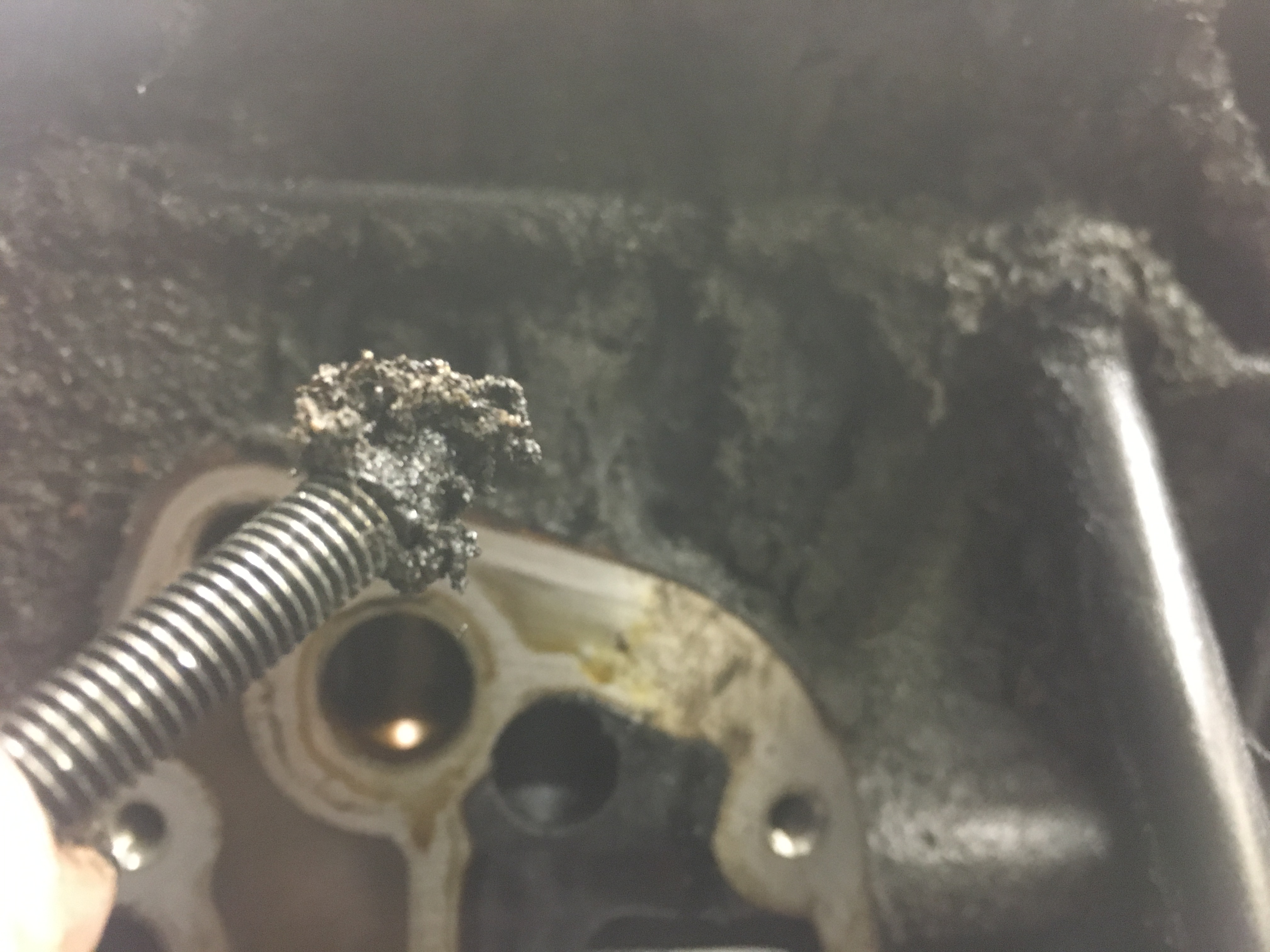

Sprayed up the front and picked the dirt off with screwdriver. Needs a proper degreaser/gunk on it though.
Mine was as bad as yours mate, Mainly oil on mine from a badly fitted return pipe
