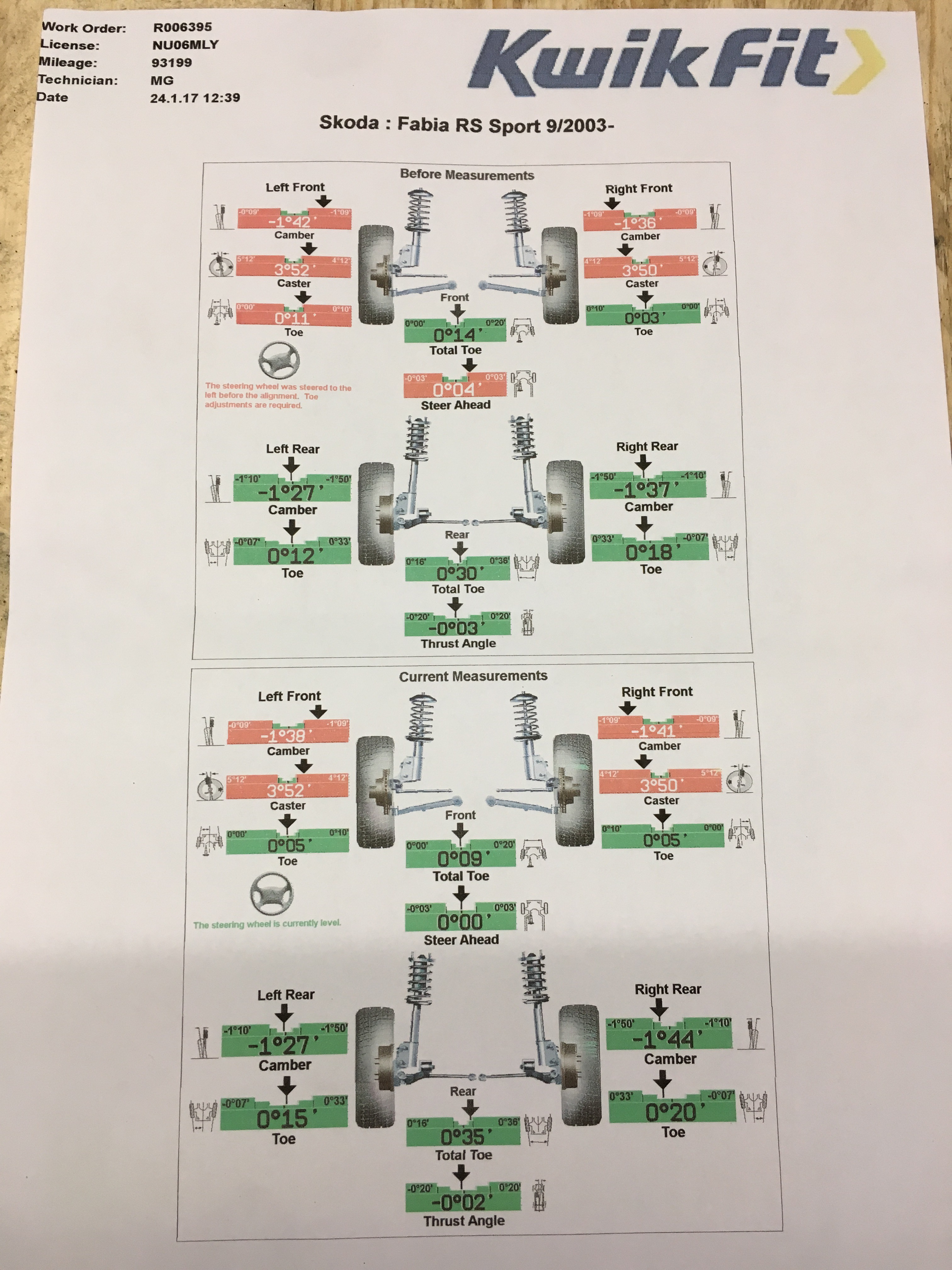

IMG_8454.JPGGoing on a RR tomorrow at Regal Tuning in York. So thought i'd get the tracking sorted as it felt really bad..
%5BURL=http://s31.photobucket.com/user/Philip_123/media/11576682-6FE1-47BD-B5C8-8379F5603041_zps2kxjugrs.jpg.html%5D%5BIMG%5Dhttp://i31.photobucket.com/albums/c363/Philip_123/11576682-6FE1-47BD-B5C8-8379F5603041_zps2kxjugrs.jpg%5B/IMG%5D%5B/URL%5D
feels better and doesnt try to pull wheeel from your arms.

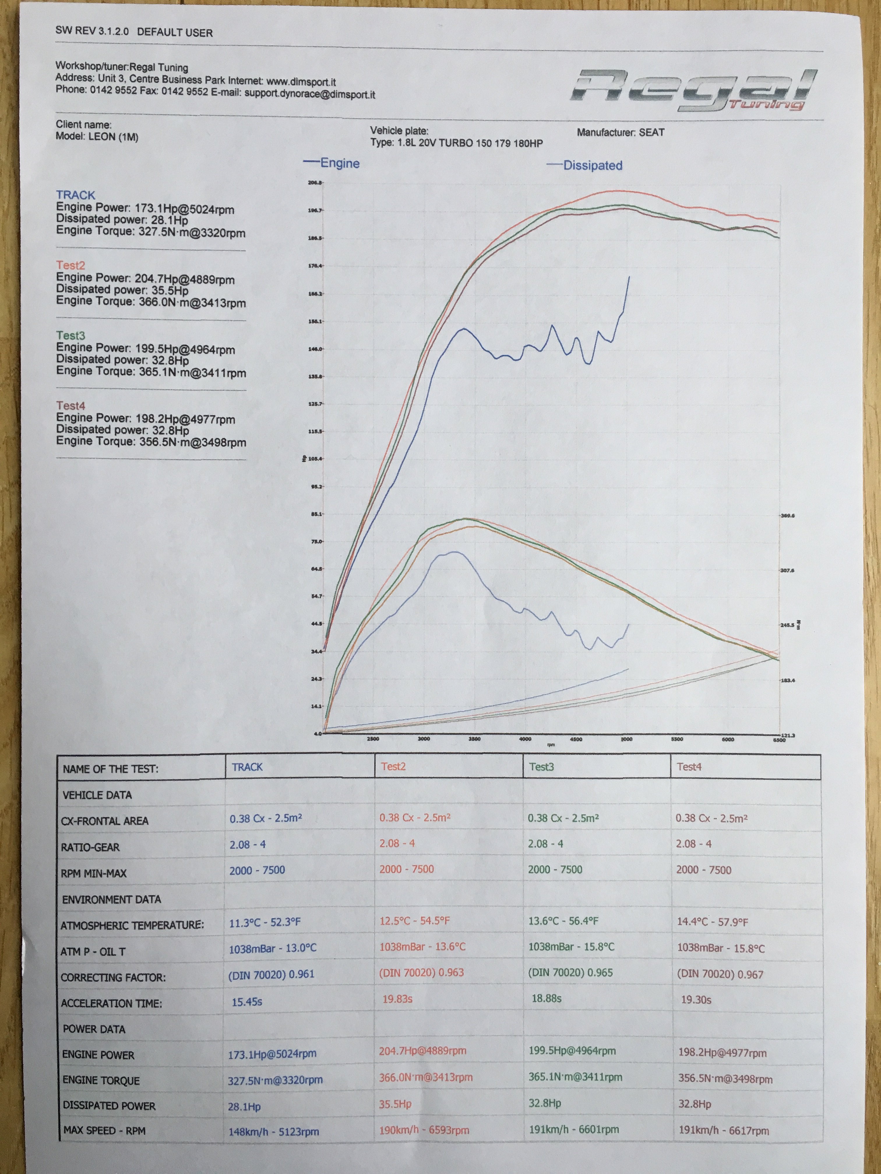

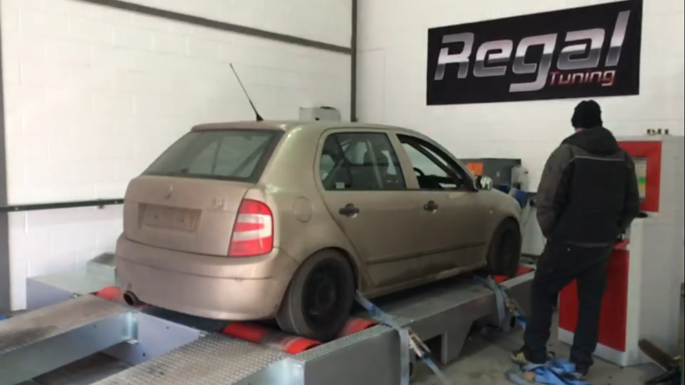

day out at Regal tuning, my mates 650i ran 310bhp and its 360bhp standard so the rollers were deffo reading low.
i ran 198, 199 and 204bhp not too fussed on numbers. There were big flames on the overrun down but i didnt video that run.. typical
