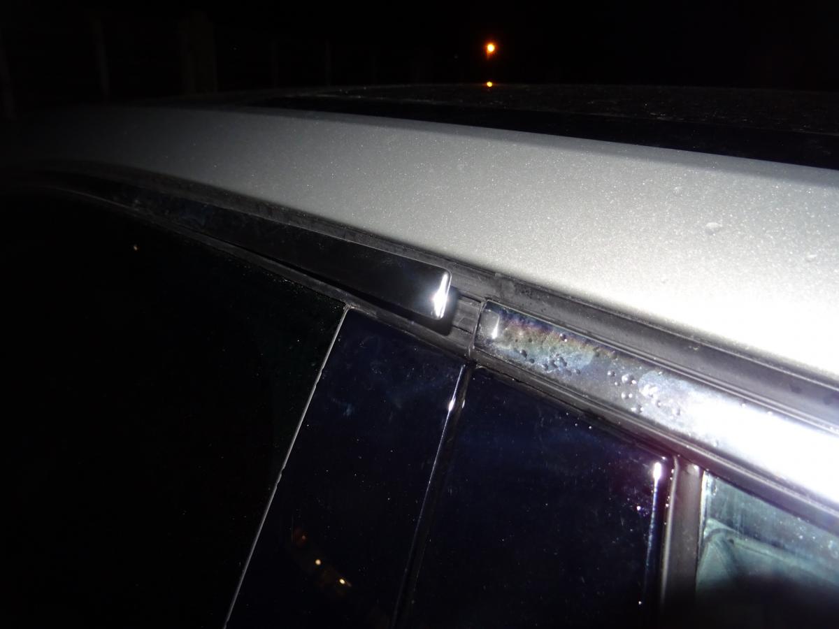

But then I gave it a good wash the other day and spotted the chrome strip on the passenger door was very slightly out of line with the rear passenger door, anal I know but it's a slight fault.
The chrome trim on my front/rear doors is out a smidge but I'm not that bothered about it.
That ever so slight misalignment of the door trim that I ignored as irrelevant has suddenly turned into a PITA issue for me.
The rubber seal of the driver's door is now pulling the r/o/s door chrome strip out of it's rubber housing every time I open the driver's door.
I suspect the mounting of the driver's door is out by just a couple of mm or so, so I'll get it back to the dealer to have it sorted asap.
So those like me who noticed but ignored what appeared to be the smallest of flaws, be aware it can quickly develop into something much more annoying.

I took it to the dealer the following day so they could have a look and after three people examined it they couldn't determine if the rubber needs removing and realigning or the door needs rehanging.
It could be either a two hour job (if just the rubber) or a two day job (door alignment means taking to their bodyshop which is elsewhere, hence two days).
Booked to go in tomorrow. Having since compared it with the passenger door I notice the door gap on both sides are even, so silently praying it's just the door's rubber seal that needs realigning.
As a temporary fix I put one drop of rubberised superglue behind the chrome trim and that was enough to stop it popping out each time I opened the door.
