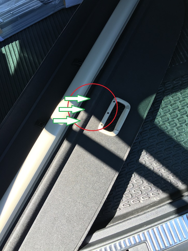

I've taken a proper look at this infuriating luggage cover rattle.
I removed the cover and took it indoors. I opened it out and wedged the mechanism to stop it winding back in before suspending the back of the cover (where the pull handle is) between to dining room chairs to simulate its position in the car.
By tapping the back of the cover, I could recreate the rattle it made in the car. I removed the plastic handle (3 Torx screws) to ensure it wasn't that. With it removed, the rattle was STILL there.
I replaced the handle and checked it again. I finally tracked it down to the bar that runs the width of the cover, just in front of the handle.
It appears there is a thin piece of metal wrapped around the plastic that runs from one side to the other, presumably to add stiffness. It was this thin metal that was tapping against the plastic inner.
Note: the following paragraph is highly technical, so please try and keep up with me on this one......
I clouted it three times with a small hammer which essentially pressed the steel up against the plastic inner  :giggle:
I've replaced the cover and there aren't any rattles so far. Fingers crossed the next few days will prove if my high tech fix has worked.
Do you have any video of the bashing ?
Meanwhile, at the other end of the load cover, I've stopped the felt strip vibrating by applying some Johnson's Klear floor polish (sounds strange but it works well as a thin glue that will wick into small gaps and as a gloss varnish; ask anyone who makes scale models) to the seam where it slides inside the metal crossbar.  The rattle is gone but it was intermittent at worst so I can't be sure if it's fixed for real.
I'll be checking the handle end too now :thumbup:
