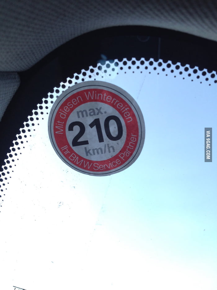

I have seen the stickers. I work for a German company and when our guys come over from Germany I've seen the stickers fitted to their vehicles.
But of course they have the chance to legally drive above that speed. :)
You get the Stickers from Various Owners clubs, Volvo, MG etc.
Getting the stickers is not an issue, and it is only where you are fitting lower Speed Rated tyres anyway,
and with a UK NSL of a max of 70mph it is likely why it has never been an issue other than with Insurance Companies who until recently many had Winter Tyre fitments being a Safety Risk rather than a benefit to safety in the UK.
Maybe a Sticker should be on the Dash of every Private,Lease & Hire car or Van telling the Driver to see what tyres are on that day, and check the pressures before setting off.
