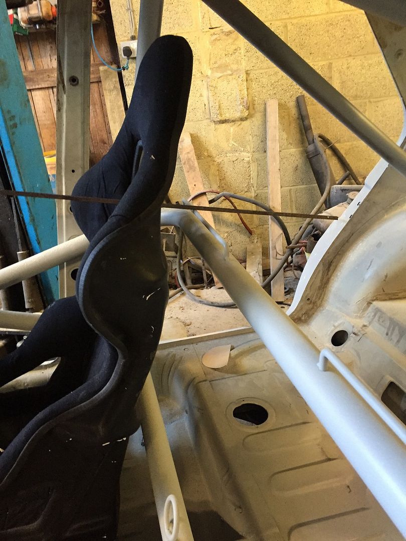

I suggest you find the nearest Scrutineer to you and have a chat with him about how to mount your belts. It might be worth getting the seat placed temporarily and seeing then. I think that bar is much too close and too low to mount your belts.

As for the cage I will get a scruteneer to look at it but fro. What you say I can now clearly see it's not right so I at take it back to the roll cage shop for adjustment I beleive it has to be 20 degrees from top of seat to restraint

I think the recommended angles for the belts with Hans is between 10 and 30 degrees and there is a recommended distance as well. There was something in one of the recent MSA publications I got sent.

Regards to the roll cage I've taken some photos with an old seat which is about 2" away from that bar I'll load the pictures shortly

I've also taken photos of the cage with an old seat see what you think

I think that belt mount bar is possibly too low and almost certainly too close to the seat.
I'll see if I can find a link to the diagram.

Here is the latest FHR ****e from the MSA.....I think angle wise Graham has misinterpreted things......horizontal from the mounting to shoulder is good.
Mandatory use of FHR
With effect from 1 January 2016 the use of FHRs becomes mandatory in Racing, Sprints, Hillclimbs and Stage Rallies – but there are exceptions. In Stage Rallying, Historic Category 1 cars (pre-1968) are exempt. In Sprints and Hillclimbs ‘Roadgoing’ category vehicles are exempt.
Additionally in Sprints and Hillclimbs, as well as in Racing ‘Period defined’ vehicles are exempt, this is cars of Periods A –H, i.e. those constructed prior to 1st January 1977.
A specific document has been circulated in the main MSA newsletter to all licence holders concerning helmet and FHR compatibility which is different for MSA National events compared to International permit events. If you are involved in a championship that involves a round being held outside of the UK, advise competitors to be careful for most ASNs follow the FIA regulations. Therefore irrespective of a race at – for example - Spa-Francorchamps running on an MSA National permit, FIA requirements will likely apply.
In terms of harness/seat/FHR set up, refer to the advice on the FIA website. Although it is recommended that the shoulder attachments are closer together so that the straps go outward from their attachments to go over and round the FHR, this is not mandatory. It is recommended that the shoulder straps be horizontal between the attachment and the user’s shoulders, or that the attachment is at a lower point to make an angle of 0-20o to the horizontal. Note this is a recommendation and if shoulder straps make an angle with the horizontal of 0- 45o this is acceptable. It is not acceptable for the shoulder strap attachments to be at a higher point (creating an angle above the horizontal). Note that (K)1.2.2 is updated so as to allow the fitment of not only door bars, but also harness bars to homologated ROPS, but this is only for MSA National events. The addition of door bars and/or harness bars to homologated ROPS is not permitted under FIA regulations.
