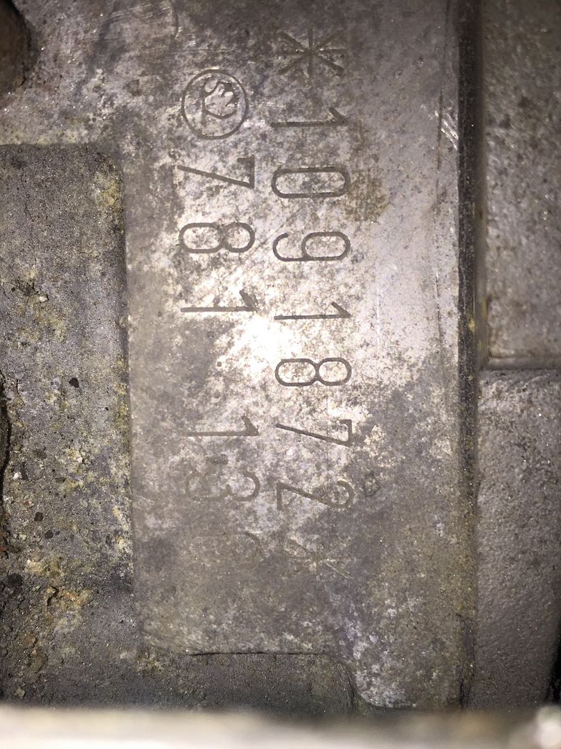

The engine with the red block is the original
The engine with the red head is undoubtedly Australian :p
The engine number is on the block not the head....next to the water pump

I've already shared a picture of the engine.......might as well got for the whole car now! Rob......read more carefully.....2/10 for attention :D . It's only a replica.
Skodapaddy (that can't be your real name!) - the general opinion is it's an early Favorit engine.....assuming there aren't any letters missing after the numbers that can't be seen.
