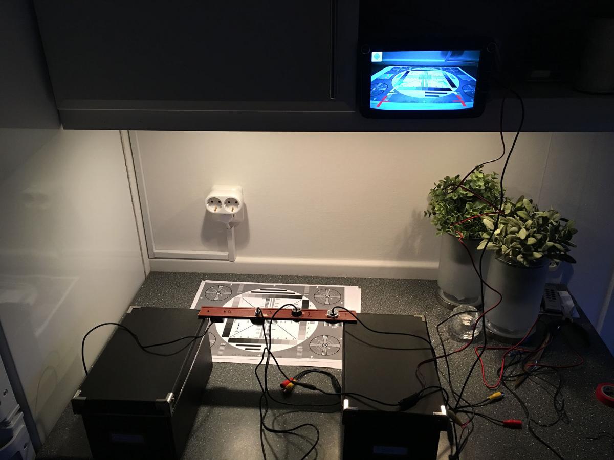

Please keep in mind this is the first time I've ever tried my hand at reviewing a camera. Also, since it's not that easy to run around with the "testing rig" (consisting of car stereo, an old computer PSU, and the four cameras) all tests where done on my kitchen bench and with only one light source.
The cameras are always in order from left to right.

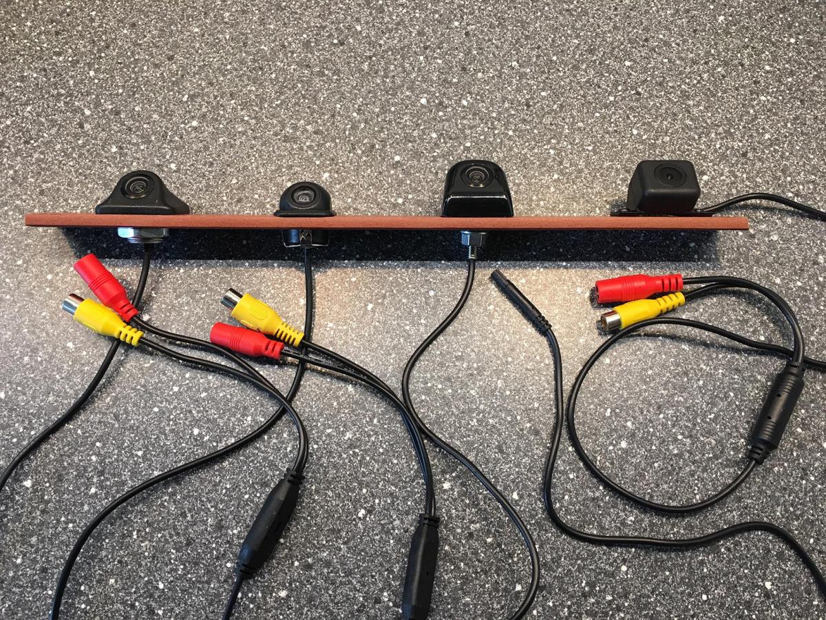

Round 1, mounting:
If you take a look at the first picture you will see the different ways the cameras mount to the car. Camera 1, 2 and 3 all use the mounting hole for the cables as well, camera 4 differs here.
1: Big nut screws onto metal threads. Felt good. 2nd place.
2: Some kind of metal thingy with small hooks that is somehow supposed to make it stick. By far the worst. 4th place.
3: Same as #1, but with smaller threads and nut, not requiring as big of a hole. Also, this camera has a special connector containing both video and power, small and nice! 1st place.
4: Two small screws, plus a separate hole needing to be drilled for the cable. Not as nice as the others, but still beats out crappy #2. 3rd place.
Round 2, build:
Have a look at the second picture, and you will se the cameras mounted and from the front. Here you can also see the special connector of camera 3. I won't rank them here, since this is very individual what you like.
1: Nice shape, second smallest, feels well built.
2: Smallest and really discreet. Most plasticky feel.
3: The only glossy one. Biggest of the bunch, and feels very solid. Heaviest by far, and not plasticky at all.
4: Second largest. Feels somewhere between #1 and #2 quality wise.

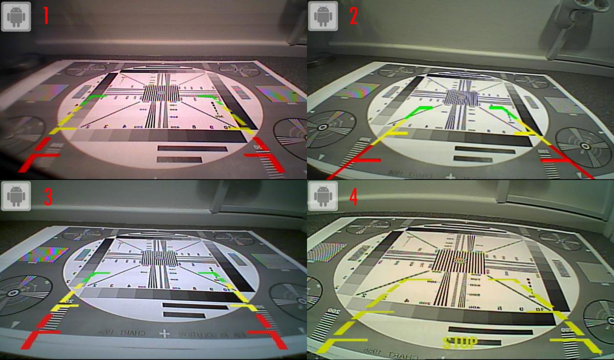

Round 3, resolution/sharpness/white balance:
One thing I found hard to judge here was white balance. #2 and #4 are quite similar, and are most true to the actual lighting under which I did the tests, namely halogen spotlights with yellow light. On the other hand, looking at #3 I feel as if it most truly represents the actual colors of the paper and everything, as if it had been under natural lighting.
1: Best sharpness/resolution. Crappiest white balance (quite a lot of red/purple). Second least wide angle. 4th place.
2: Worst sharpness. Best white balace. Widest wide angle. 2nd place.
3: Second best sharpness/resolution. White balance most "natural" but not really true to the situation. Second widest wide angle. 1st place.
4: Quite sharp, but I feel it lacks a little quality vise. Second best white balance. Least wide wide angle. 3rd place.

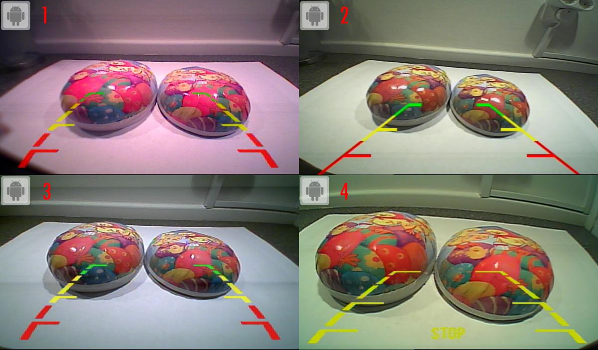

Round 4, color reproduction:
1: A lot of red/purple discoloring. 4th place.
2: Natural. 1st place.
3: Feels most "true" if I disregard the fact that the scene was lit by a halogen spotlight... 3rd place.
4: Natural. 2nd place.

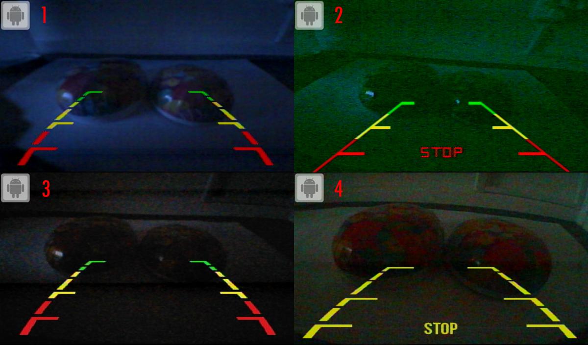

Round 5, low light:
1: 1st place.
2: 2nd place.
3: 4th place.
4: 3rd place.
