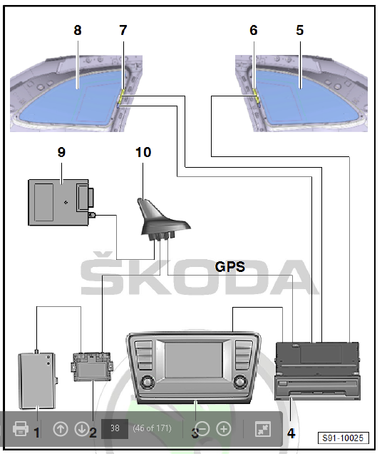

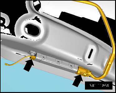

Looking at the workshop manual, there is an amplifier module on the C pillar next to each rear quarterlight. Can't tell what the connections are though.
7 is the FM2/DAB amplifier
