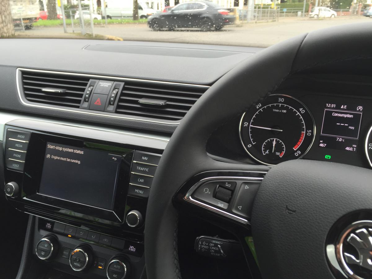

The primary excuse on in car display seems to suggest it's non-operational because of a risk of windows fogging, which I somehow doubt is likely to occur during brief stoppages given sheer internal volume of the estate! But today it surprised me with a new excuse...
I can only presume another regen was underway, but for the car to suggest "engine must be switched on", whilst idling at 1000rpm and up to temp is a puzzling?!

It´s cold these days, and because of that, my Superb often raises the idle RPM to 1000 - like when doing a regen. This, and a load of other reasons will cause S/S not to work.
The message about "risk of window fogging" must be due to the humidity sensor installed in the SIII.
