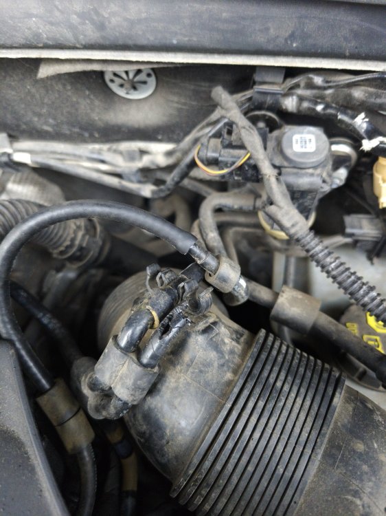

I also am sorry to respond to old thread, but i had this issue today morning and the responses here led me too a solution. It was a vacuum tube from the turbo pressure valve. I already fixed it temporarily wit a random vacuum tube i had in car. IMG_20251129_134015.jpg
