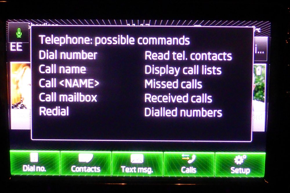

So - I've now had an Android phone for a while (LG G4) and the Amundsen will display my texts, but it doesn't give an audible notification of a text being received, nor does it appear to offer the option of reading the text to me via voice control. Is this possible, for any phone?
Yes, but it works through having the appropriate app on the phone. In the case of my Moto X phone, that's the Moto app, so-called.  I don't know what's available for the G4.
Reading a text by voice control does not appear in list of possible commands.
Which is, for an expensive piece of kit like the Amundsen, pretty crap I'd say. On the lowly PID in our Citigo, "it just worked", to coin the phrase. I didn't have to do anything with settings on my old Nokia 920 - just hooked it up by bluetooth and the next thing I knew I had a voice telling me I'd received a text and did she want me to read it to me? I can even dictate reply texts on the PID (which gives rise to some fairly humorous interpretations, it must be said  :notme:  :no: :D )
