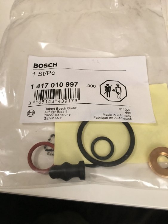

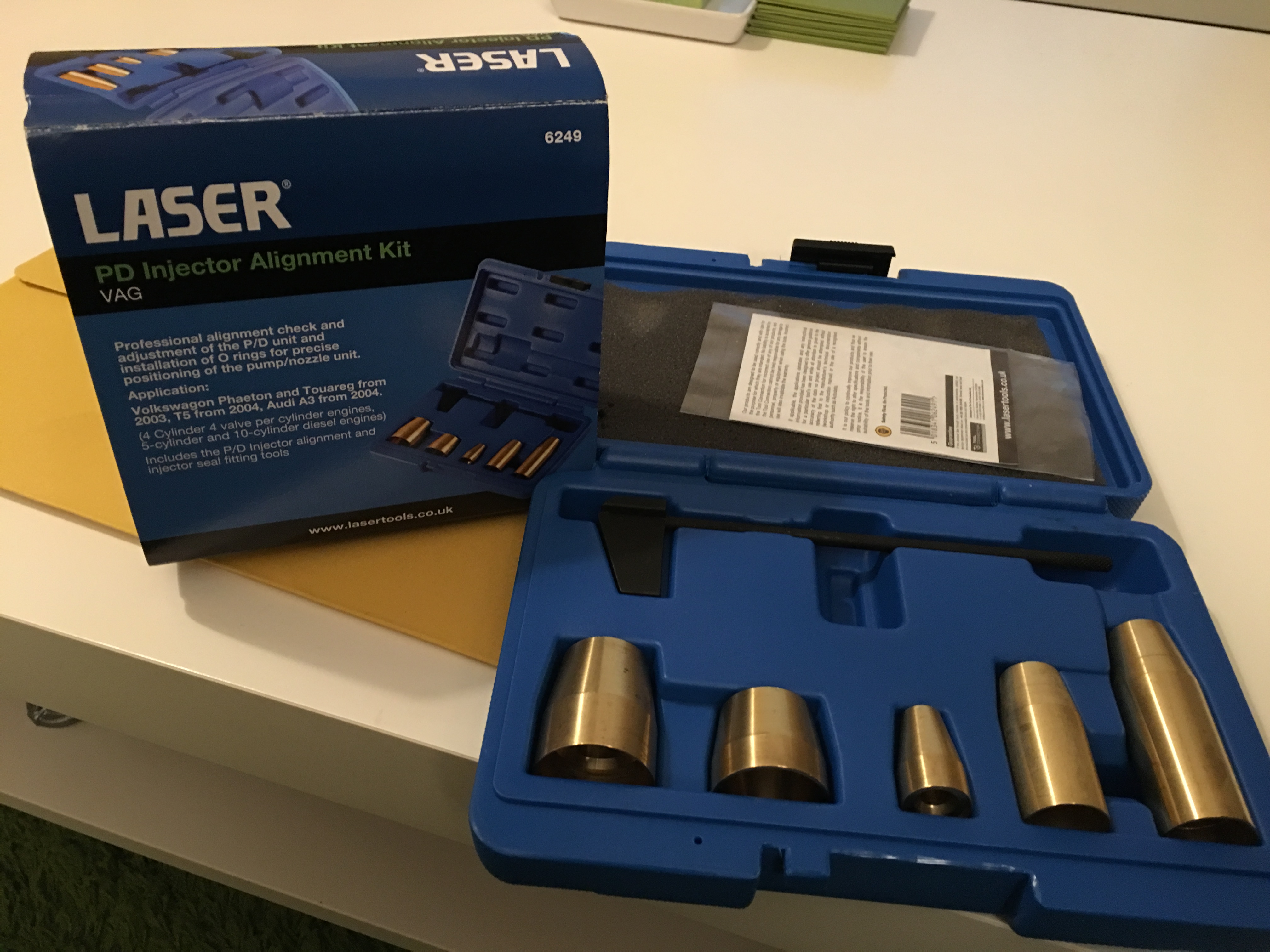

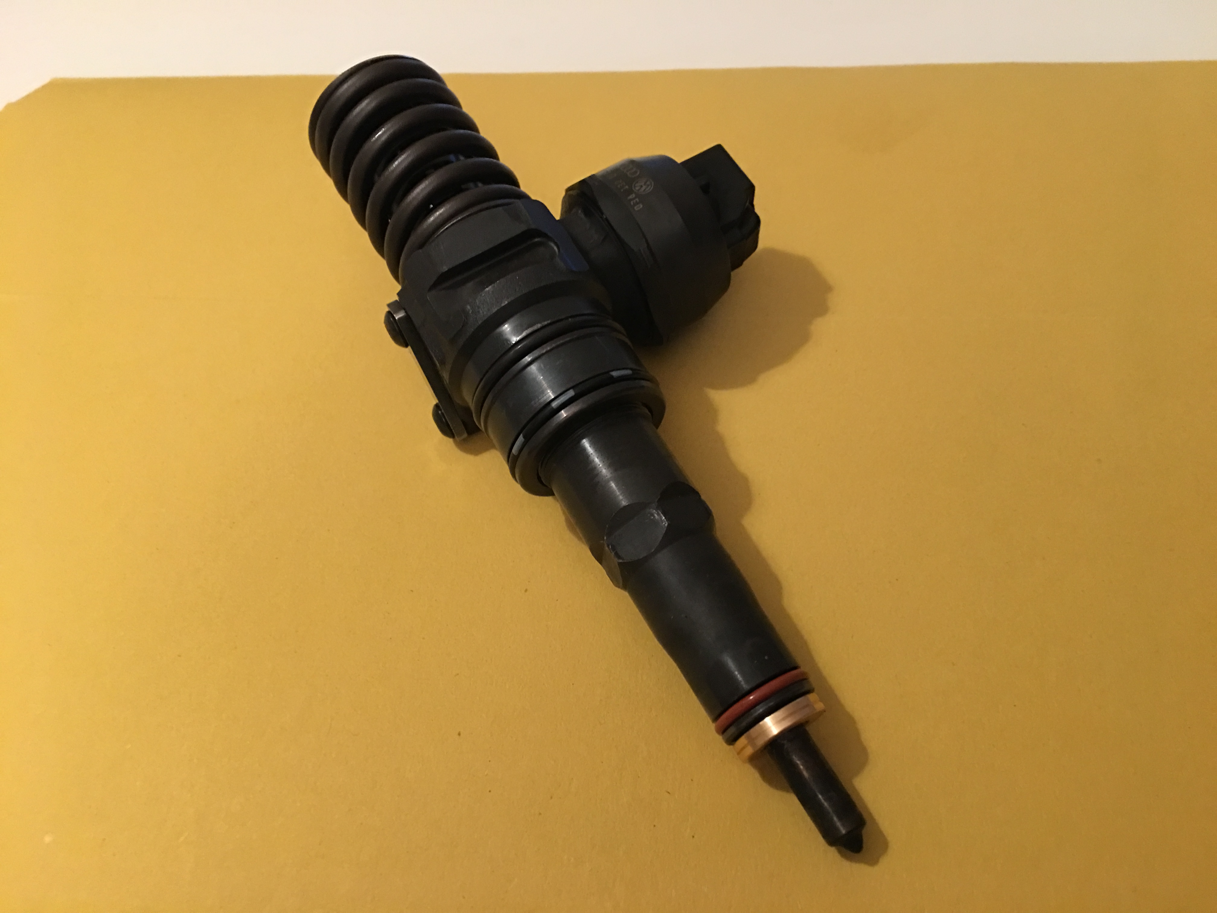

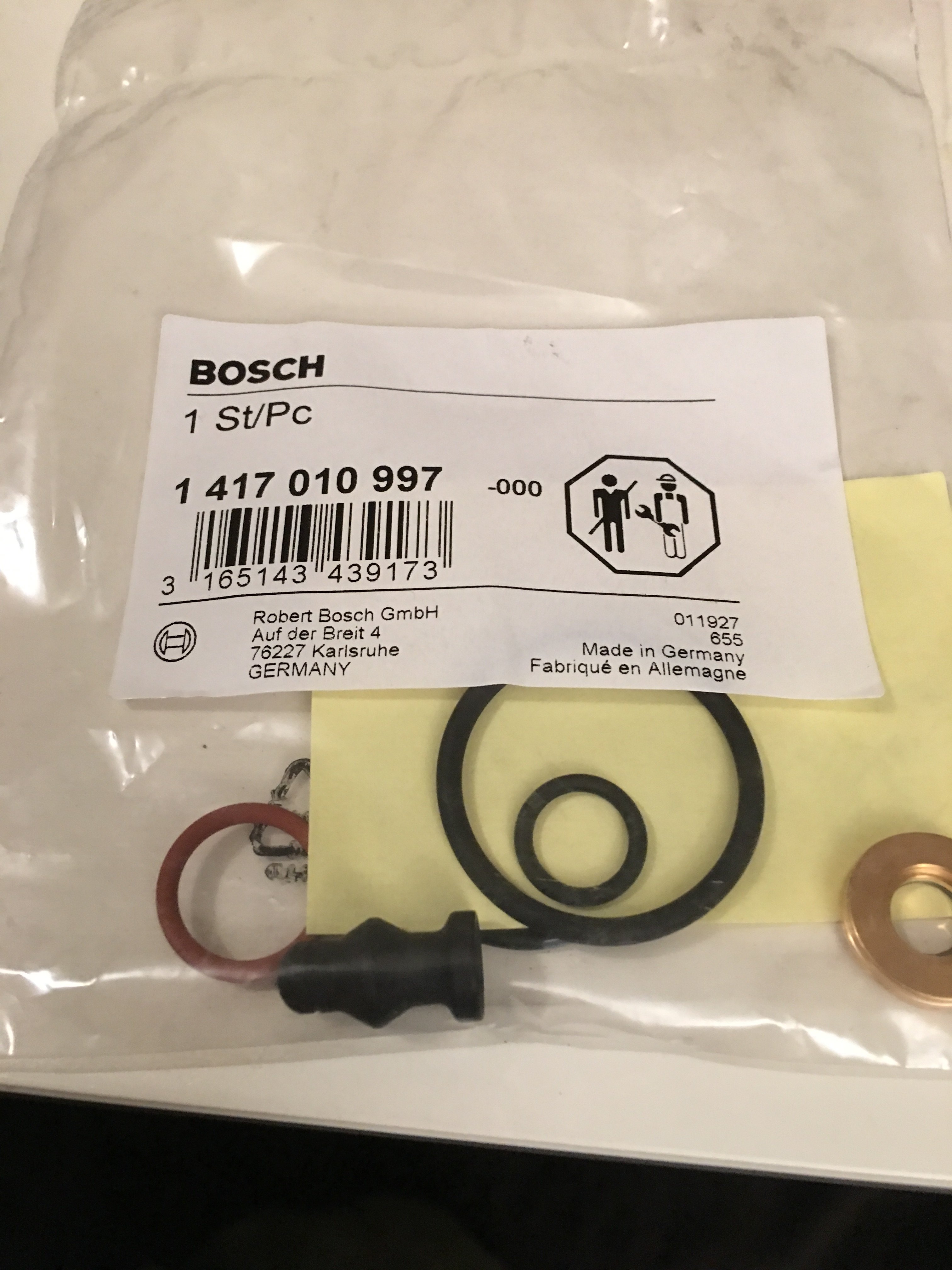

The injectors are are being replaced with a recently built set of DSSR 130% ones, and instead of just chucking them in I ought to replace the seals on them.
Now the genuine Bosch seals are easy enough to source, the factory recommends fitting them with the proper installation tools which saves the seals getting nicked or twisted which would be bad news..
Bosch seals
Laser kit.
And all done

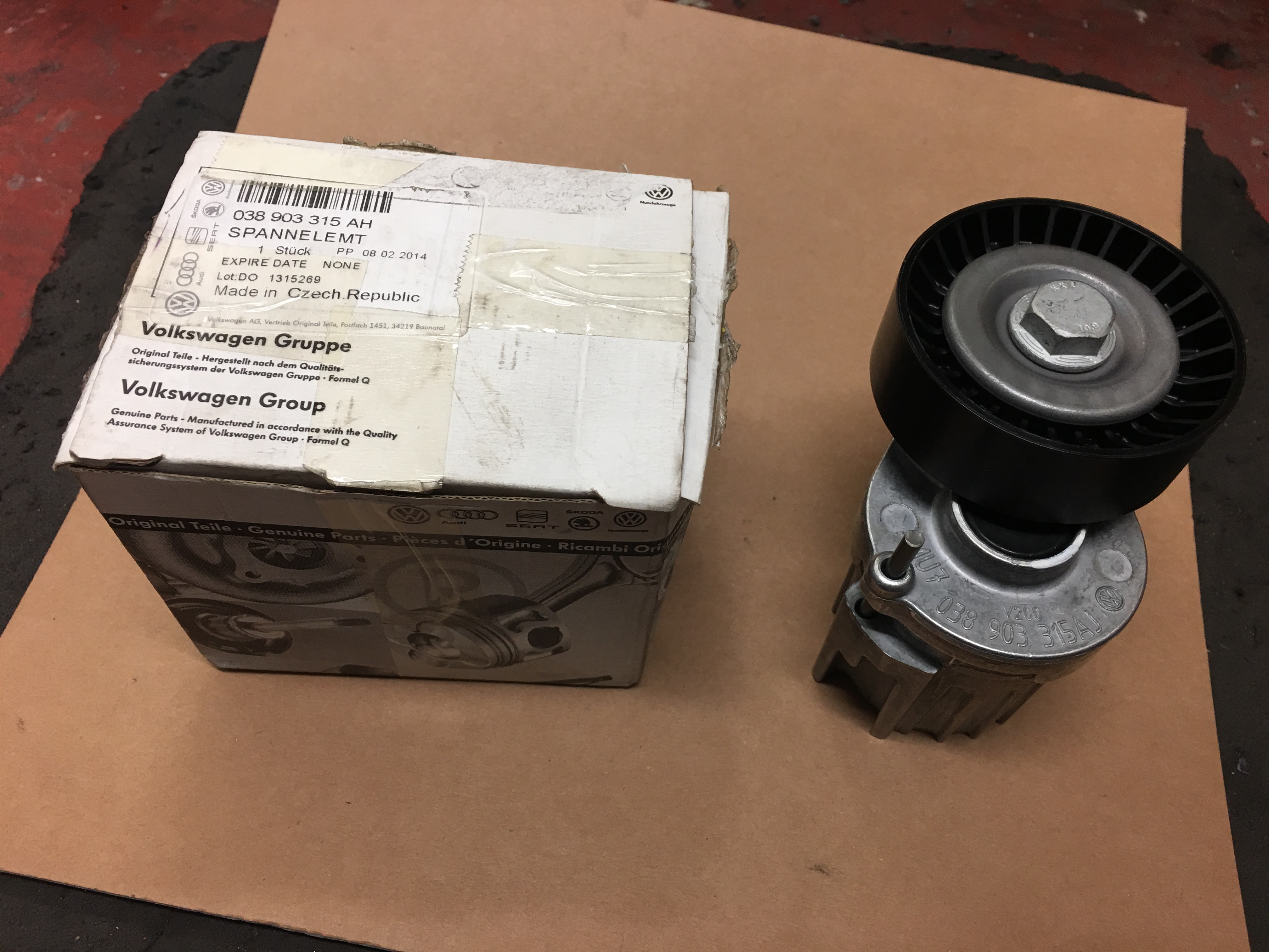

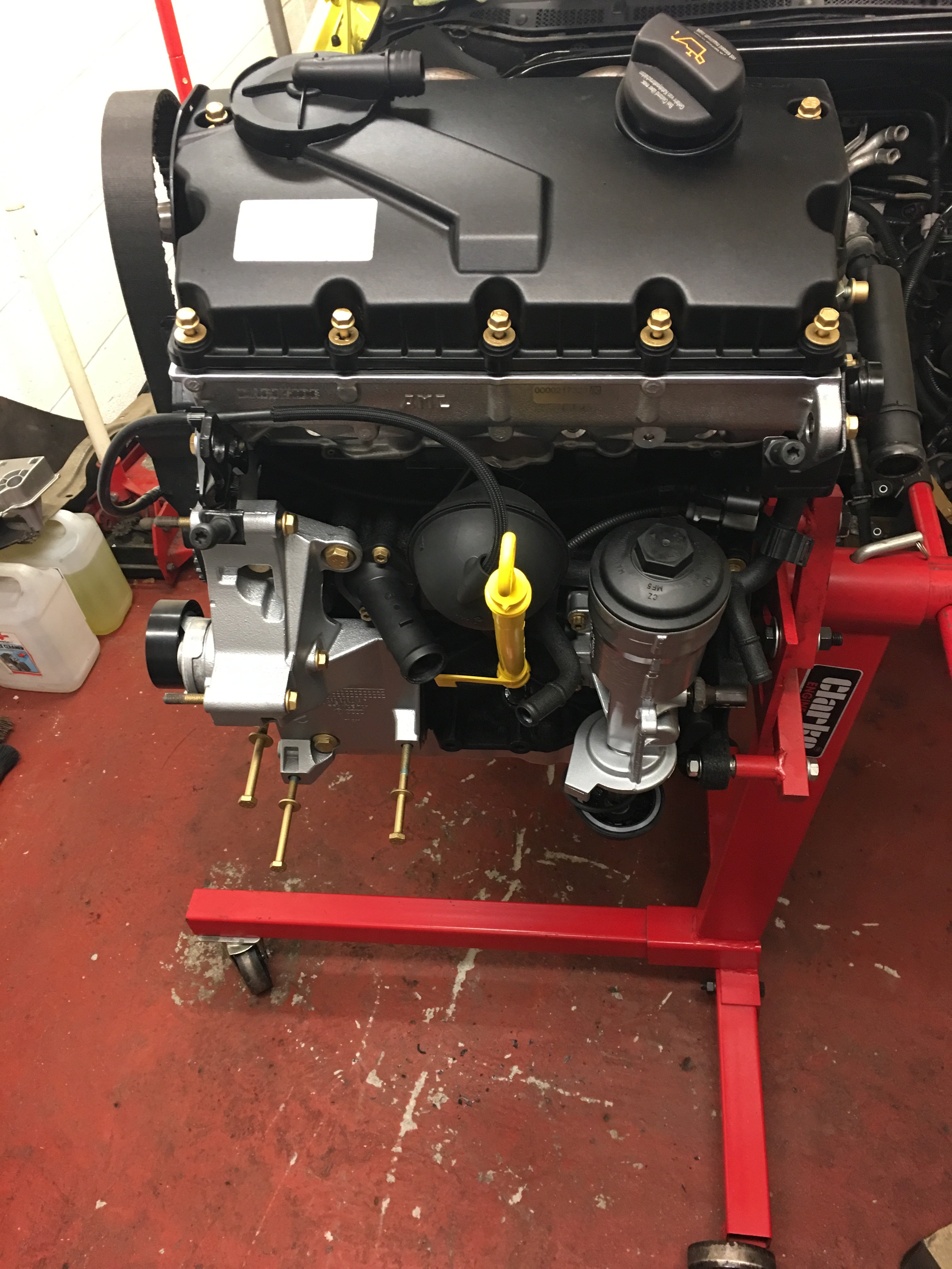

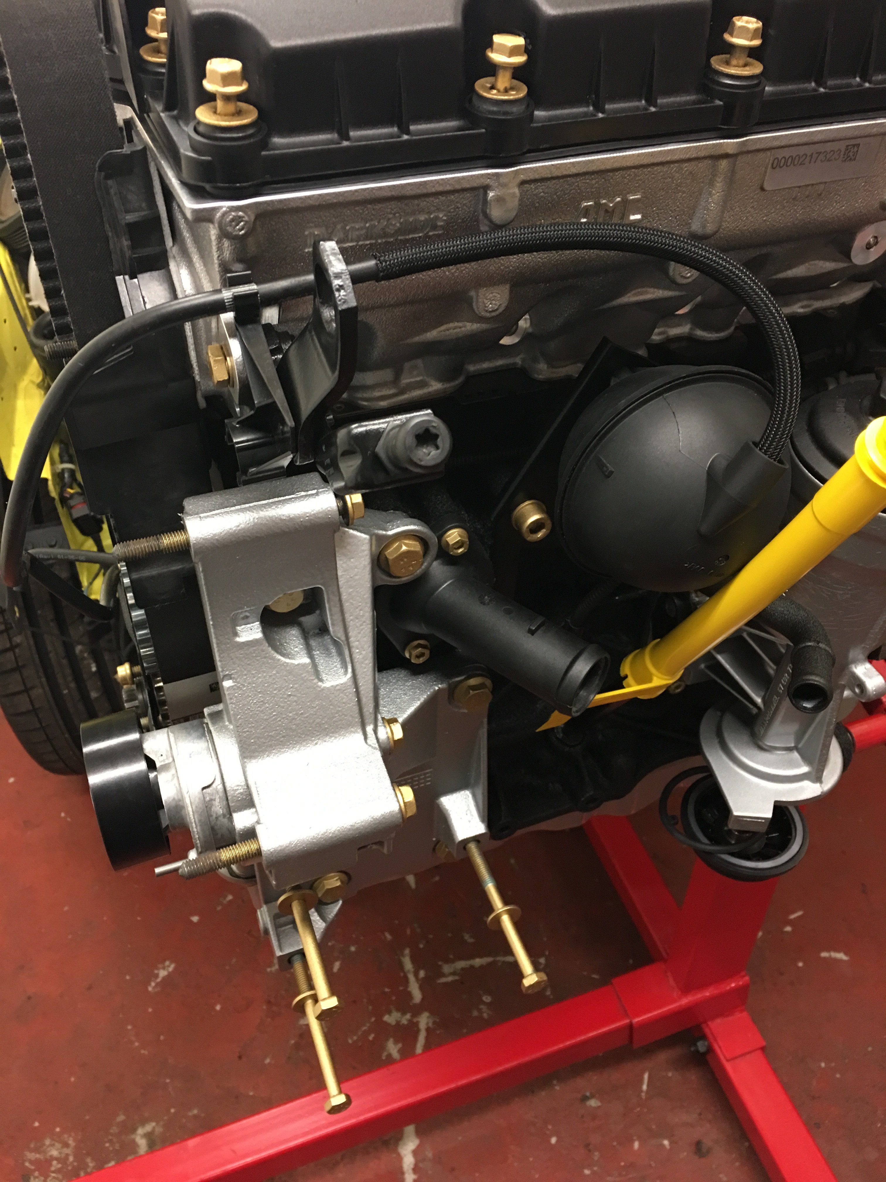

Got the ancillaries carrier finished and fitted, along with the dipstick tube and new genuine auxiliary belt tensioner that I forgot I had...

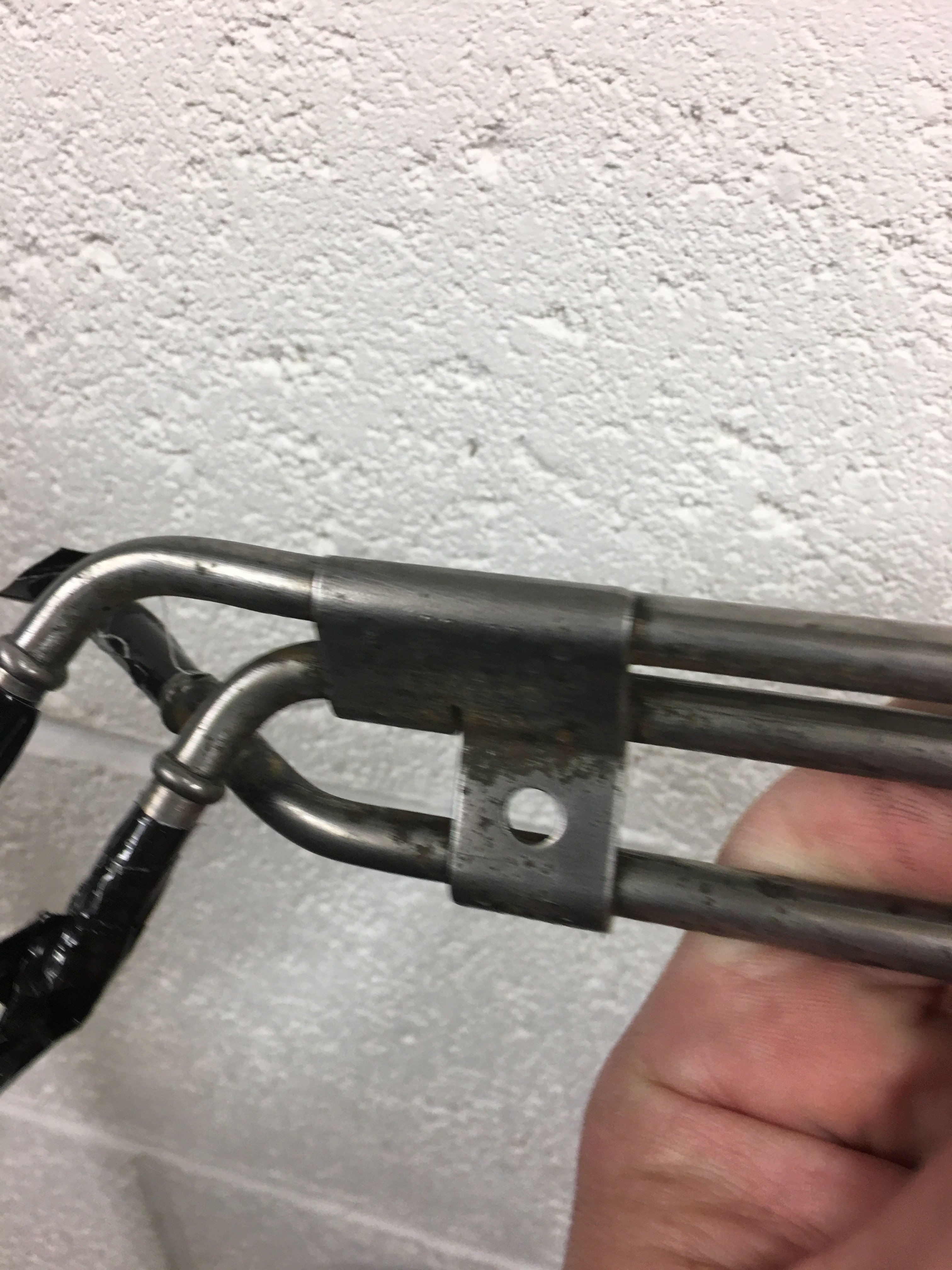

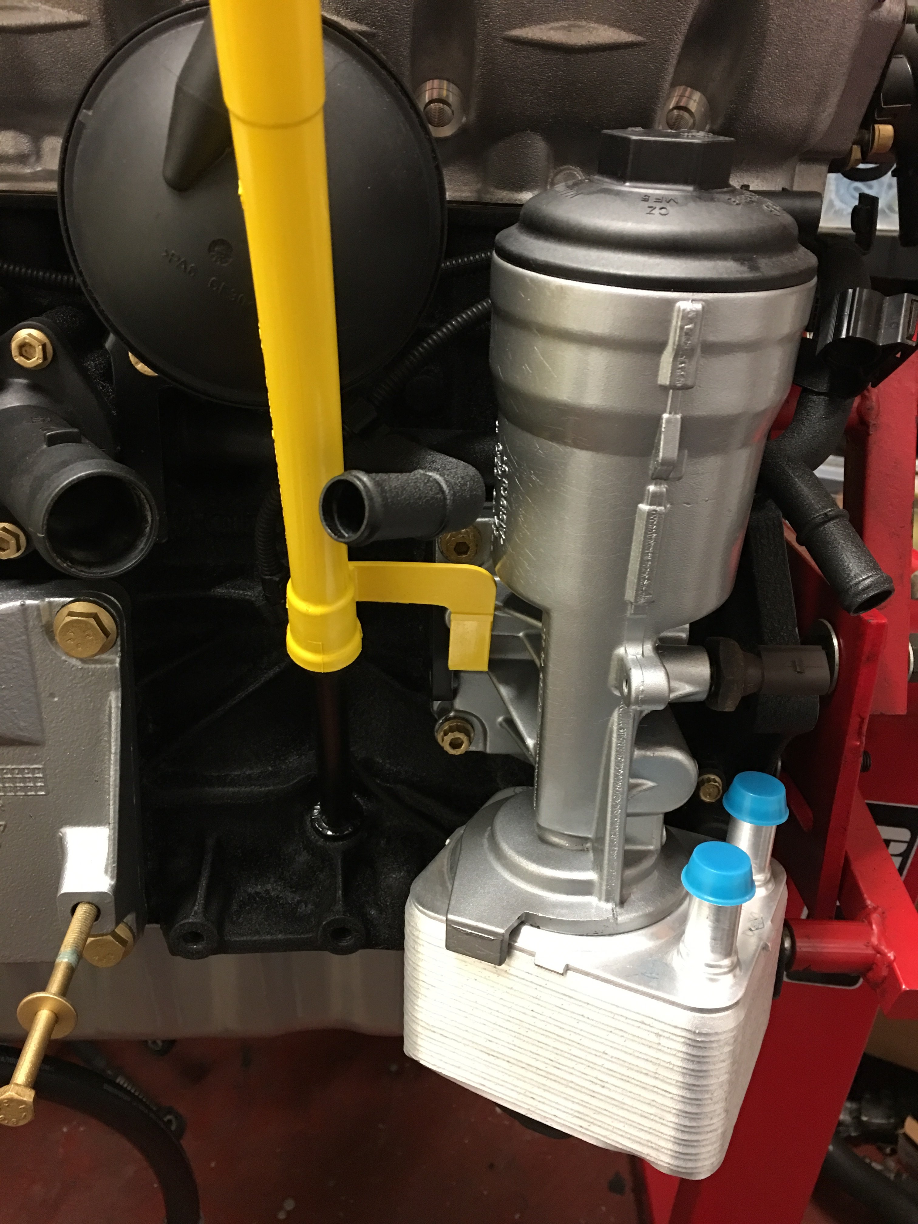

The postman should be delivering the new oil cooler tomorrow and as you can see the new seals are in place ready.
Another trip to TPS tomorrow will see the cam carrier bolts collected and I'll order up the new water hoses I'll need.
Need to to do something with the air con pump and alternator in due course, then the front of the engine is near completion.
Once the cams timed timed up I can get the new covers on then turn my attention to the turbo side.

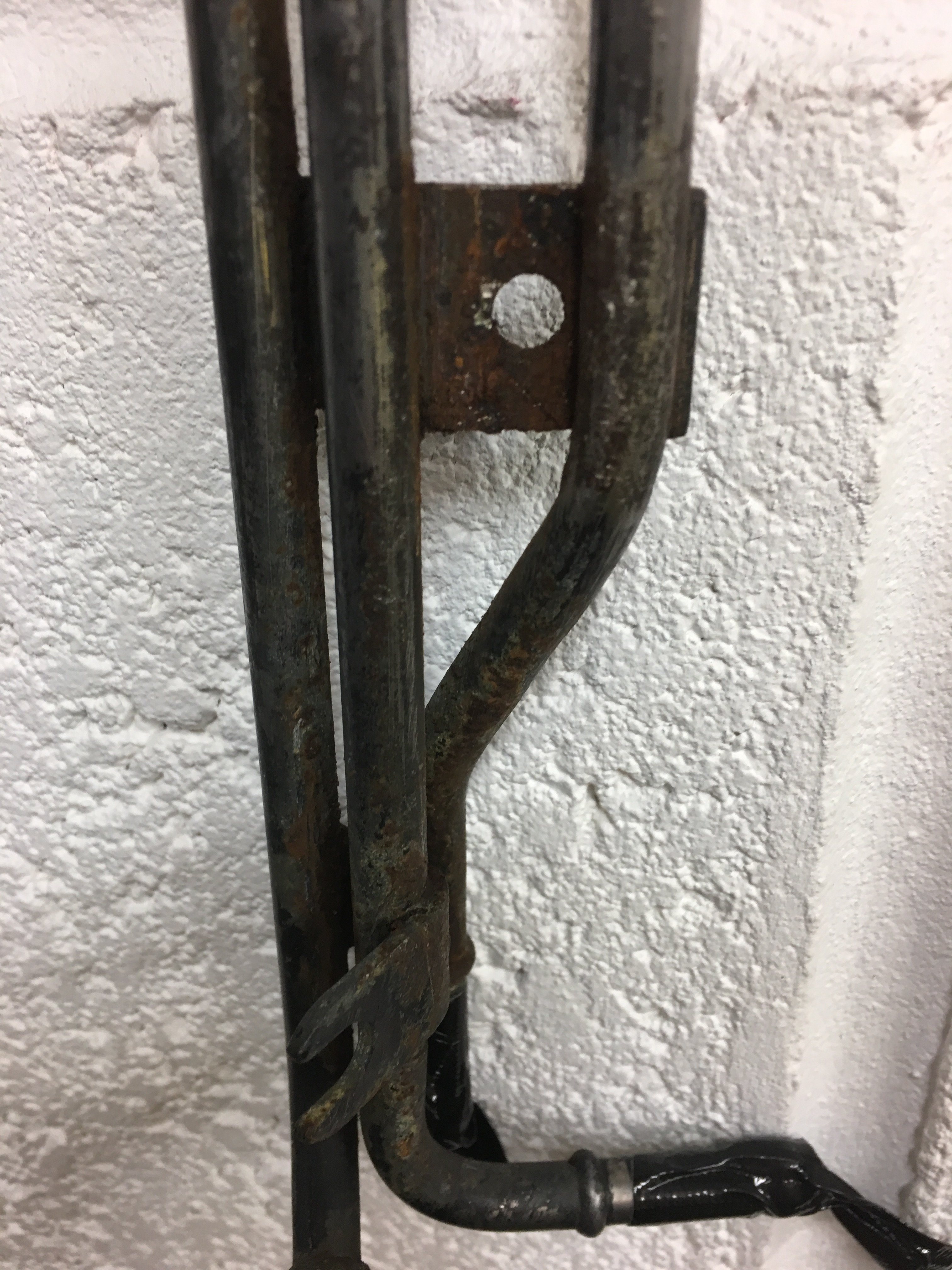

Just noticed the dipstick tube is the wrong way round... bo11ocks!!!!
I have left mine that way as mine wouldn't swivel round the other way because of the tab
Oil cooler fitted and dipstick tube realigned the correct way
Looking extremely good!!! And probably cleaner than new. Are you going to be fiting a aftermarket oil cooler to?

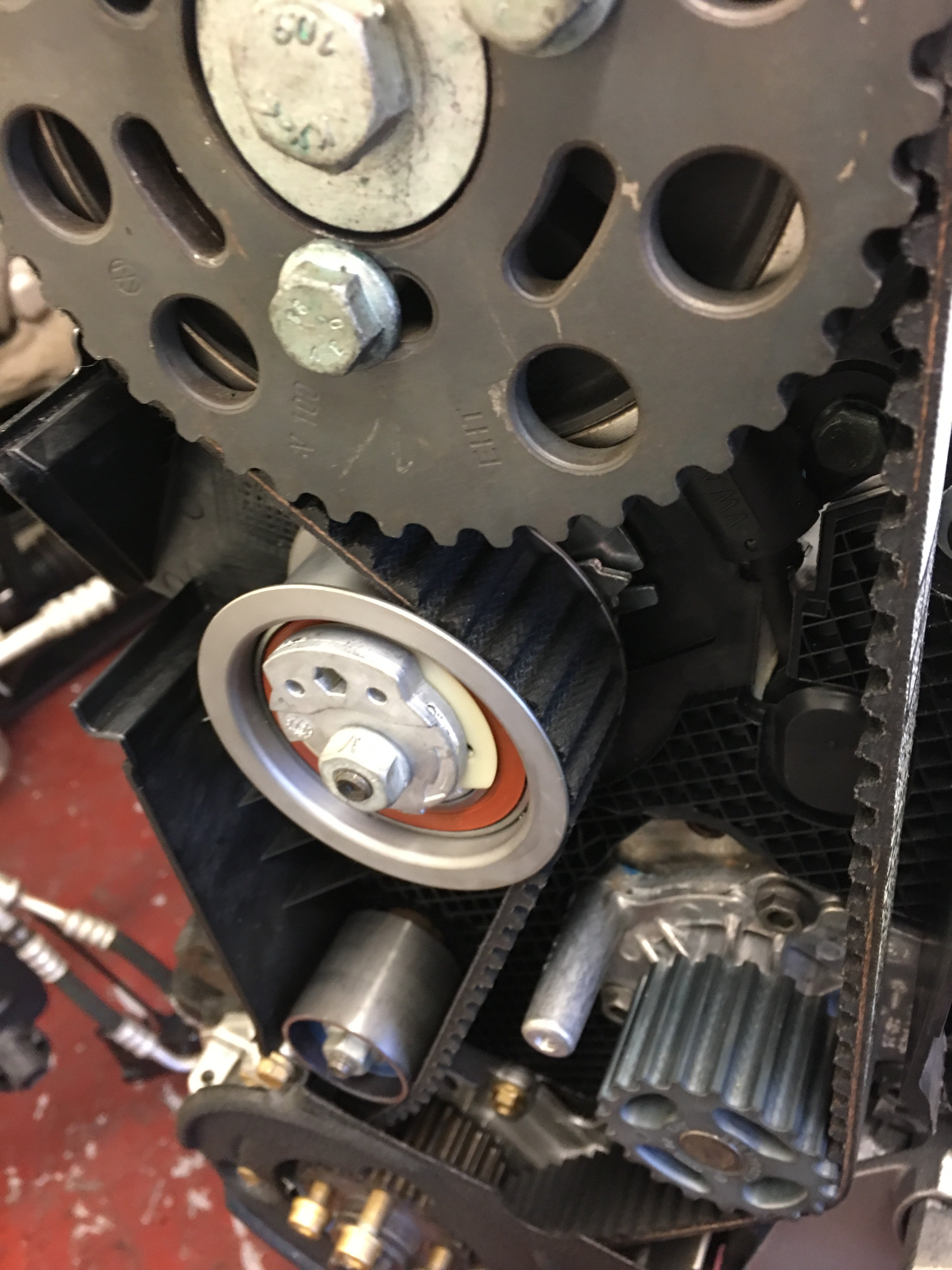

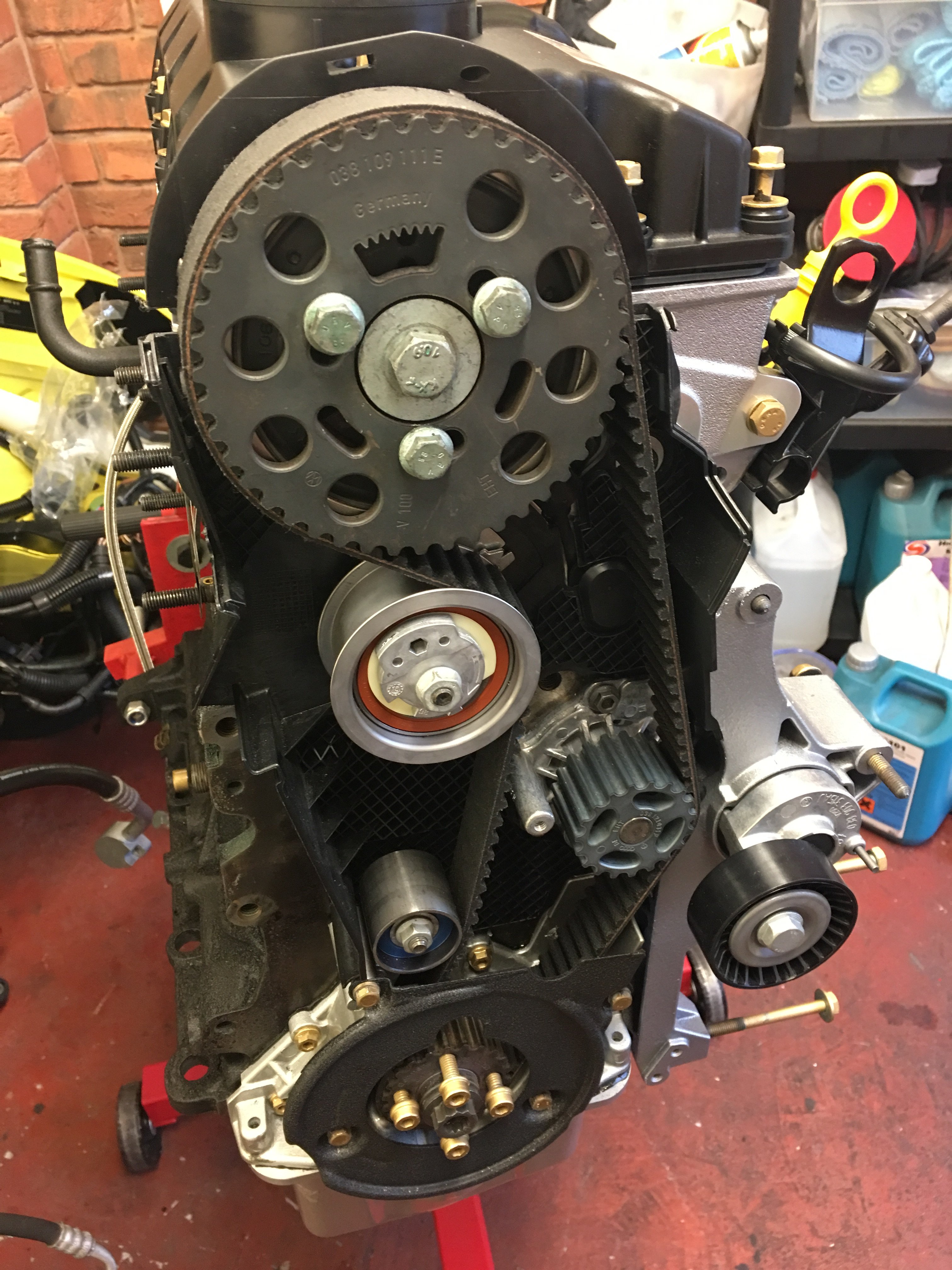

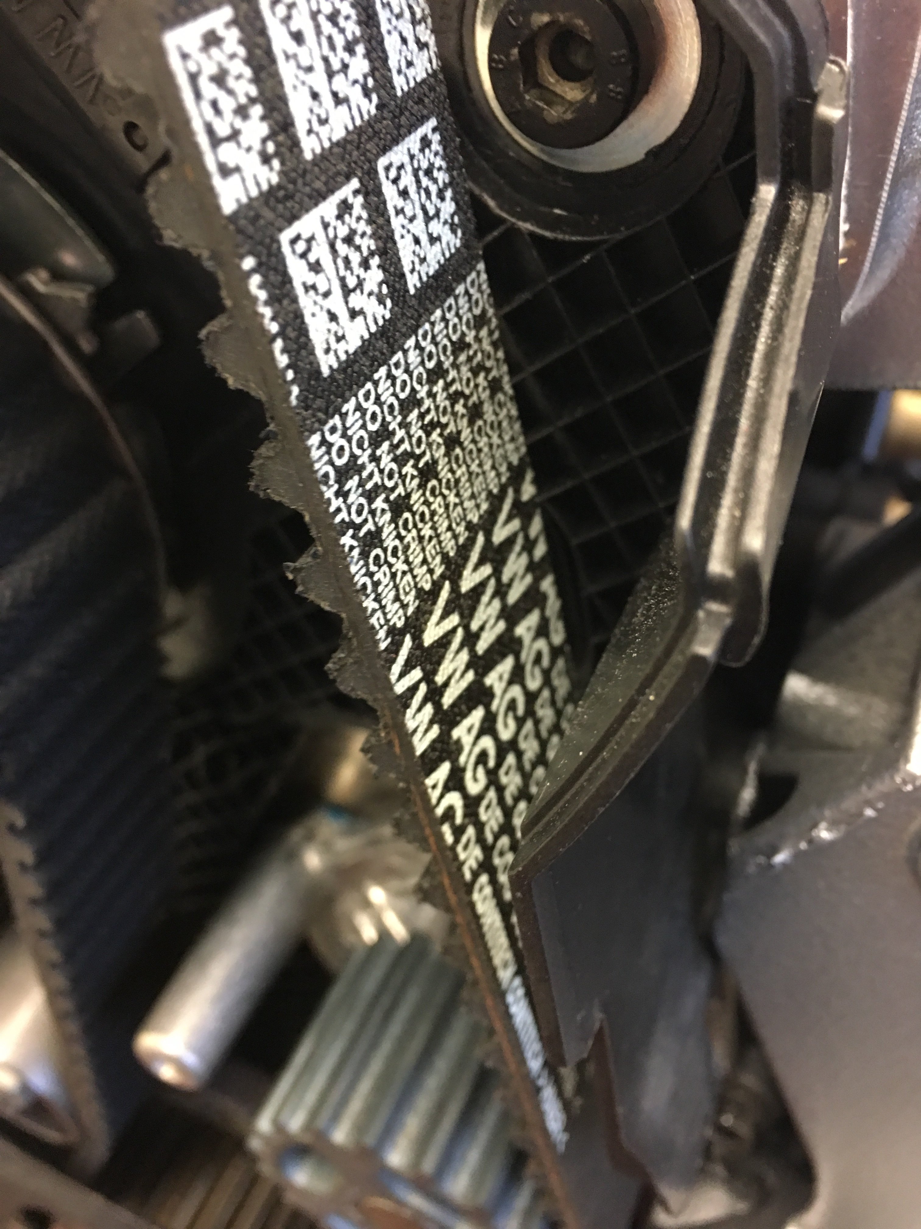

The new VW cam carrier bolts arrived so last night we fitted the cam and then the the genuine VW cambelt kit also fitted and timed up spot on.

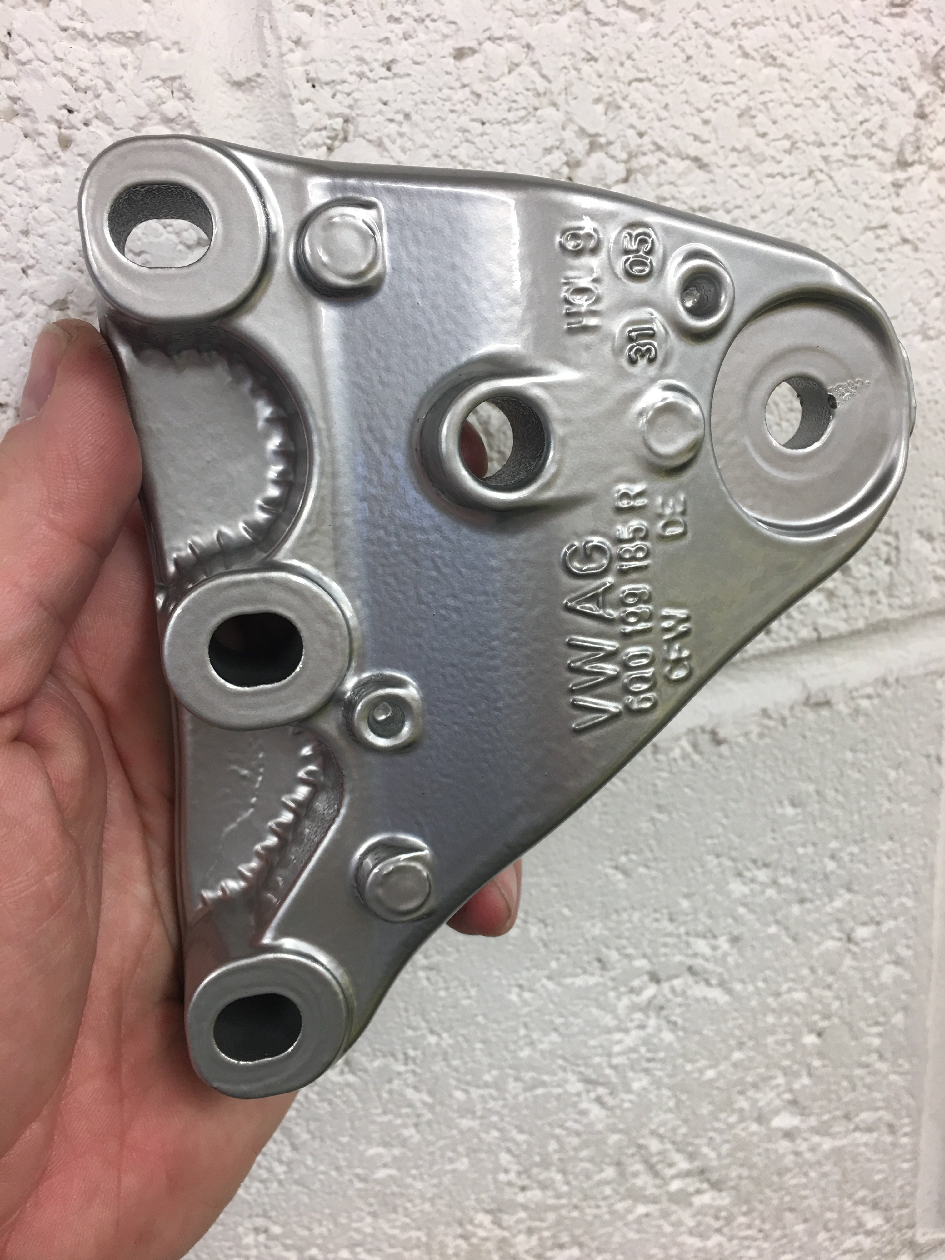

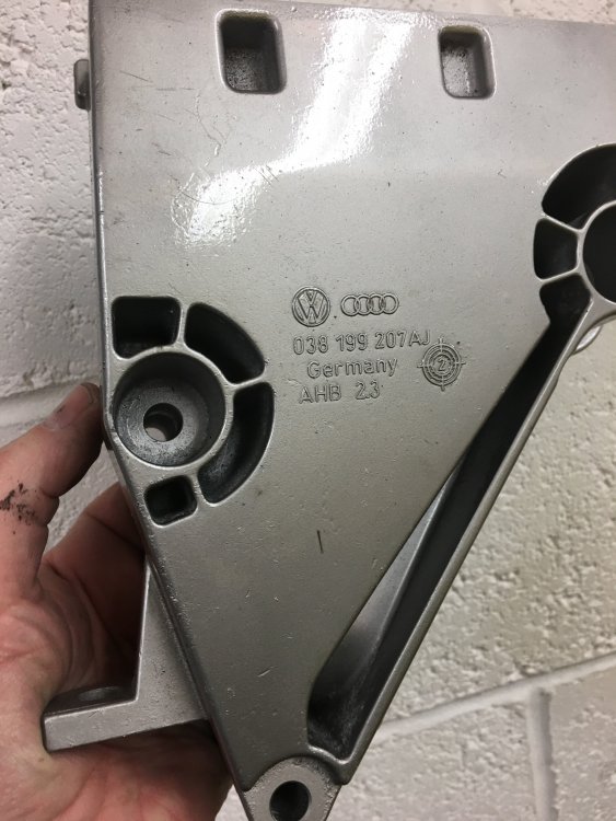

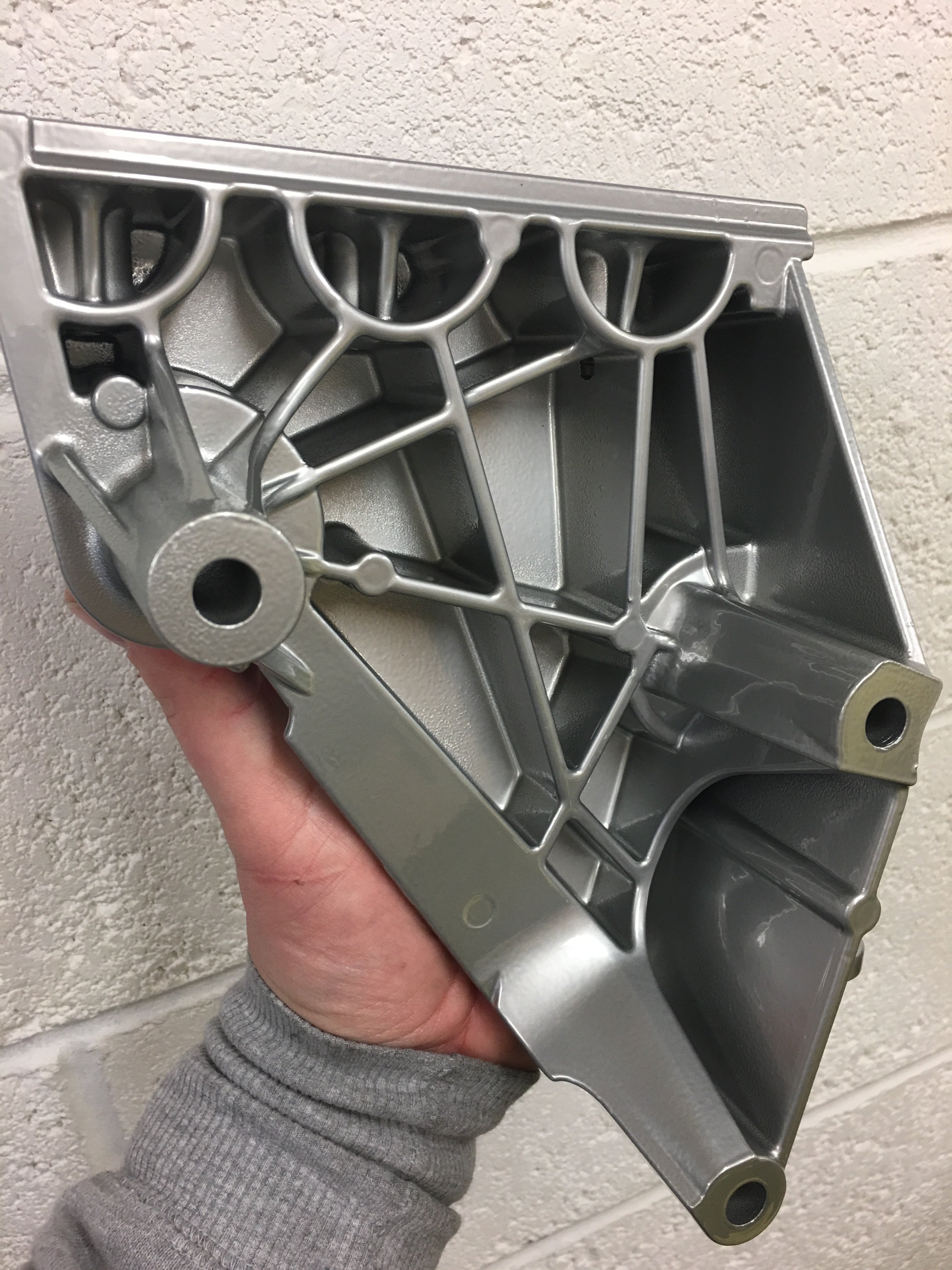

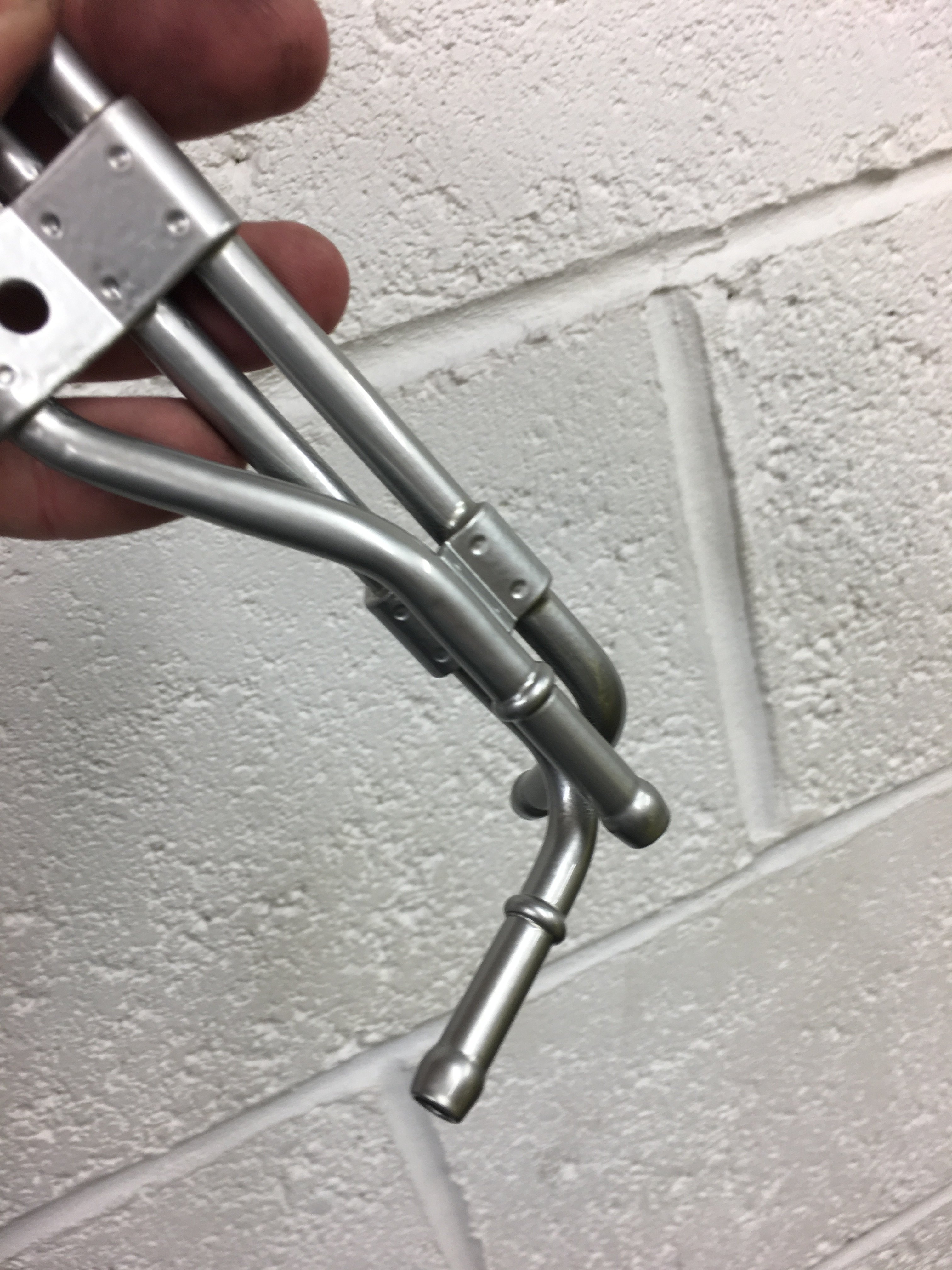

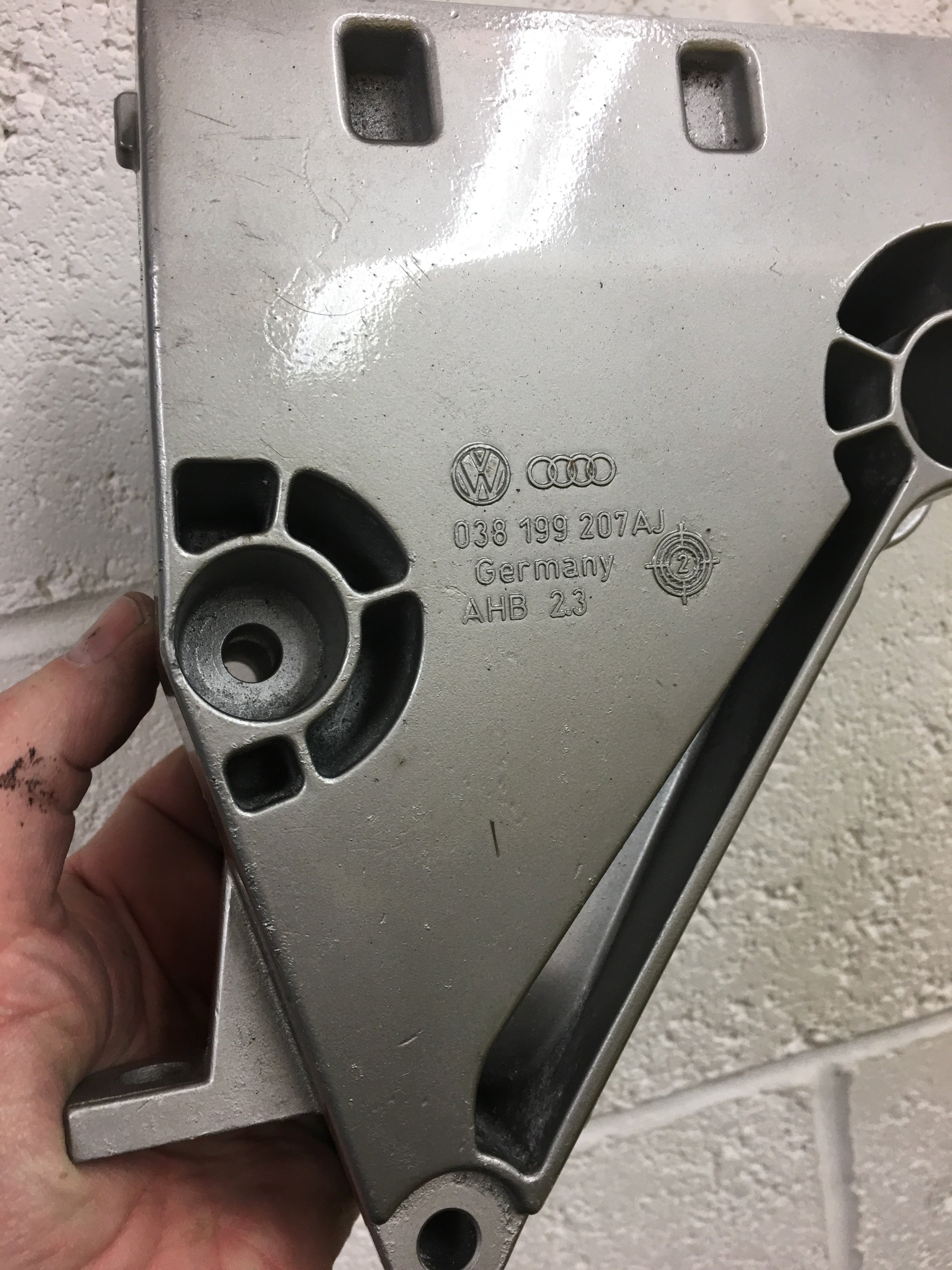

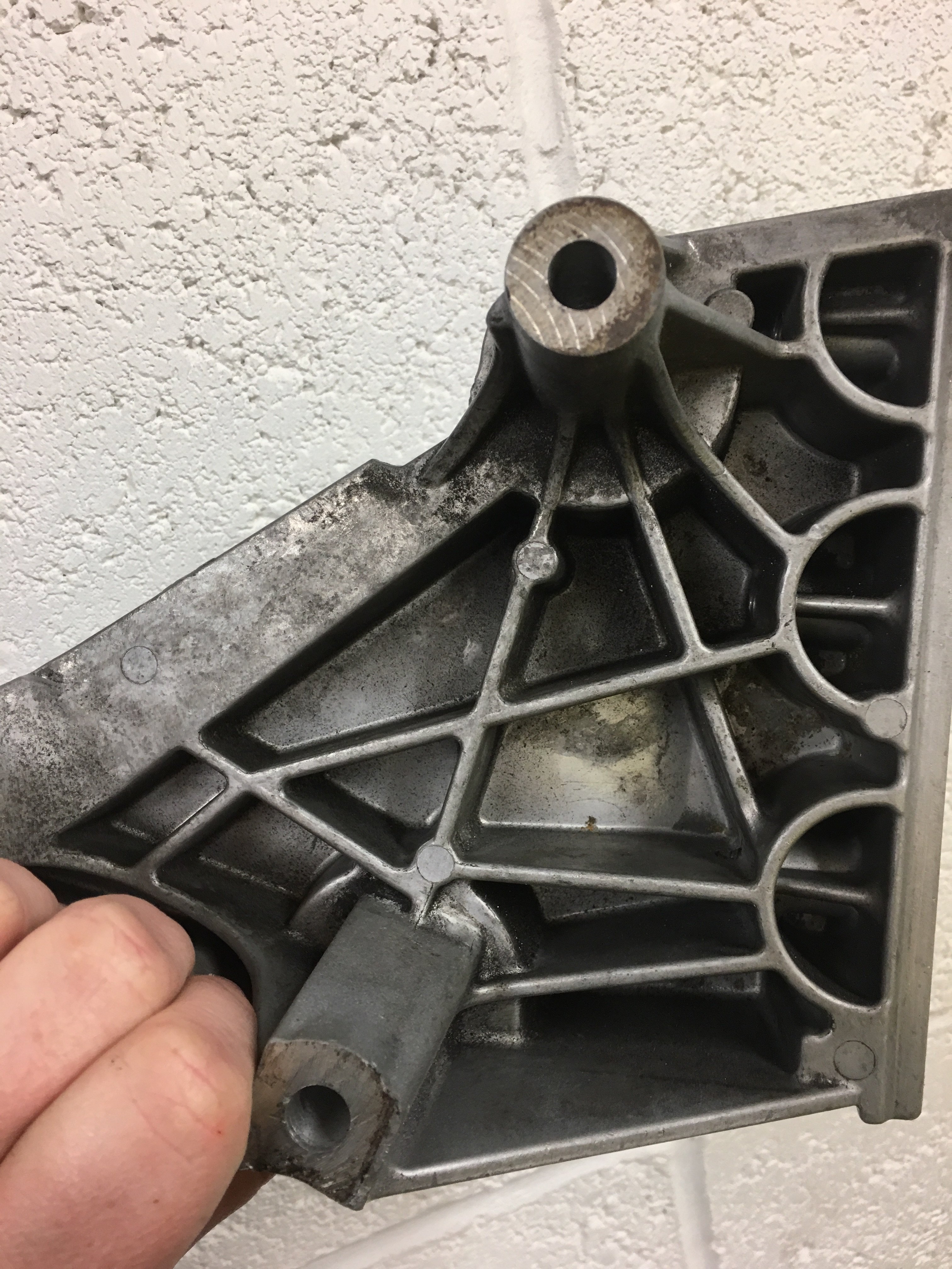

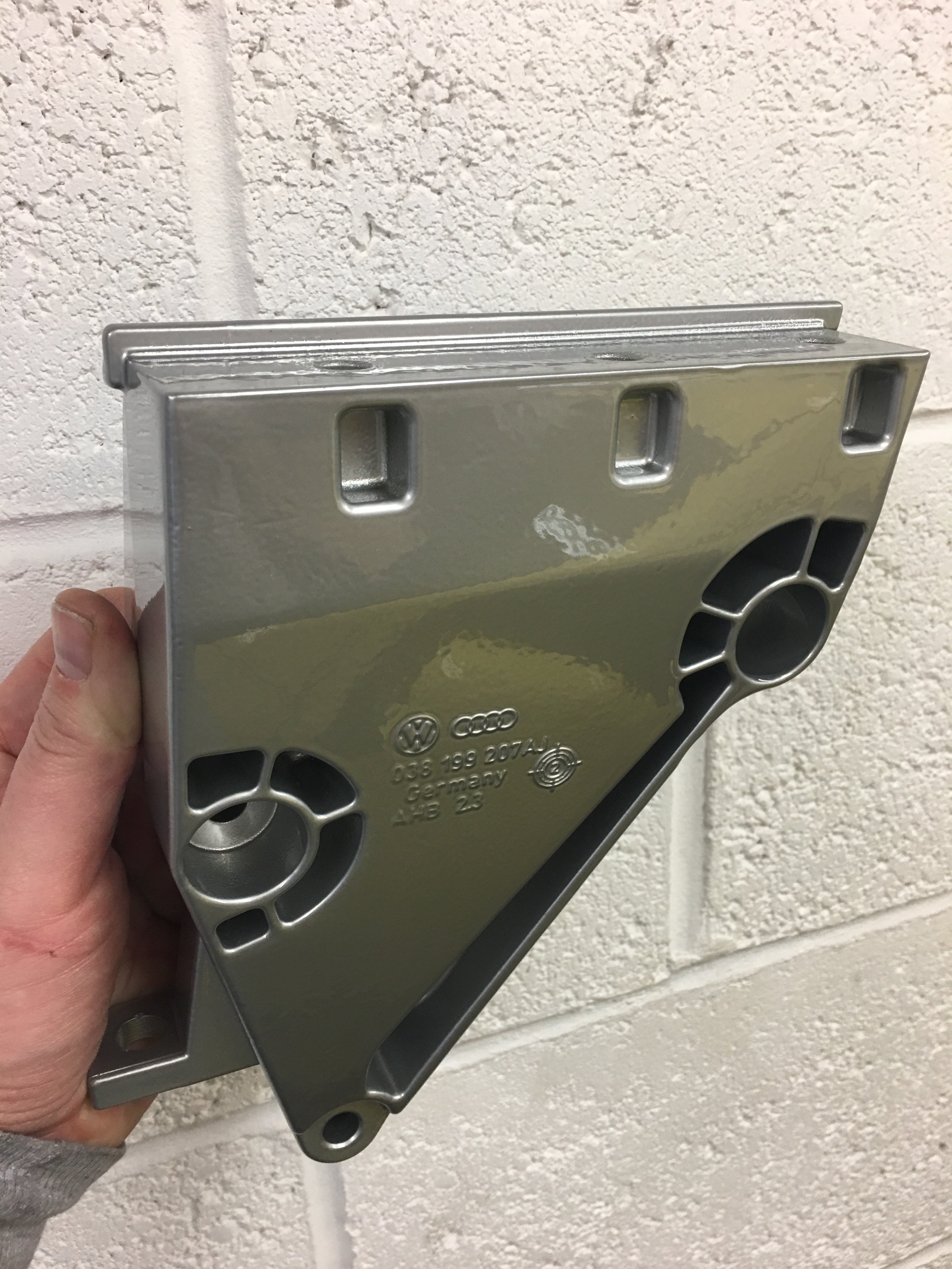

Some parts have been dropped into Bournes powdercoating in Birmingham who do the intricate stuff for me and I've picked those up today as well.

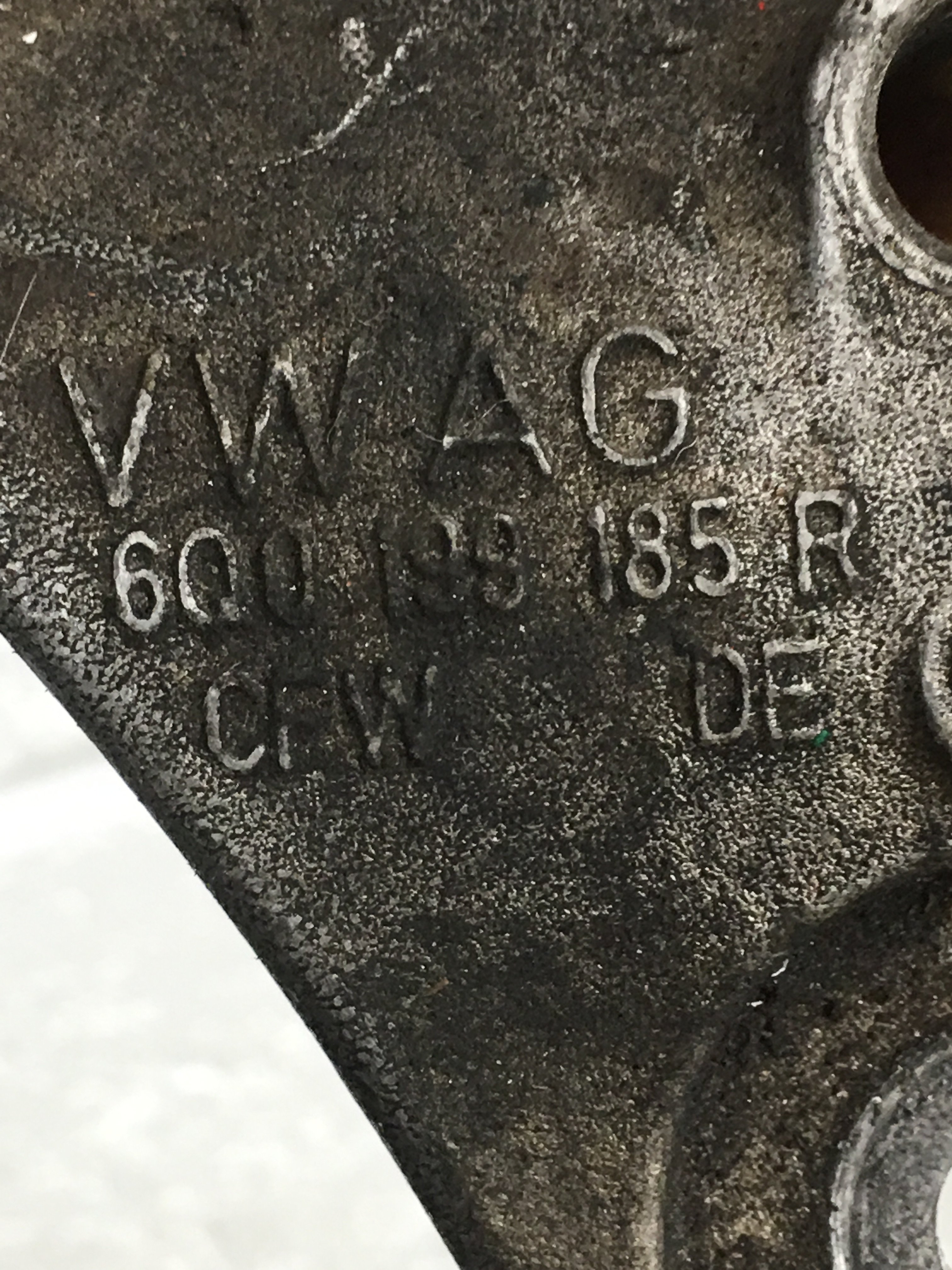

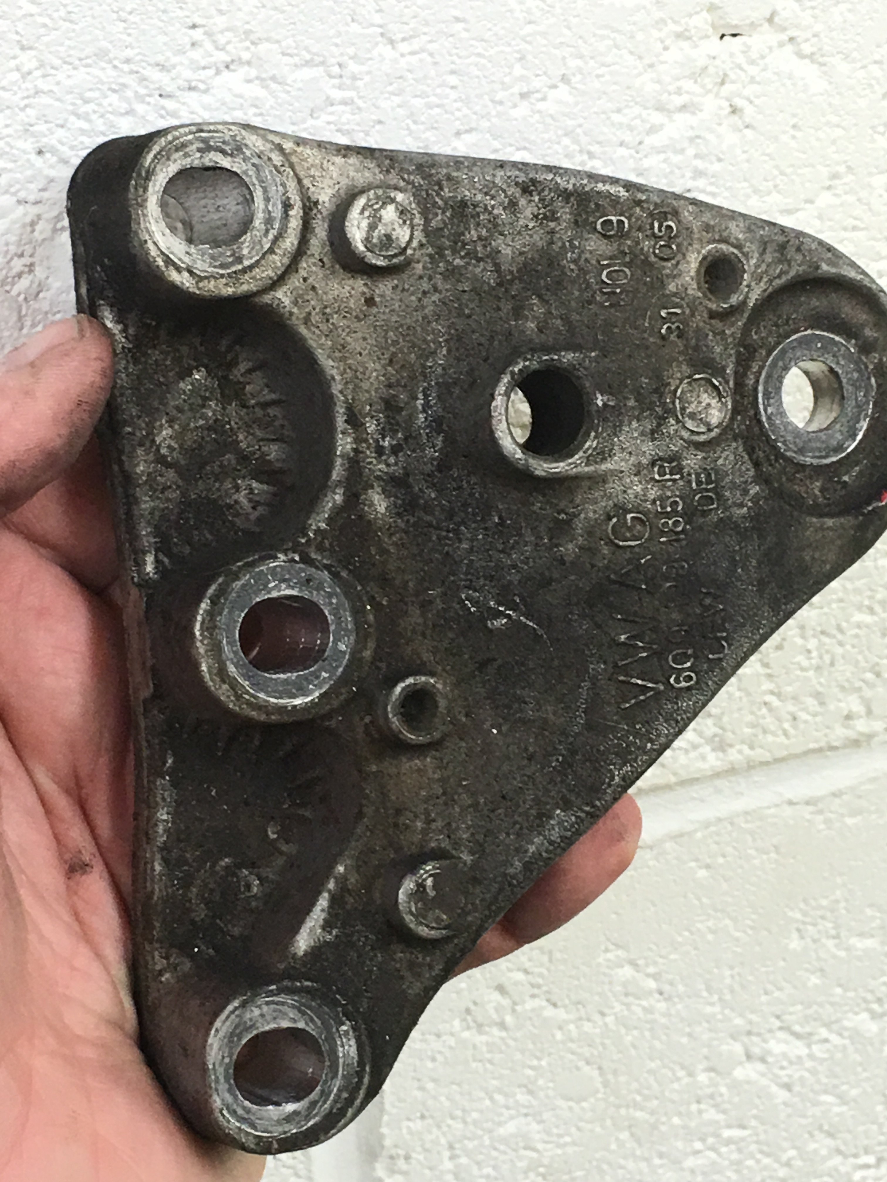

The engine mounting triangular bracket...
and after..

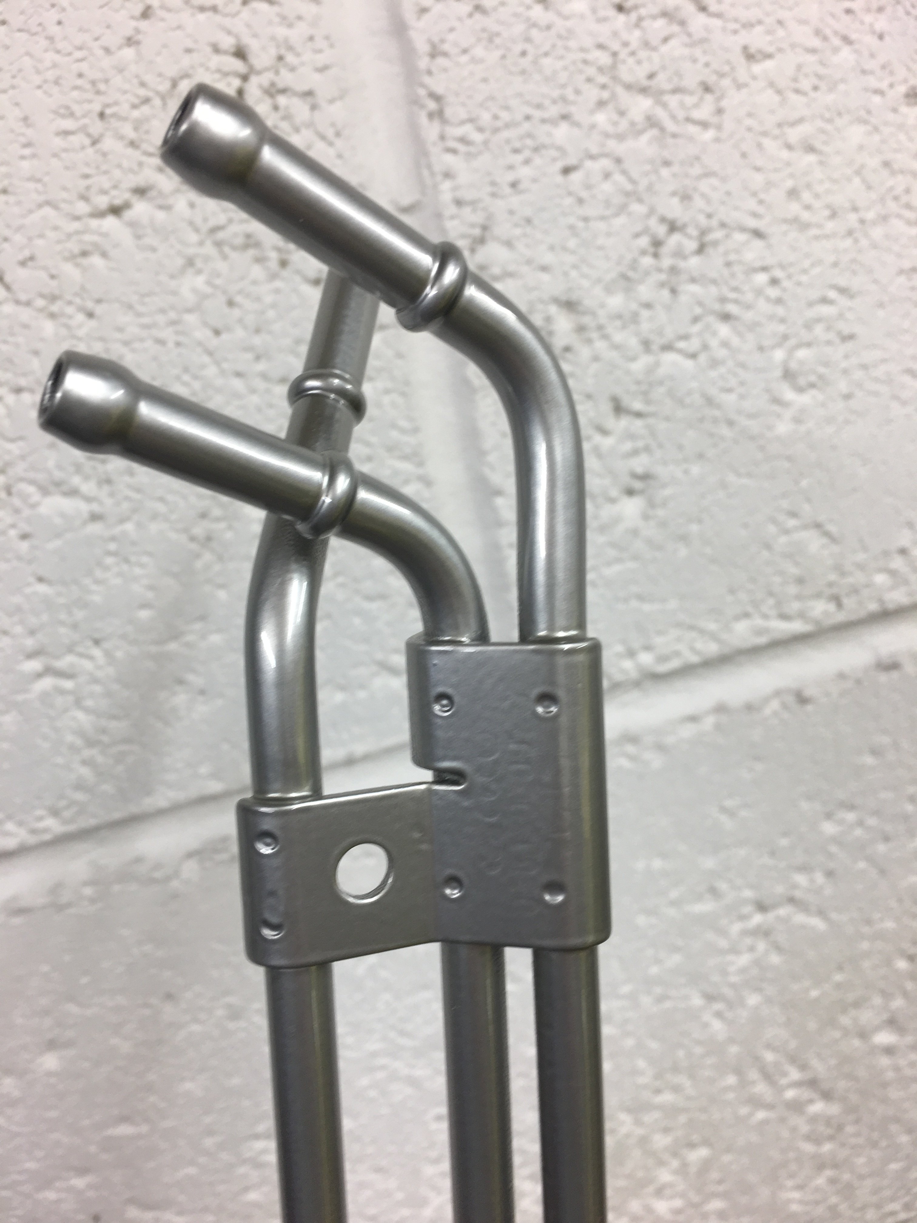

The fuel rail before..
and after..
How are you planning on attaching the fasteners to the engine mounting parts? I had mine coated previously, and as soon as you start to tighten the bolts, the coating started to crack around that area. Maybe worth popping a nylon washer under all the bolts/nuts...
I'll prob use a washer of some sort Alex, I'll have to look into it.

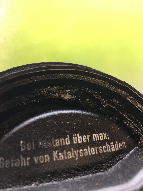

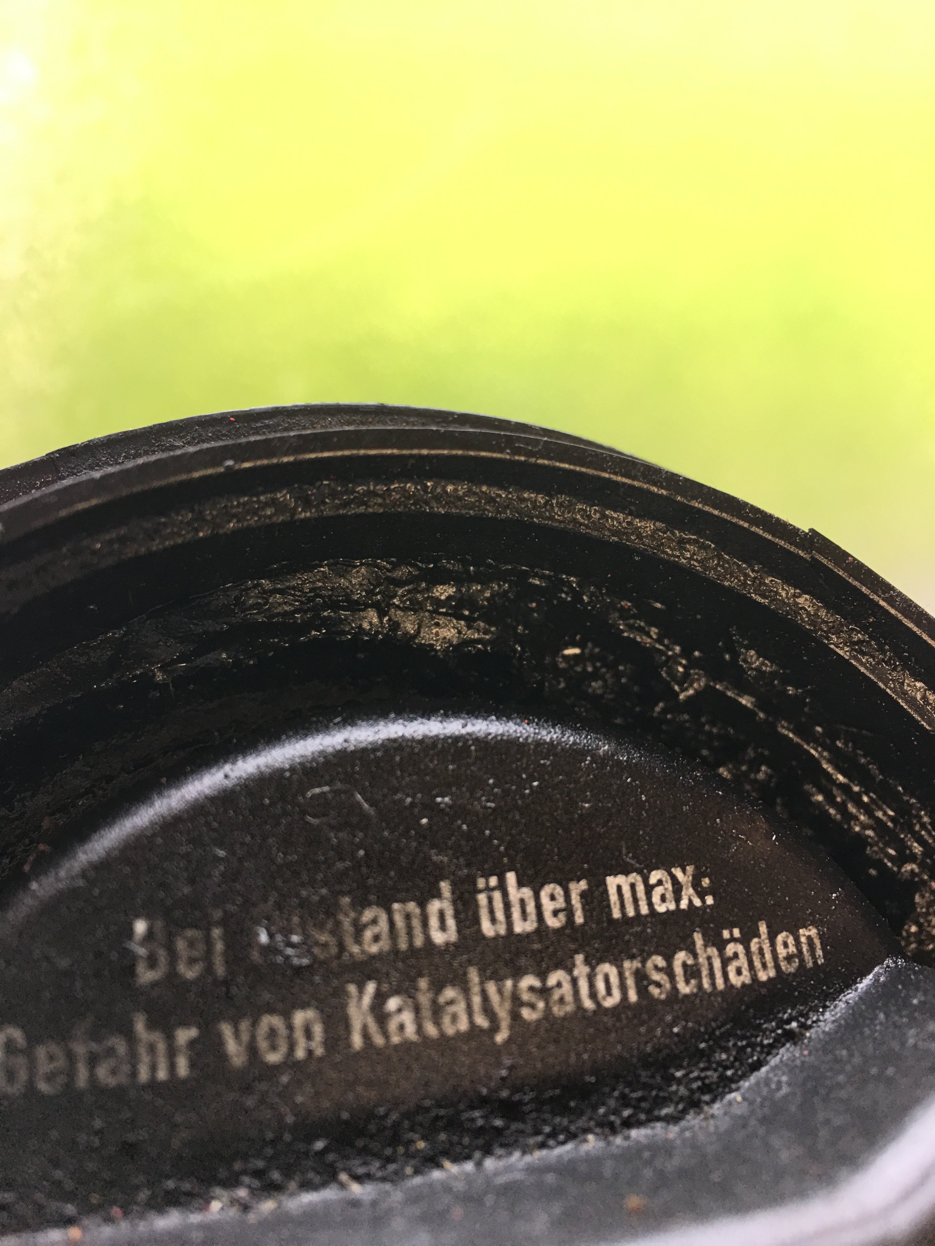

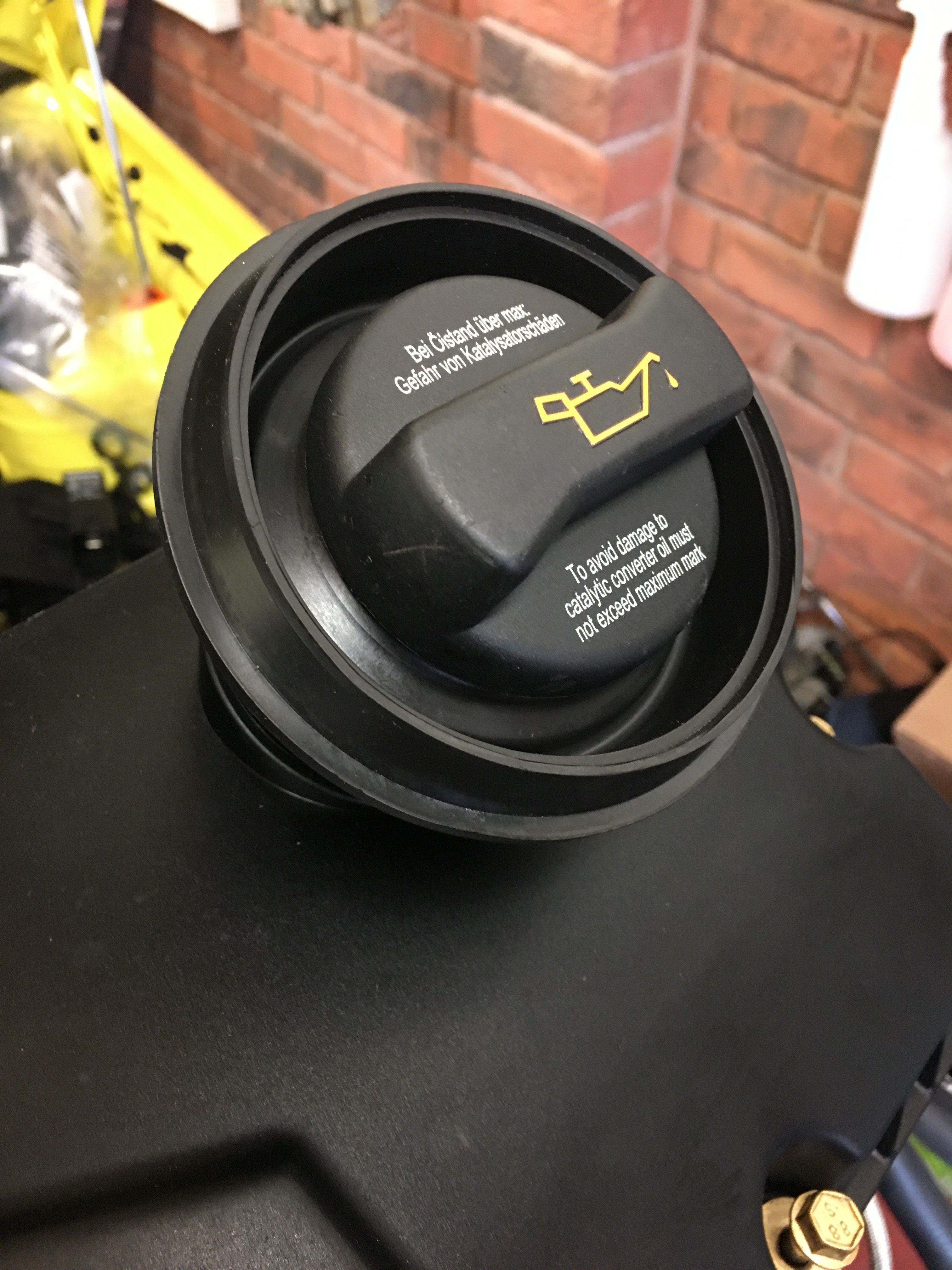

More work done today, fished the oil filler neck extension off the donor engine and was disgusted at the state of it..
A thorough clean, new seal for the neck and the actual filler cap and it looks much better.

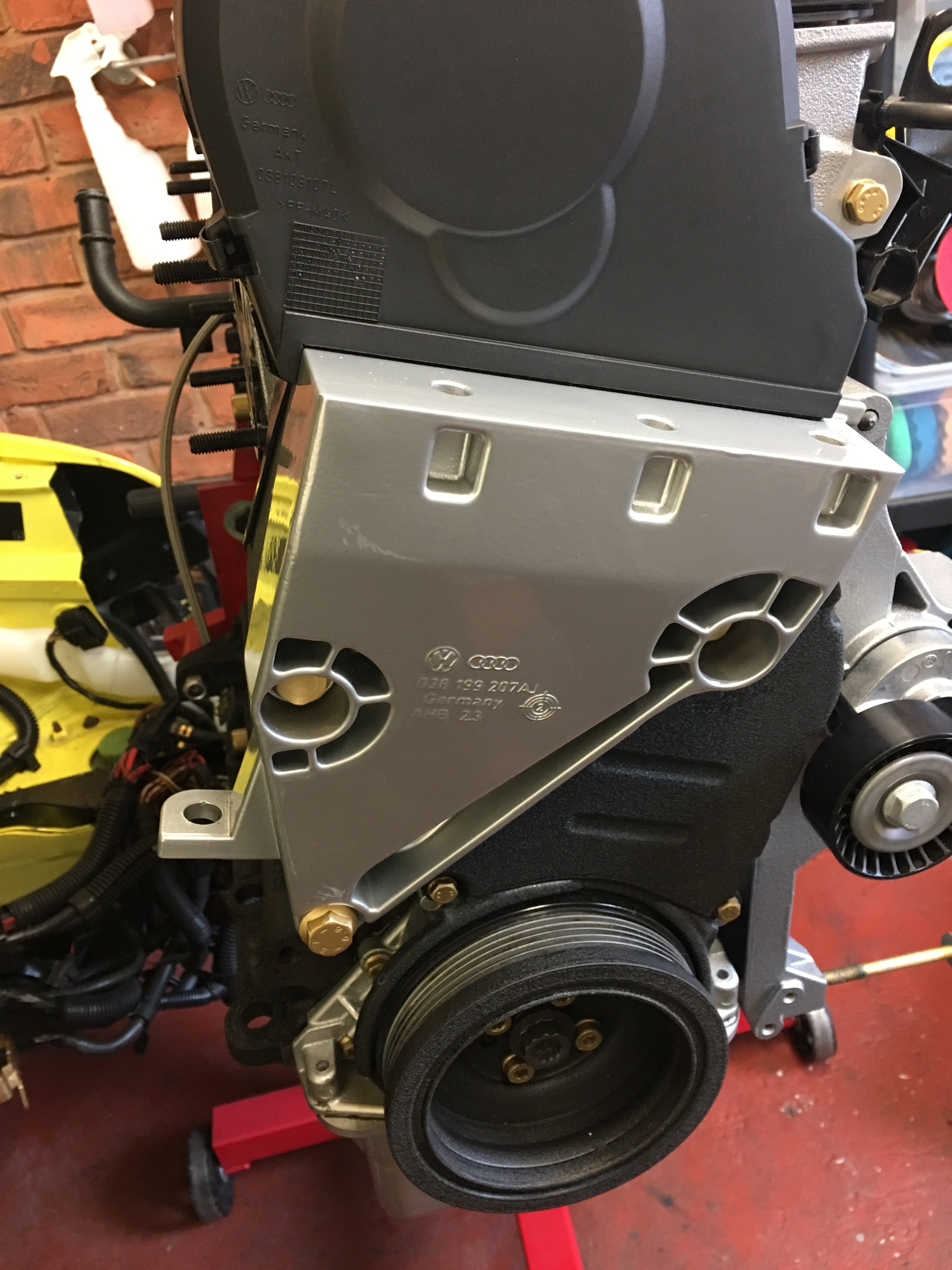

Fitted the powdercoated triangular engine mount support and middle cambelt cover and bottom aux belt pulley.

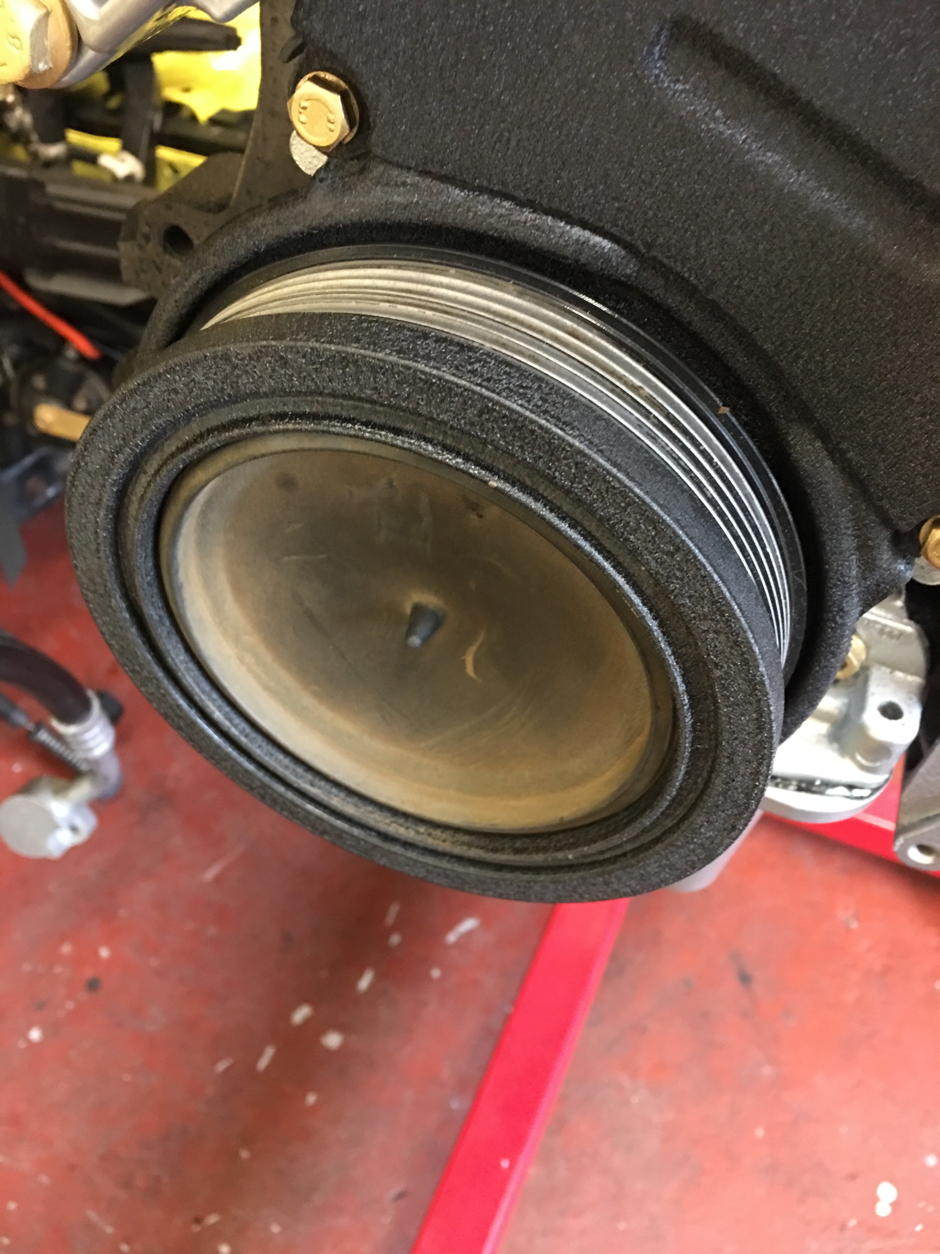

Now the actual bottom pulley is supposed to run a rubber blanking cover in the middle of it, these normally get forgotten about when folks do cambelt changes and they end up in the bin, however there was one on the donor engine and this is how it looked after prolonged cleaning....
The rubber has aged and is now pockmarked and porous so I've popped it back out and will have to source a new one from TPS

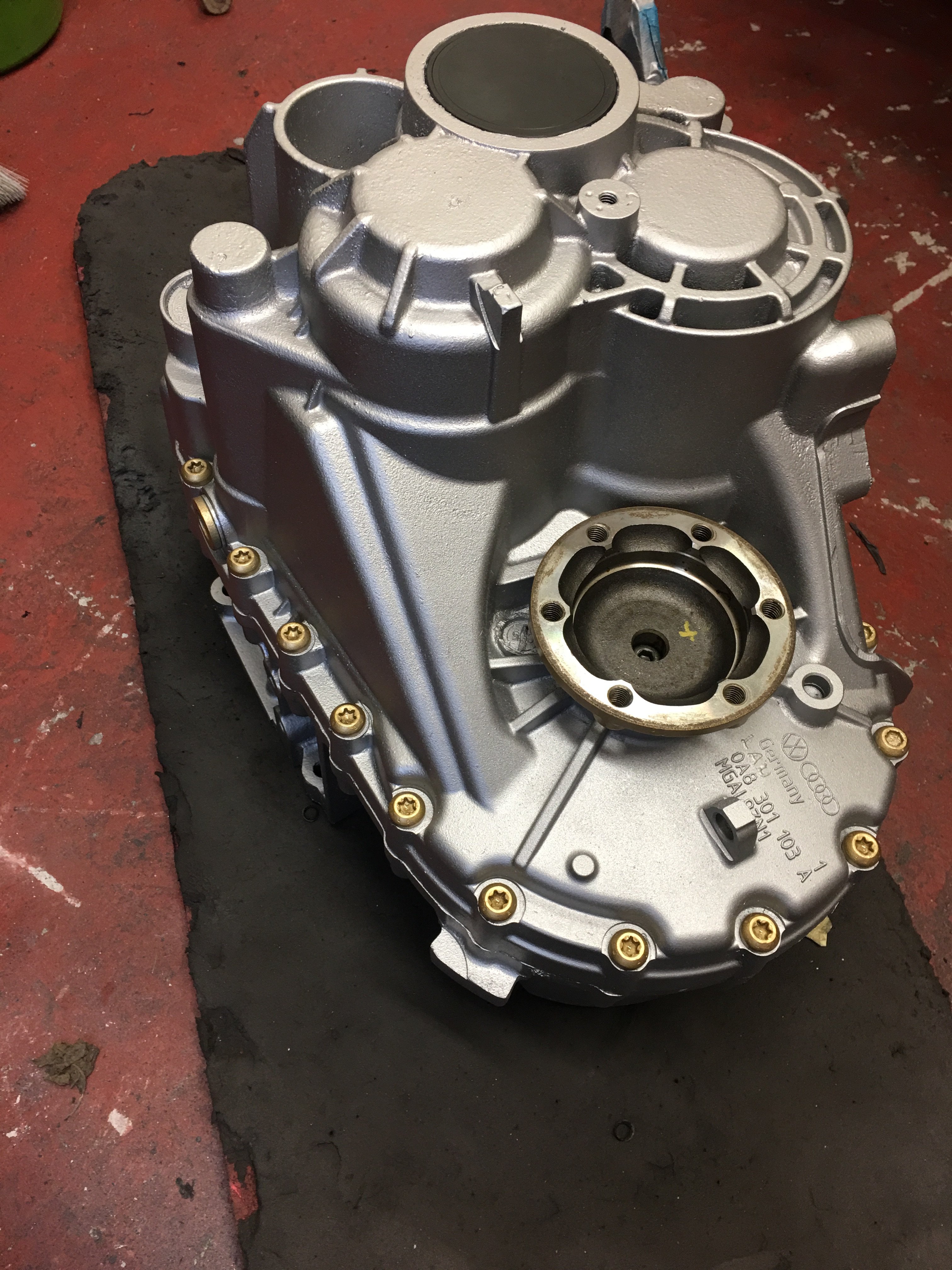

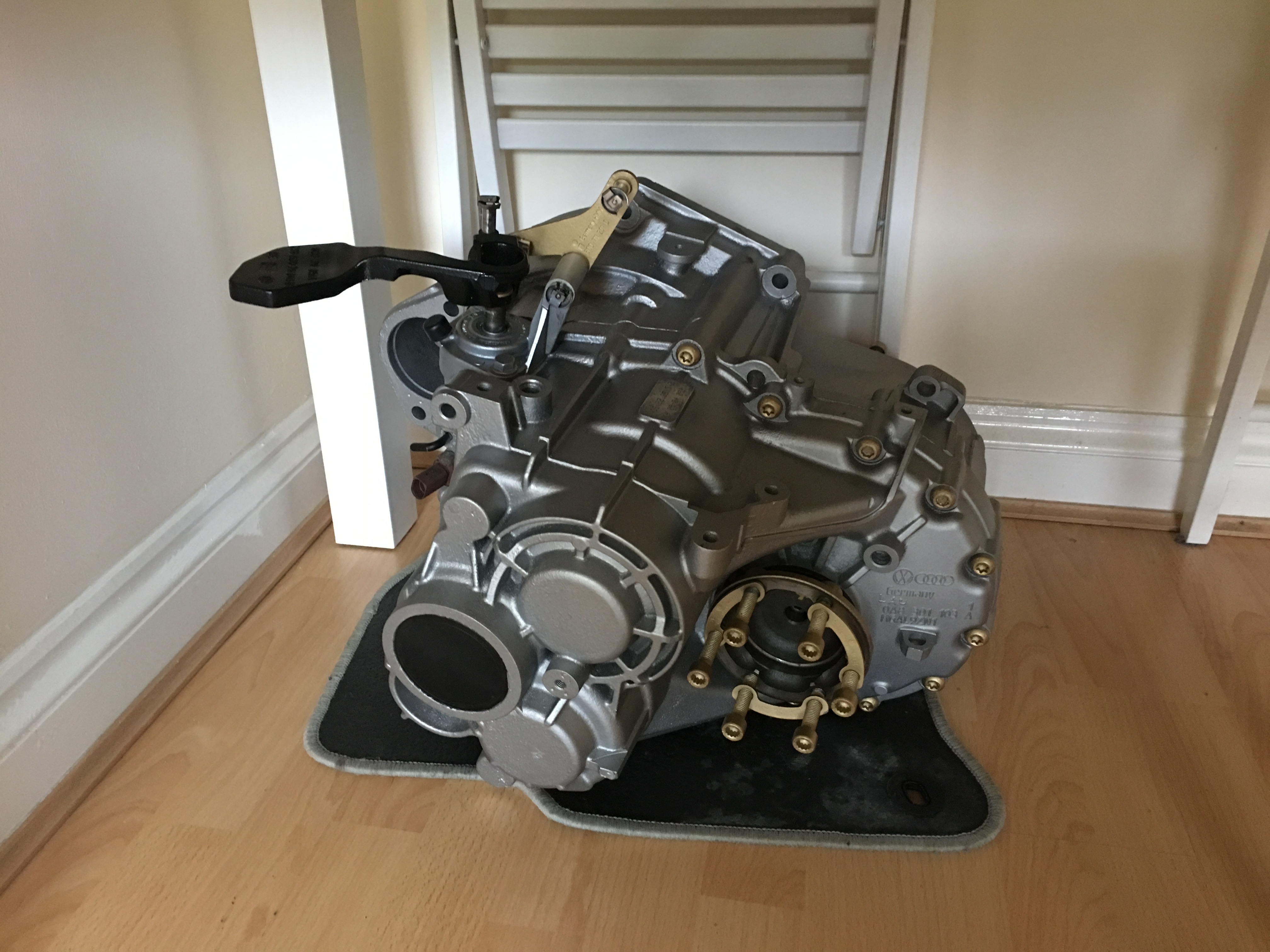

Once that was done I turned my attention to the gearbox. This has been rebuilt by a specialist, the Peloquin limited slip diff checked and various enhancements/fixes made to it, but it still looked like a 12 yr old gearbox, i.e. Nasty!

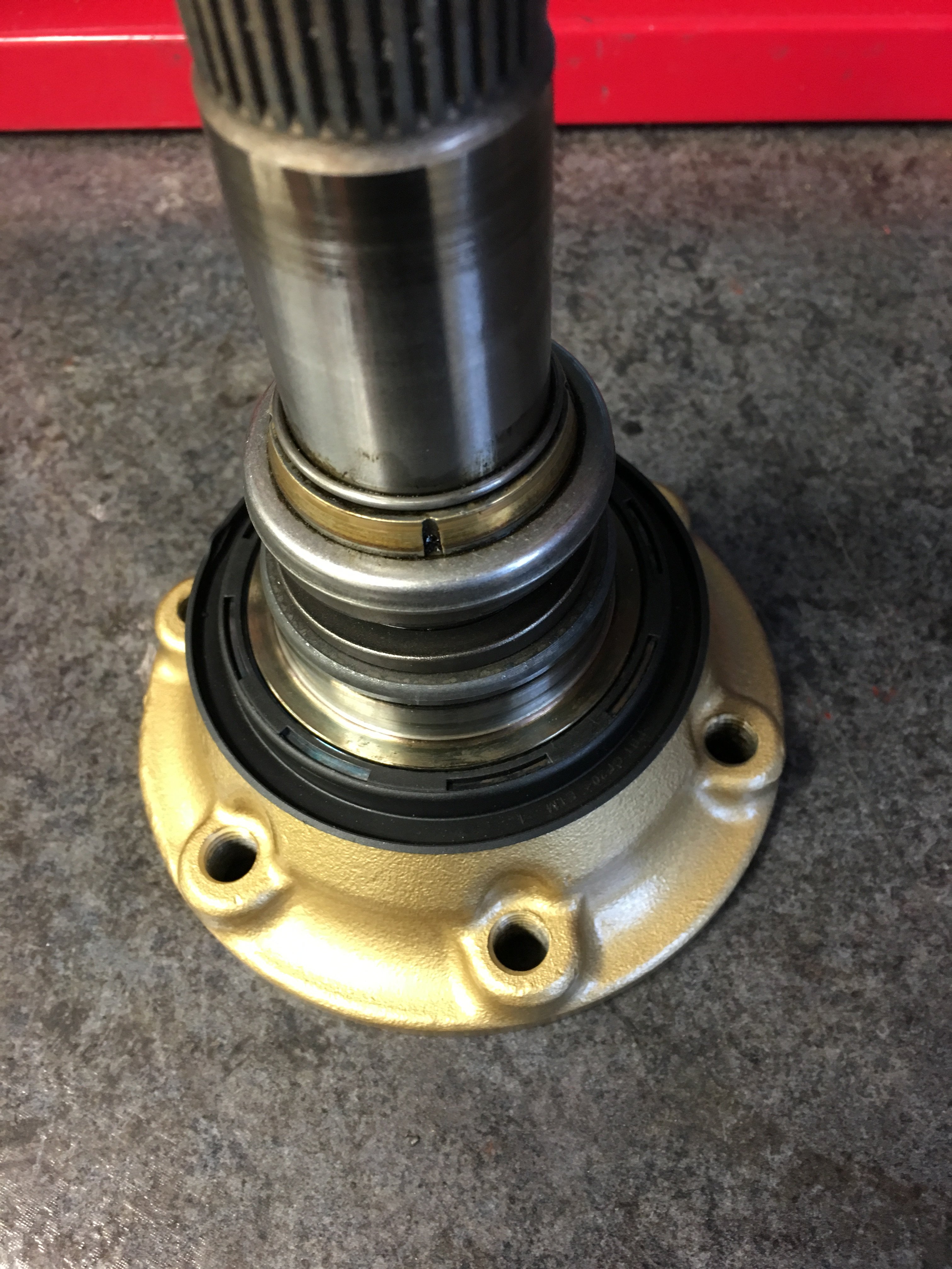

I removed both driveshaft flanges the other day, and sorted those out.
They will be refitted with new genuine VW oil seals in due course.
The gearbox has seen some cosmetic love as well..
The tandem pump has been refurbished and has gone back on with a new gasket, and the bolts torqued up to the right spec
Gearbox is now finished and put under the dining room table... just wait till the missus stubs her toe on it
At least it's freed up some much needed room in the garage.

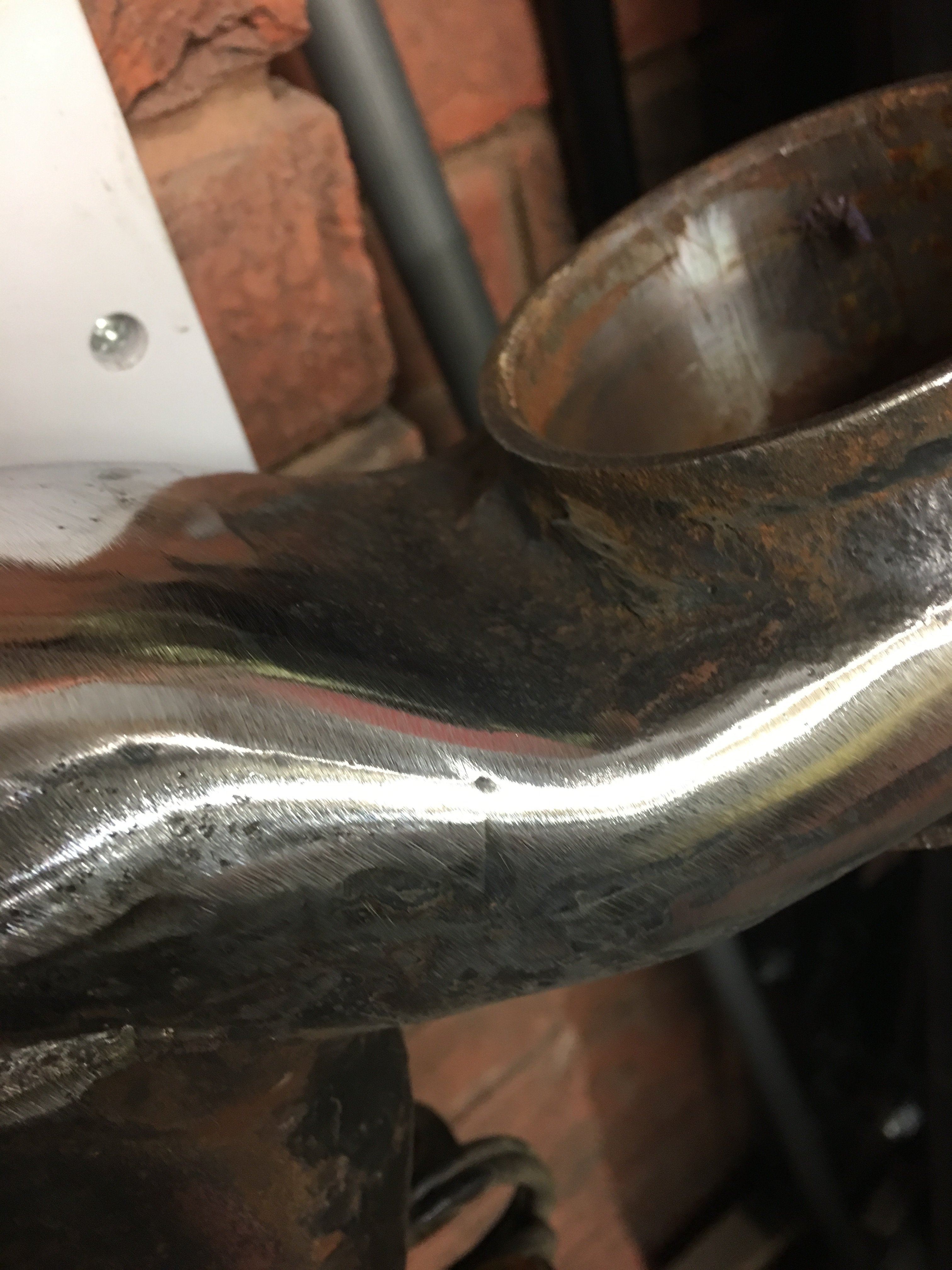

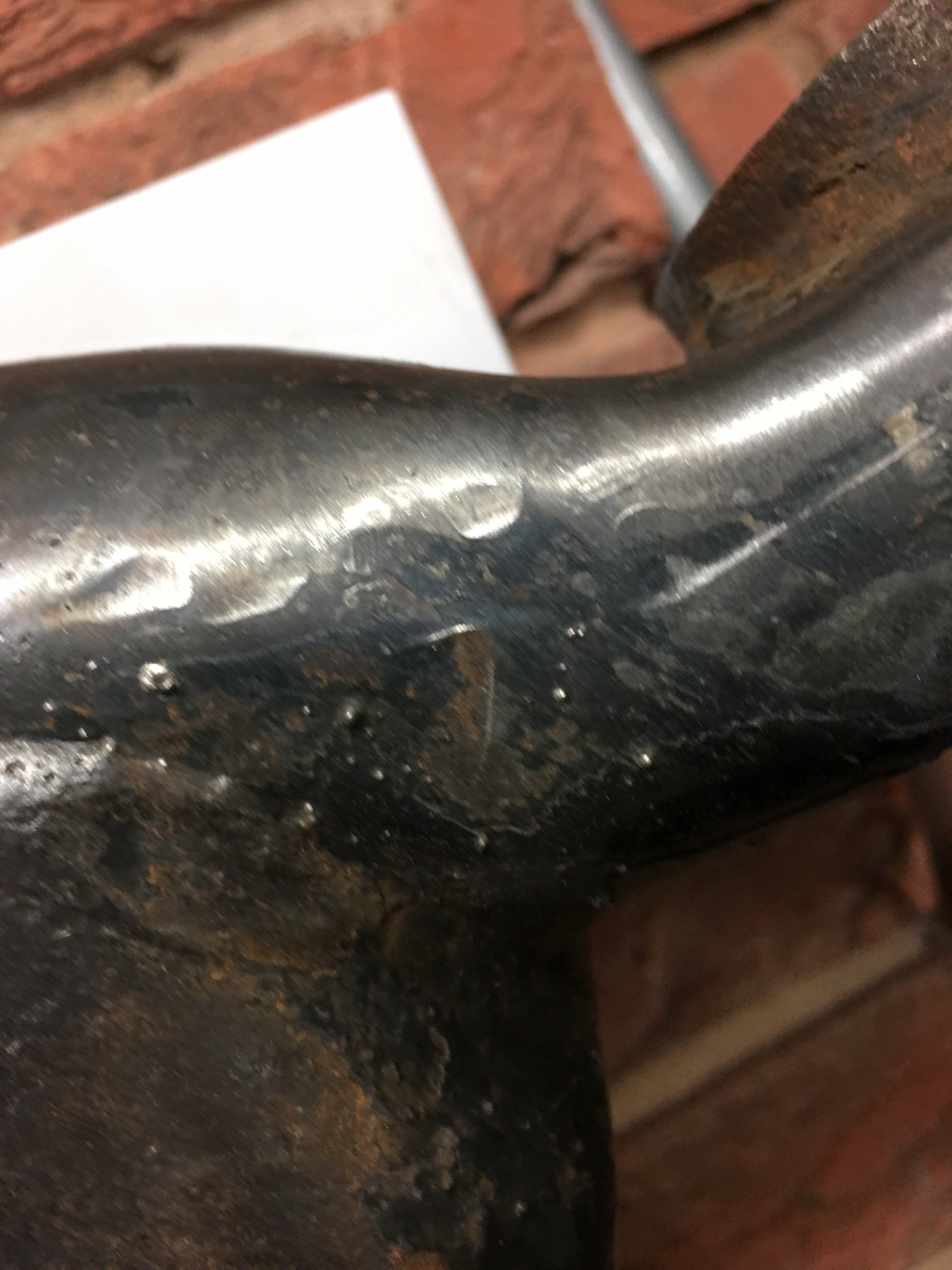

Done some more tinkering with the rear beam I had off Danham..

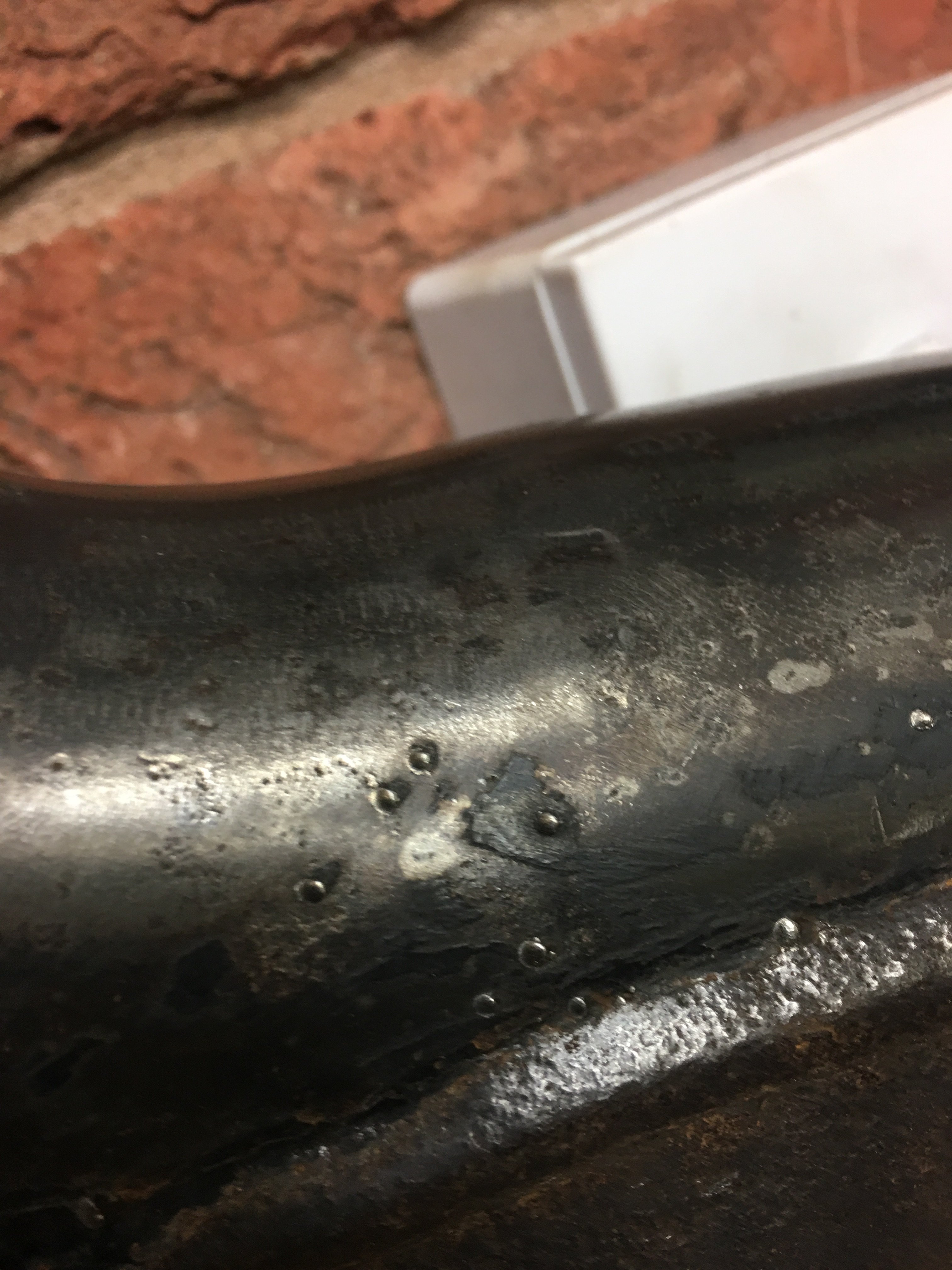

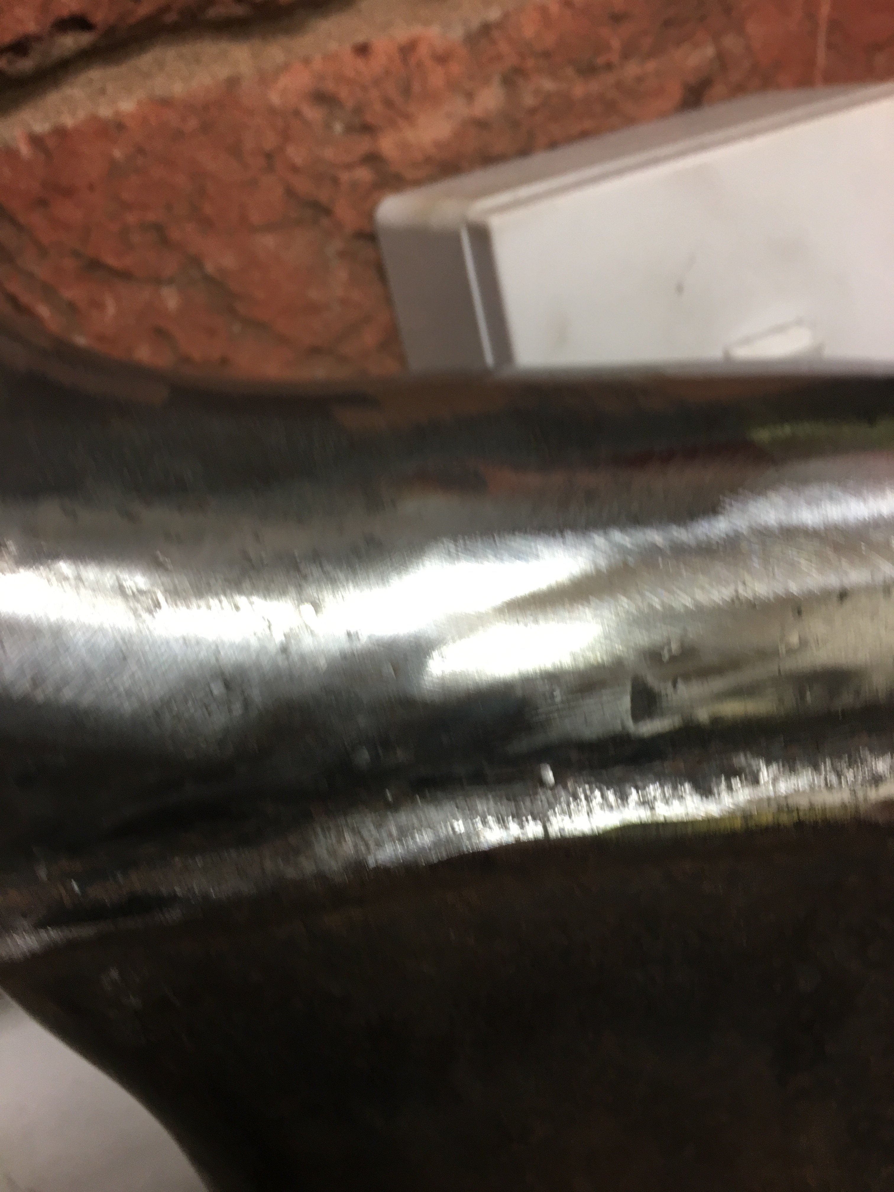

Stripped it of all the mechanical parts and it's ready to go to powdercoating. However when Skoda/Vw had these beams built, they never cleaned off the welding splatter... does it matter? Probably not but it would make my teeth itch to see it through the powdercoating.
So I used the grinder with knotted wheel to rip the paint job off (thanks for painting over the rust Dave...) to reveal what I'm on about
A few minutes with the flap disc on the grinder et voila!!
The acid dip and shot blast will see to the rest of the paint and rust removal for me.
Should be able to pick it up next week then I can rebuild it all with the refurbished stub axles and new wheel bearing kits
