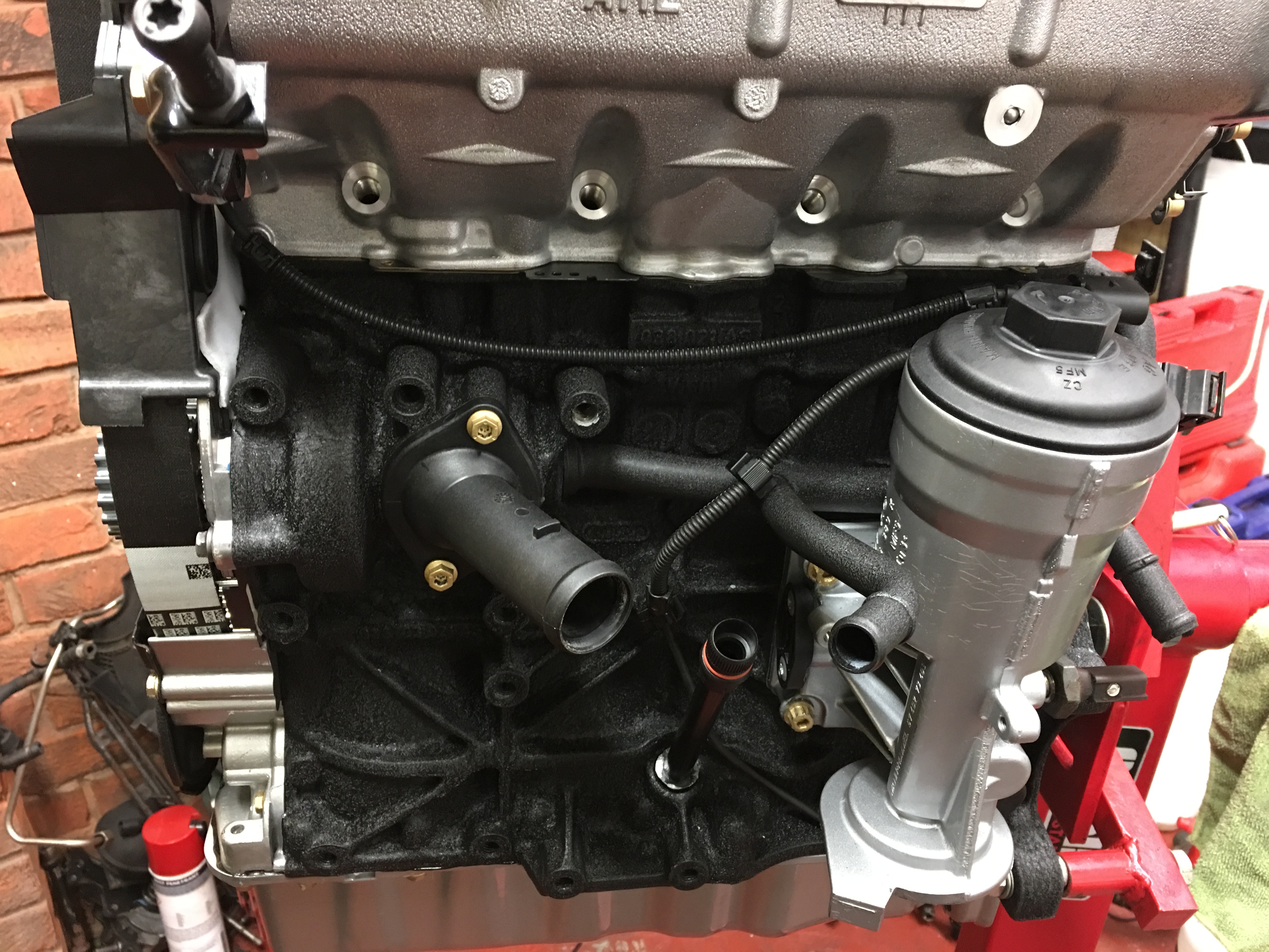

Got the newly painted oil filter housing fitted with a new gasket

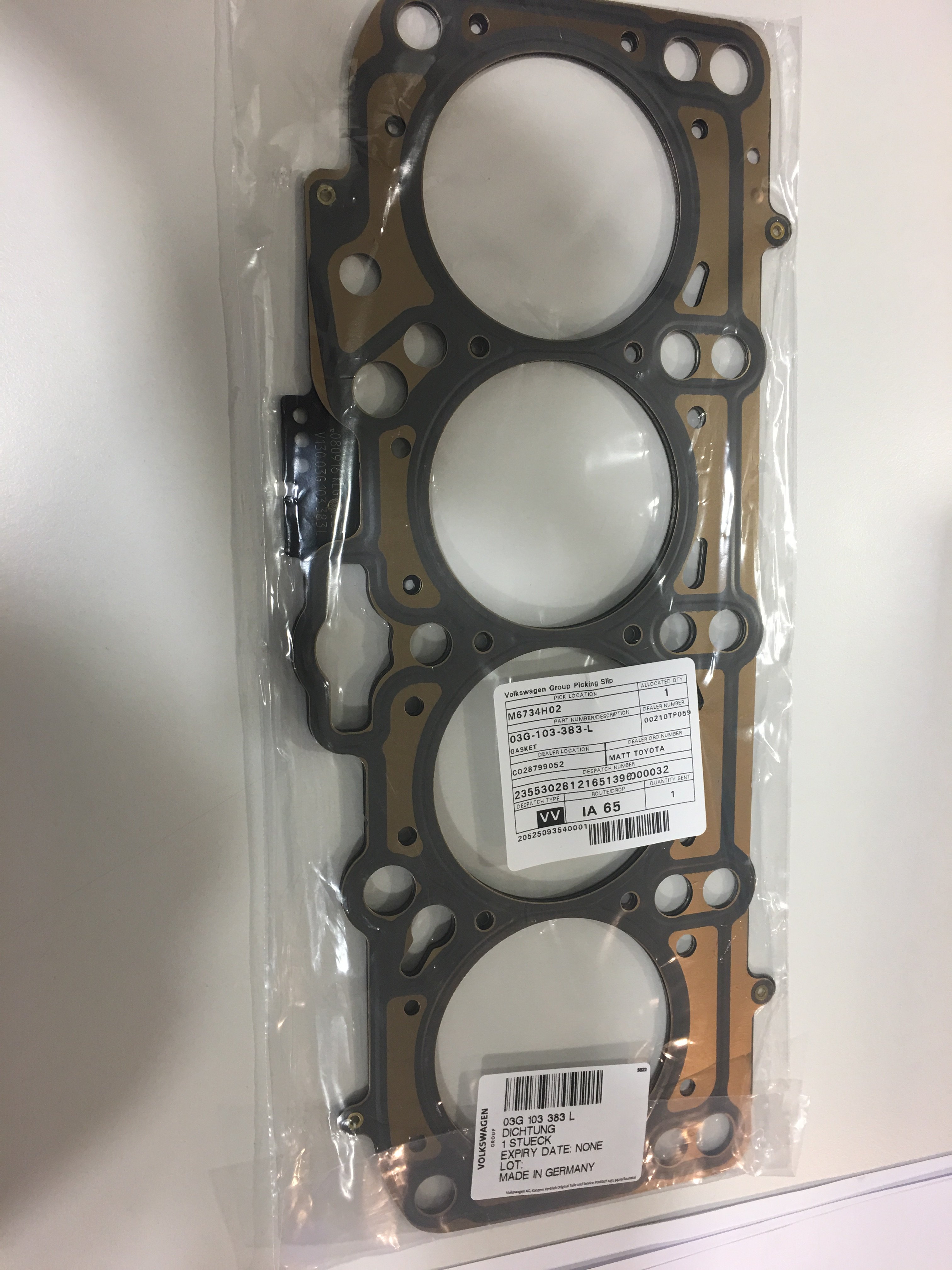

The engine was wound over to get the pistons to TDC and measured the piston protrusion and got a max reading of 1.2mm which necessitates the fitment of the three hole 2.0 PD 8v head gasket which I'll get from TPS tomorrow.

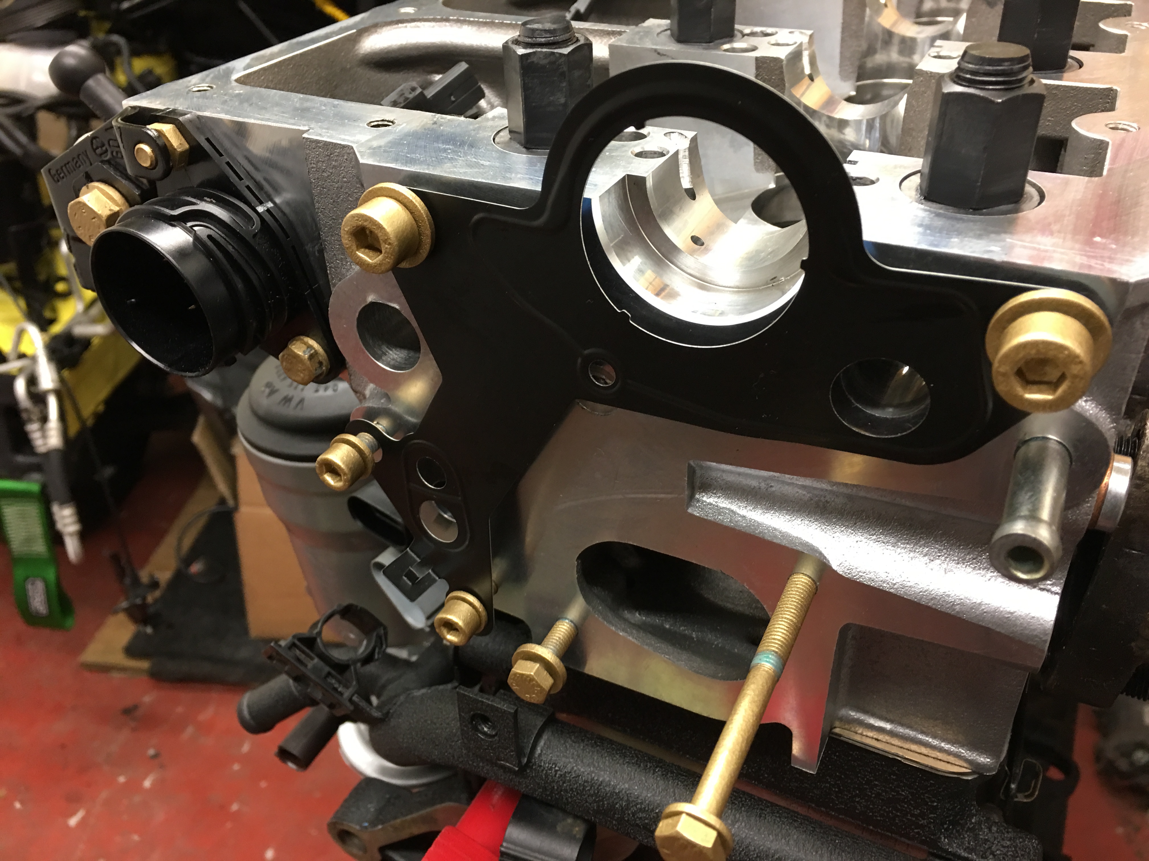

Three hole head gasket is now here

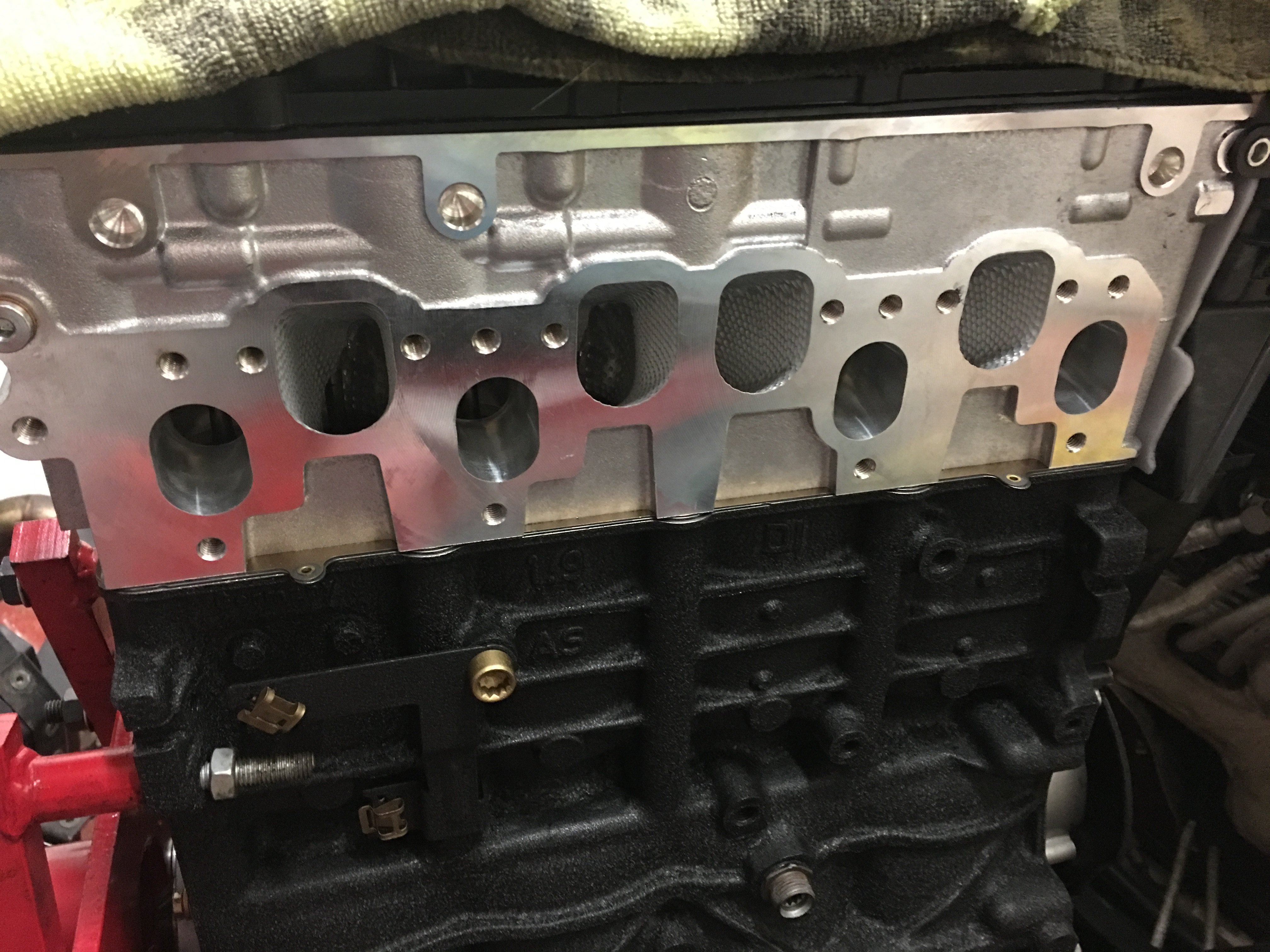

so of course the heads been fitted. The stud and nut kit is nice to use, simple torquing up process as well
I like the look and idea of the stud and nut conversion, but are they worth the cost?
Yeah they supposedly offer a stronger clamping force than just headbolts alone so will hopefully handle the boost better

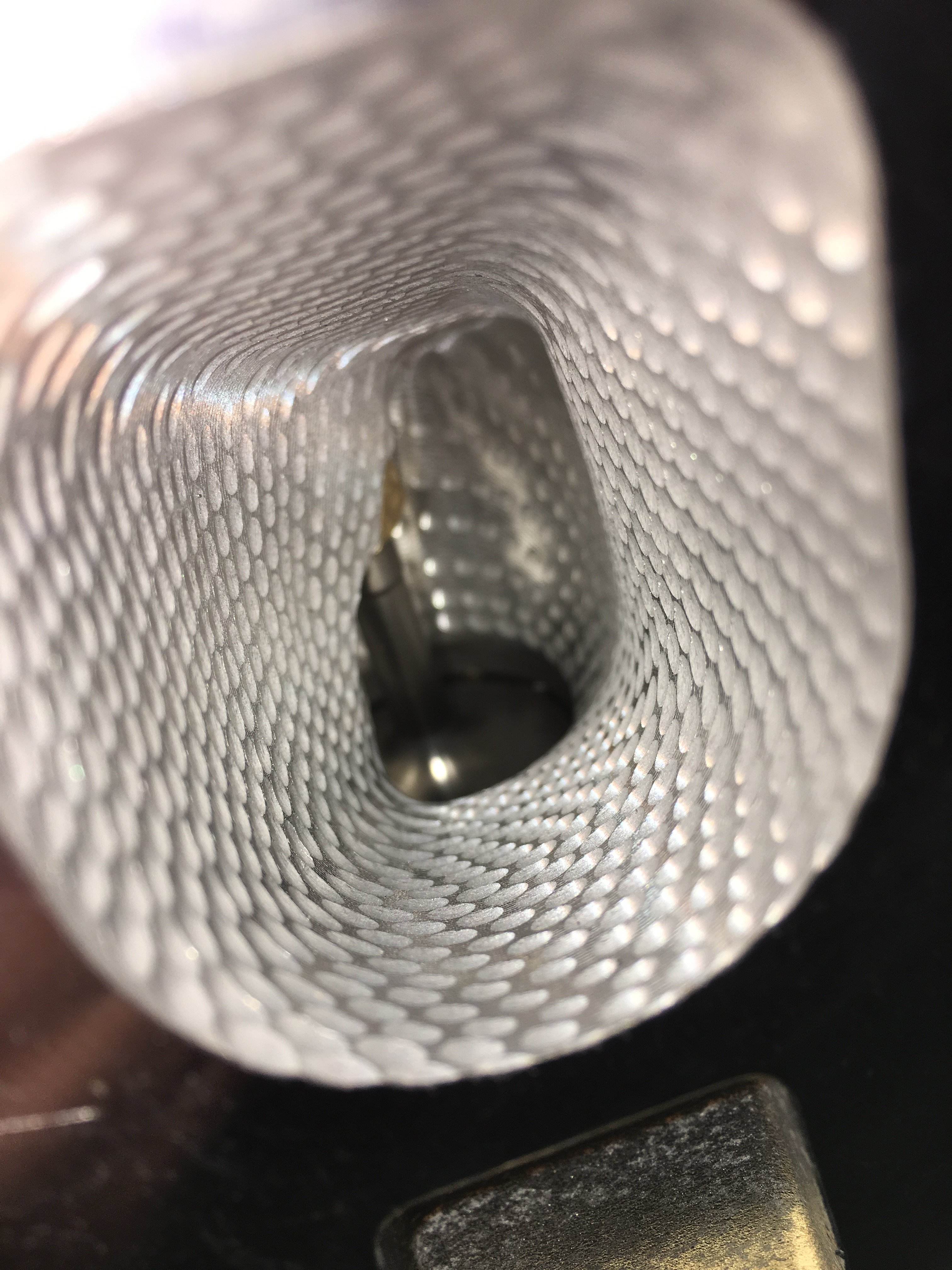

Cheeky close up of the inlet port. Just for Coskev
Dimpled headed 'C U Next Tuesday' :D
" Engineering "
that is all

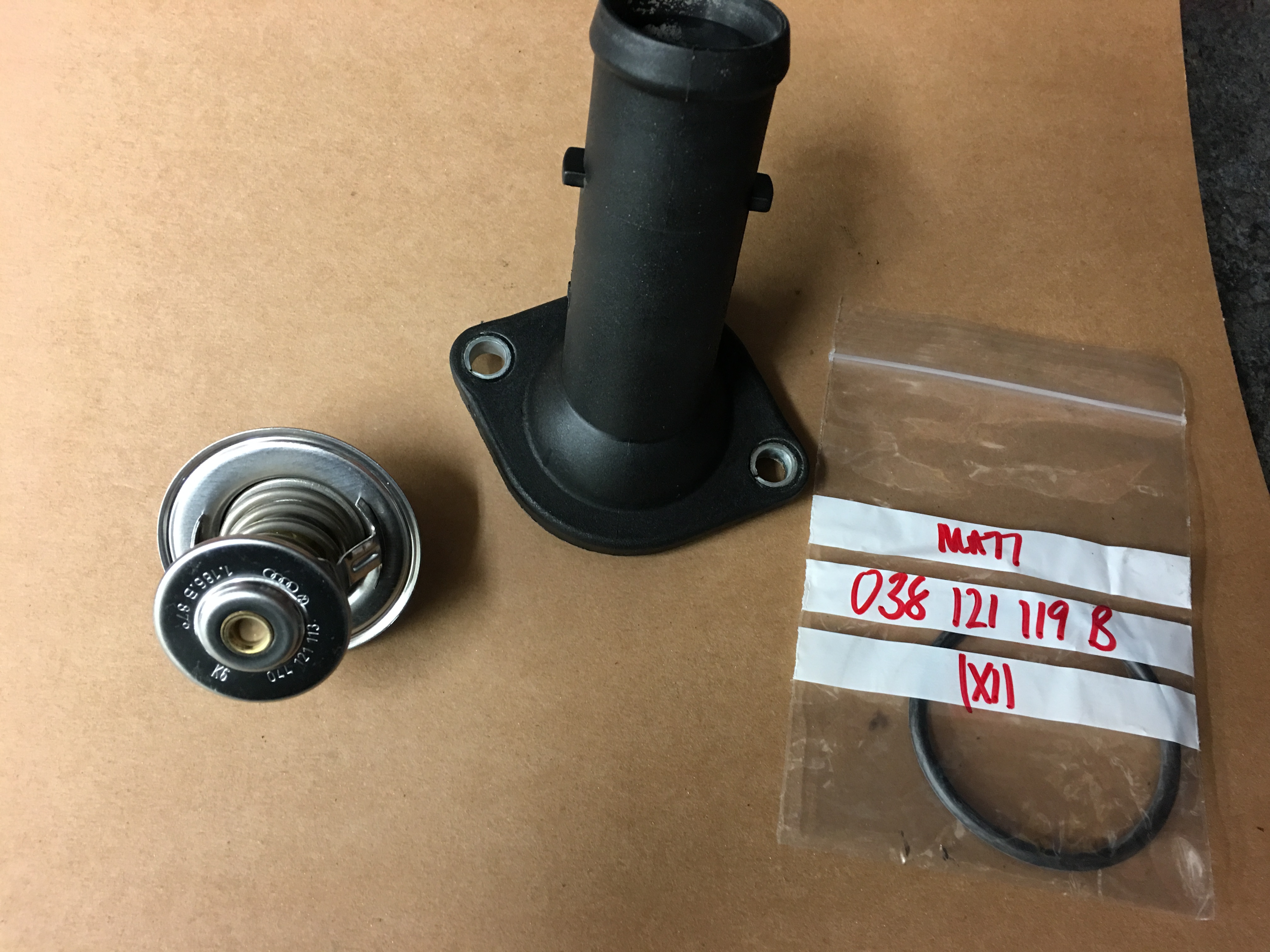

Fitted the new genuine thermostat, gasket and bolts.

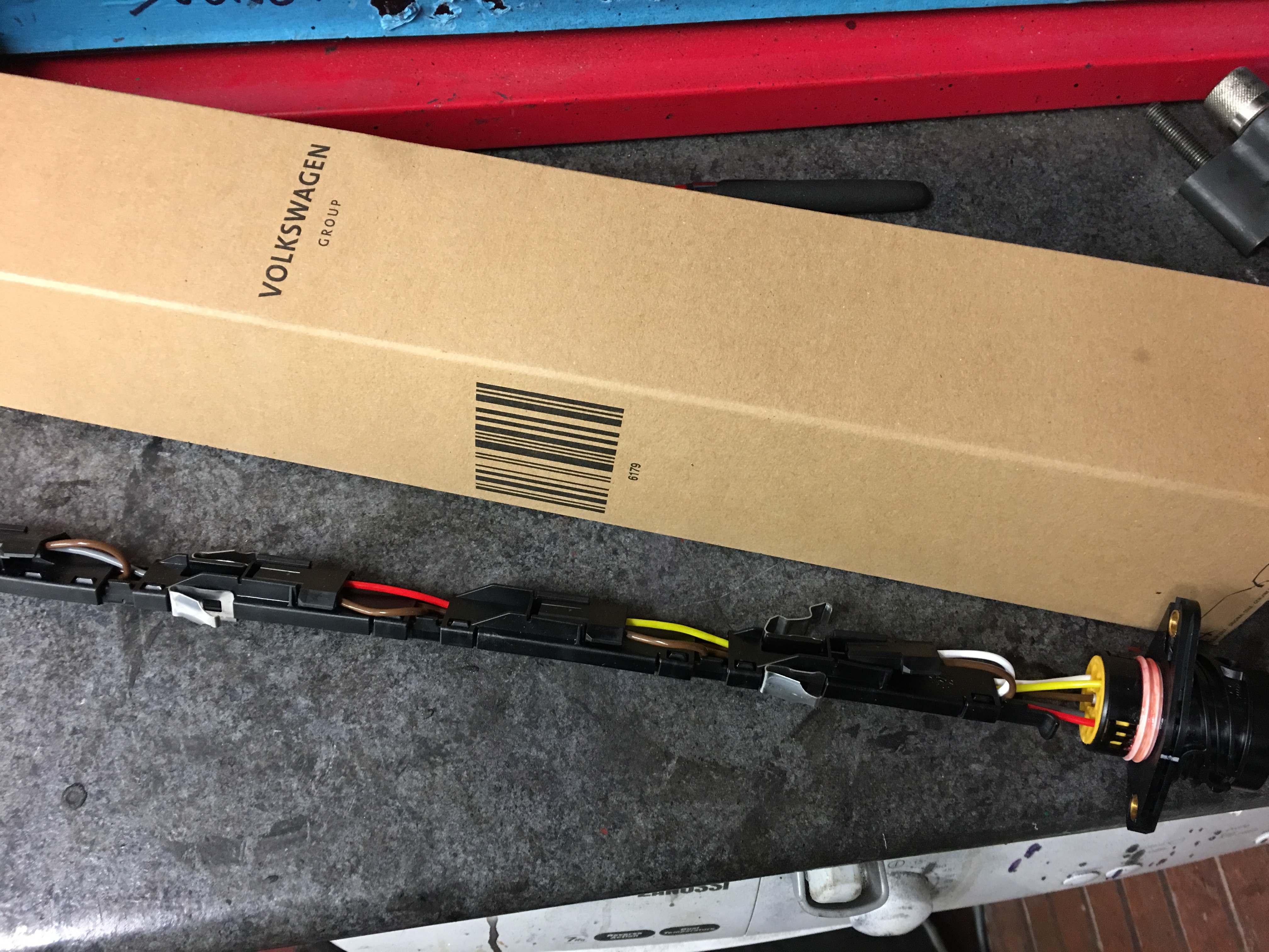

New injector loom

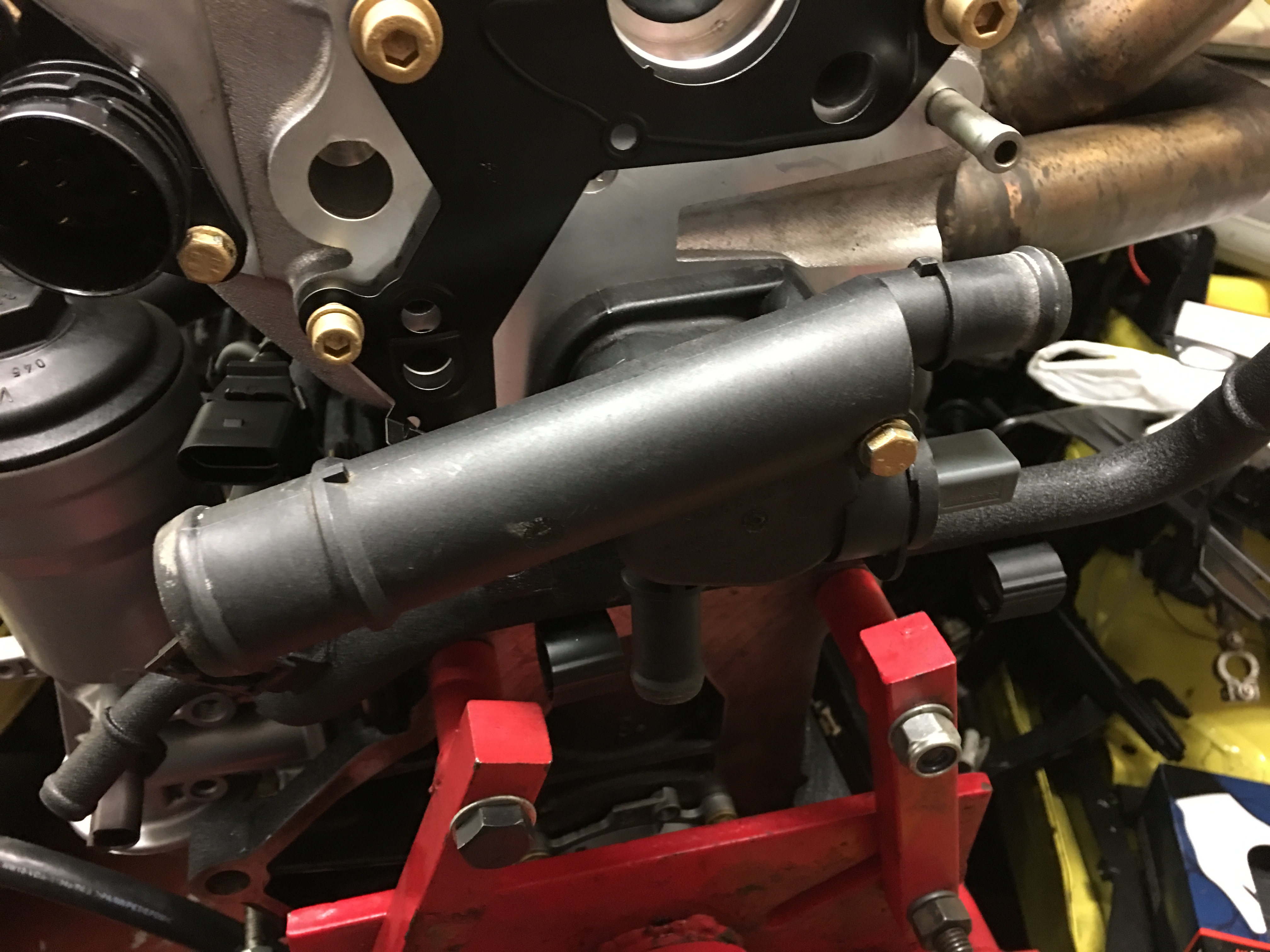

Fitted the cam and crank sensors, fitted the new water pipe across the front of the block and got the tandem pump fittings ready also

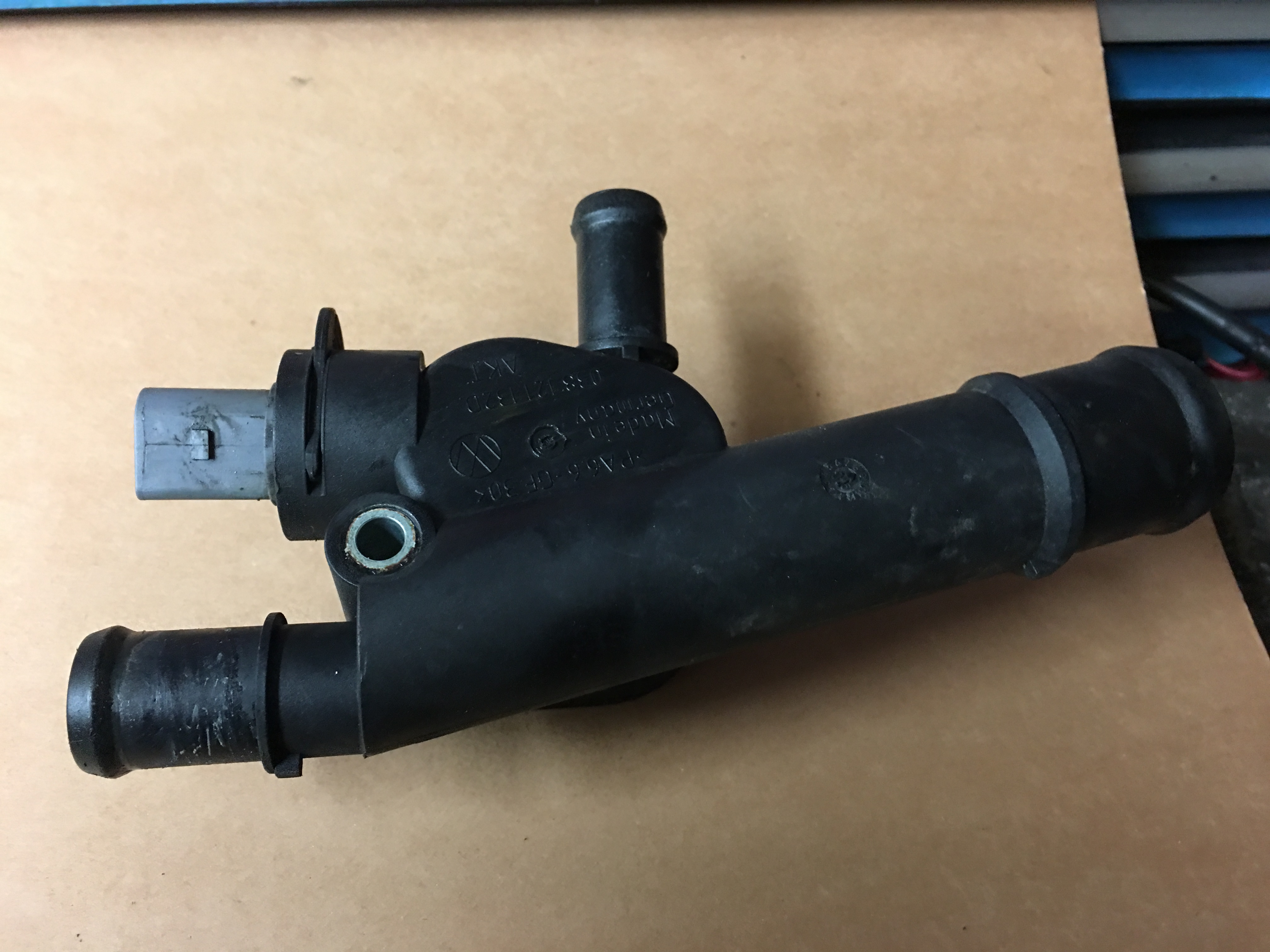

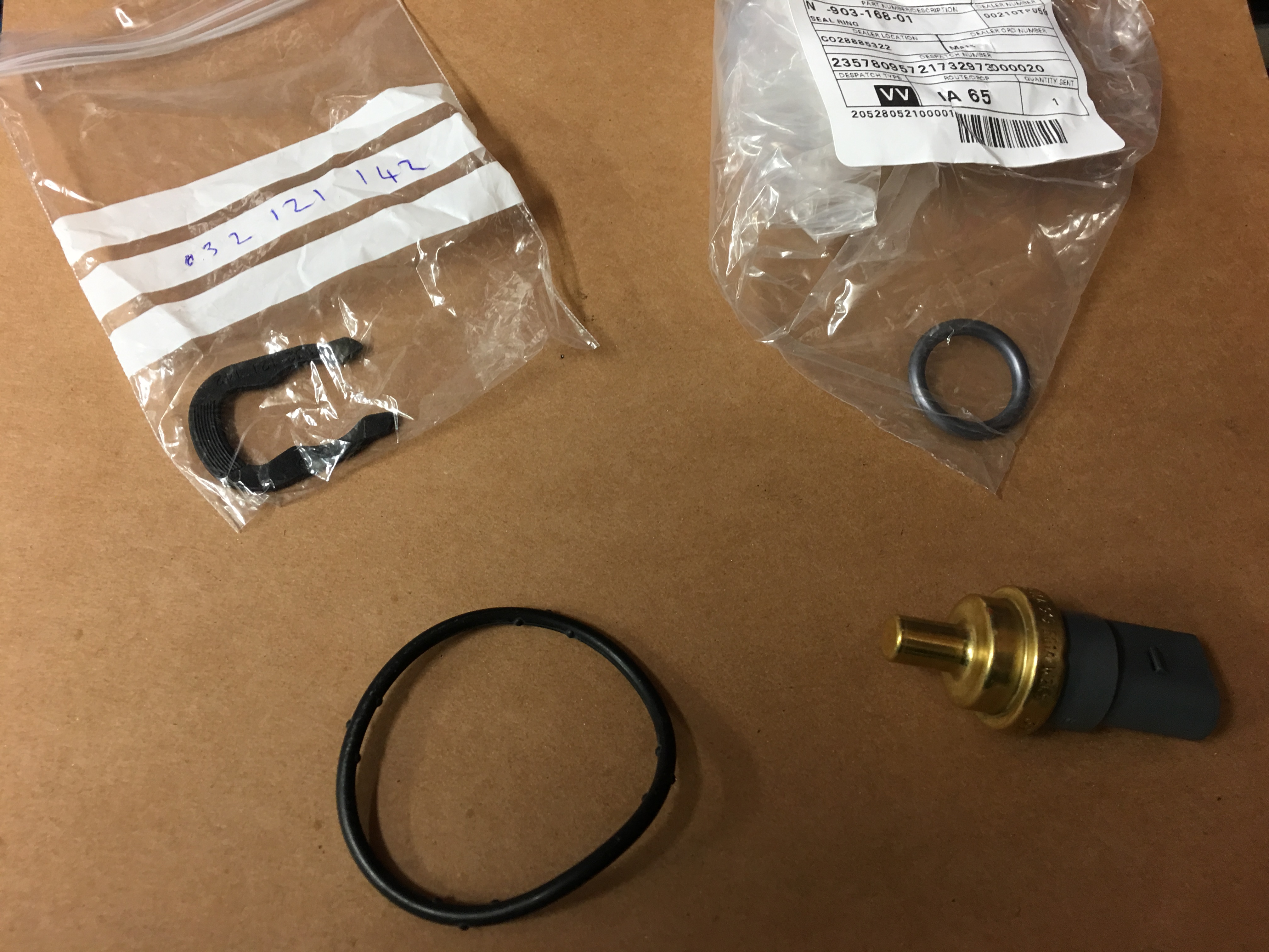

Five minutes outside tonight saw me clean up the water pipe fitting where the coolant temp sensor lives.
this was how it looked. Now it seems like false economy to me not to replace the sensors and seals as I go as the rest of it is brand new, so I picked up from TPS today.. new CTS, seal for CTS, new plastic circlip and the o ring for the water housing.
And all fitted up.
more tomorrow hopefully
Errr... what's going on? You've blatantly tried to deceive us here. Last picture has the tubular on...
