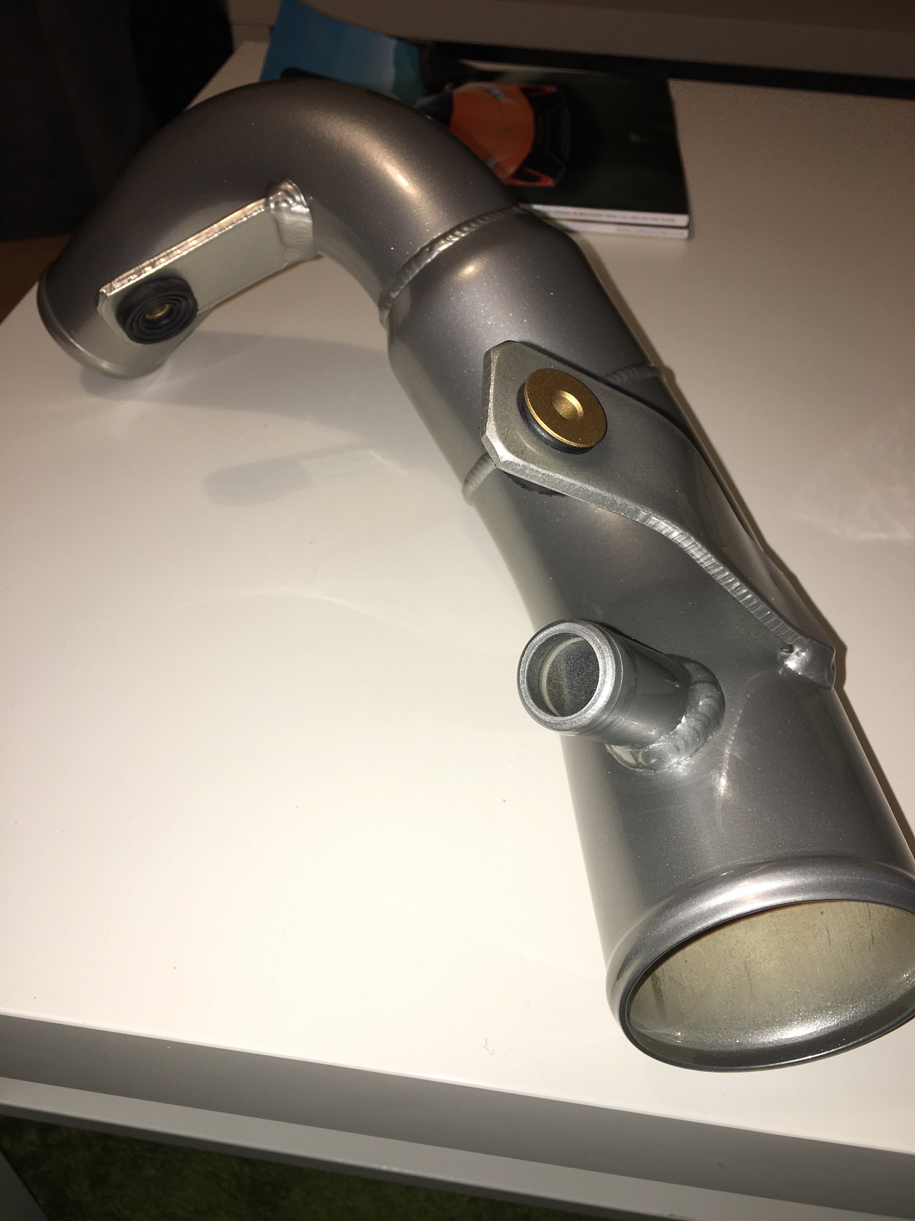

  • Update time!   Back in post #52 you will recall a picture of a rather grubby looking 1.9 PD engine from a Fabia vRS. This has been purchased for a number of reasons, most of them totally log

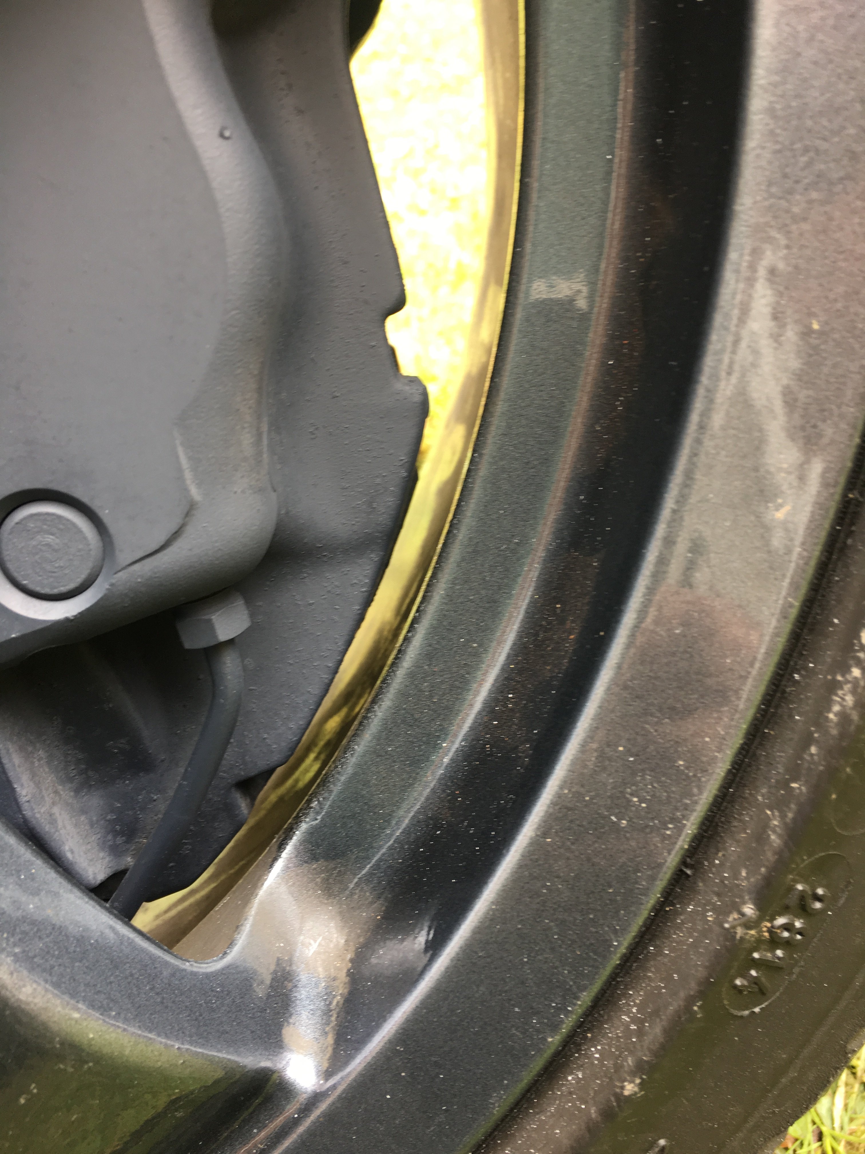

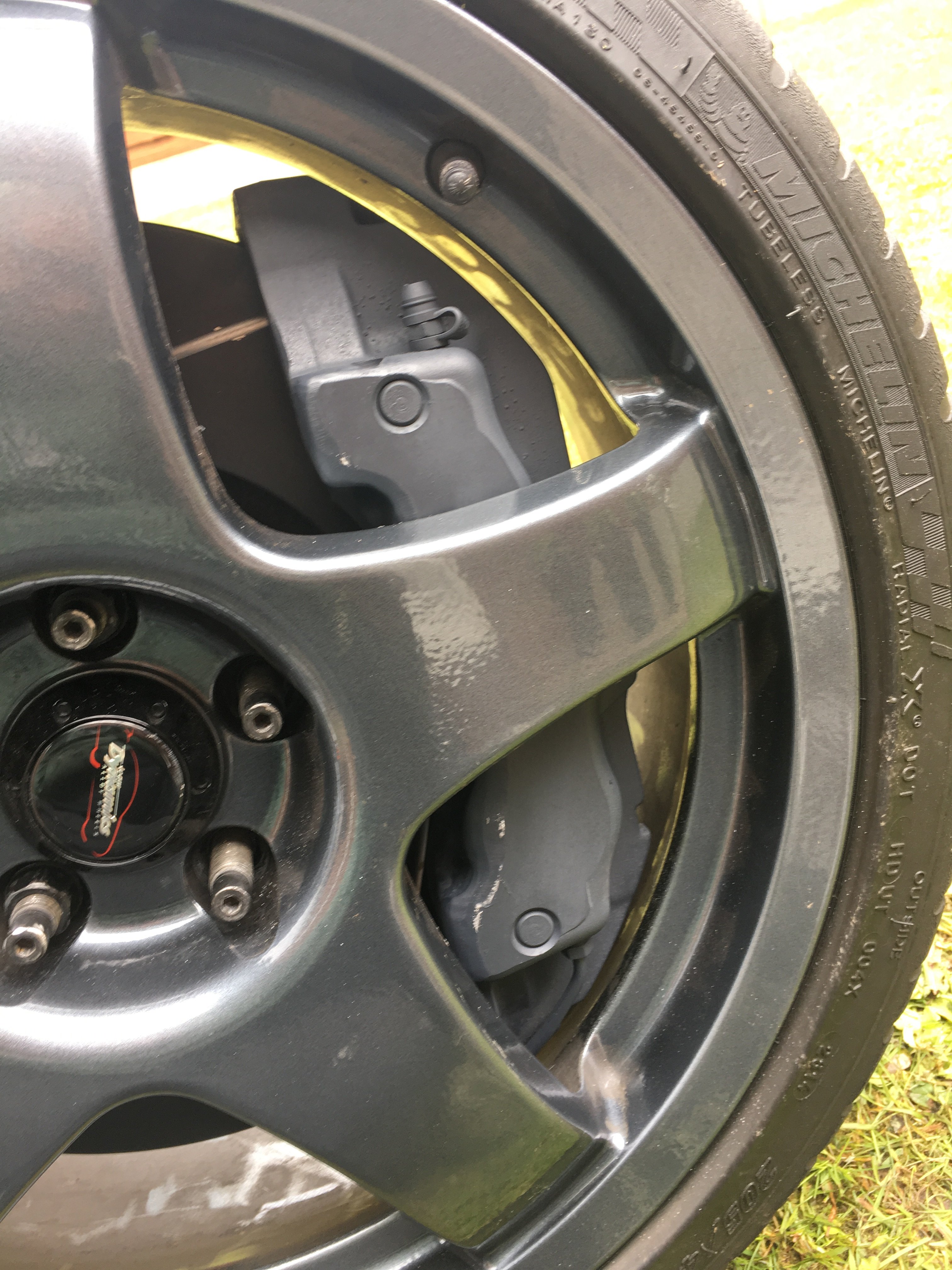

I dont think standard green will suite them. Why not go colour coded?
OEM+ strikes me as the name of the game with this build
They have a massive surface area though, the green will be too much. I may be wrong though..

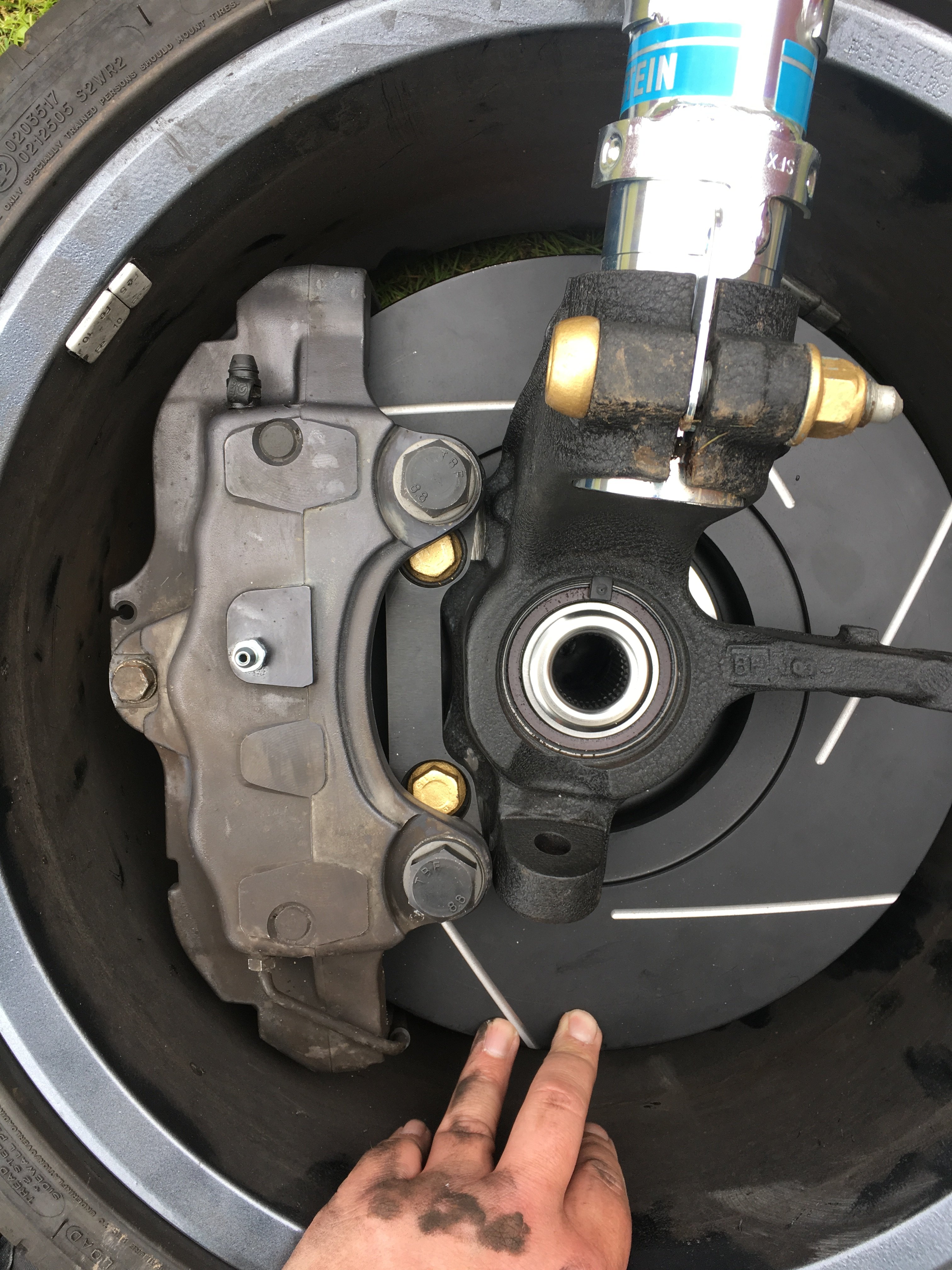

I've been deliberating caliper colour for weeks lol!
Meantime the drivers arch is 99% finished, just waiting for the braided hose fixing/spring clip.
Looking good ,looming good ,going to be One of the best .
I feel the pain of picking a colour for the calipers, I've had that problem for about 6 month so sticking with red, abit boring and not really for you but I think either silver or black for your calipers personally. Maybe photoshop them green and see how it looks
I don't think the calipers are big enough.... ;)

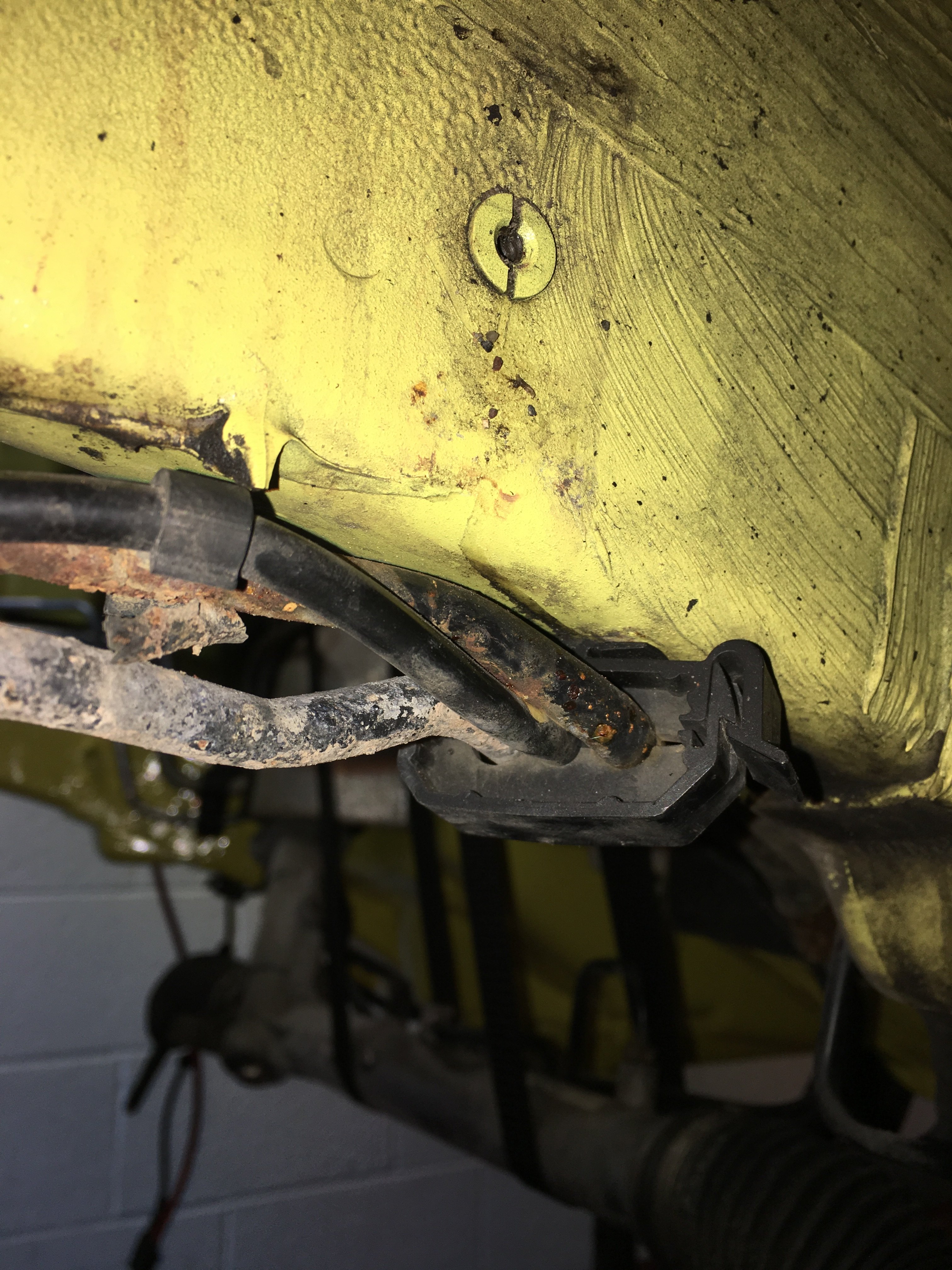

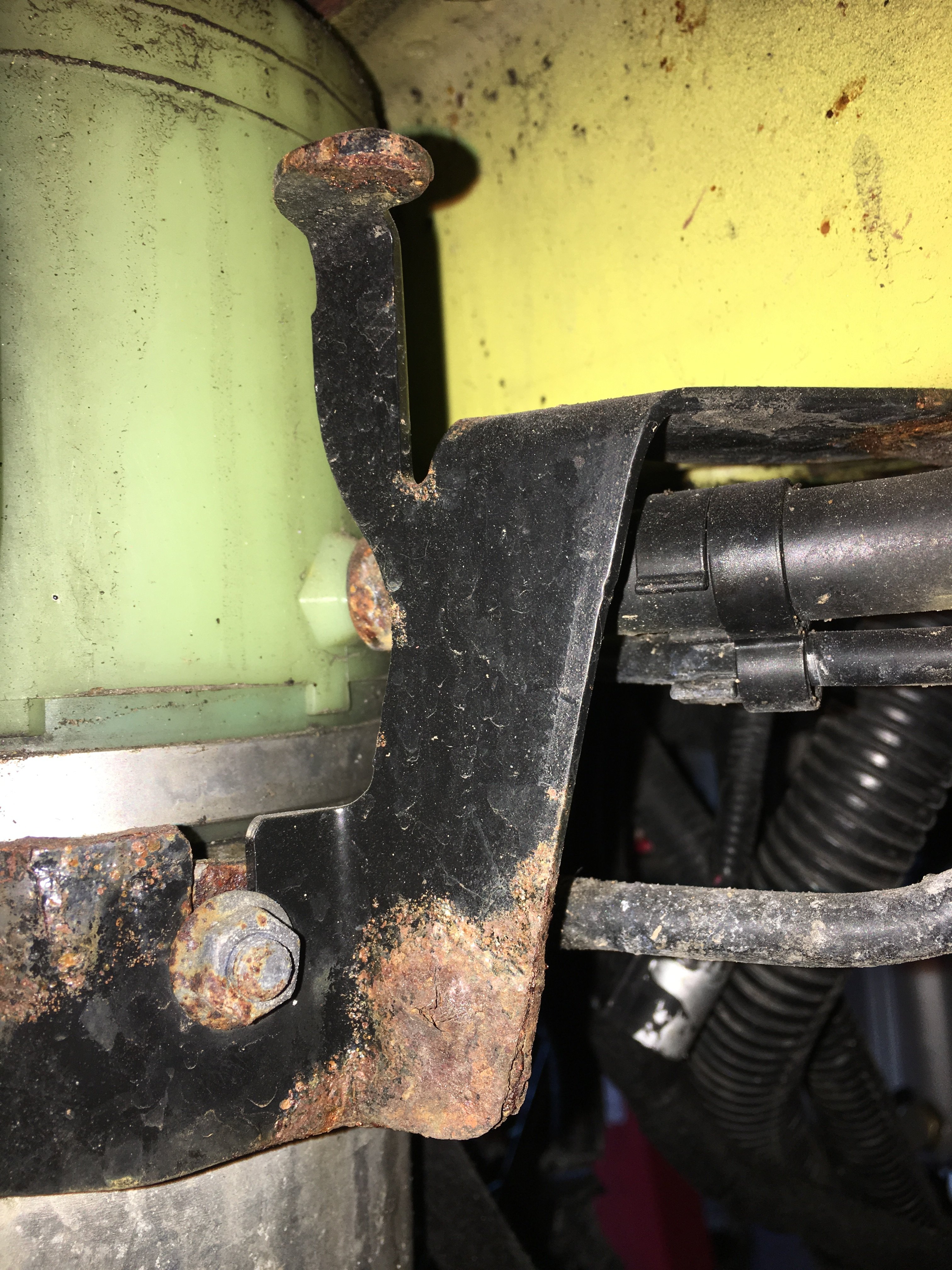

One worrying discovery was the hard line PAS pipes. Where they come from the pump towards the rack they pass through an oblong retaining clip fixed to the inner wing. Unusually poor design means that road muck and moisture sit encased on the pipes and as such mind are very corroded indeed. It's the kind of thing you only discover when dismantling the car to this degree but I'm confident that as soon as I unclip them they're gonna start leaking hence this lot...

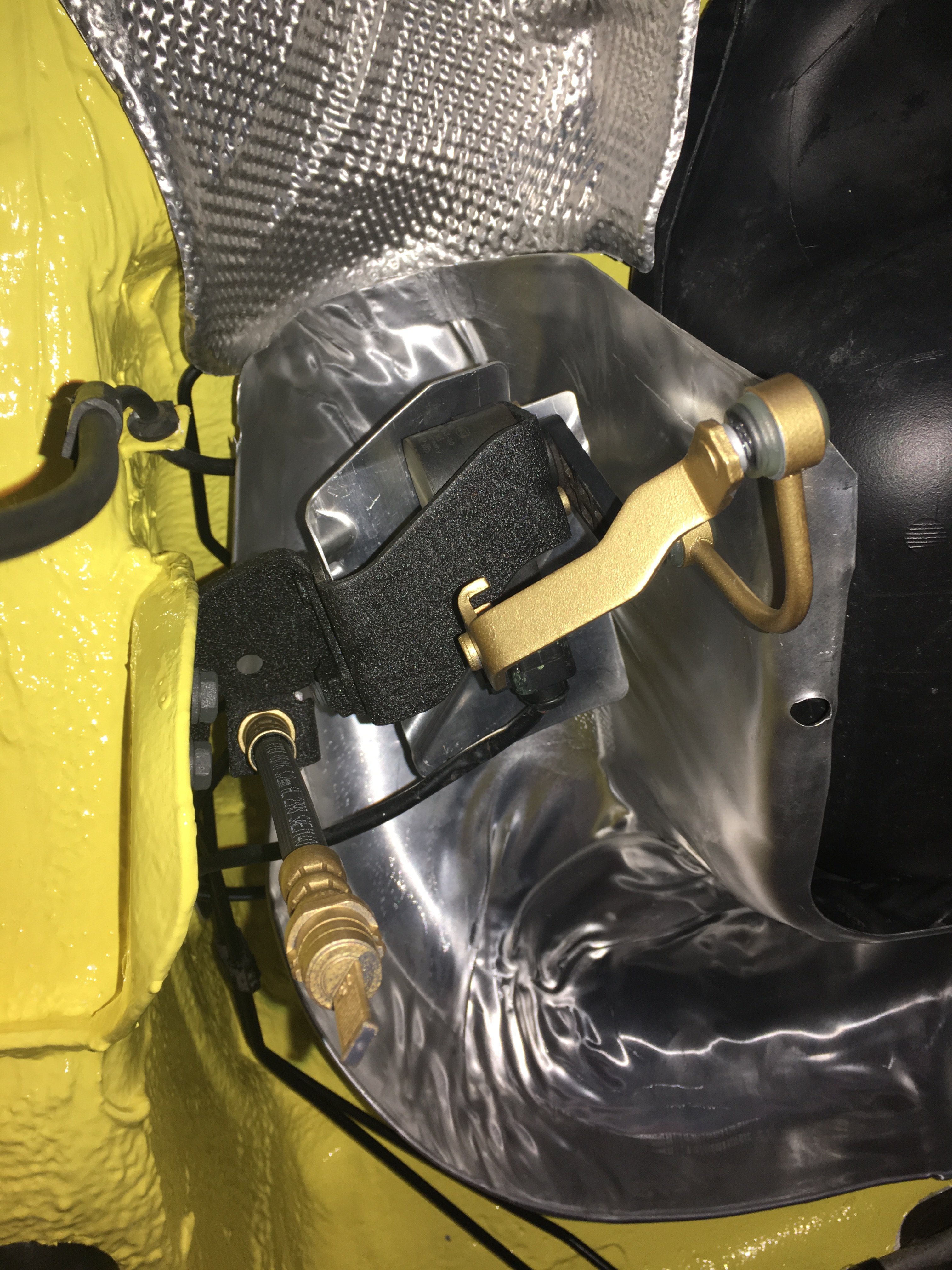

Both PAS hard lines from pump to rack, also taking the chance to change the clutch hardline and flexi into the bleed breather (also renewing the breather)
I'm working my way round the engine bay and have got some pics of the crusty PAS pipes..
Not the best pic I know but until I strip them off the car that's all I've got.
The PAS pump has gotta come off to, as all the brackets are crusty as well

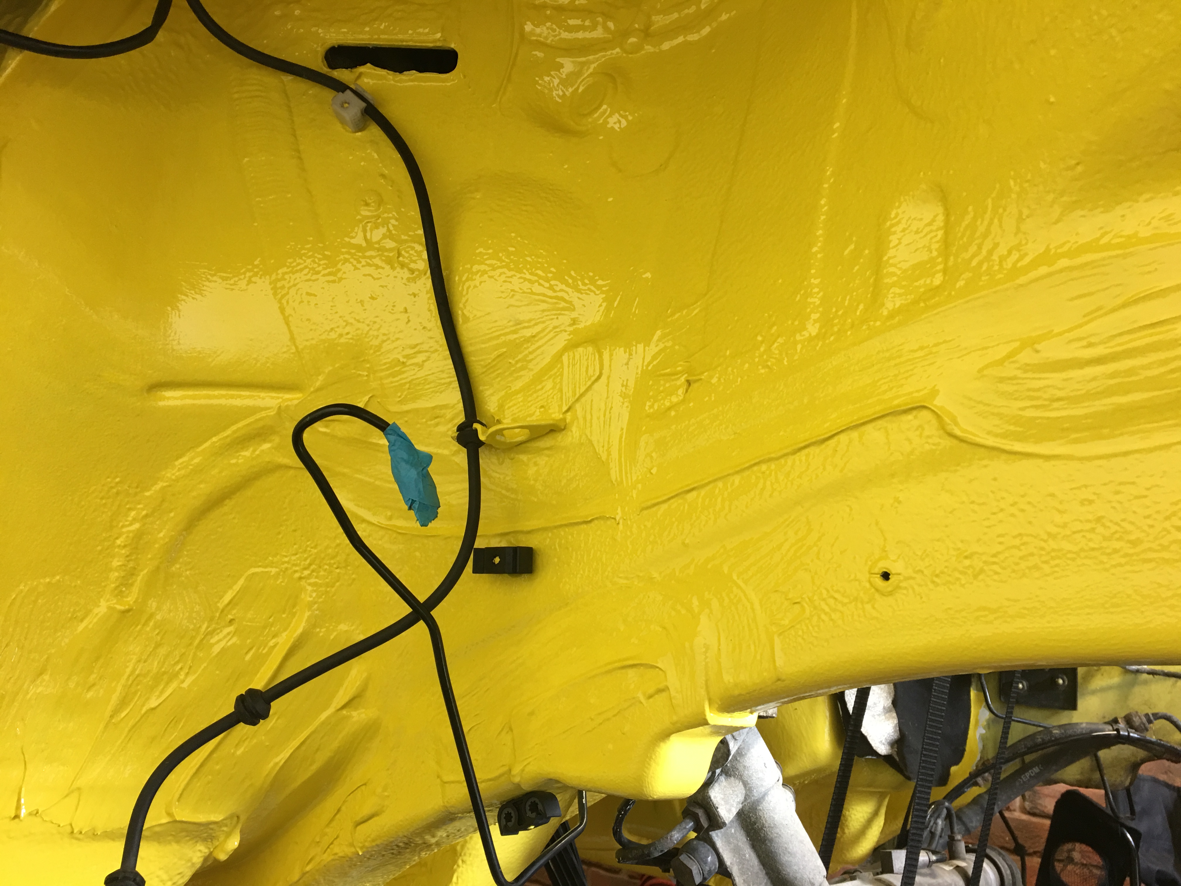

This heat is a good excuse to not mess with the car but hopefully the weekend will see more progress and at least have the n/s/f inner wing/leg stripped bare
Few hours again this afternoon has seen more progress.
The new front to rear brake lines have been fitted, plumbed into the rear flexible hoses and the ABS pump at the bulkhead.

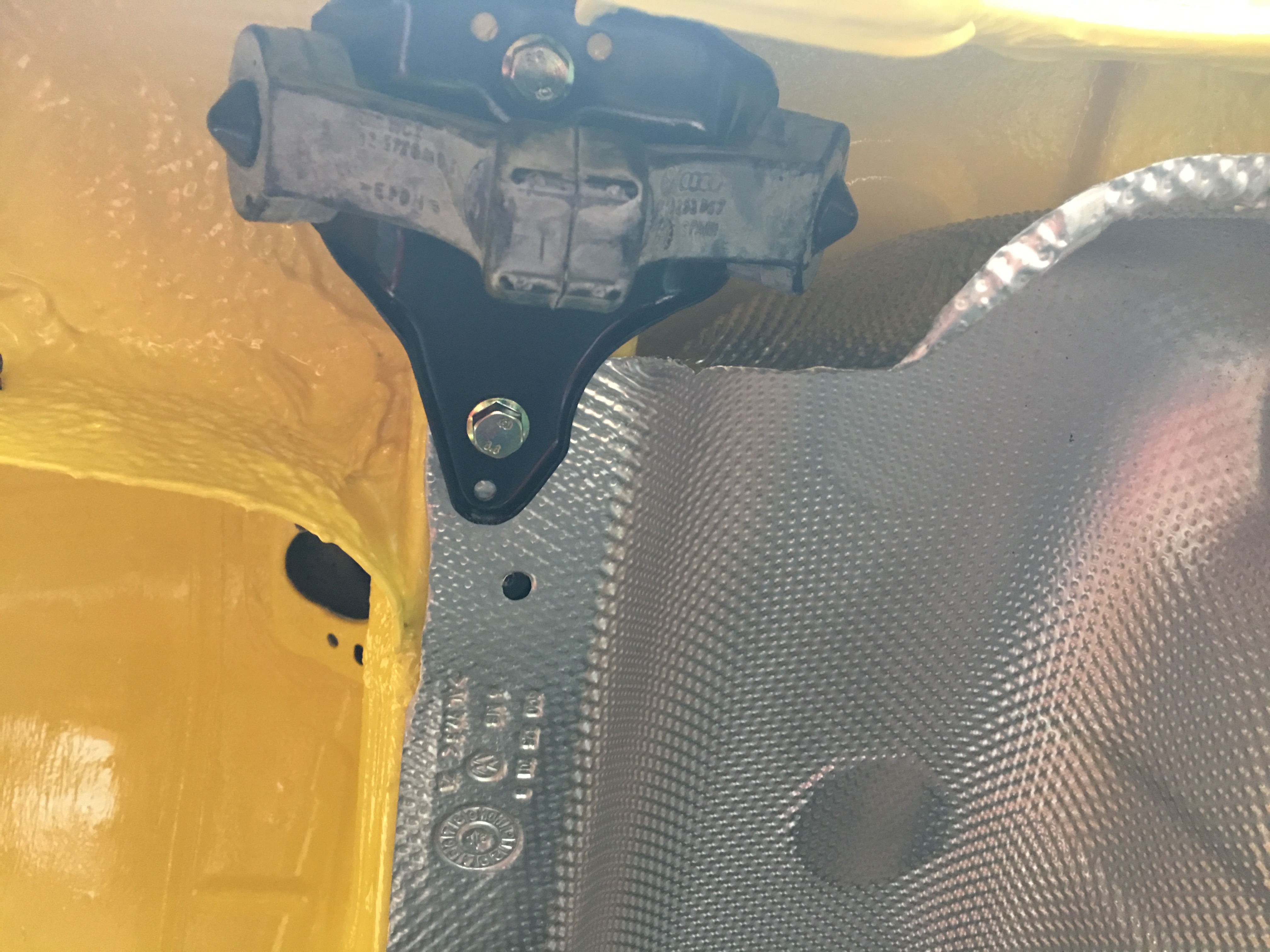

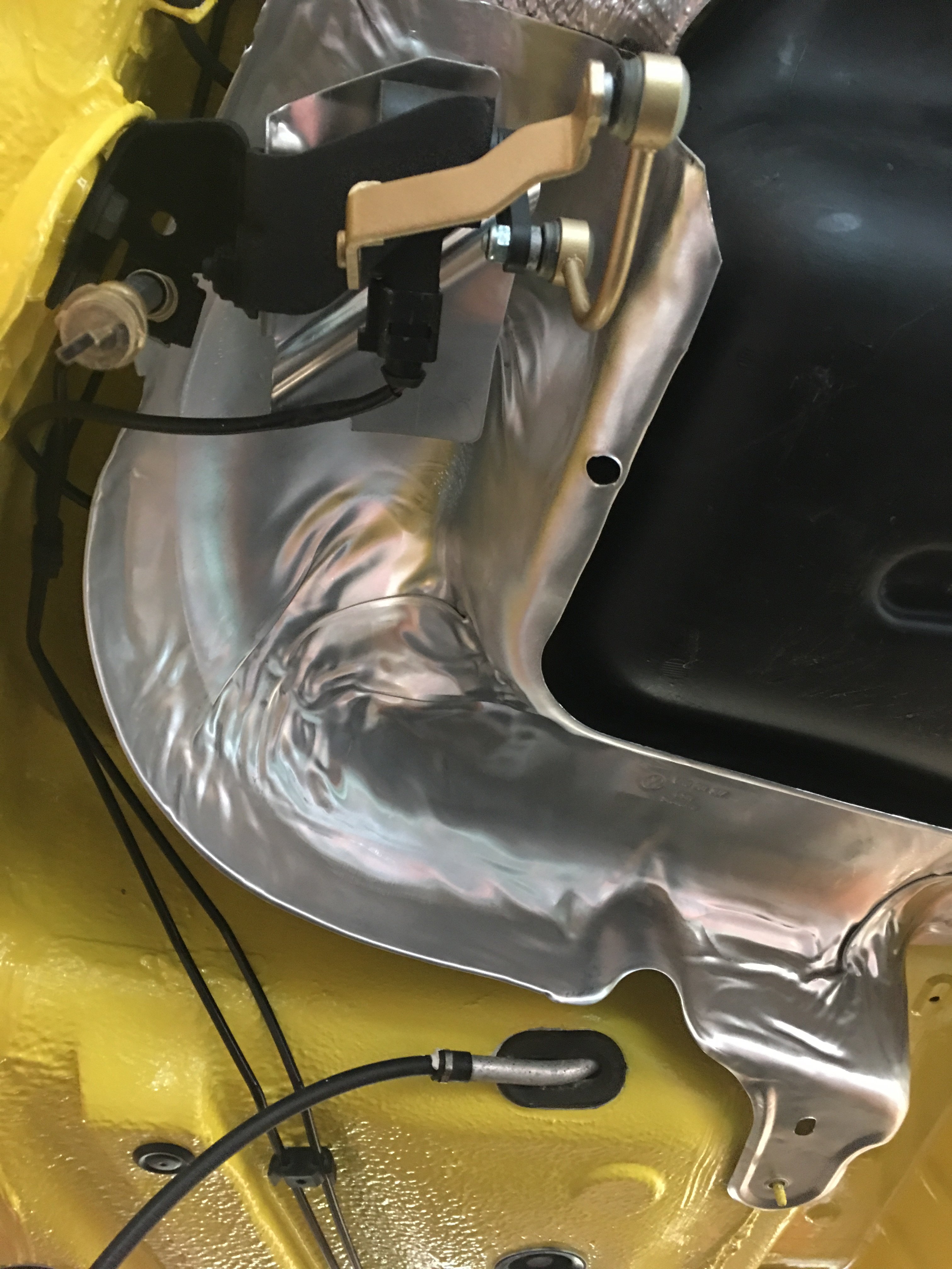

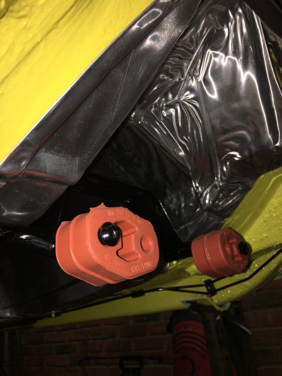

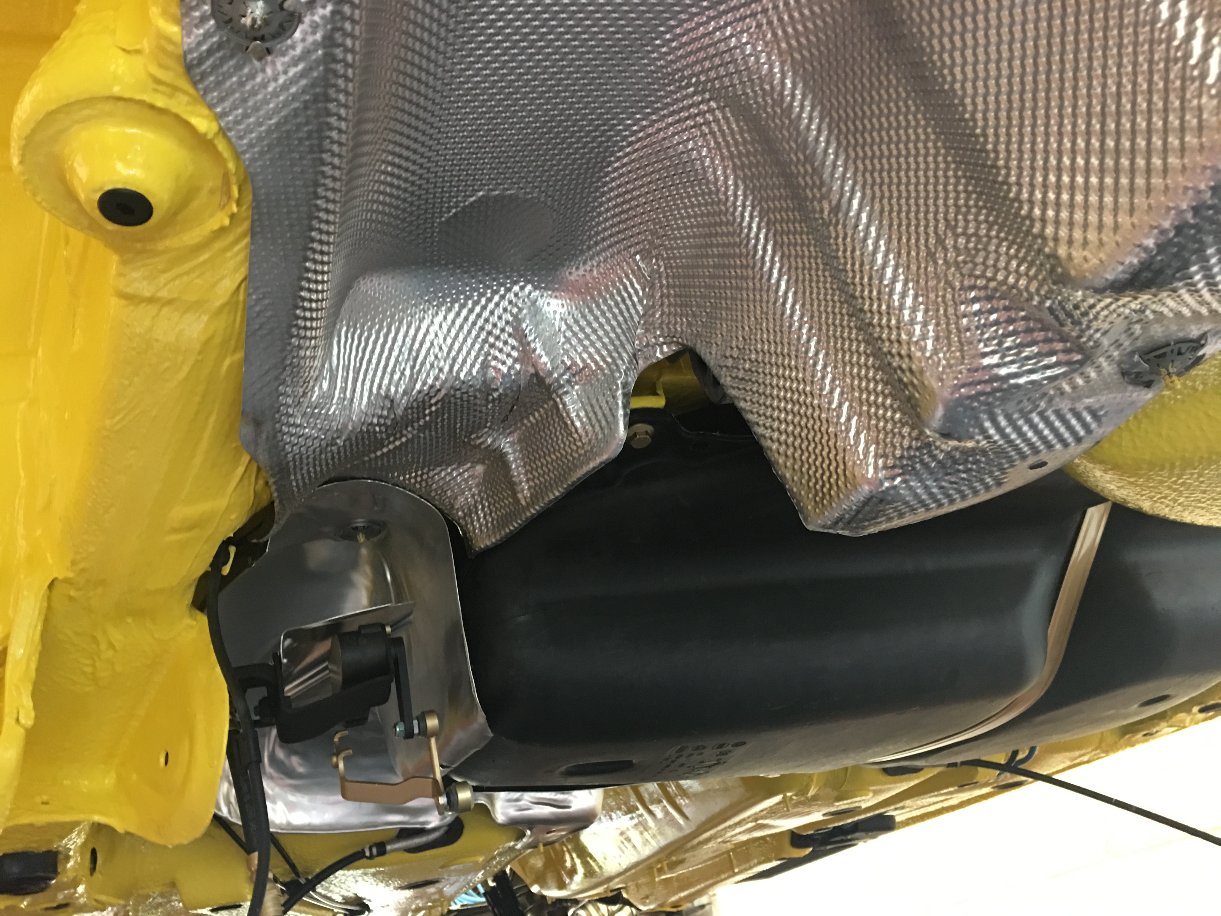

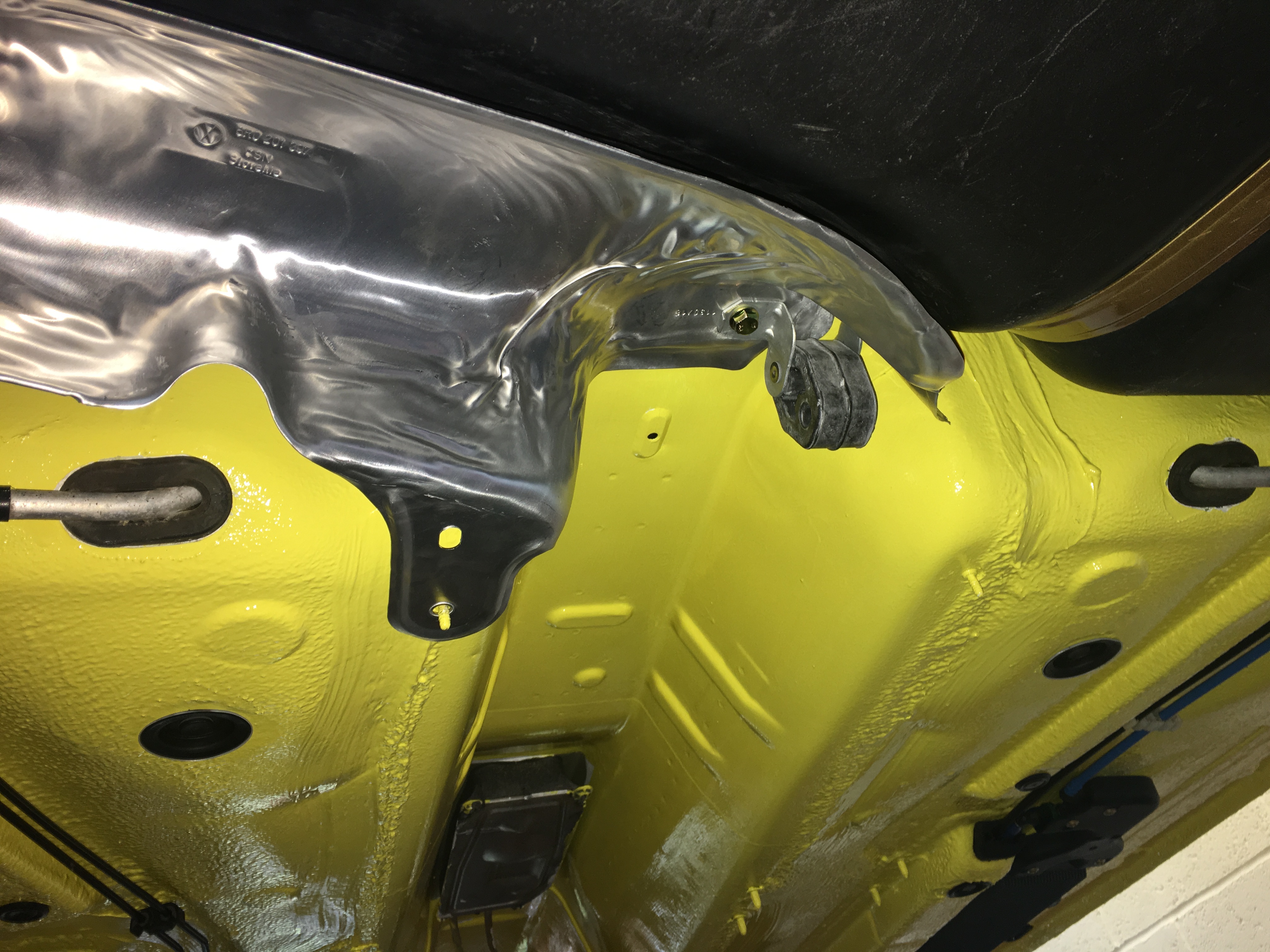

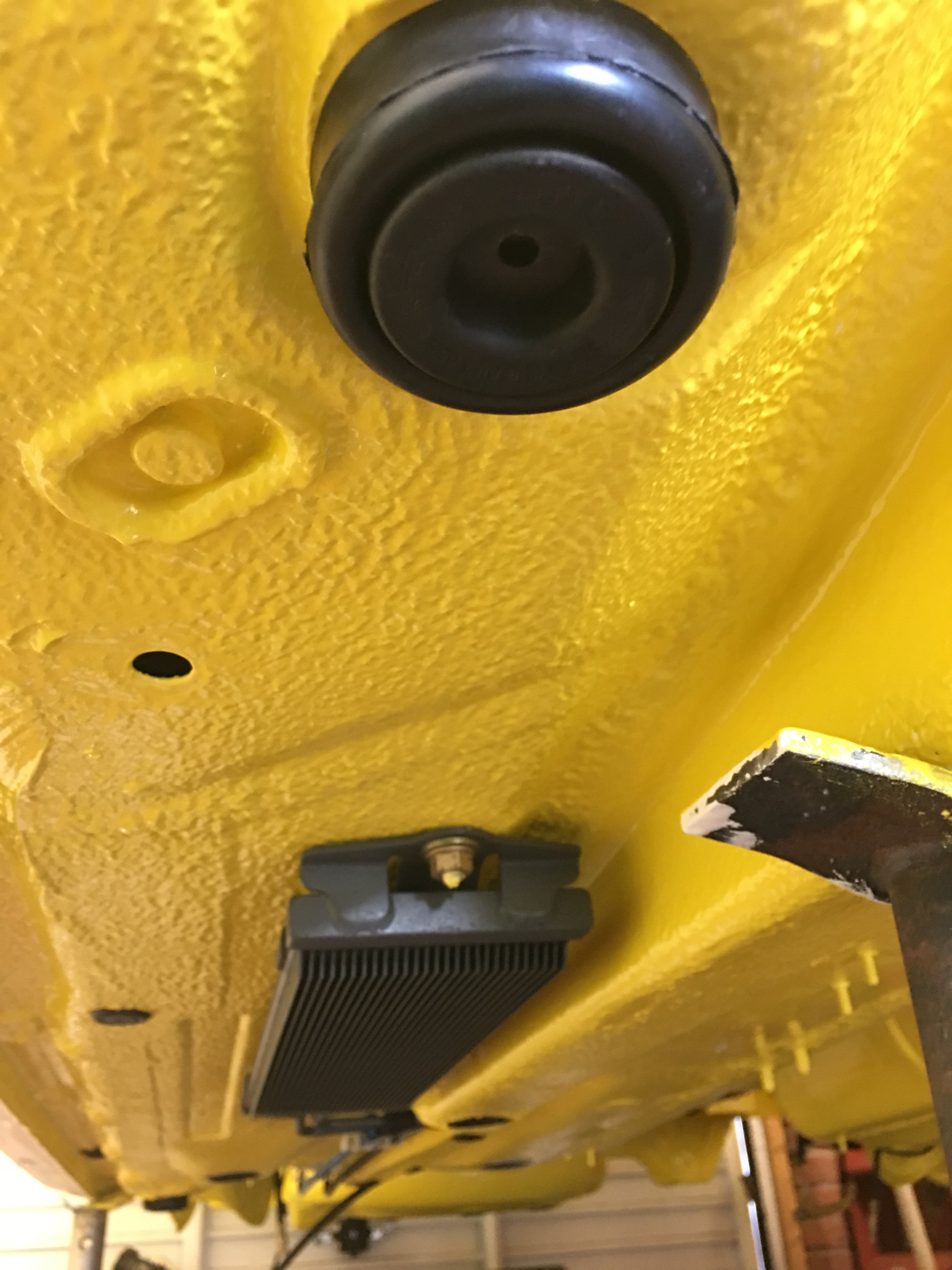

Fuel tank has been refitted, along with the two rear most exhaust heat shields. New exhaust hangers have also been fitted.
The PAS pipes have been fitted and the N/S/F inner wing has been stripped of the wiring loom, washer bottle and PAS pump. Hopefully get the chassis leg/inner arch in paint by next weekend then we can start getting the rear beam and front subframe refitted.

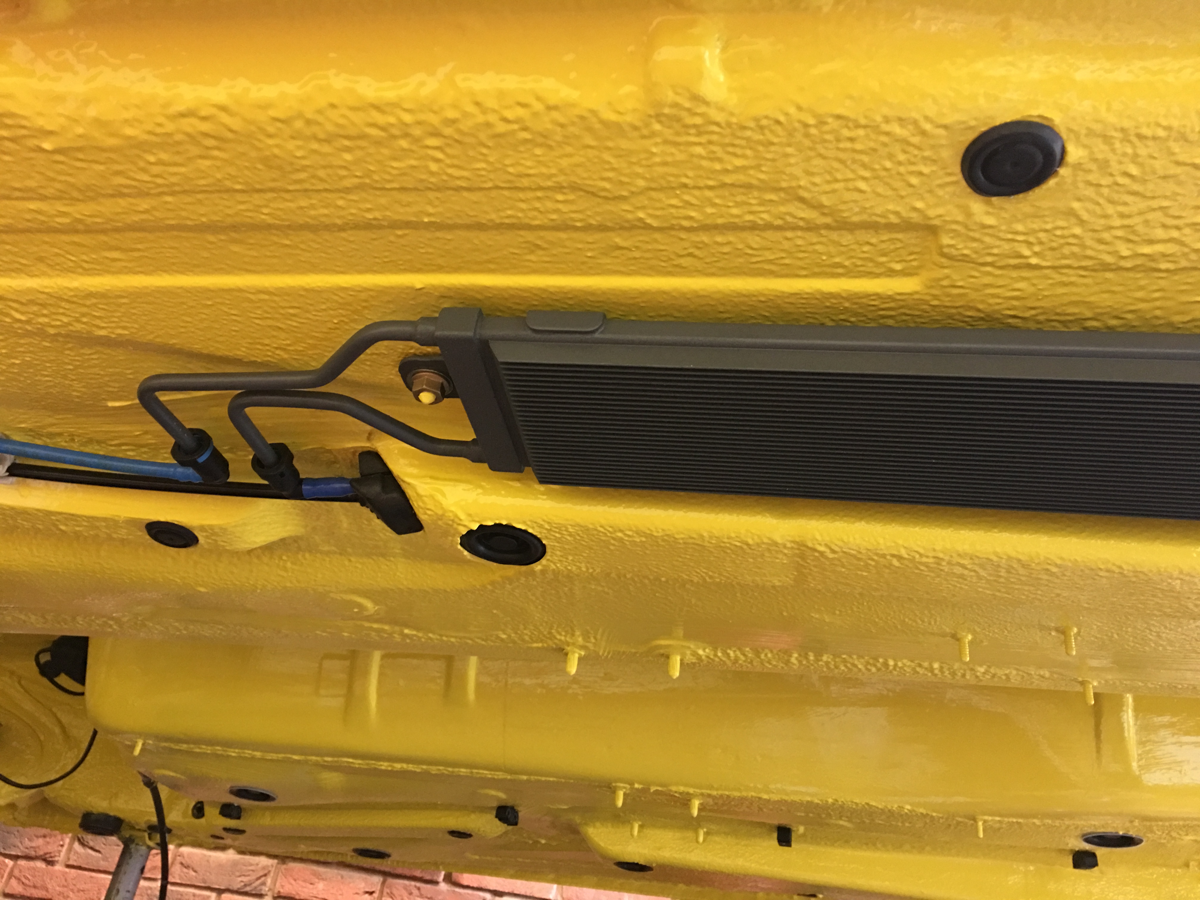

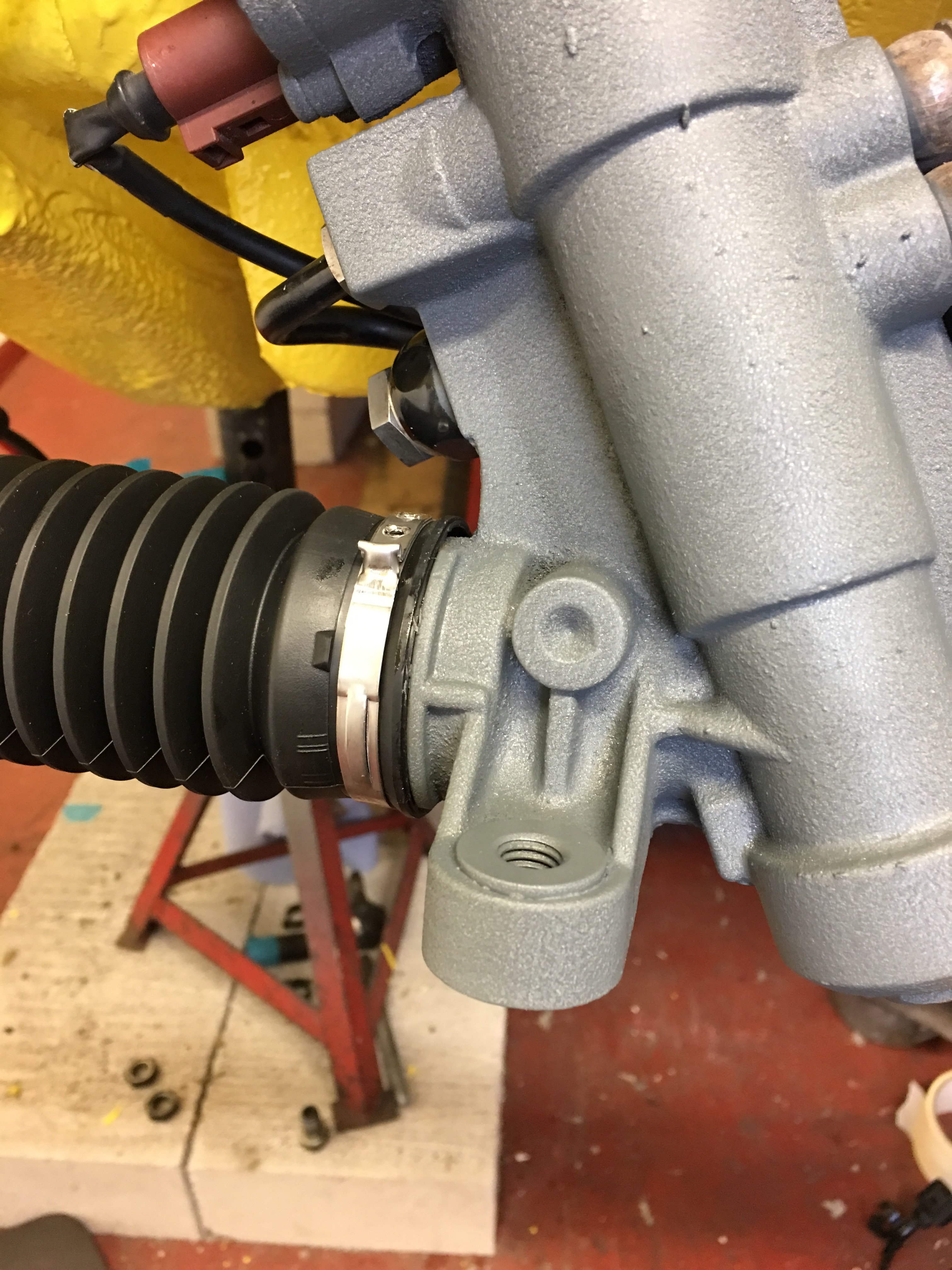

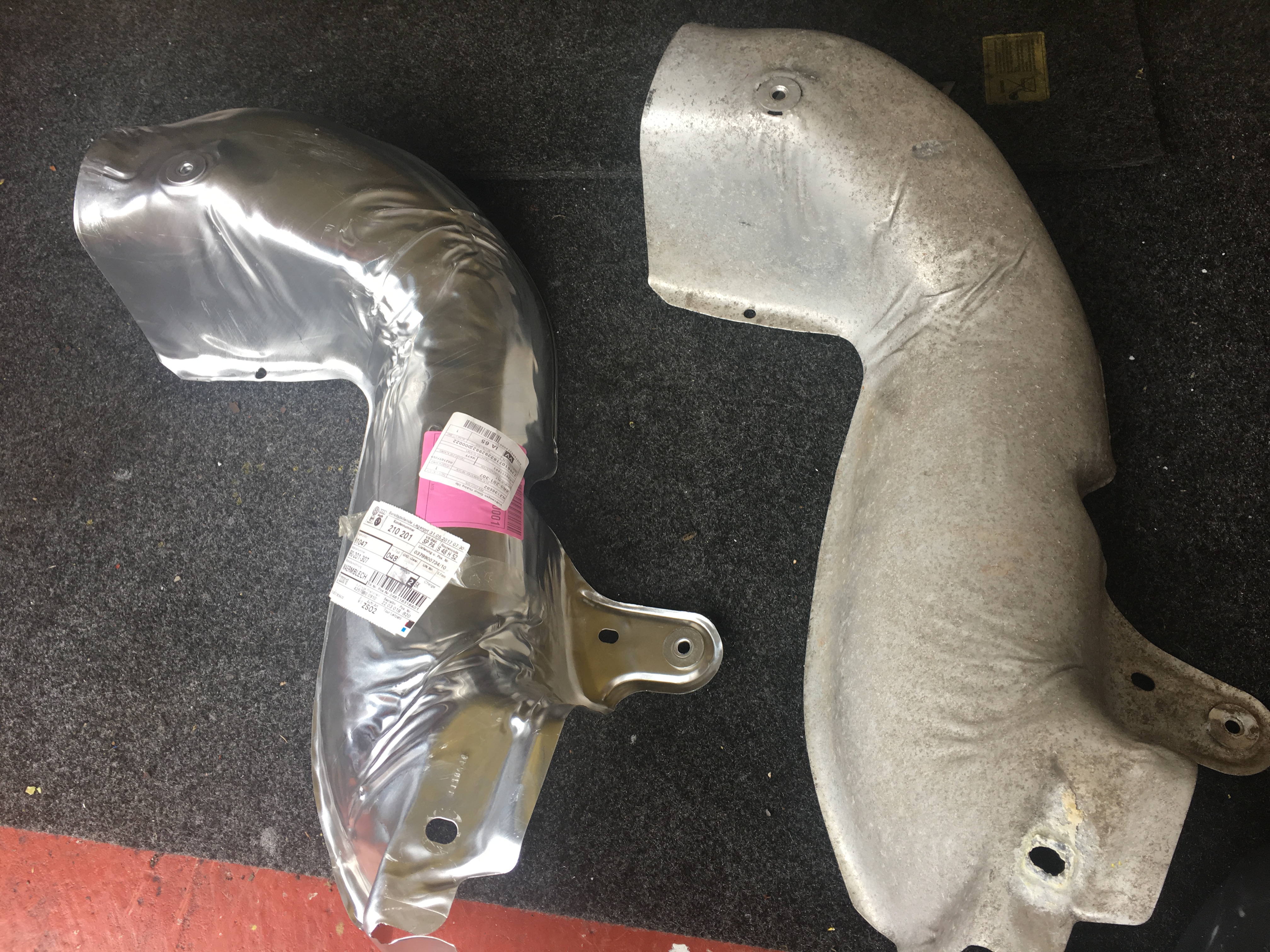

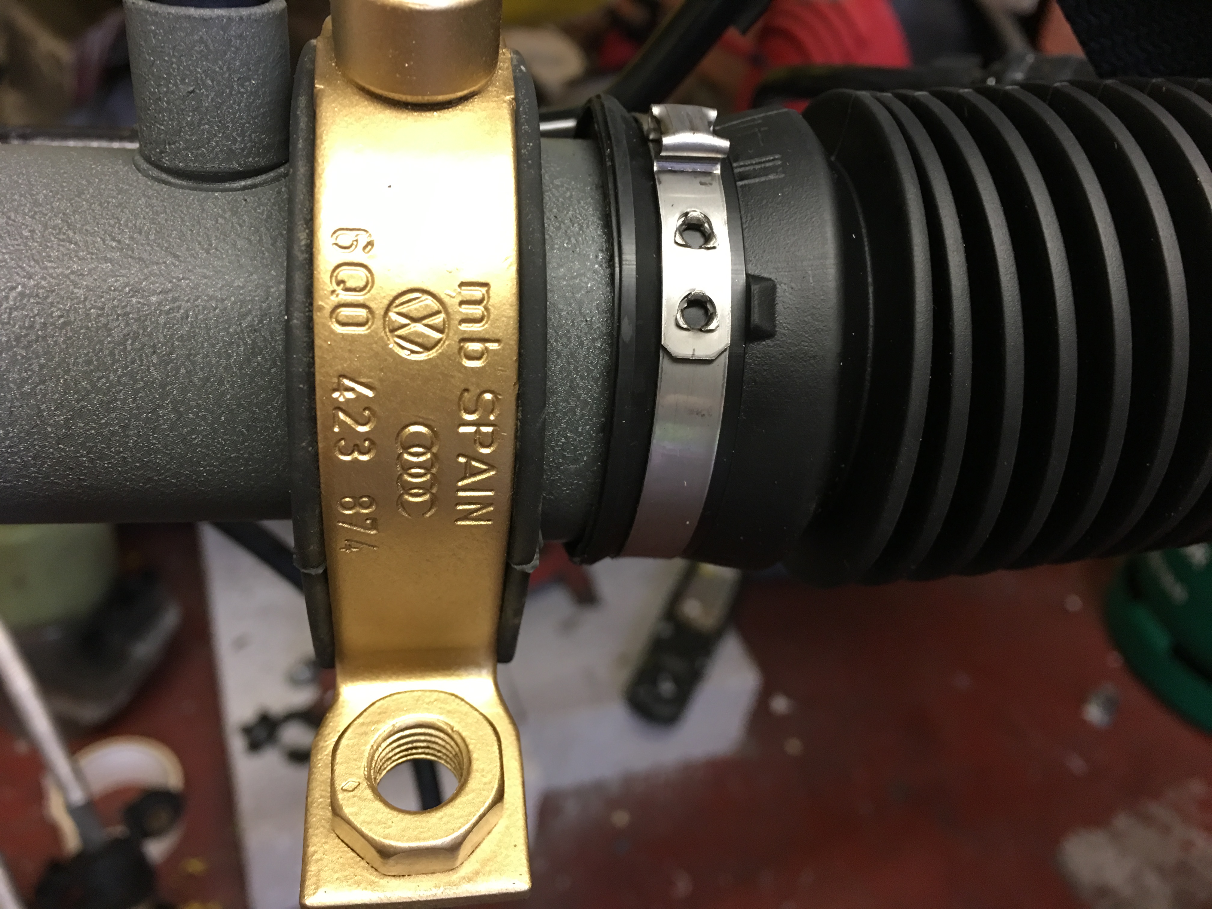

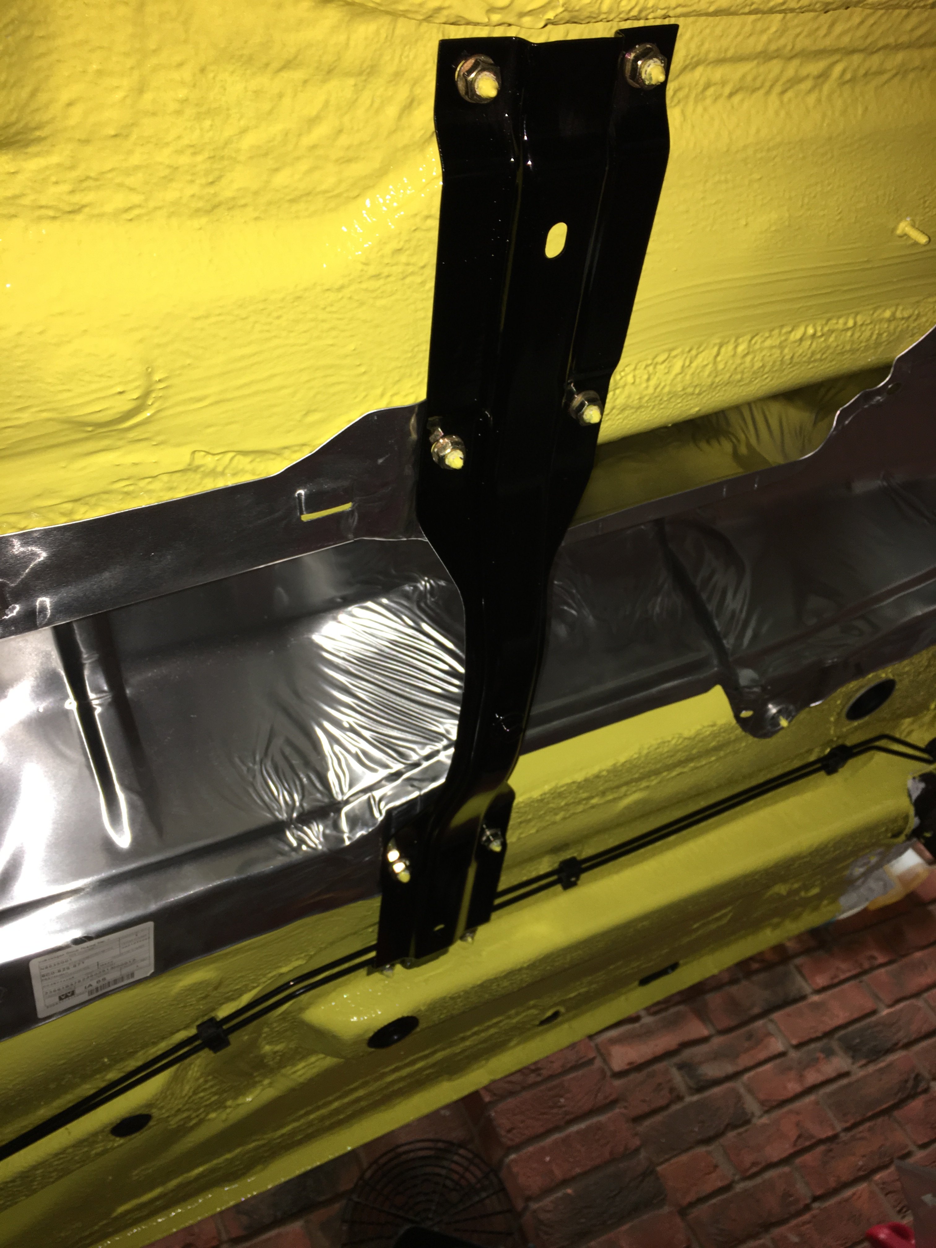

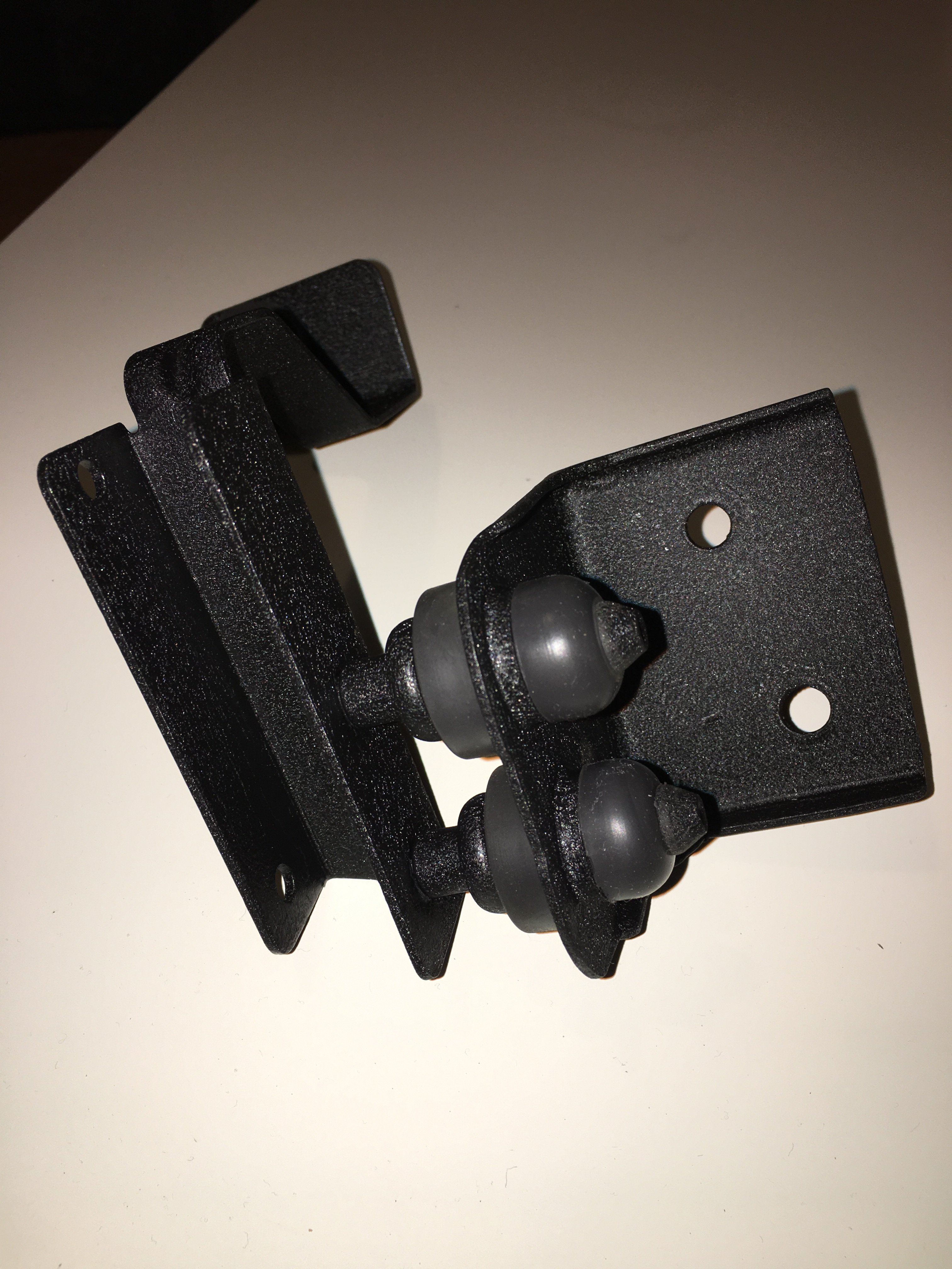

Gear change cable brackets have been refurbished, steering rack stripped, refurbished and built back up with new genuine boot kits and clips, main central tunnel heat shield fitted, powdercoated central chassis brace fitted with new zinc plated fixings, new down pipe support bracket sent for powdercoating and also fitted with zinc plated fixings and new genuine rubbers (funky red colour now apparently)

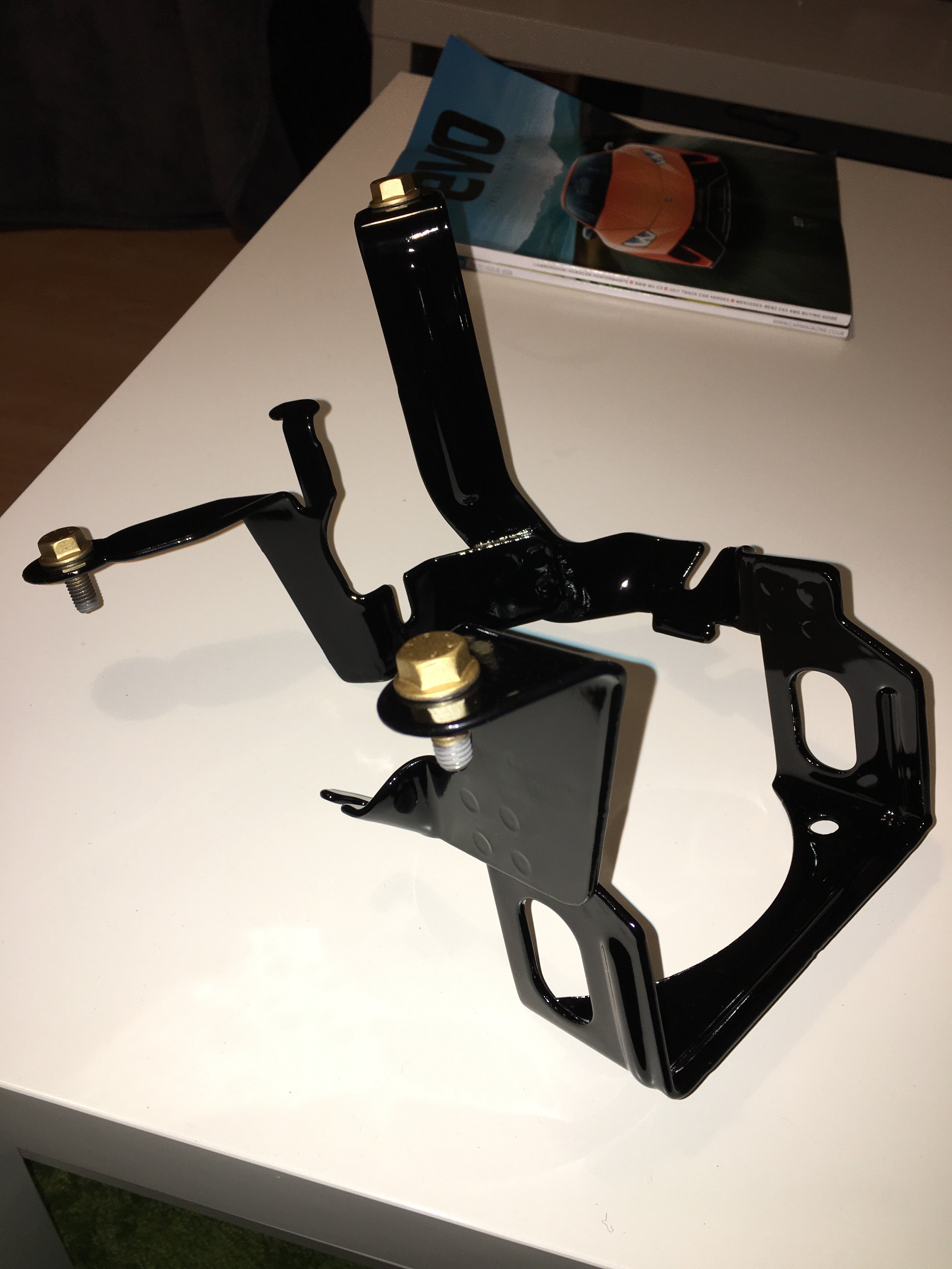

Had a shock when TPS quoted me nearly £150 for a new cradle/mounting bracket for the PAS pump, so I've had the old one blasted and powdercoated and it looks fine, not that it's ever seen!!
