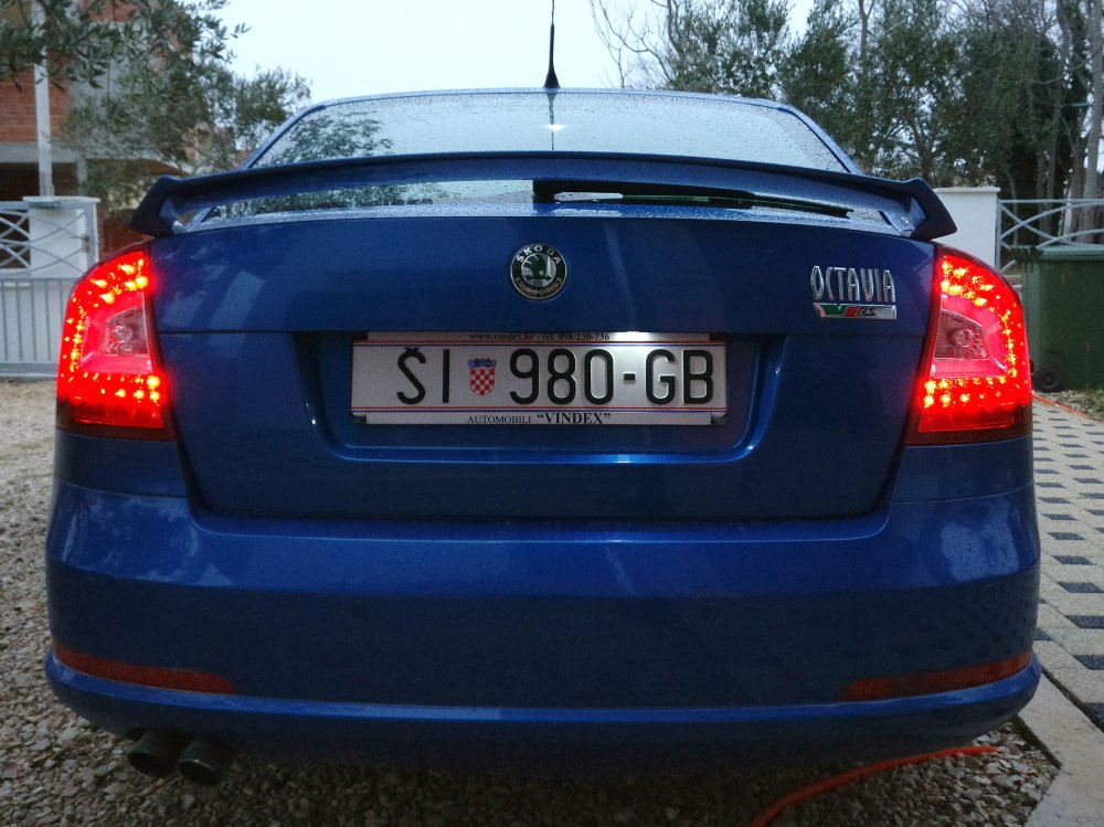

Rear clusters
- Genuine Skoda 1ZD945095A + 1ZD945096A
Reverse lights
- Cheap 30W things http://www.ebay.co.uk/itm/131544161772
Puddle lights
- Superskoda Mega Power http://www.superskoda.com/Skoda/OCTAVIA-II/Octavia-II-09-13-Facelift-MEGA-POWER-LED-mirror-downlight-KI-R
Excelent info as always langers2k
Unfortunately the fog lamps you have are H8 or H11 (I think?) and mine are H1 on the vRS - they don't make them in H1 flavour - also a bit of a pain as I've just looked and there's not much room in the enclosed fog lamp unit to fit good bulbs with heat sinks attached - I might take my chances with some of the cheaper ebay specials as they're only driving lights and I can refit halogens without any problems if I don't go cutting (yet...)
Also, the Chinese OEM rear clusters you fitted, what lamps are LED on those? I saw them but it looked like the indicators where still halogen?  I'm tempted to go down that route despite hearing that additional resistors are needed due to it not being a VCDS option to add the LED clusters - can you let me know how it was to fit them?
On the rear clusters, anything red is an LED so tail, brake and fog. I then added LED P21W and PY21W bulbs for reverse and indicators to make it a full LED conversion. They are also only for the hatch and aren't made for the combi/estate.

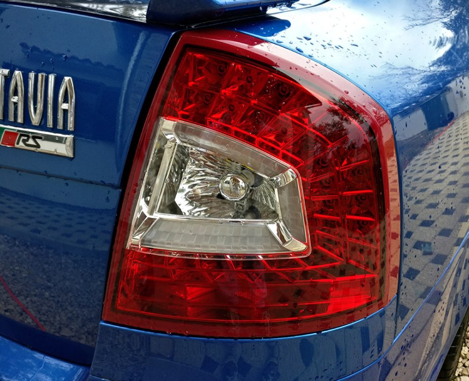

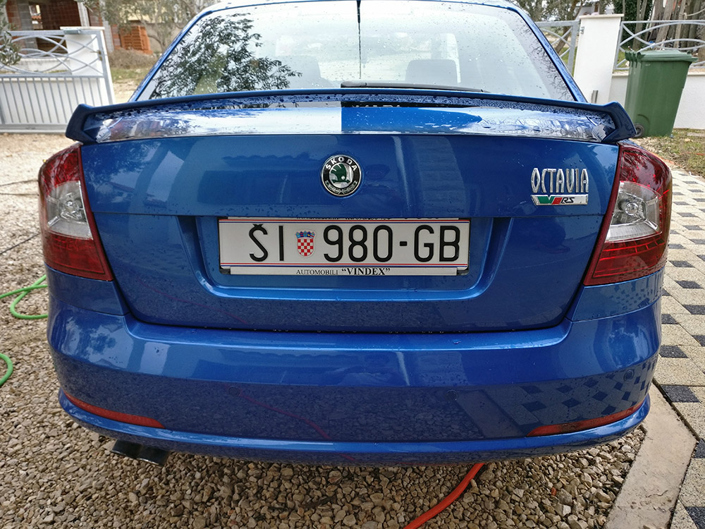

Anyway, back to the lights!!  Litec Red/Crystal lights are on, very nice fitment and light output, phone camera struggles to capture them in low light...

Just a couple more pictures of the Litec units...
