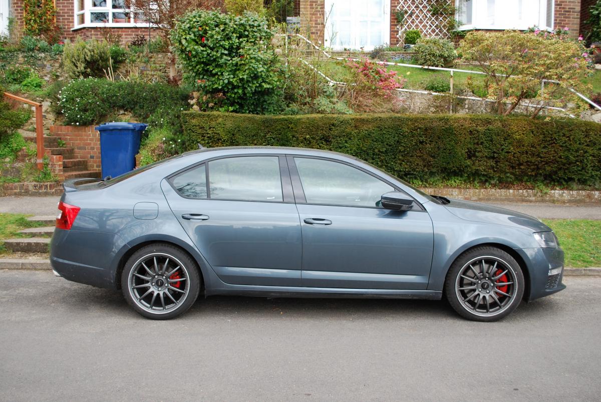

I have fitted Goodyear Asymmetric 3s and have no issues with them. They are also a bit quieter then the Bridgestones which have nasty roar on old coarse tarmac.
They are running on Dynamics alloys (as in the picture) which are 3.5 Kg lighter than the VRS standard alloys and this also helps the suspension cope with the bumps as it doesn't have to work so hard.

really like that setup, Paul - this is my ideal but looks like best part of £2k so far...  :o
