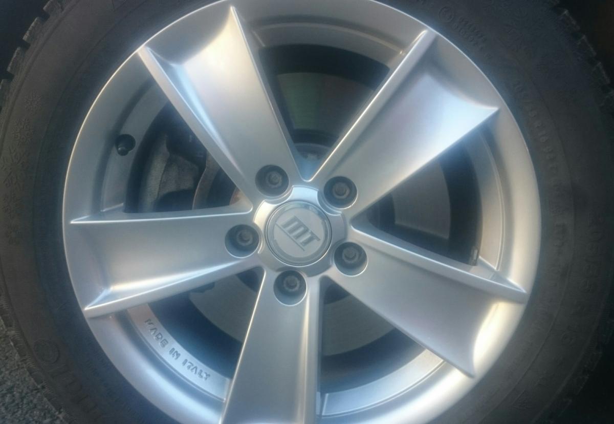

Looks like mine have the 312's up front after all :blush: . I've even read up on how to use a tape measure & verified it myself this morning! Here's mine:
18inch_Gemini_wheels_with_312mm_front_di
Only 35mm from the leading edge of the caliper housing to the inside of the rim so still can't see how a two inch small wheel would squeeze in there.
That is because your 35mm is radius and your 2" is diameter
You would be decreasing the radius by 1" (25.4) giving you a clearance of 9.6mm
Like all said above they would fit (spoke design dependant) but they would be tight

This is how it looks with the 312mm brakes and 16" rims.
