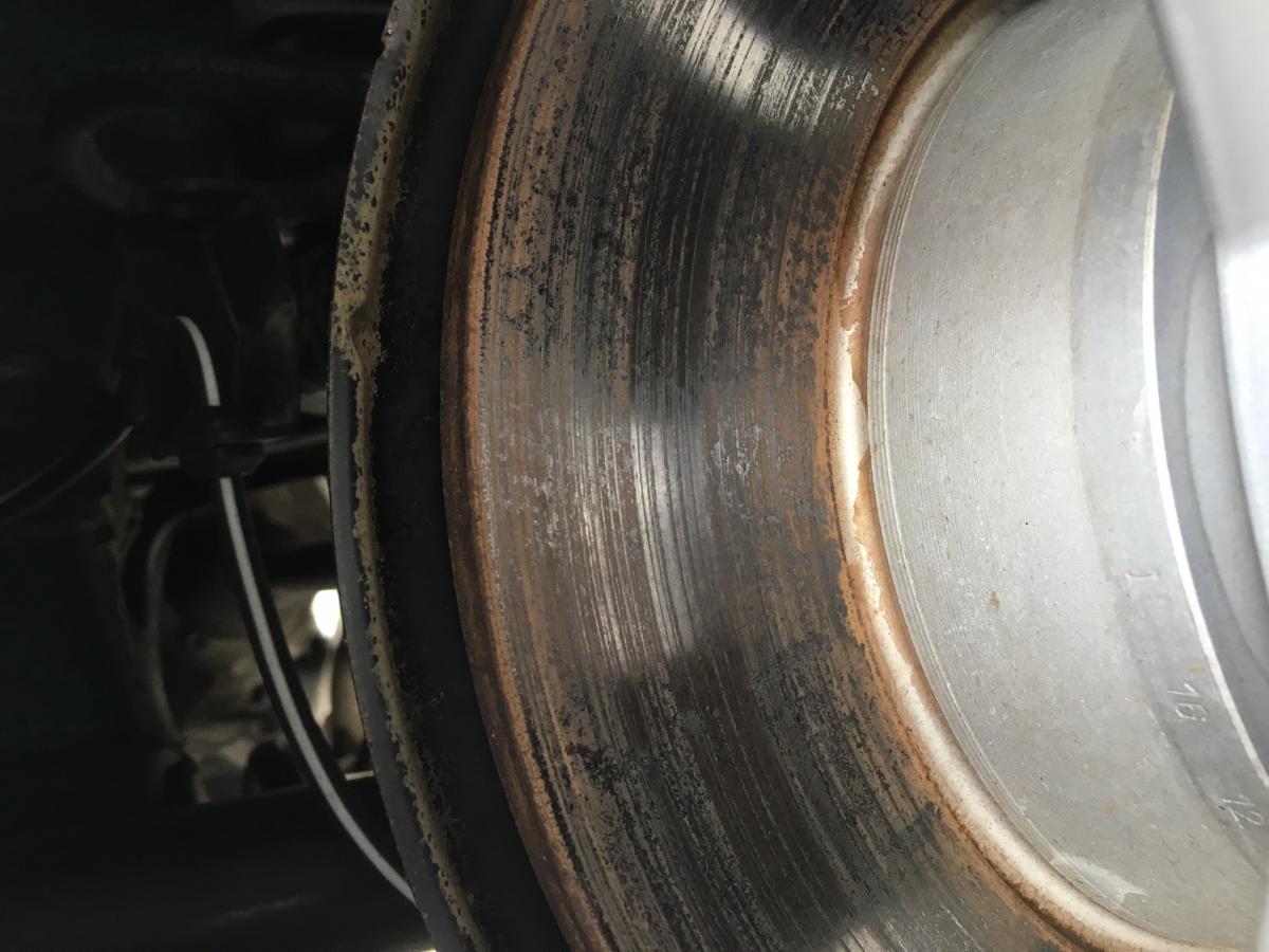

The rear brake discs on my 4 month old Octavia Scout appear to be quite scored and have a bit of corrosion around the edge (as if the pad isn't touching the full surface). I've only had it 2 weeks and bought from a main dealer (ex Skoda UK car).
I don't think the car has been stood around for long as it's got 6500 miles on the clock. Braking from speed I can hear a slight rumble from the rear and a 'pulsing' as though they may be slightly warped. The supplying dealer isn't interested in helping me at all, they just said "it's a used car sir" which is the same response I got when I showed them the half dozen deep stone chips on the bonnet (which they are also refusing to rectify even though a couple are right through the paint layers).
Any thoughts on why the discs might be in a poor state this early on? Will they improve with use or should I be making a fuss at the dealership?

If you are hard on brakes from new before they have bedded in you can warp them from the start, although it is usually the fronts that go as they take the most heat.

Brakes were like that when I collected it, heard the scraping as I drove away but put it down to a light surface corrosion as it had been raining for the past 24 hours. It's not improving though.
I will call down to the dealership tomorrow and mention the '30 day reject' clause, see if that galvanises them into action, the service so far has been diabolical so let's see.
This pic is the OSR;

The reduced rear brake bias means that you do need to be hard on the brakes every so often to give them a good clean up.
There is every chance that the car was stood for a lengthy period, either at the docks or in a dealers compound.
Looking at the picture those discs are not beyond being saved.
Find a quiet or private road and do a couple of pretty hard emergency stops (no need to come to a complete stop) or lightly apply the handbrake (at slow speeds). This should clean them up nicely.

The rear brakes do very little work especially if the car has only been driven with just the driver or driver and front seat passenger. It's worth putting some heavy weights such as couple of bags of sand (well sealed and well fastened down, of course!) and braking heavily as silver1011 suggests. It seems that the pads still haven't bedded in.
As other people have said this is very common.
It's rare for brake discs to warp - it's normally uneven pad deposits.
Are there grooves in the disc surface if you run your fingernail across it? Maybe a stone has got stuck in there and caused it a groove. They should clean up with use and an Italian tune up may help.

Take the car out and work the brakes, hard.

Yep - brake discs warping is almost an urban myth. It is normally uneven pad deposits and hard spots caused by high temps. All are rectifiable by some sensible hard braking.
Cleaning up rears is easier if you are going backwards LOL
A few J-turns should soon clean them up
They should at least offer to strip and clean the rear brakes up, and fill/touch up your stone chips as well as they can.

To me it looks like if you give it a bit of use those brakes should clean up a bit more than they already are. Discs are ten a penny these days, I would just put a new set on if they were bothering me that much.
