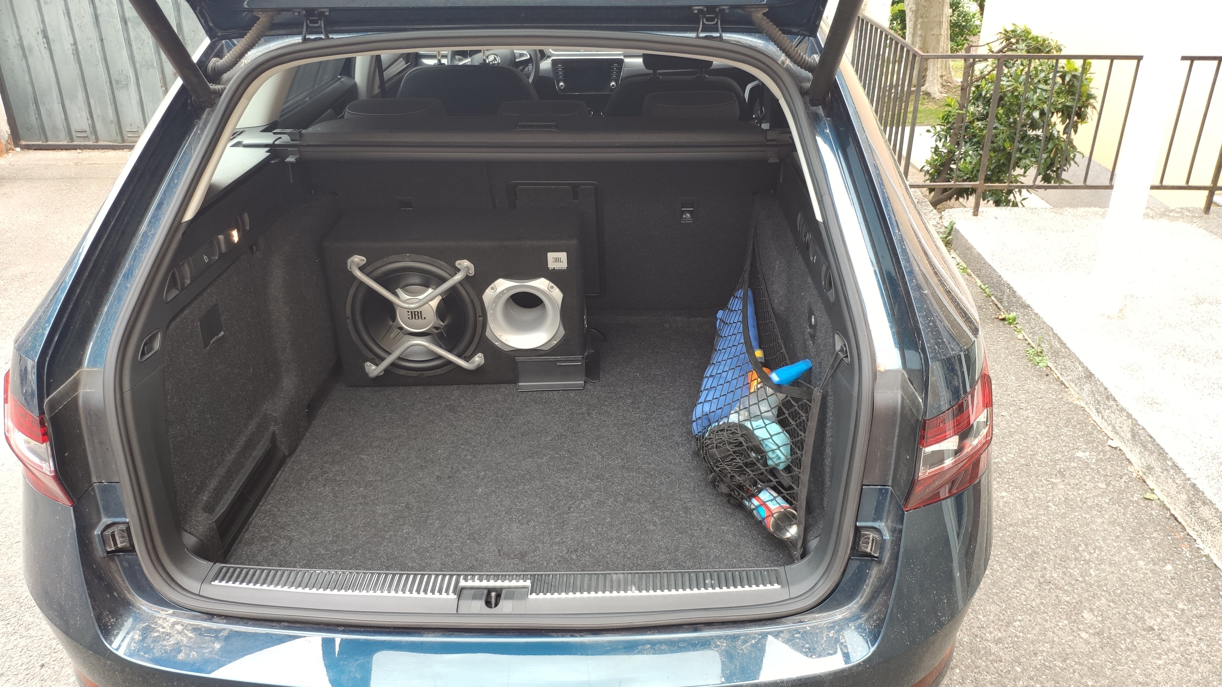

Just to help people looking for an as "factory" as possible upgrade, JL audio now do a 10" Dual 8ohm voice coil sub - 10TW3-D8. Combined with the box from basser, it effectively becomes a upgrade using all the standard wiring and just removing the canton and putting the basser box/sub in place.
I'm in the process of contacting basser to get a wagon sub box shipped to australia, and getting one of the 10TW3-D8 imported (australian importer of JL does not bring the D8 version in). The sub is not cheap ($500 AUD) but has great sound quality and is a proper sub. The canton amp should be enough to power it to OK levels, while keeping everything easy to switch back to factory in a few minutes. No running wires, or getting convertors etc.
For me it's not cheap ($500 AUD for sub, plus about $200 for the box) but it means its basically a factory setup that I can switch out when I go to sell the car and leave no marks / holes/ anything. I'm also doing the whole boot / rear arches with sound deadener so car should be a bit quieter and actually be able to play proper bass in music. I'll post some pics in a few weeks when its all done.
Thanks to OP for starting the conversation, it's made me look to upgrade the sub which is abysmal - the rest of the system is decent. I'm confident (especially knowing how good JL products are) that this will give me exactly what I want.
An 8 ohm dual voice coil from JL is good news. But with a sensitivity at only 82 dB I'm afraid that the Canton sub will be to small. On the other hand; I dont know what sensitivity the Canton speakers in doors has, so maybe it will be a match after all
Im not expecting it to pound the house down, but rather provide a level of bass that the system should have had to begin with. ~50w per VC should be enough to improve it at normal listening levels. It's enough for me anyway, and if it's not, well at least the sub is capable of taking a massive amp and really shining anyway ha ha.

Basser got back to me. The box cutout doesnt quite have the same shape required for the TW3. Waiting to hear back if they can mod for me to suit, before I figure out how to mod so I can use it.

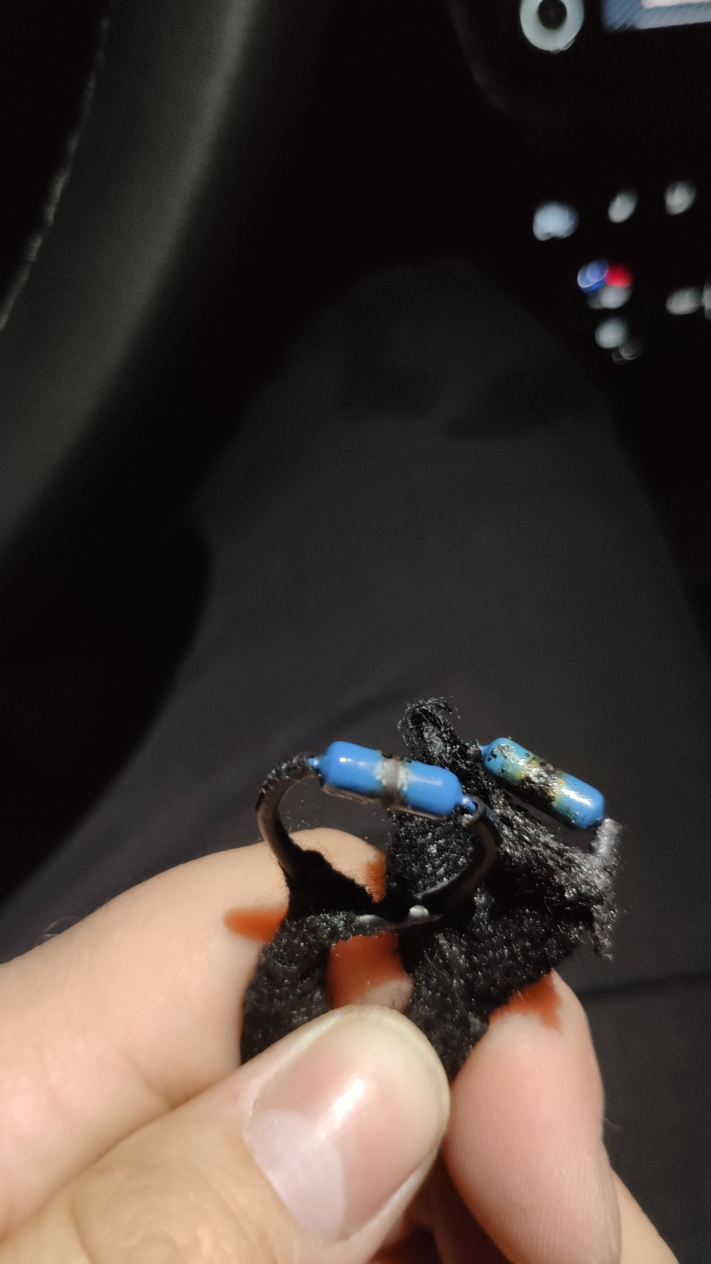

I went with logic and got two 0.5w 8ohm resistors. Seems to work so far. So one resistor per "coil" (cable pair +/-). I'm extremely happy with the upgrade. I got Alpine amplifier 500w 2ohm or 300w 4ohm and some old JBL sub i found and its already MUCH better. I'm soon getting a better sub and it will be even better. Compared to stock its really big difference. The deep tones are actually deep and at high volume there is zero sound distortion. However it does take some space in the boot. Though I've hidden every thing where canton sub is and it looks amazing. The sub-woofer cable comes out where seat "clips" in. On attached image the sub cable goes out of the compartment, but after tests I've hidden that one too. Will attach image later tonight 😃

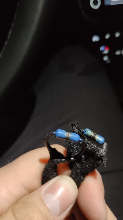

To quote my self. The resistors part was really bad idea. I blown them after trying sub a little higher... I am not sure what to do here haha... It did amplifier/sound start 4/4 times though.

Yes. Both. Left channel 1 set of wires, Right channel the second set. For me without resistor it works 9/10x. I reset codes via ODB and it works again. Its annoying but for now its the only solution.
Resistors will just waste all the power from Canton amp and convert them to heat. 50w per channel would be sufficient (checked some German forums), but it would create a lot of heat... Some people there wired up some sort of delay chip so when powered on 5sec current flows through resistor, then it switches to the main amplifier (external). But I am not skilled enough with electronics to make something like that. Also all the power has to flow through then right? I don't really know.

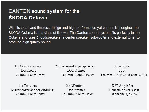

Problem is like mentioned earlier that the Canton subwoofer has two voice coils, each with a impedance of 8 ohm. And that is something you wont find I'm afraid.

In MK3 the Sub is 8 ohm total independence. 4 ohm per coil...
So any 8ohm sub would work?
The Canton/Skoda website says it's 1x4 / 2x8 ohms. A  1 x 4 ohm driver is much easier to find than 2 x 8 ohm.
So does that mean the 2 pairs of sub wires are joined at the amp end?
