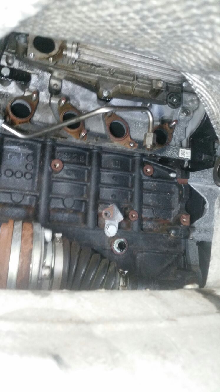

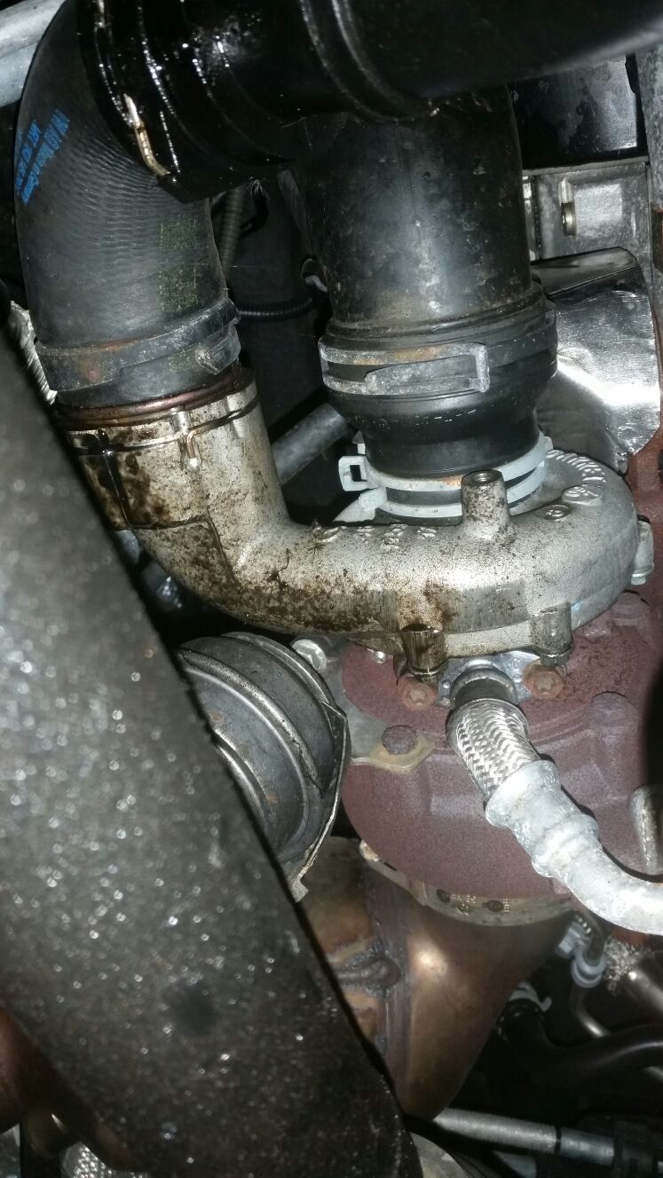

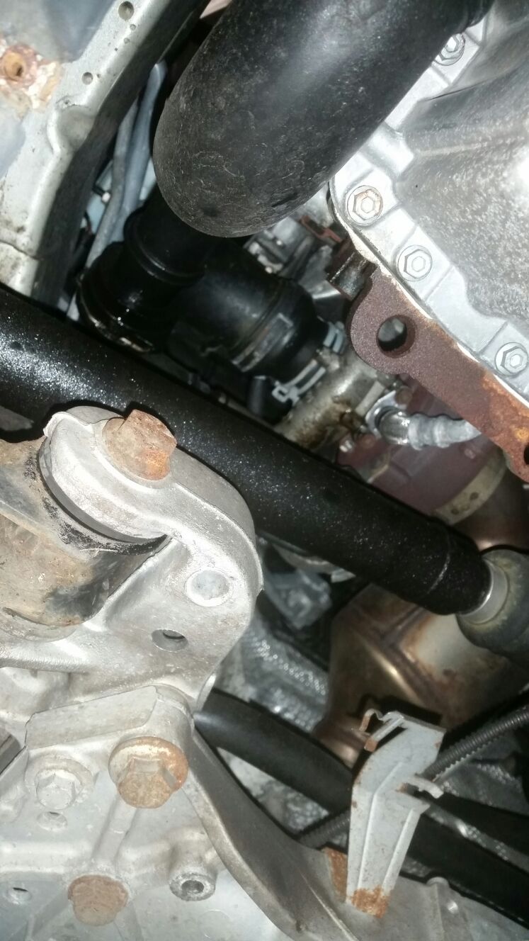

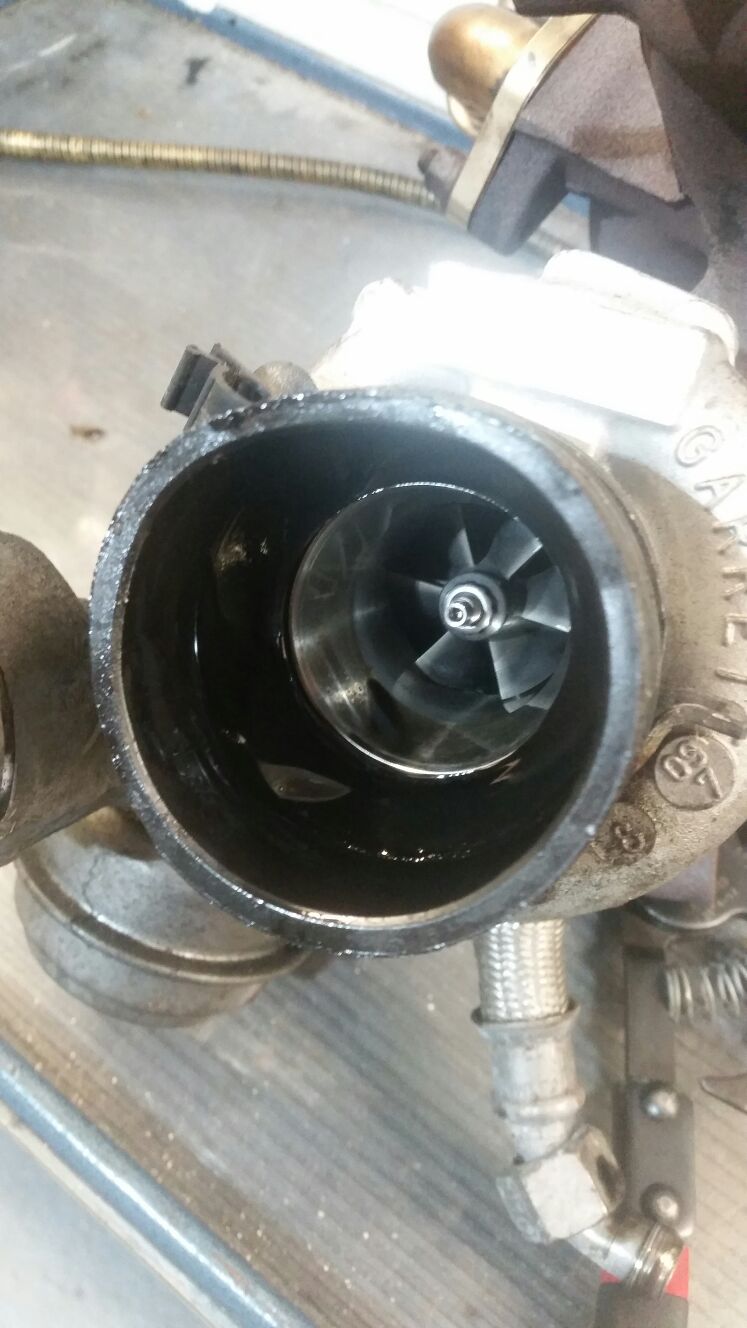

Morning all.  To answer the questions in one go --  yes we have had the car from new  and its only been driven by us. The mileage is genuine.    It did fail on emissions  --  apparently the turbo had leaked oil into the engine , so burnt oil in the emissions .   The garage was a local  VAG specialist  , we thought we would try out  for a service.  It was due an MOT. They dont do MOTs themselves  and took it to a general garage on the same estate.  May just have had the one MOT charge , will have to check the breakdown again, but its not that part thats worrying.   They send some photos after OH requested which Ill try and post later.
post-146567-0-94358900-1478201100_thumb.jpgpost-146567-0-52704700-1478201133_thumb.jpgpost-146567-0-28180500-1478201169_thumb.jpgpost-146567-0-94958600-1478201189_thumb.jpg
Not sure that these say much to help - should have had  a look at the parts at the time .
To be fair,  OH has  had the car out today for a run  and says it does feel as if its running slightly better  (not that it was noticeably below par before )
Edited by Yop
I'm no expert on Turbos but it does seem pretty oily and looks like the seals are letting go.
If that is your turbo, it seems it would need replacing sooner rather than later.  I'm not sure how the MOT found it, I mean oil leaks are hard to spot with the bottom tray on and they don't remove that for the MOT.  I think you suggested the oil burning was causing the emissions to fail - hadn't heard that before I suppose it sounds possible. Then the Garage went looking for a problem....
I'm open to be corrected but that is how it all appears and plausible to me on seeing your photos....
edits: typos and grammar
Edited by TheClient
Hopefully you're right  The Client,  I  think we maybe just got a bit paranoid after having  a radiator go on a fairly new car, and now a turbo at such a ridiculously low mileage  -----  re the photos,  it doesnt take much lack of faith to wonder  if  they are even of our turbo.  However,  I guess we have to just get over it now  , and hope we havent been fleeced . Thanks for the replies  everyone.
Ask for the replaced bits back, If they can't return the bits they  might have gone missing    :notme:
