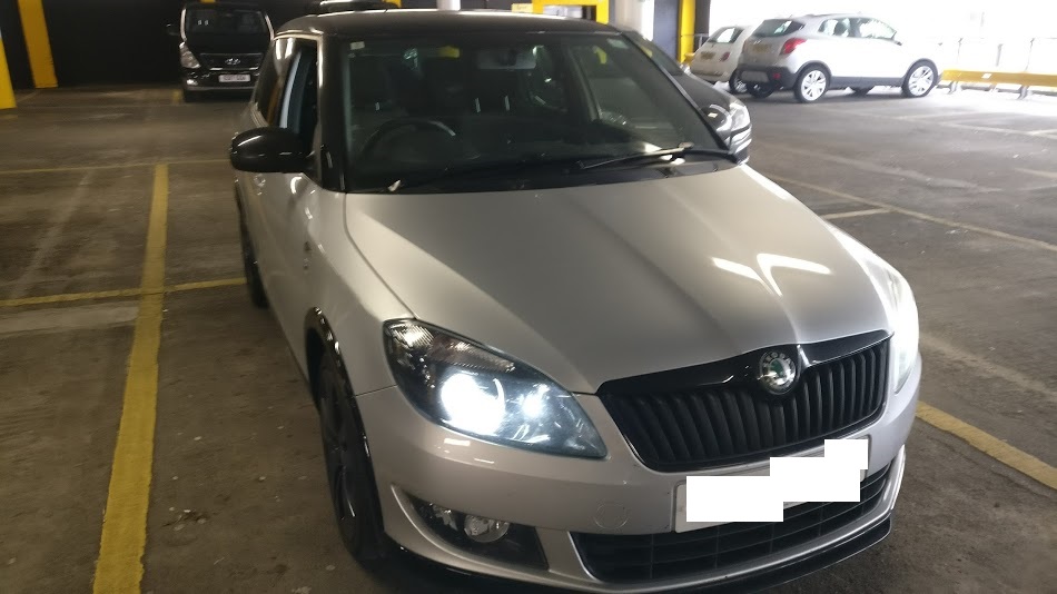

I've changed every bulb front end bulb apart from the fogs on the Monte Carlo I have. The DRLs and Side lights are 6000k and the HIDs I've installed are 5000k.
Here's a picture with the HIDs and Side lights installed on my Monte. The 6000k CREE LED side lights seem to work well with the 35W 5000k HID Kit I have installed.
Great info, thanks Abaday789.
Ash!!
