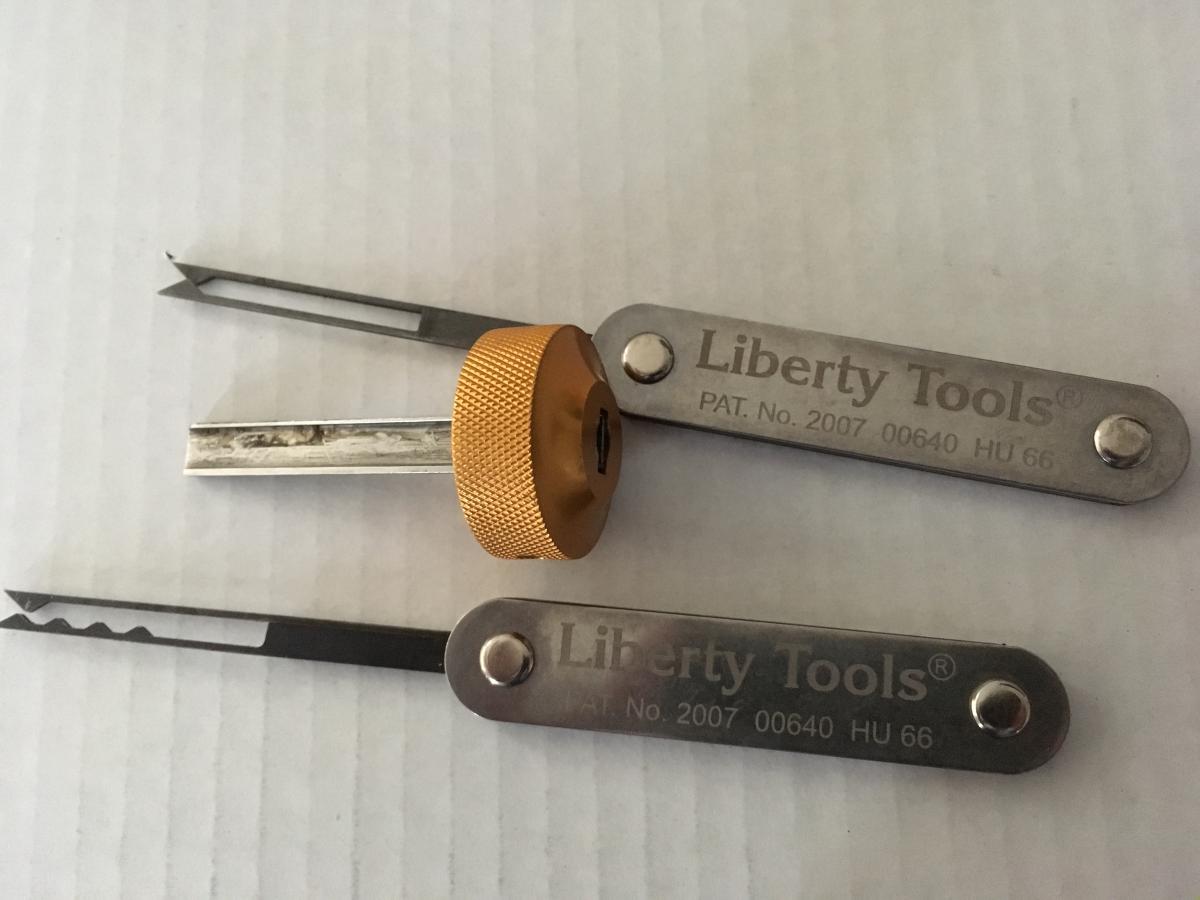

This photo attached is of some of the liberty tools which belong to my mate who is a locksmith...they work pretty slick but not been tried on any modern vag cars...I'm tempted to see if they work on my 66 vrs....

I suggest the above tool is probably the most likely option in that case....
