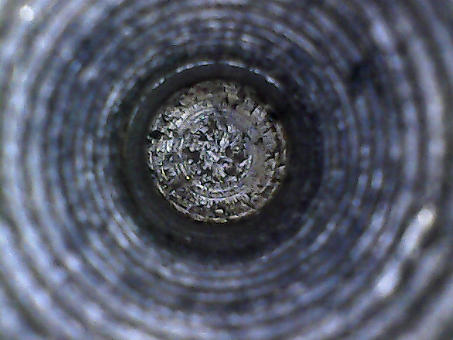

From what I could see with a torch before, all the holes looked clean. This morning I stuck a camera down all the holes to try to get a better look. That was all I could do before the rain set in.
Unfortunately,  the kind of inspection camera I can afford that is thin enough to fit down a 11 mm hole is fixed focus and low resolution, but the image clearly shows that the thread does not go down to the bottom of the hole (none of them do) and that the hole is clear to the bottom. You can see where the end of my screwdriver scraped the bottom of the hole when I was using it with some industrial grade paper towel wrapped around it to clean out the wd40.
It's also clear where the bolt has bottomed and polished the end if the thread as I ran it up and down with wd40 to clean the threads.
I'm putting it down to manufacturing tolerances. I guess it was near the knuckle before I had the head skimmed. My memory of the machining limit was getting on for 2 mm before I took the head in - it's just about 1 mm now. Difficult to tell exactly because the notch is rough cast not machined. So maybe they took getting on for 1 mm off?
I've decided to grind a mm off the end of the new bolt for that hole. Don't want to take much off because the thread in the block is not much more than 25 mm judging by the marks on the old bolts when they came out. I'm actually more concerned about the somewhat tatty threads I can see with the naked eye in nearly all the holes in the block, but there's nowt I can do about that. It's not nearly as bad as it seems in the photo - pixelation due to the appalling resolution - 640 x 480.
The other thing I can do is **gently** lower the head onto the block without a gasket, fit the bolts finger tight and see if any actually bottom out then.post-151435-0-54943900-1484011405_thumb.png
I took the liberty of enhancing the photo of the hole a bit. Everything looks OK except that the hole is indeed not deep enough due to a machining error.
I suggest that instead putting the head directly on the block, use 1 mm thick cardboard to act as the crushed HG. Of course you'll have to cut 14 holes in it. Next screw in the bolts finger tight. If they will touch the head you're good.
For extra care you can smear the bottom of the hole with a bit of grease to see if the bolts touch it.

I carefully removed the head and  ran a bolt down each hole a couple of times to make sure the grease got to the bottom of the threads in the block, removed the bolt, cleaned and re greased it each time. Not over happy with the feel of the bolt as it went in the first time - the next time I do this (hopefully never again on this car) I think I'll stick with oil.
Then cleaned the block again with with white spirit followed by acetone, cleaned the head again with acetone, fitted an new manifold gasket the (right way round - it's symmetrical), spread copperease on the manifold studs, fitted the head gasket to the block (checking it's the right way up) and laid the head on the gasket.
