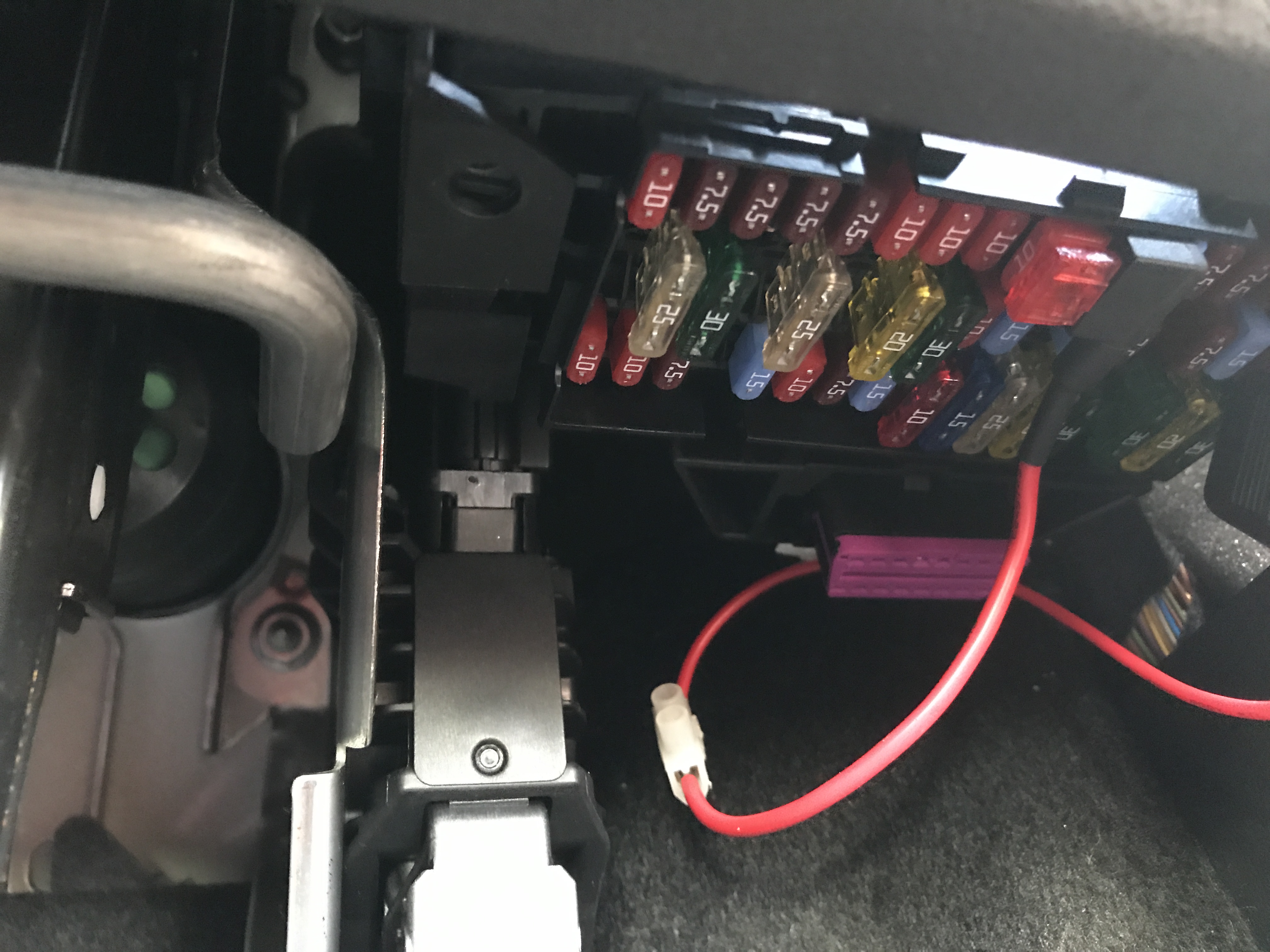

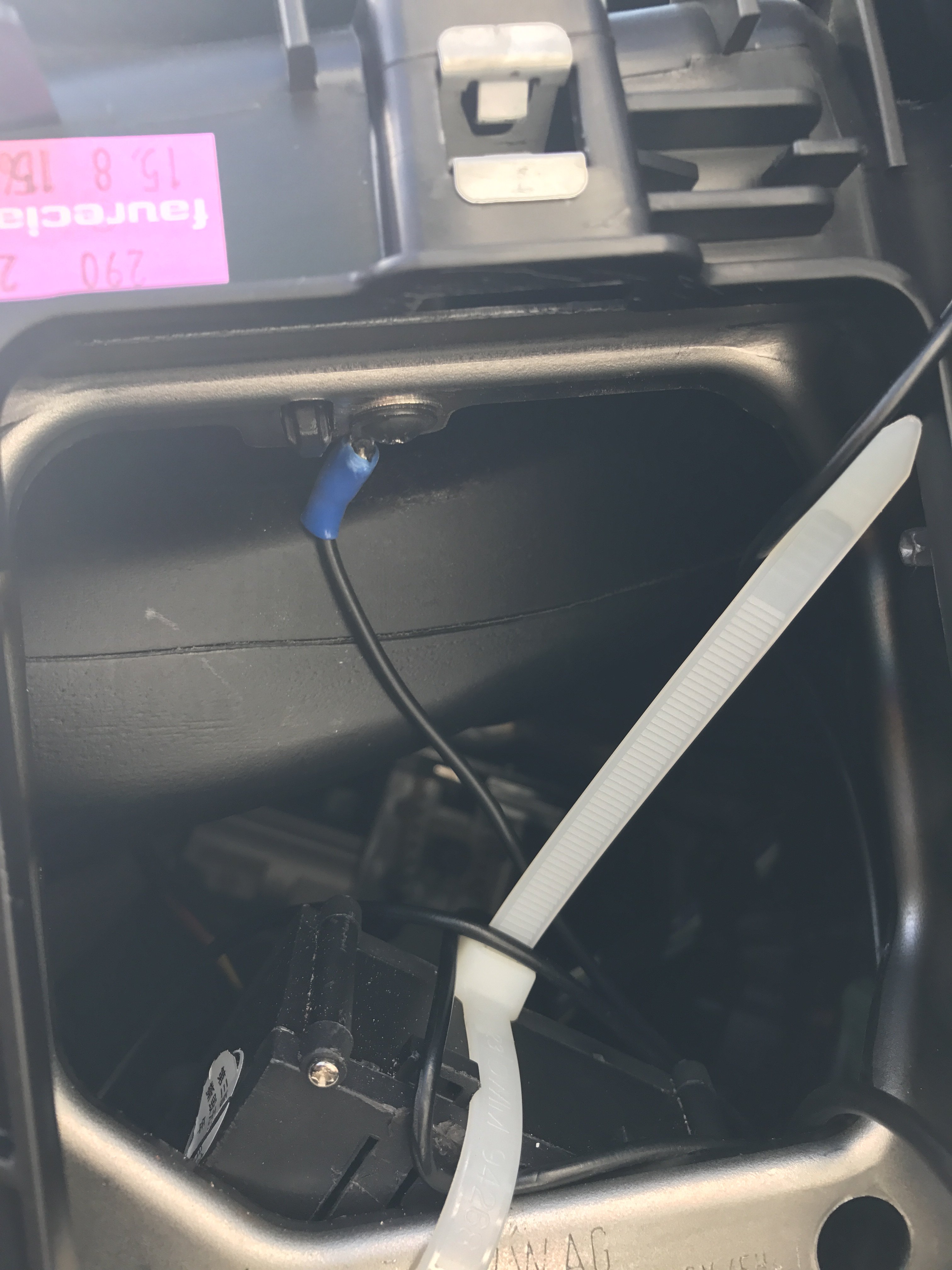

Thanks to Photobucket and it's new terms and conditions all the photos on this thread (and many others I've made over the internet) have no pictures so I'll need to fix that at some point in time! But for now I should go over the dash cam install for those interested. It's very easy to do. This is how the kit that I bought comes IMG_5830.thumb.JPG.b01c69c2efe266a026227cc3a174ed55.JPG
I snipped the original hoop of the positive cable and added a micro fuse end with a dual fuse slot using screw connectors (will solder later).
I prised off the dash end panel (been off so many times now haha) and quickly found a suitable earth on the dash support bracket
Once that was attached I ran the positive down to the fuse box and used this fuse for power
Once the cables were all tidied away and the 12v socket firmly held in with black tape it was time to bundle the wires and cable tie them together and shove them behind the dash and pop the end panel back on. I've also stolen a clip for the wire on the screen from my Dad as he had some left over from his Blackvue install but I forgot to take a picture!!
I'll get some footage up soon once it's recorded some as it's been off as I've only just wired it in! Approaching 6000 miles now and still going strong :D
Which fuse number (controls what function) did you piggyback onto, and is it a switched fuse?
Thanks in advance.
J.
Hi, I’d need to check that, car is actually with Skoda for its first service as it’s just hit 10k! When it gets back I’ll remember to double check, but I'm pretty sure it’s the 12V socket fuse.
