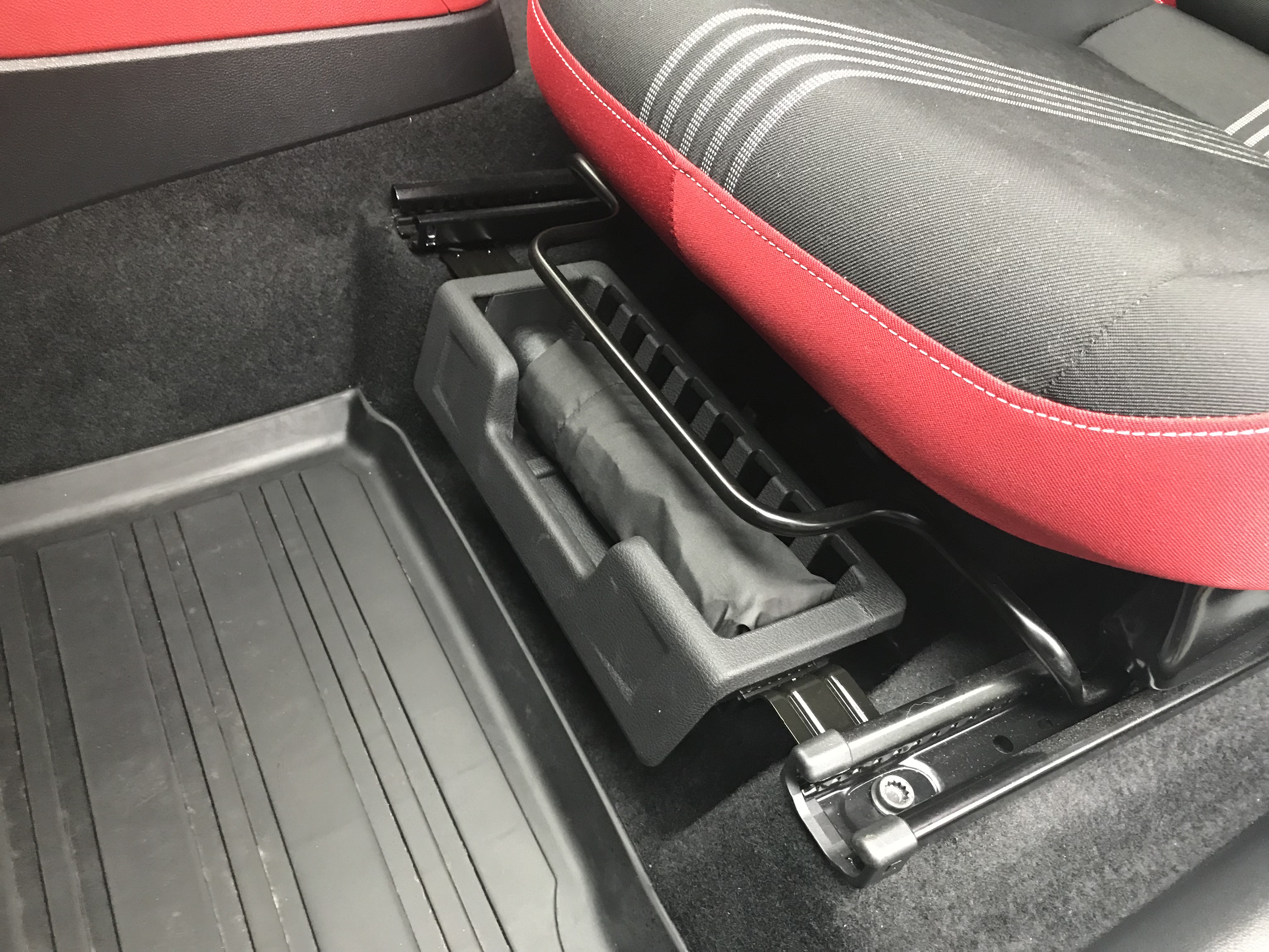

Umbrella holder arrived today and I’ve collected it so that’s ready to fit tomorrow :) Hopefully it’ll be all nice and clean then as well. Will have to find the right tool to get the bolt undone though, I know I’ve got one in the garage somewhere!!
To remove the seat? It's a Spline I do believe it's a size 12, if you're taking it out completely to fit, good luck with removing the plugs :D
... and don’t forget to disconnect the battery. Don’t want the airbags going off ...
Thanks both, it’s not coming out totally, just the front 2 bolts want undoing then the holder sliding into place under the seat rails. Won’t take a moment to fit... she says!! ;)
Handy tip to know is torquing the seat runner bolts up to the OEM spec which is 40nm :)
So the car is now all clean but Flickr isn’t uploading the pics so let’s just skip to the ones I can do for now
The umbrella holder and umbrella are in and I’m very pleased with them

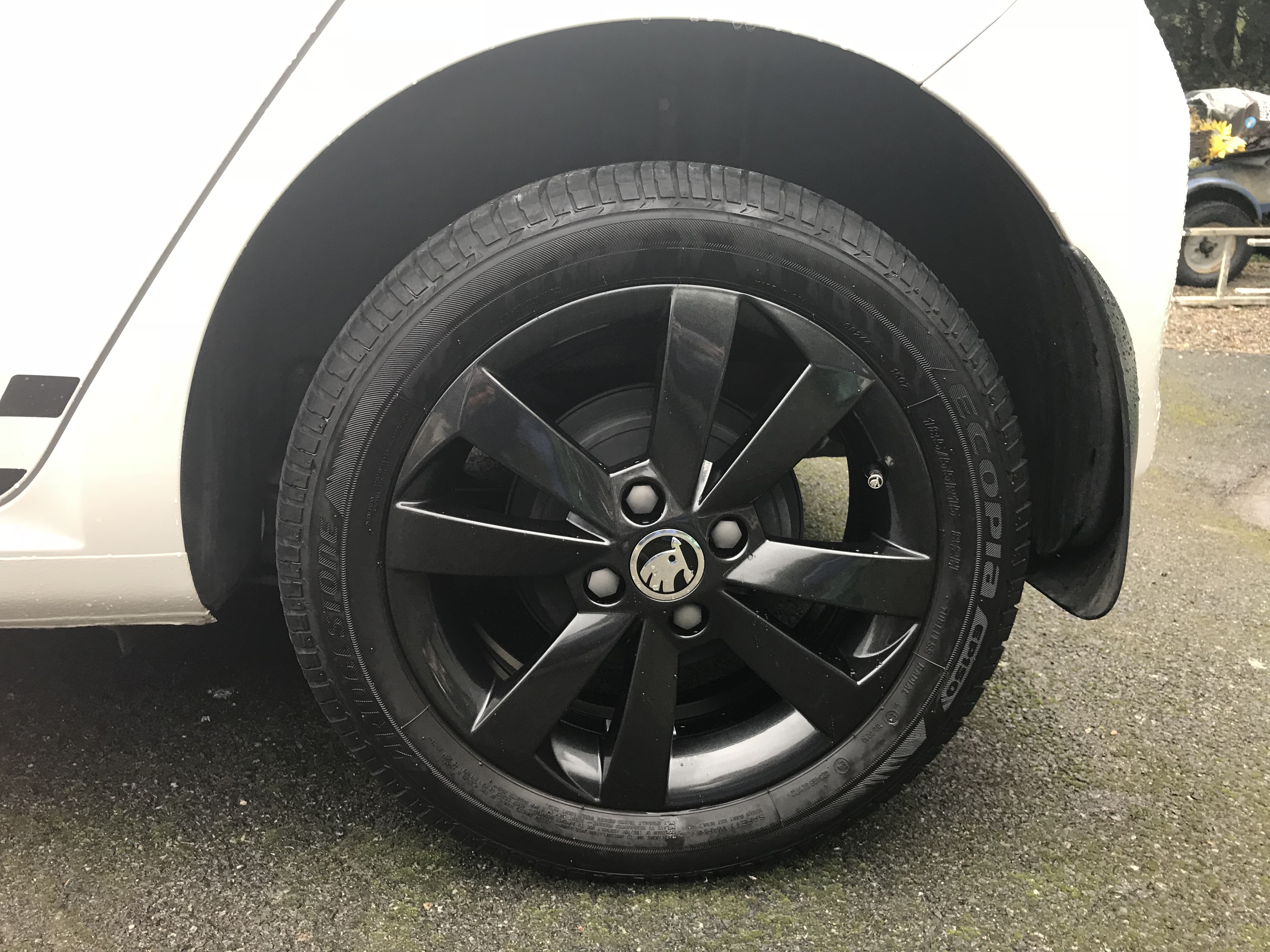

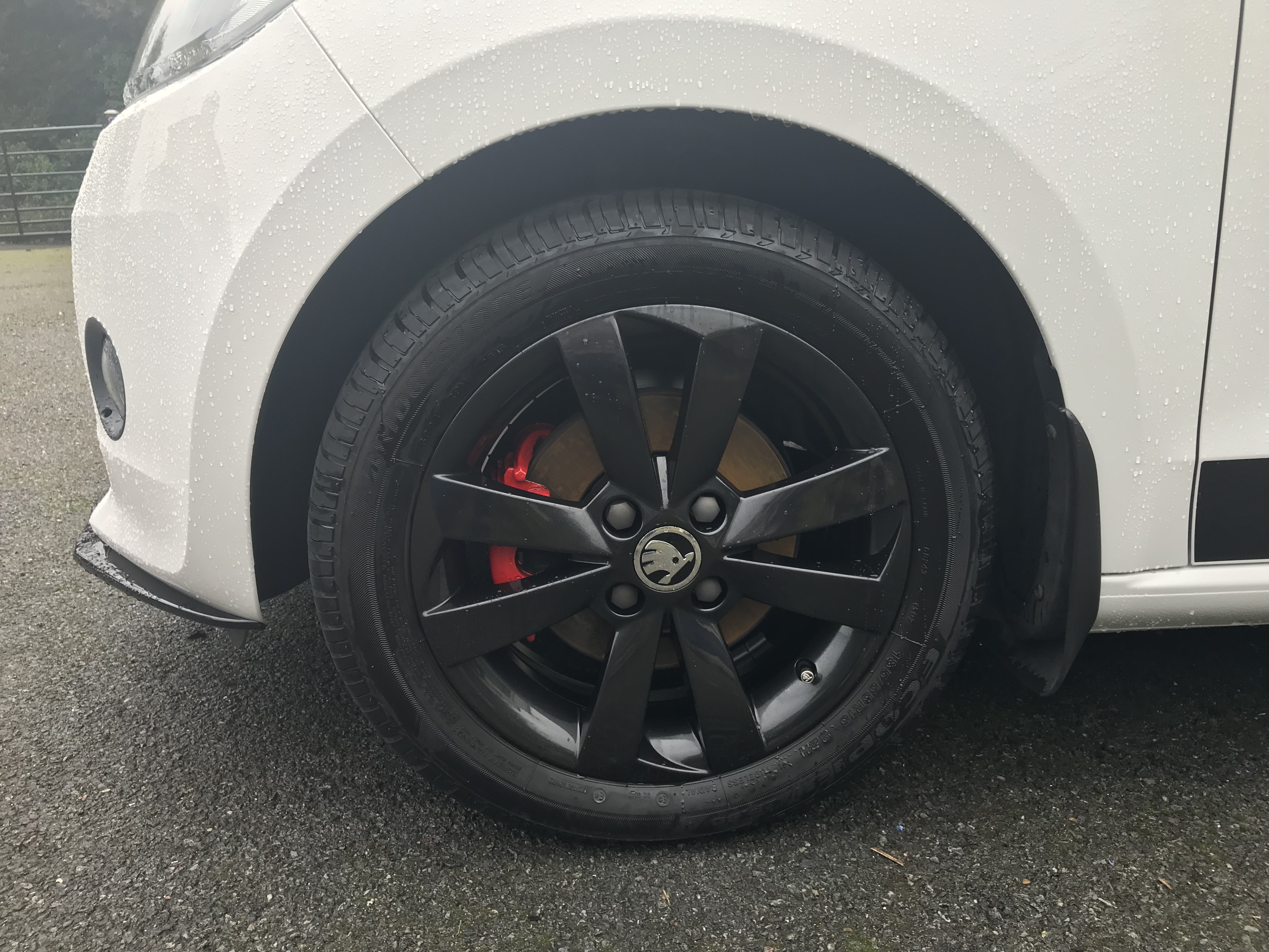

The wheels and tyres came up well considering the wheels haven’t been removed since the day after purchase

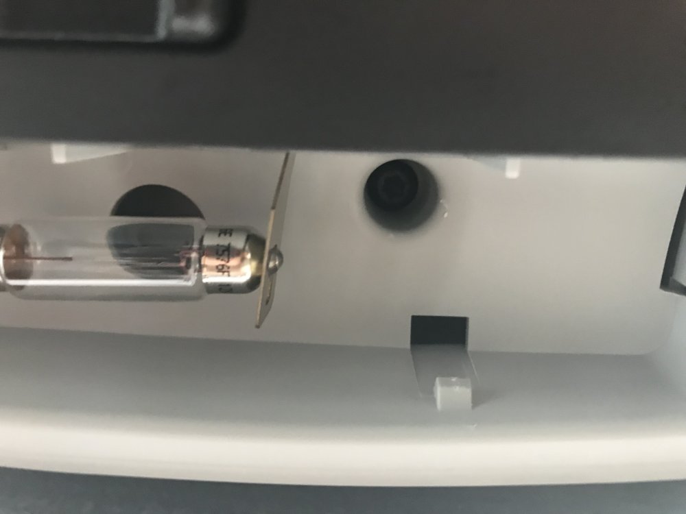

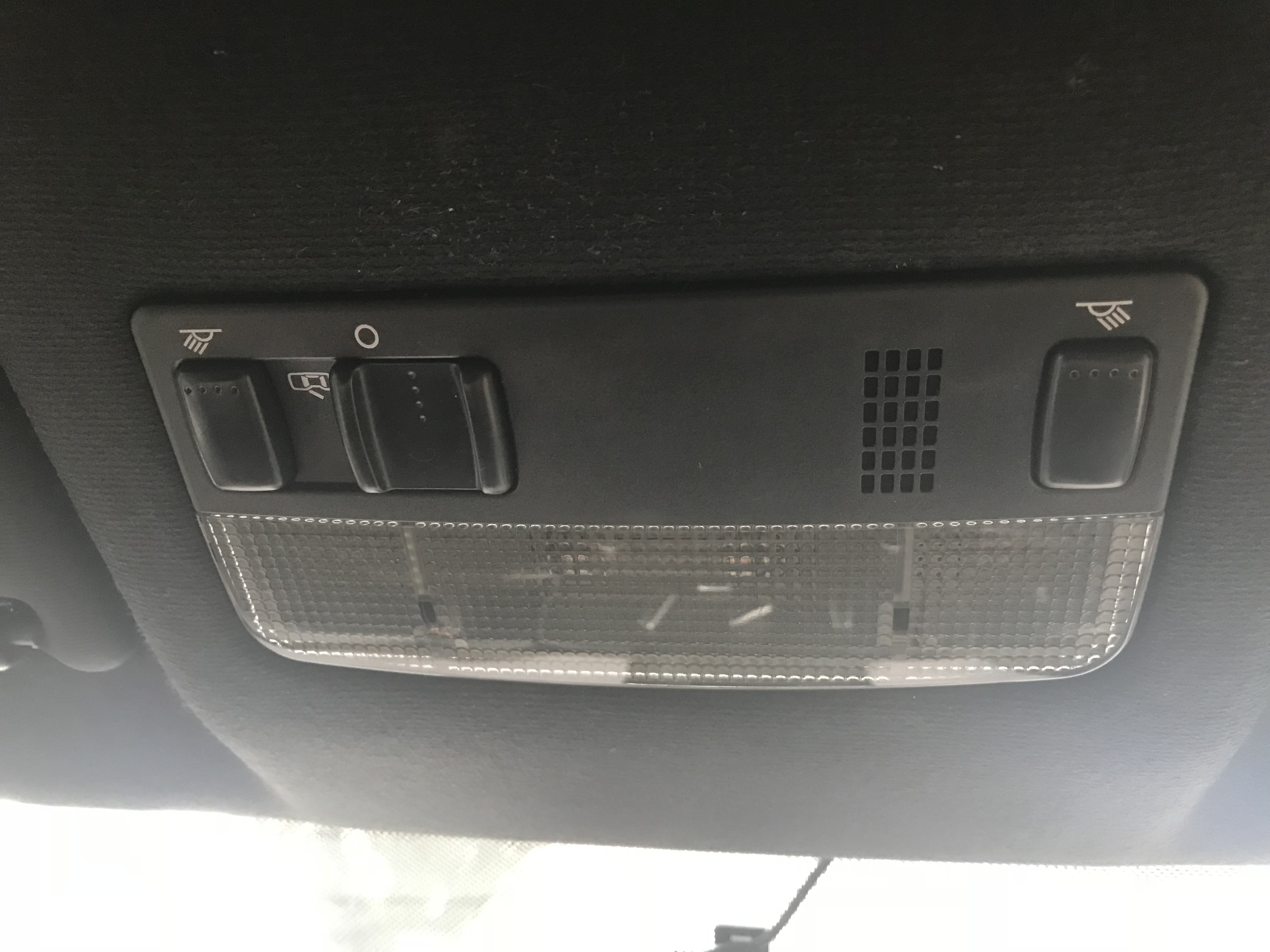

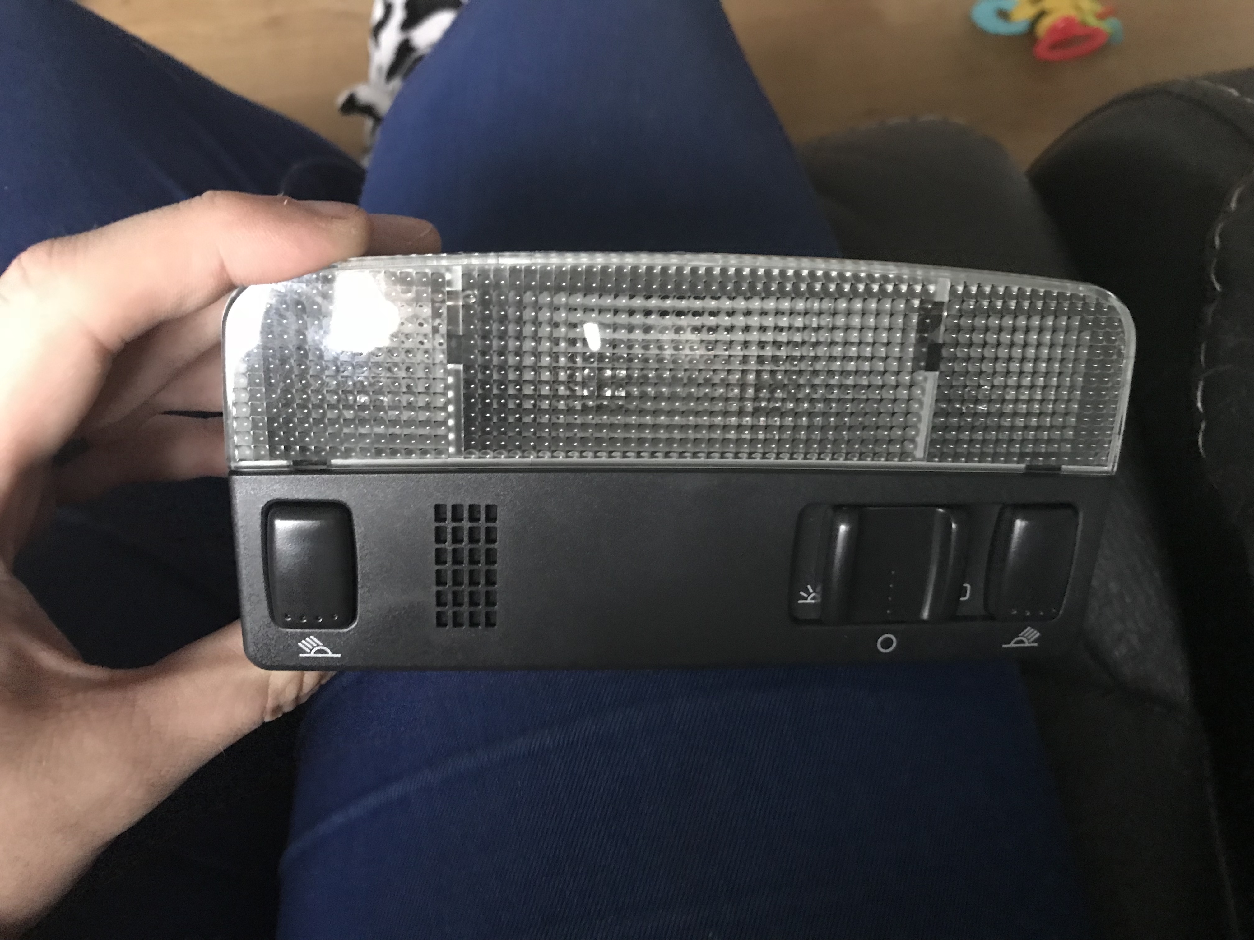

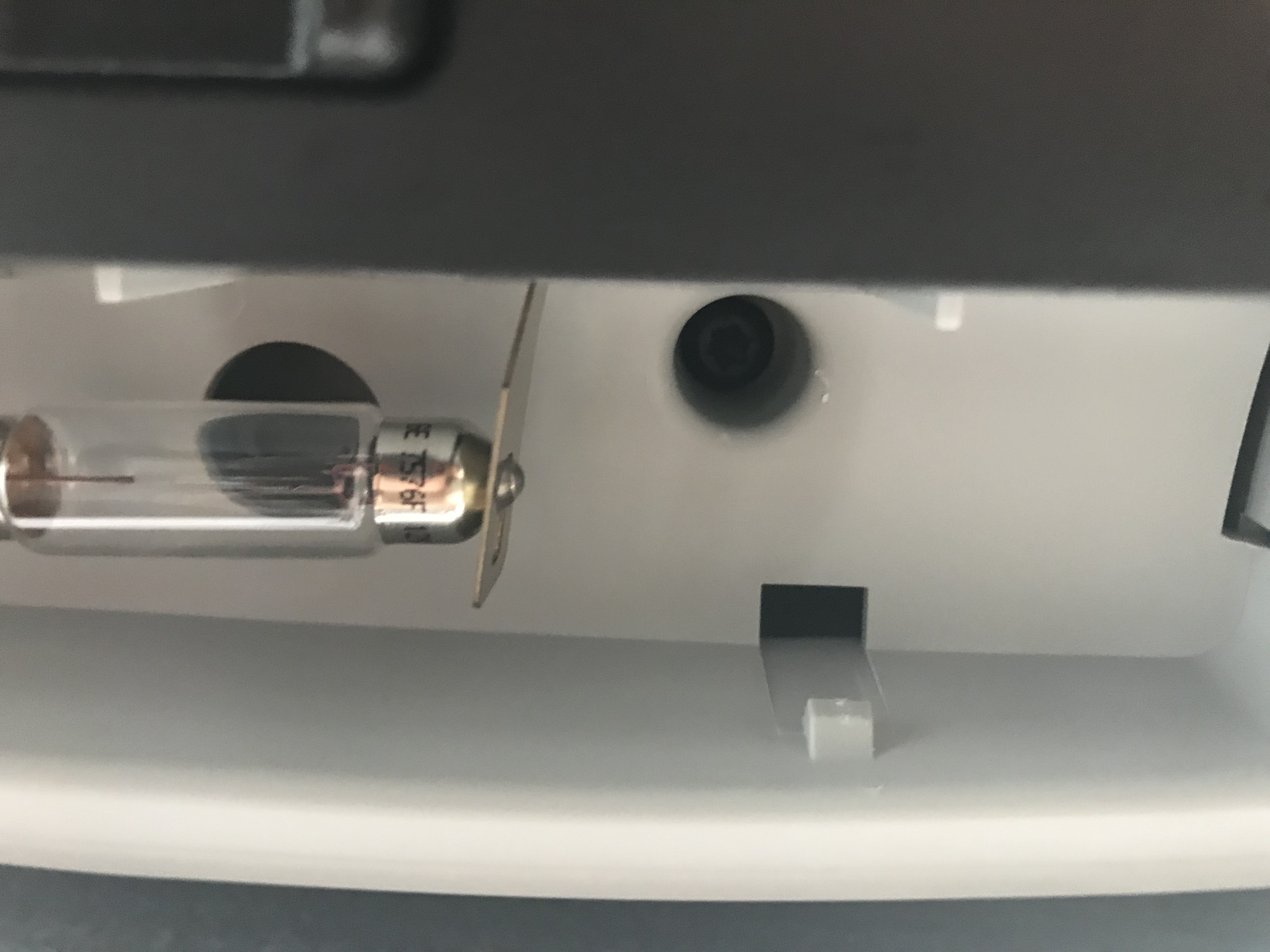

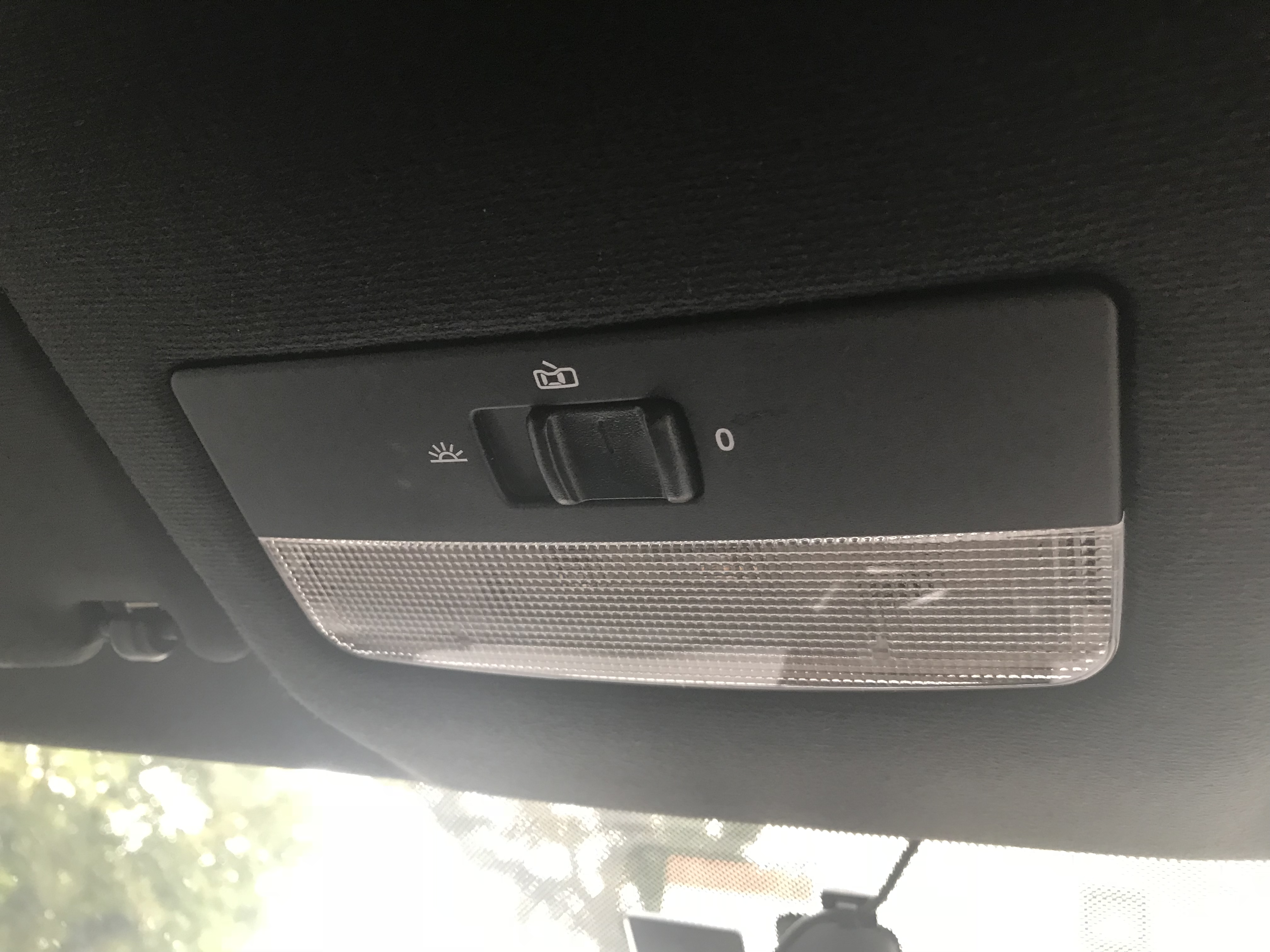

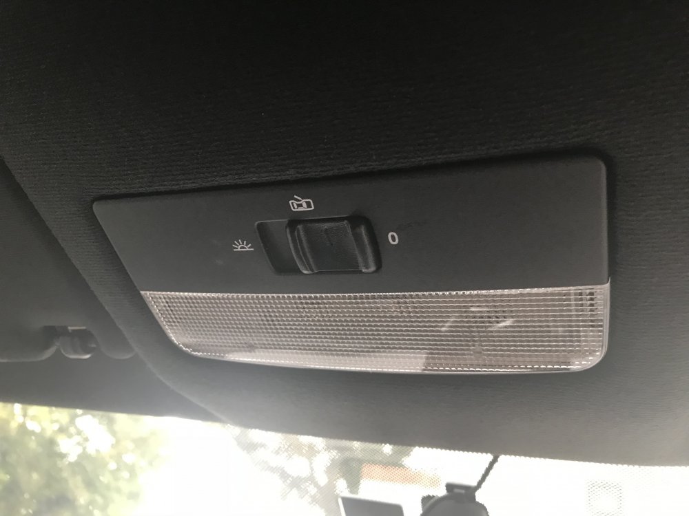

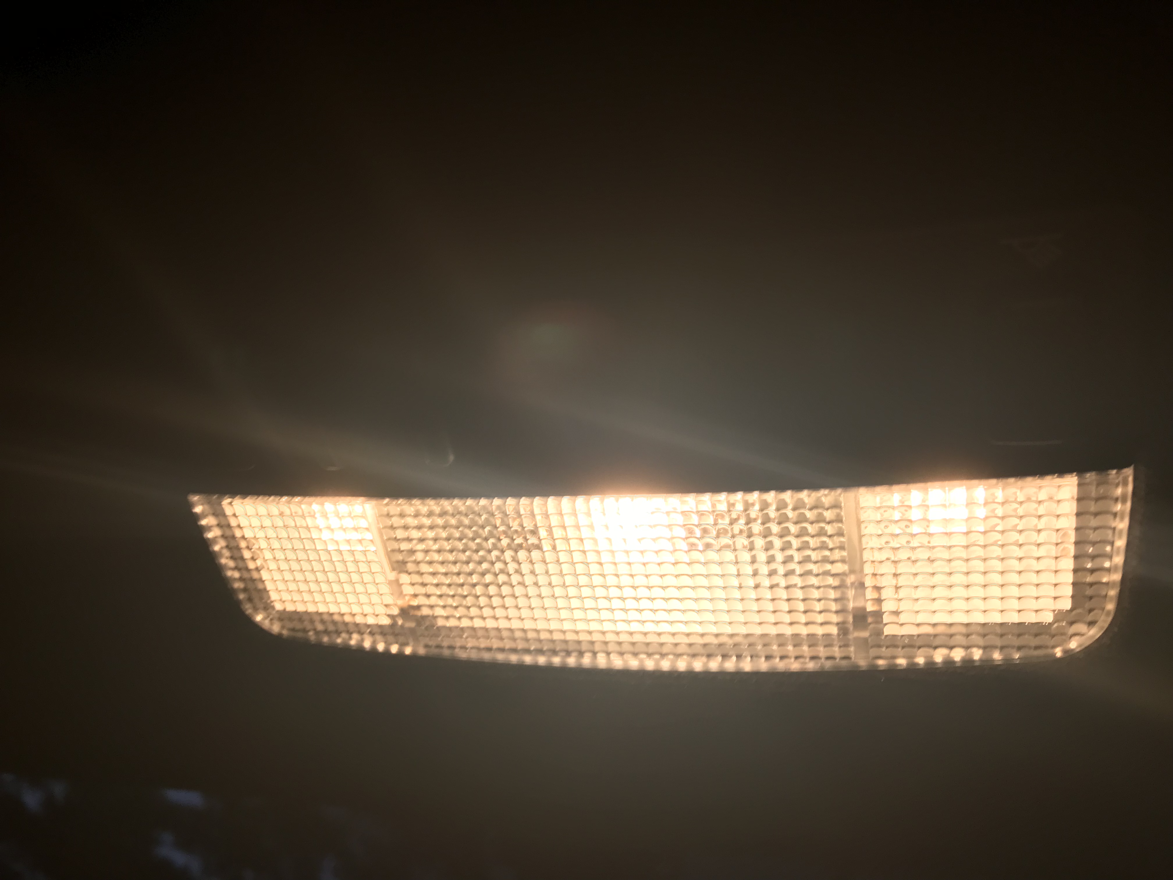

All sorted and fitted today :) Original light is like this
Pull the glass out and look for the Torx screws
Then press down the outer tabs and pull it out of the metal cage, be careful not to damage the headlining as it is very flimsy. Once it’s out, unplug the connector and as the Haynes manual used to say, refitting is the reverse of the removal :)

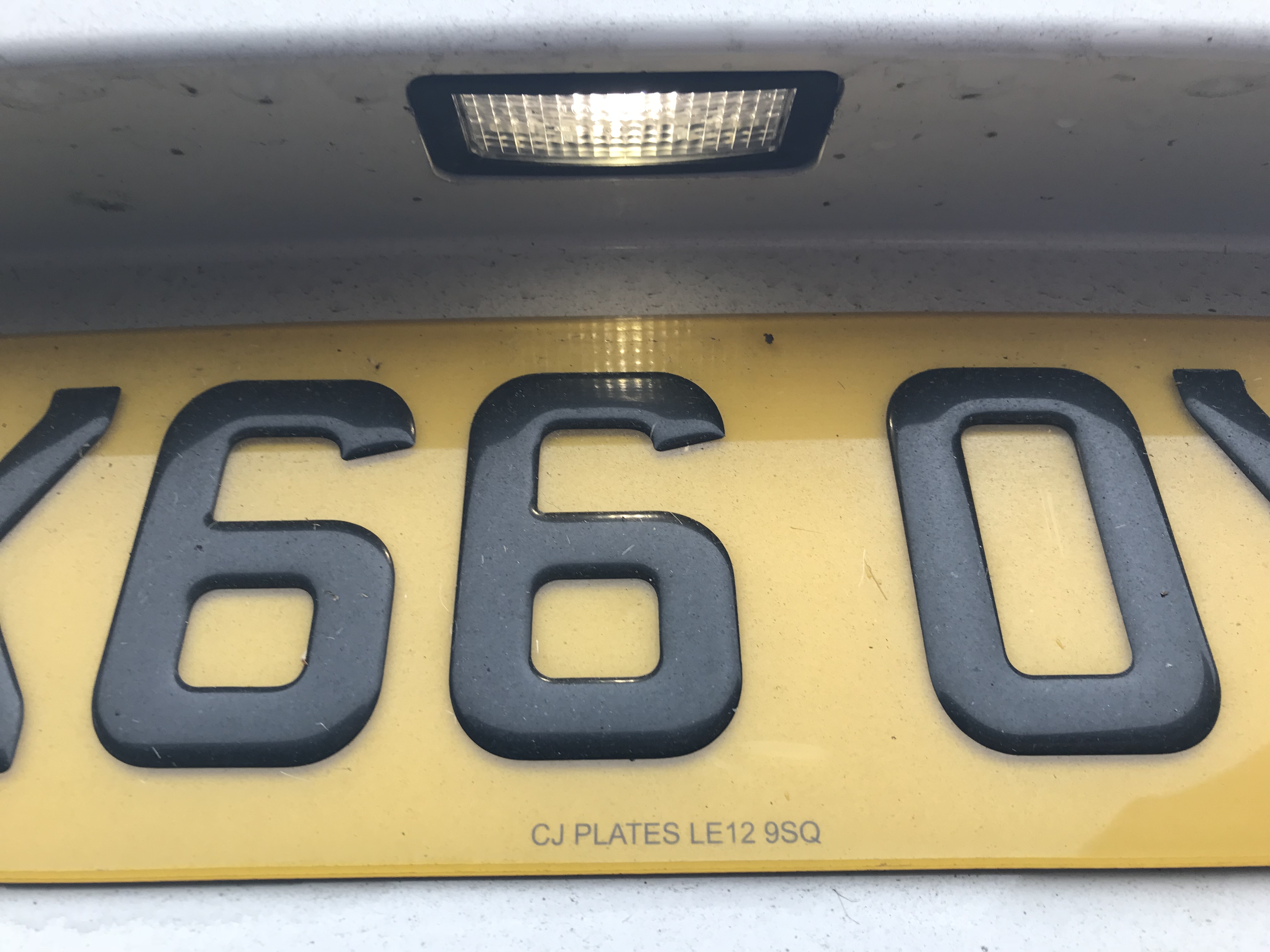

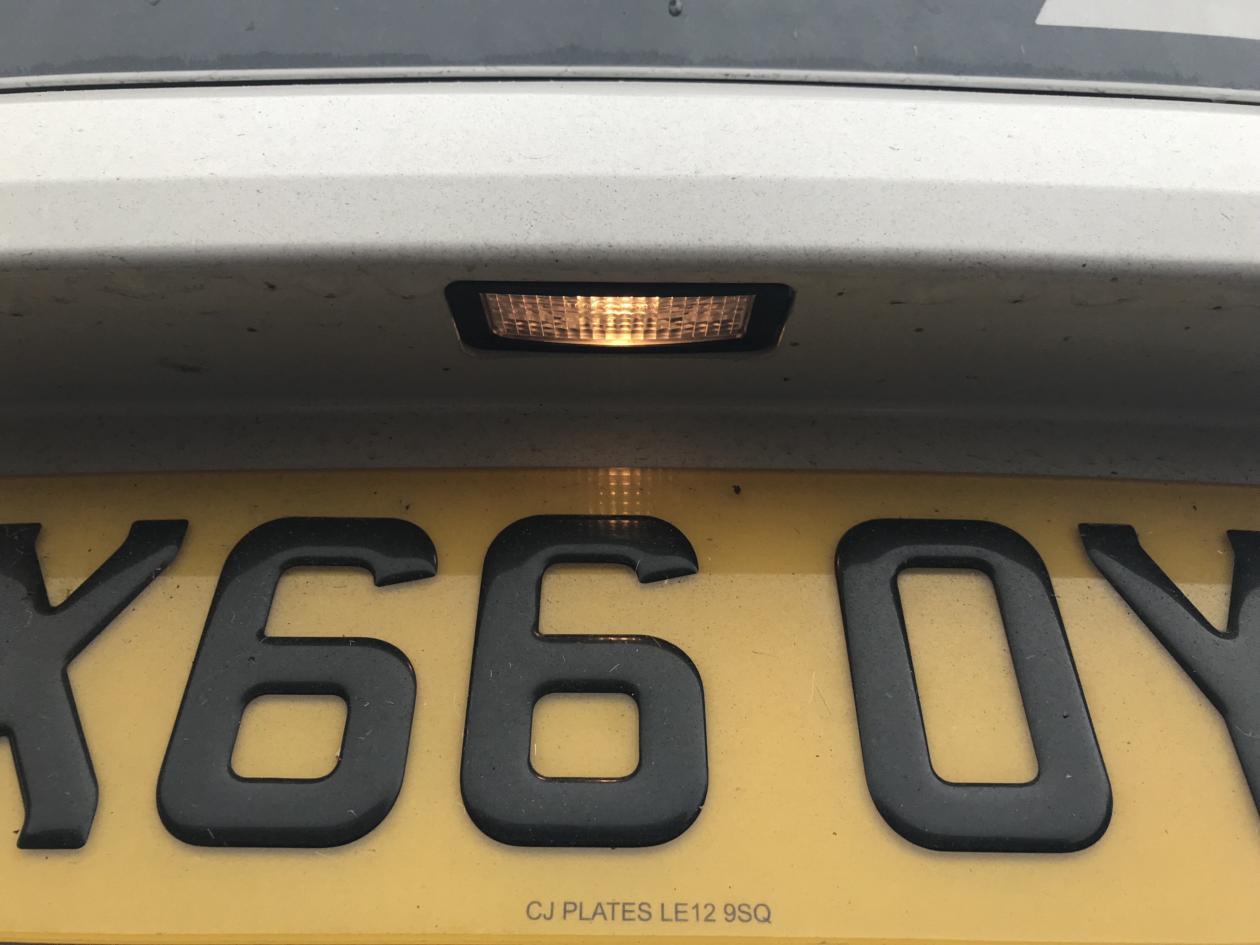

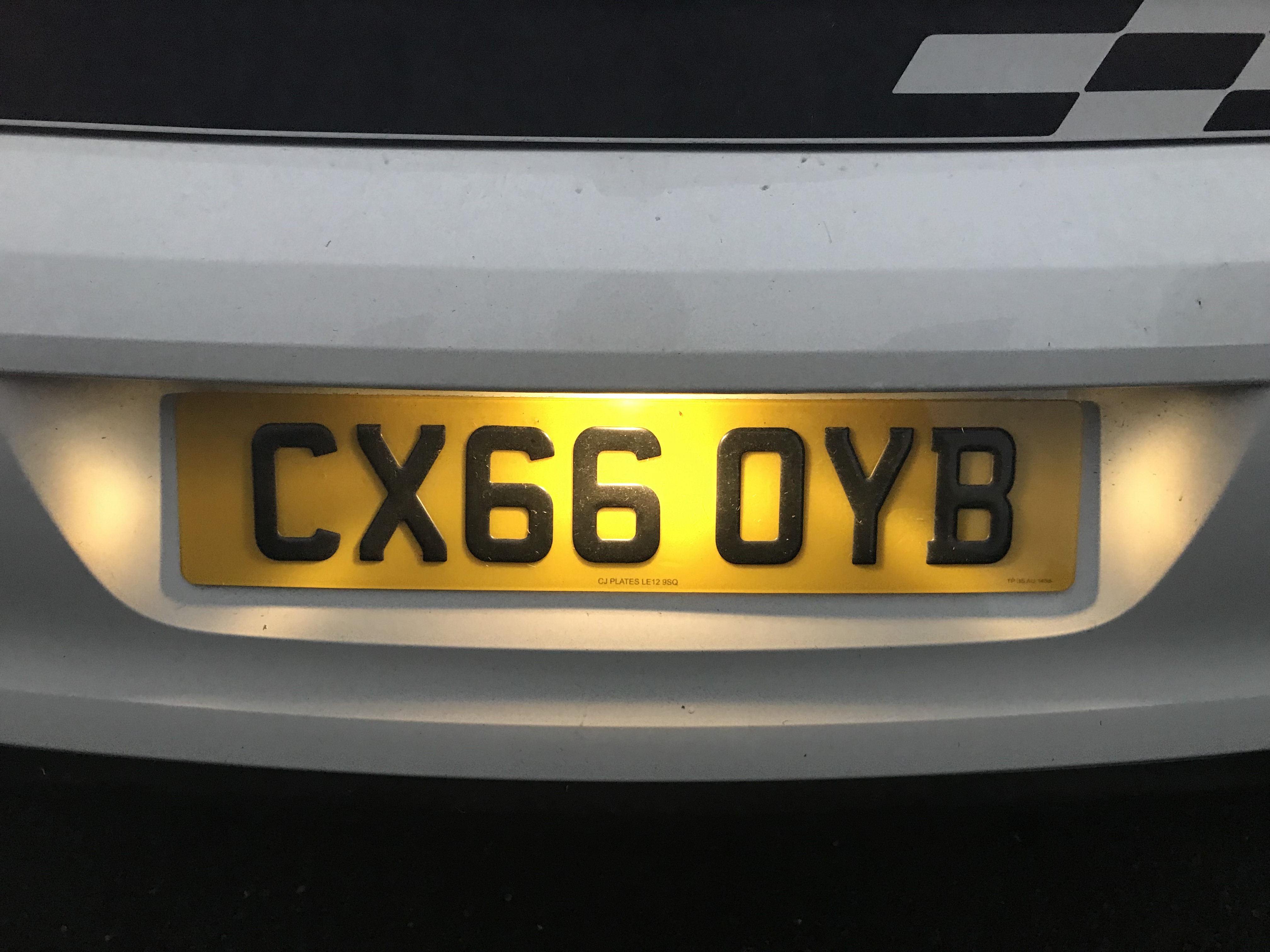

Necxt job was to do the number plate light which is very simple
Press the metal tab which is on the right of the photo and it just pulls out. Pull out the W5W bulb and replace with the new LED.
Now just to see how it all looks at night. LED’s to be added to the cabin shortly :)

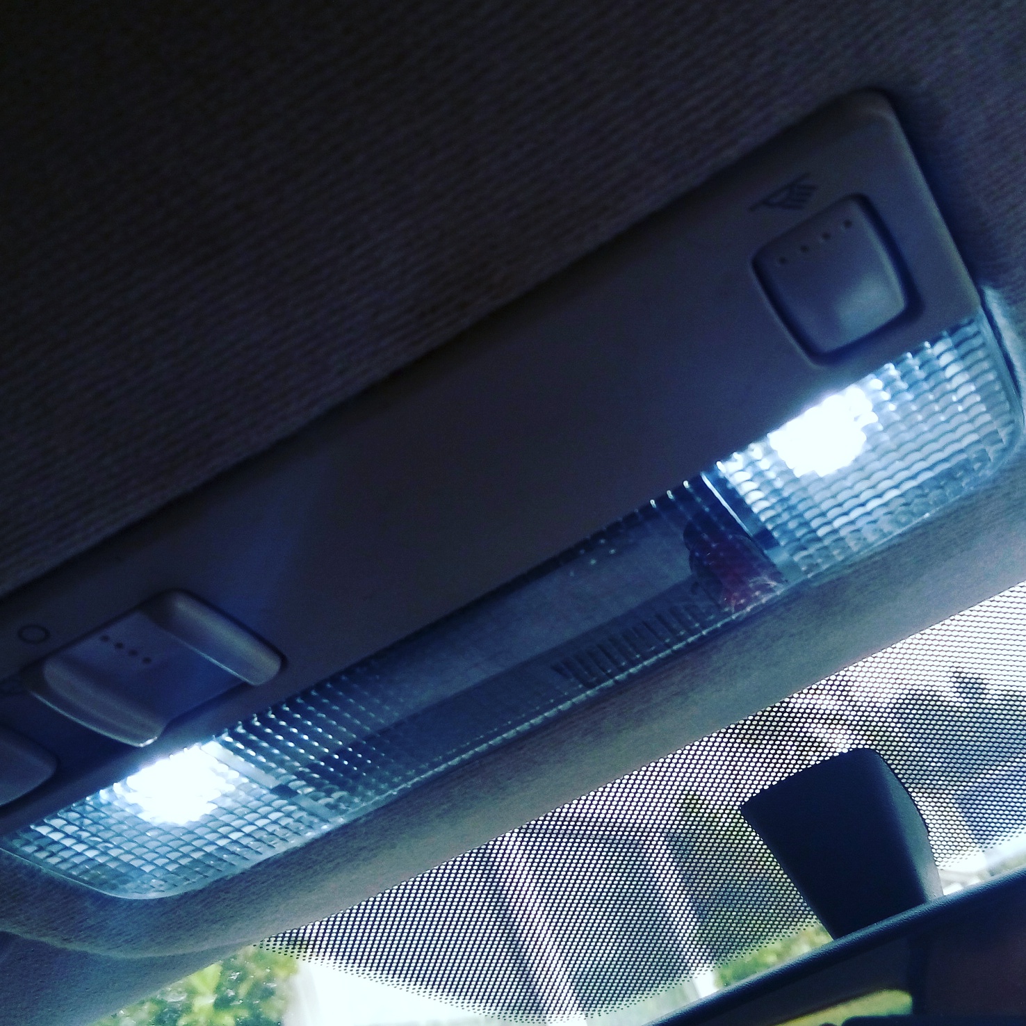

I’m a little annoyed, I meant to order the cool LED colour to match the DRL’s but I actually ordered the warm colour which is a nice colour but the car doesn’t match front to back. They’d look nice inside though so I might take it out and put these in the map light with a similar colour centre bulb and use cool LED’s in the plate light.
Even with the incandescent bulbs this is a massive improvement :)
