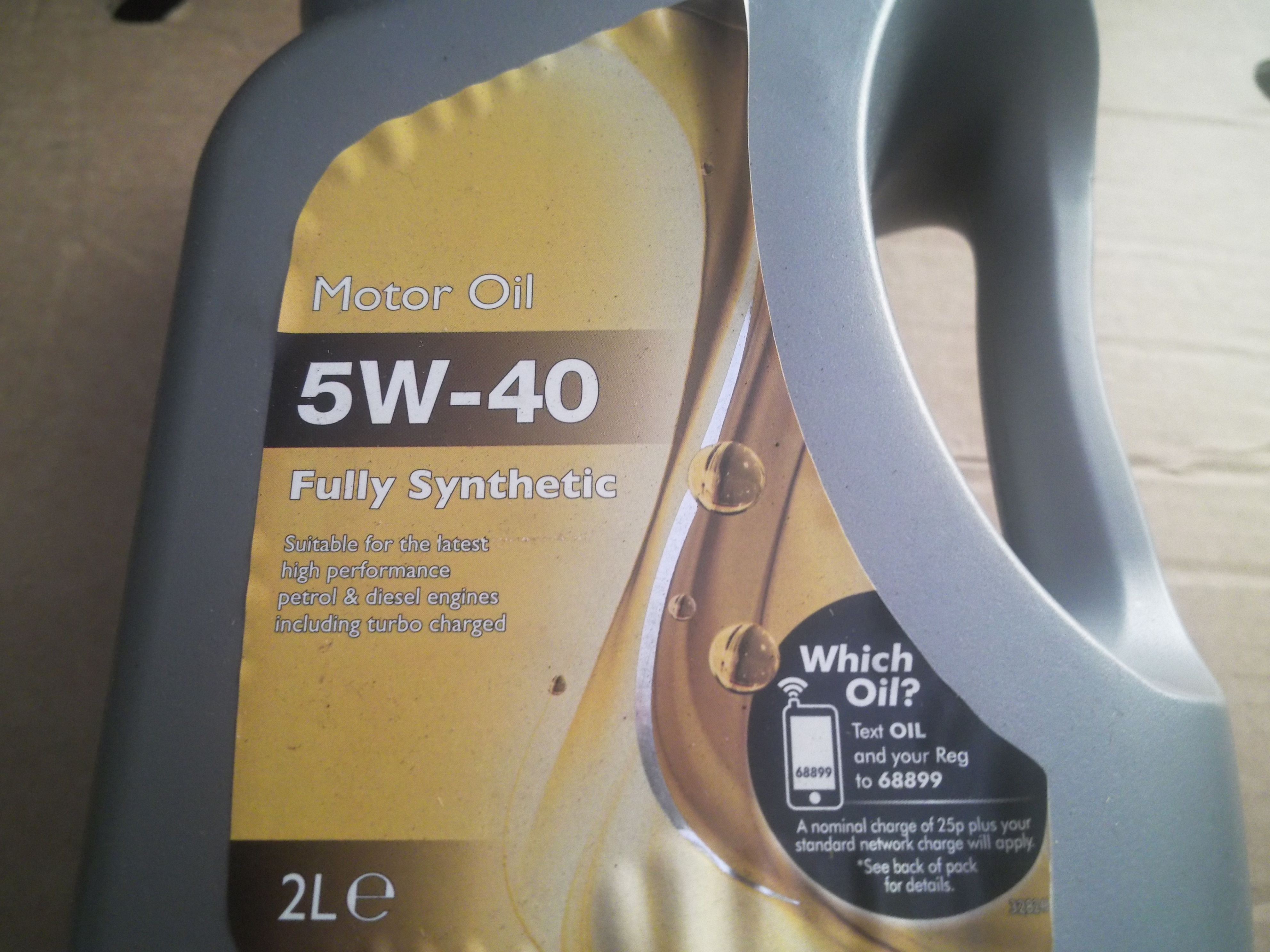

Just had a short chat to my local Skoda parts manager. Says they've changed contract and are stocking Mobil 1 now, 5w40 recommended for my petrol vRS 220. BUT they're asking £18 Inc VAT for a 1 litre top up bottle. At the service 6 months ago they used Castrol Magnatec. 2 litres of Tesco own brand 5w40, fully synthetic, VW 502 spec is £16. Going with the Tesco option.

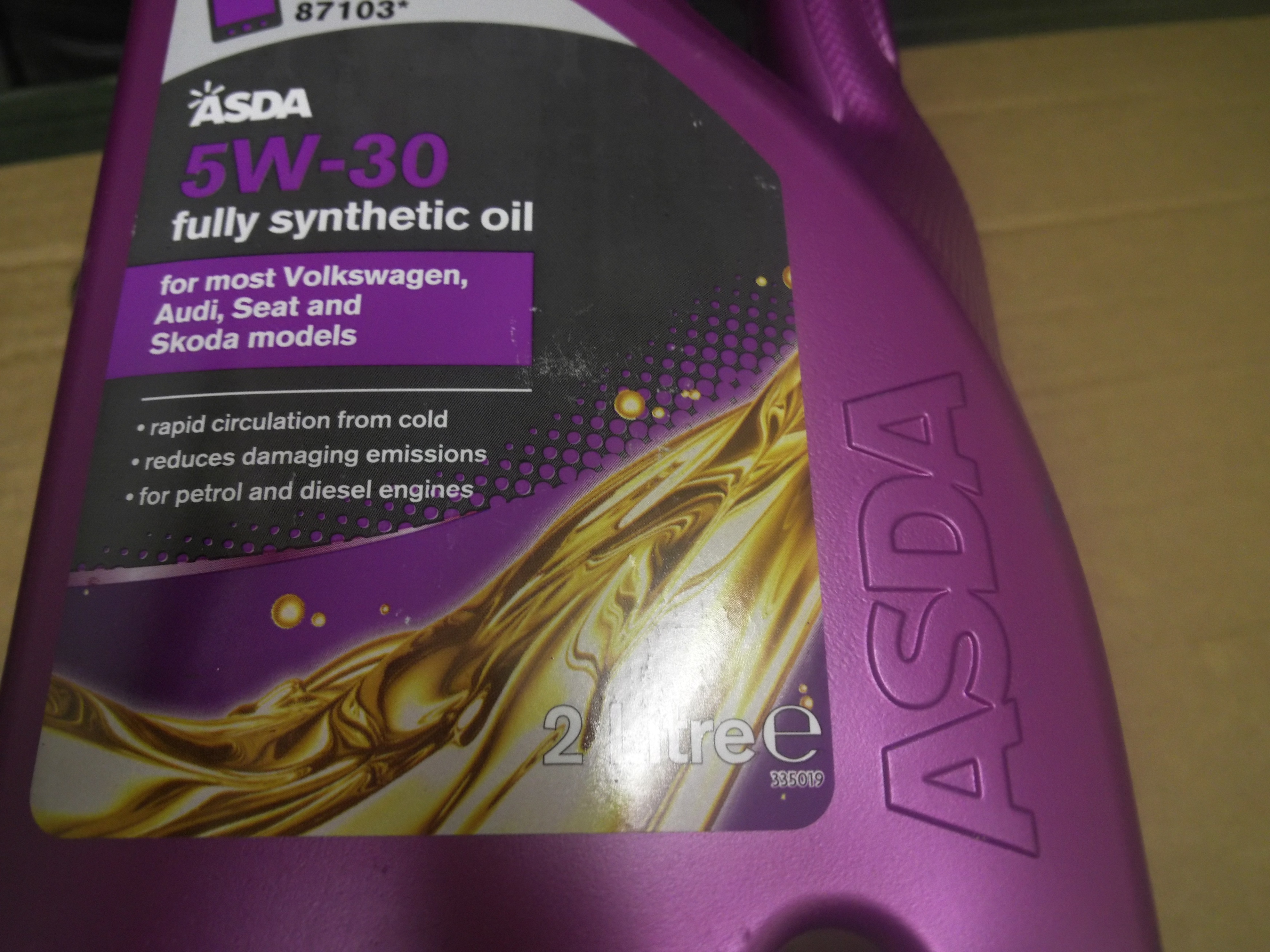

4 litres of VW 502 00 5w 40 Full Synthetic from ASDA in an ASDA Container for about £20.
Proper oil from proper Oil Producers and perfect for a TSI getting fixed oil and filter servicing.
As with from TESCO, COMMA or anyone else.
VW504/507.00 is the required grade. Dunno about VW502.00.
Not the Required Grade, there are options, look at your Owners Manual.
VW 504/507 is required for Variable / Flexible servicing and will be 5w 30 FF LL commonly.
http://volkswagen.co.uk/owners/servicing/regimes
VW 502 is perfect for Fixed Servicing, 372 days / 9,400 miles or sooner.   Commonly 5w 40 FS.
Long Life Oil, short life VW TSI engines quite commonly.
