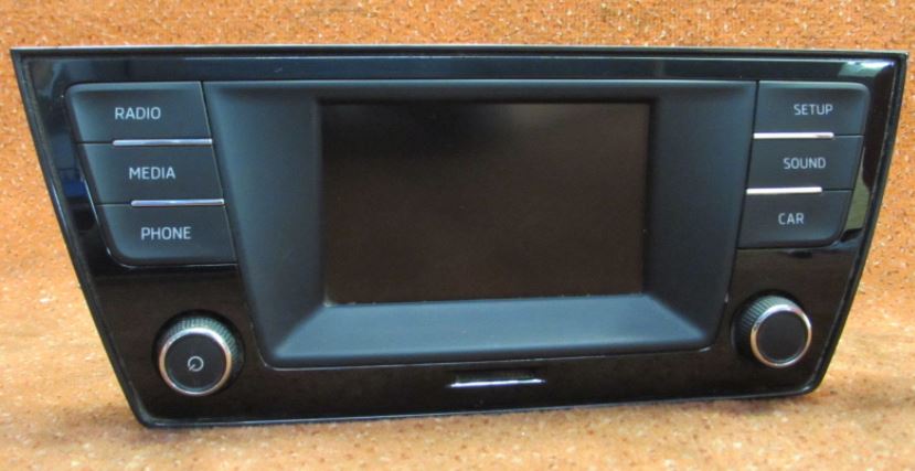

This is my radio (i think skoda names "swing" to two radio models):
http://www.skoda.ie/shared/SiteCollectionImages/models/new-fabia/fabia/fabia/connectivity/fabia-connectivity-slider-02.jpg
If you "truly" have a "swing" radio then no as it has no way to connect the camera, if you have one of the MIB1 or 2 units than it is not too bad (you may need to update the firmware to get full screen though)
John
What do you mean with  "if you have one of the MIB1 or 2 units"?
The thing is that when you configure the car at skoda website, you can choice rearview camera without upgrading to bolero radio, and it makes me think that OEM skoda rearview camera is compatible with radio Swing.
Thanks!
Edited by pedpasos
The Skoda cams can be two different types "compsite video" this is most of the aftermaket cheaper ones or "RGB" theses are much harder to find and cost more. the MIB1 and 2 are post 2013 I think and would be Bolero and Amundsen and Colombus but the pre 2013 units will not work without extra parts if you do not usr an RGB camera

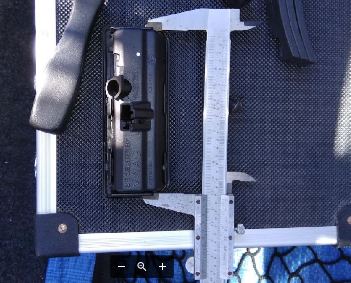

Now I am waiting for receiving the camera, but the only thing that i have tried by the moment is to disassemble tailgate panel to measure the stock handle.

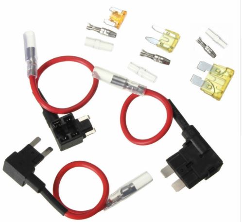

I prefer to make the installation wired, but i have bought also the wireless kit. I don't know where to connect the receiver, maybe on the lighter, or maybe with an "add a circuit" attached on the fuse box:
Other option is to buy an after market radio came from china that allows all the options plus gps. (there are around 300€, but i am scared abut the import taxes).

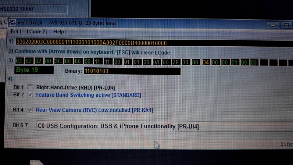

Hi,
I bought a factory Fabia 3 to reversing camera. The seller looked at the chassis number and should work it. There is a Swing 2 radio in the car, and I activated the RVC in the 5F module with VCDS, but there was no change, and when the rear radar image is turned over, the shutter radar image appears only on full screen.
Can someone help me with what might be the problem with her? In February 2016 the car.
Thanks!
hello,
PixiTrabi, could you explain me where have i to do to activate RCV on the 5F module??
Thanks!
31 minutes ago, pedpasos said:
hello,
Thanks!

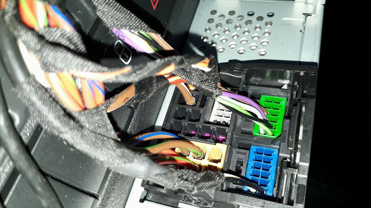

Hello,
Here is the picture:
Thankyou very much!

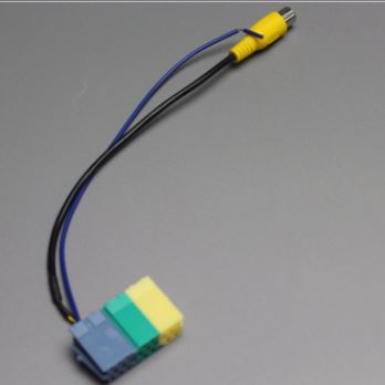

Now, another little question: Could yo take a photo of the original connector?
I have bought a connector like this, but i dont know if it will work:
Thanks!
12 minutes ago, pedpasos said:
Thankyou very much!
Thanks!
This is not the connector, but the blue part of the quadlock must be connected to the 6 and 12 positions. The 6 is the signal of 12 in the GND. Includes 000 979 009 contact.
Have you the pin list of swing 2??
thanks!

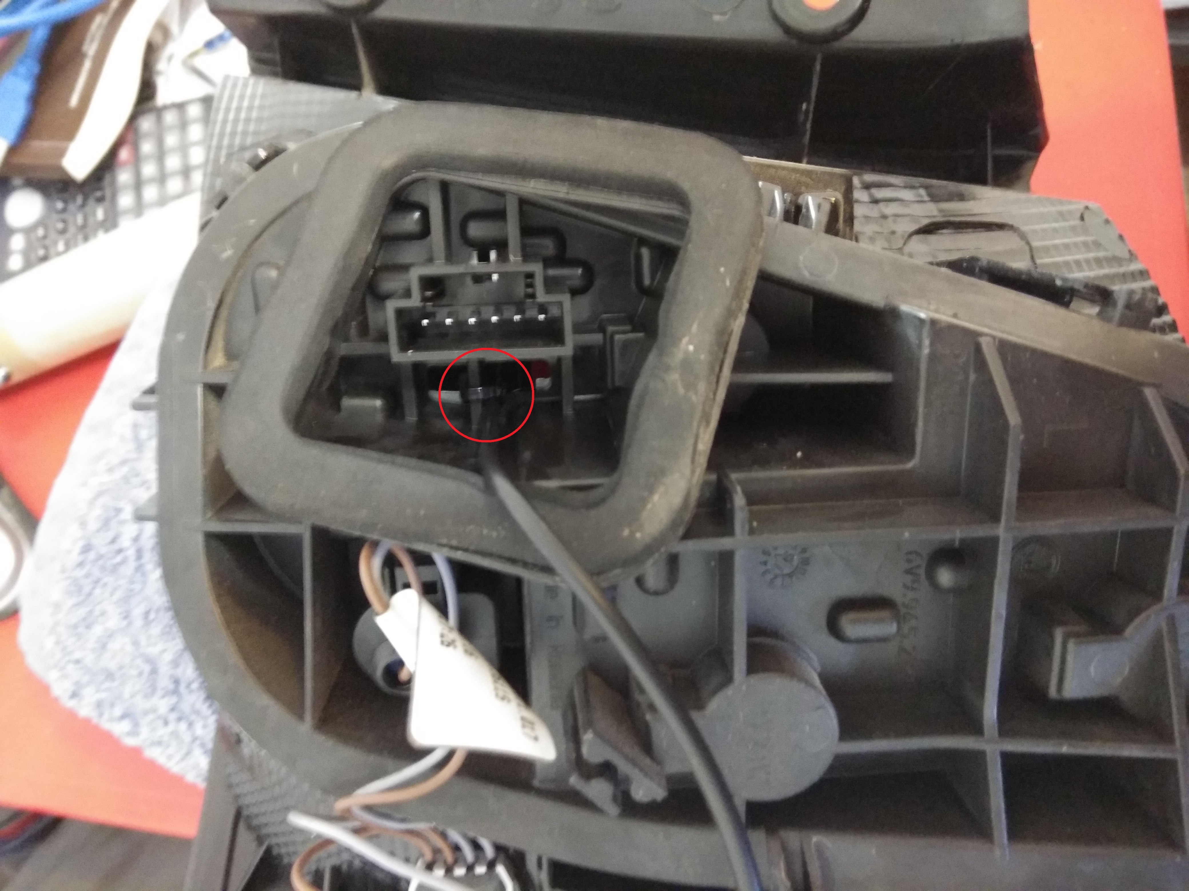

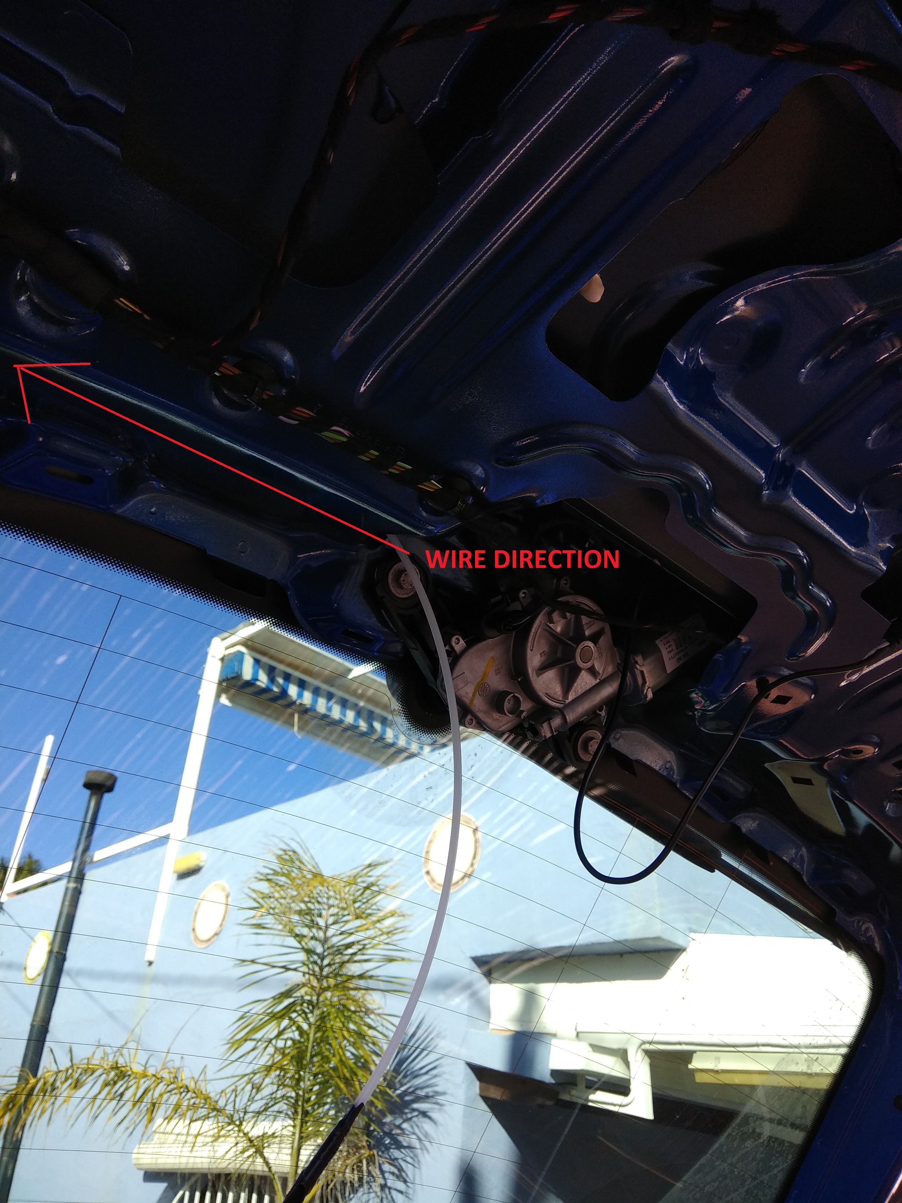

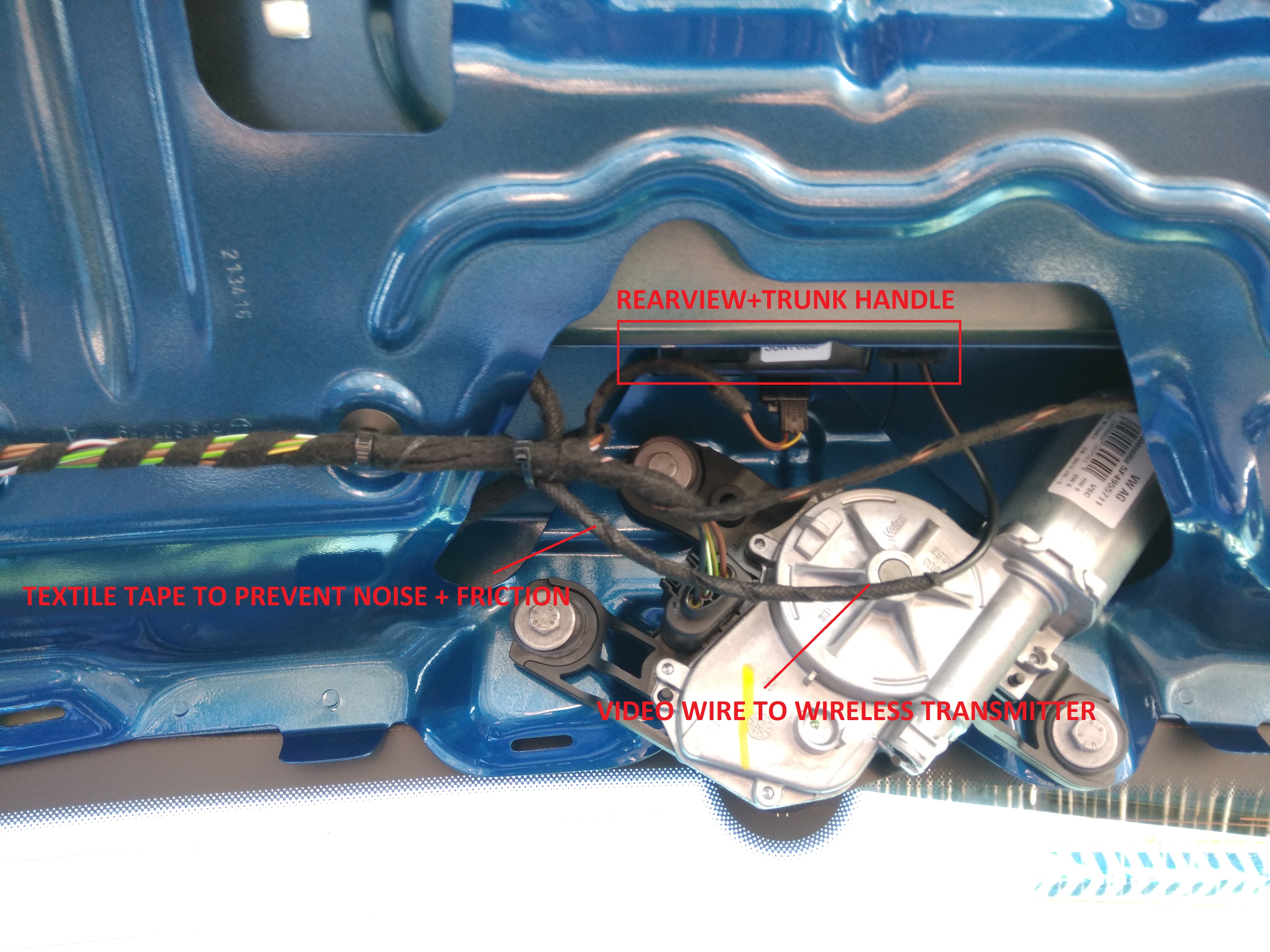

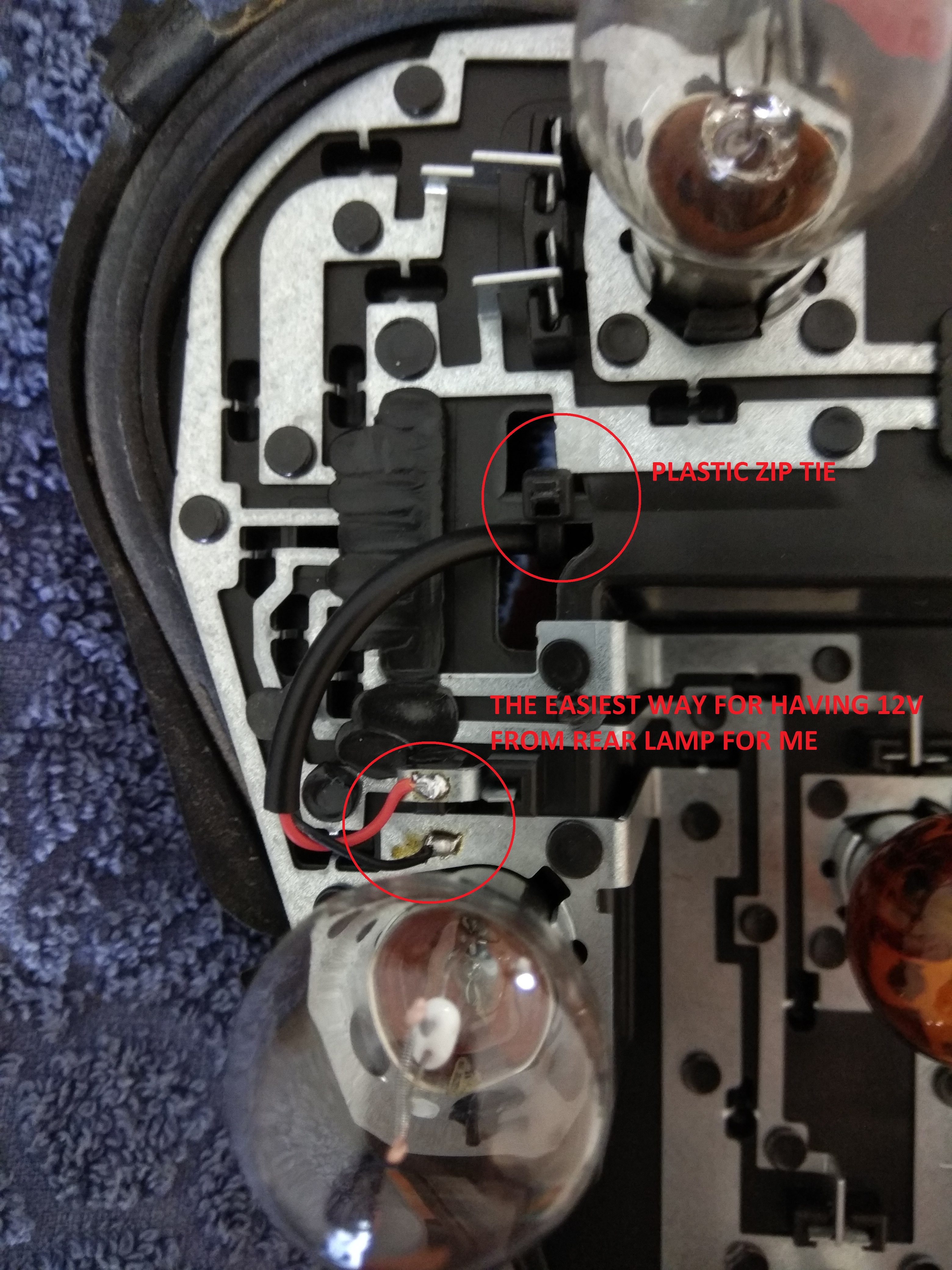

Hello,
i finally tried to install the rearview today.
Here some pics:
I decided to take wireless option, due to the complication of routing more than 6 meters of video wire through the car.
At this moment i have only half of the installation (only the rear camera mounted, and connectad to the rear lamp).
I have tried to have image on an external screen, and it works reasonably well. A little interference probably due to the 12v noise on the car. I can be easily solved by adding a chocke coil based filter, but for me is okay. I only want to see something about rear on the screen.
