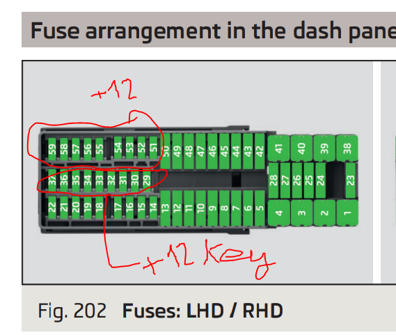

The problem is that it remains with the green light on when the car is closed.
Does anyone know wich fuse slot are key manged? I mean, only powered if the key is on.
Thanks!
Thanks!
When I fitted a dashcam to my sons fabia III I used the rear wiper fuse output
I used the heated seats fuse, think it was 35 or 36
Te upper fuses are everytime powered.
The down ones are powered only when the car is powered.

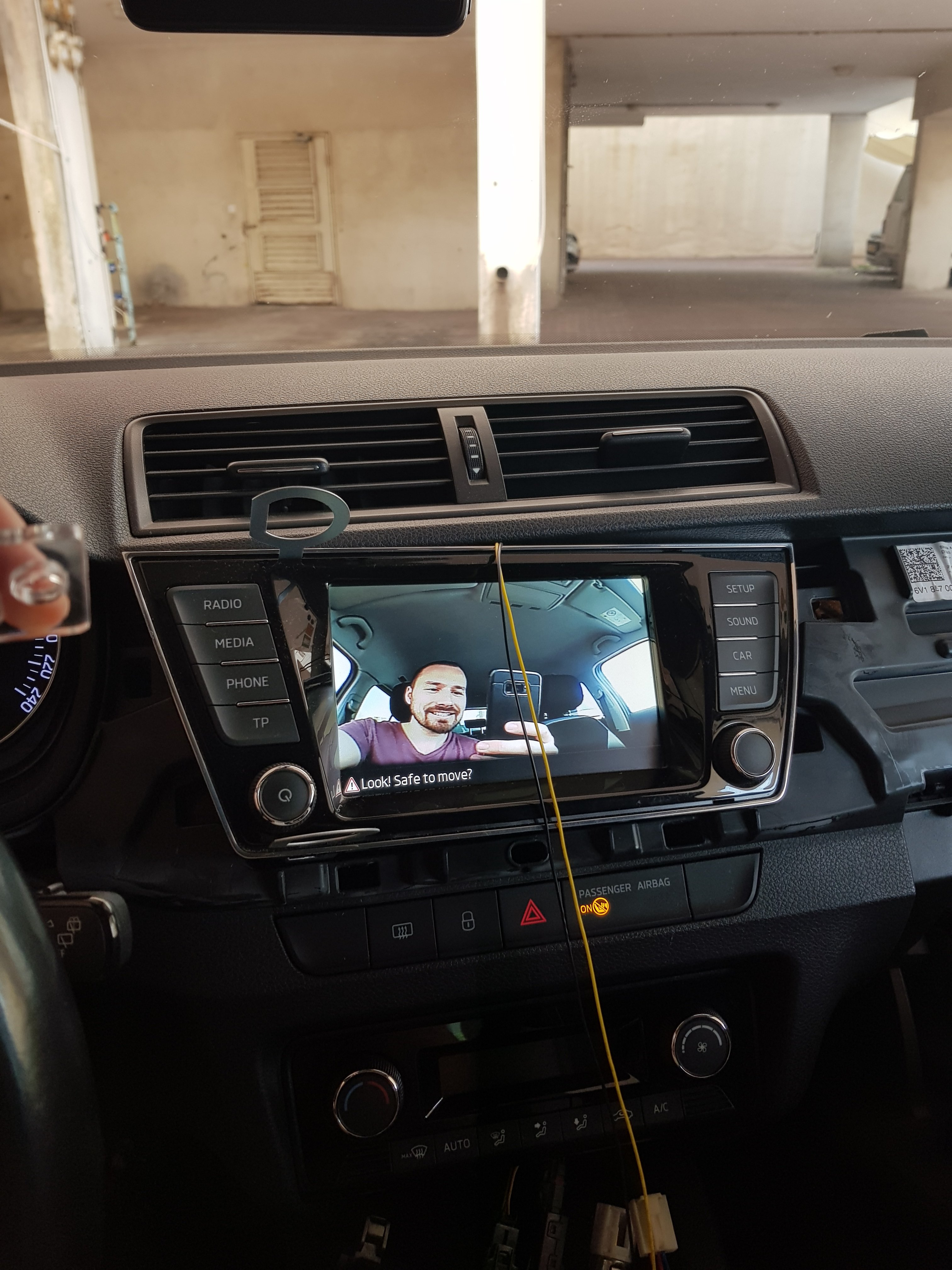

I have installed the screen mirror with dashboard cam by connecting red wire to +12V, yellow wire called "ACC" to the key managed fuse slot.
I found several spaces without fuse.

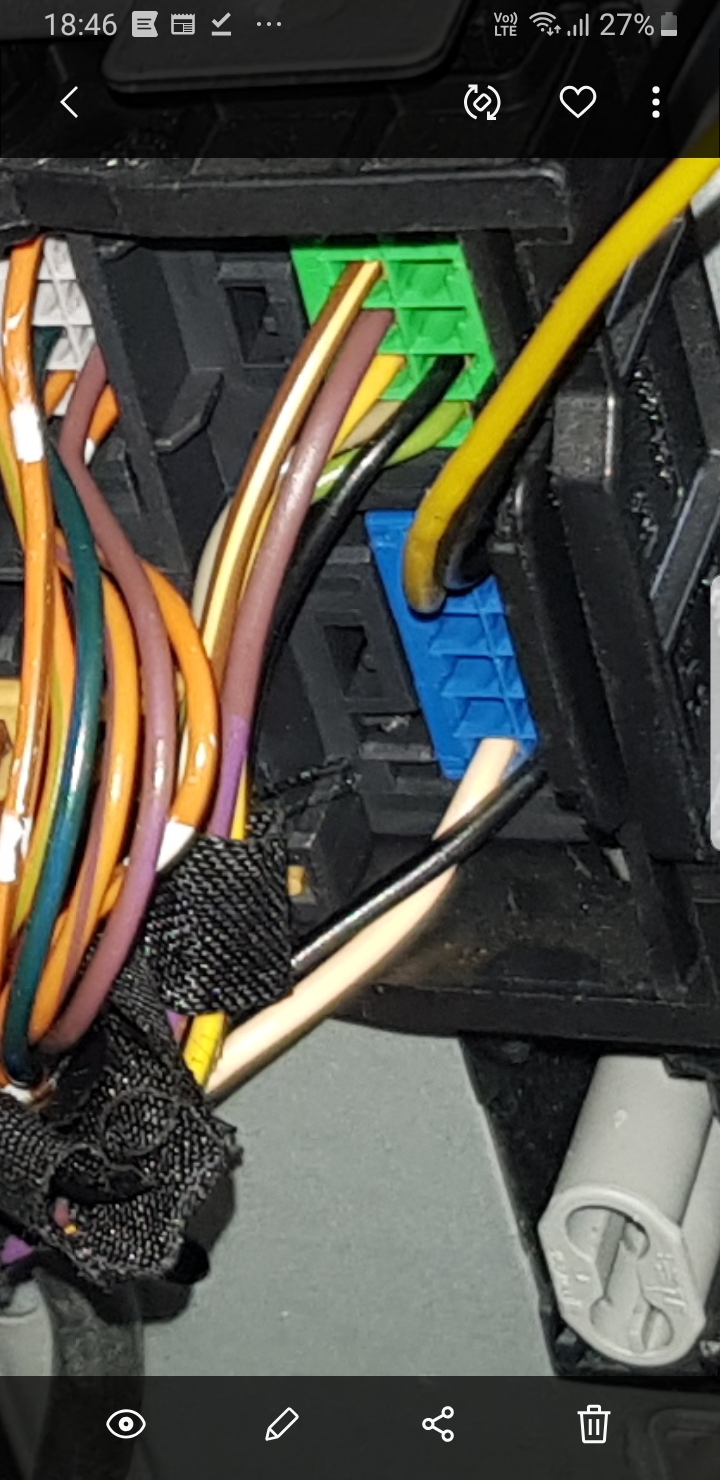

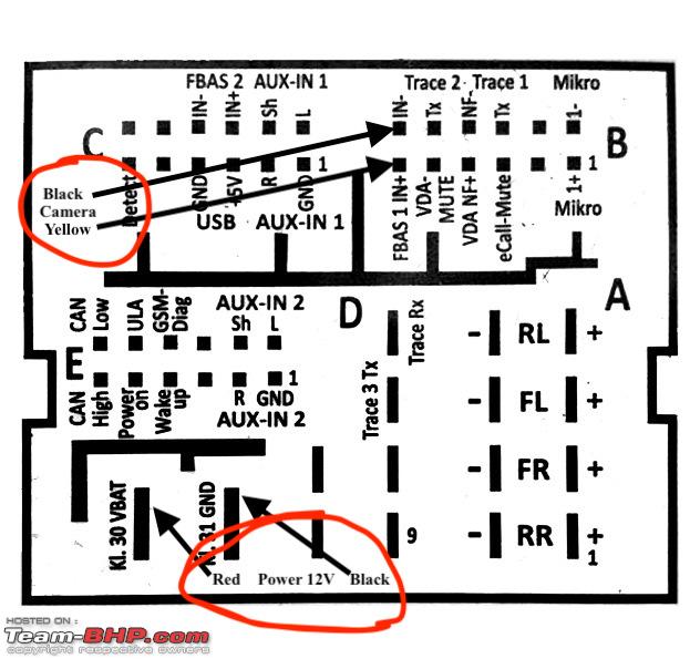

Hey, so after browsing long posts and some internet reviews I was able to install an Ali Express composite camera in my Fabia MK3 2016
I have amundsen Mib2.

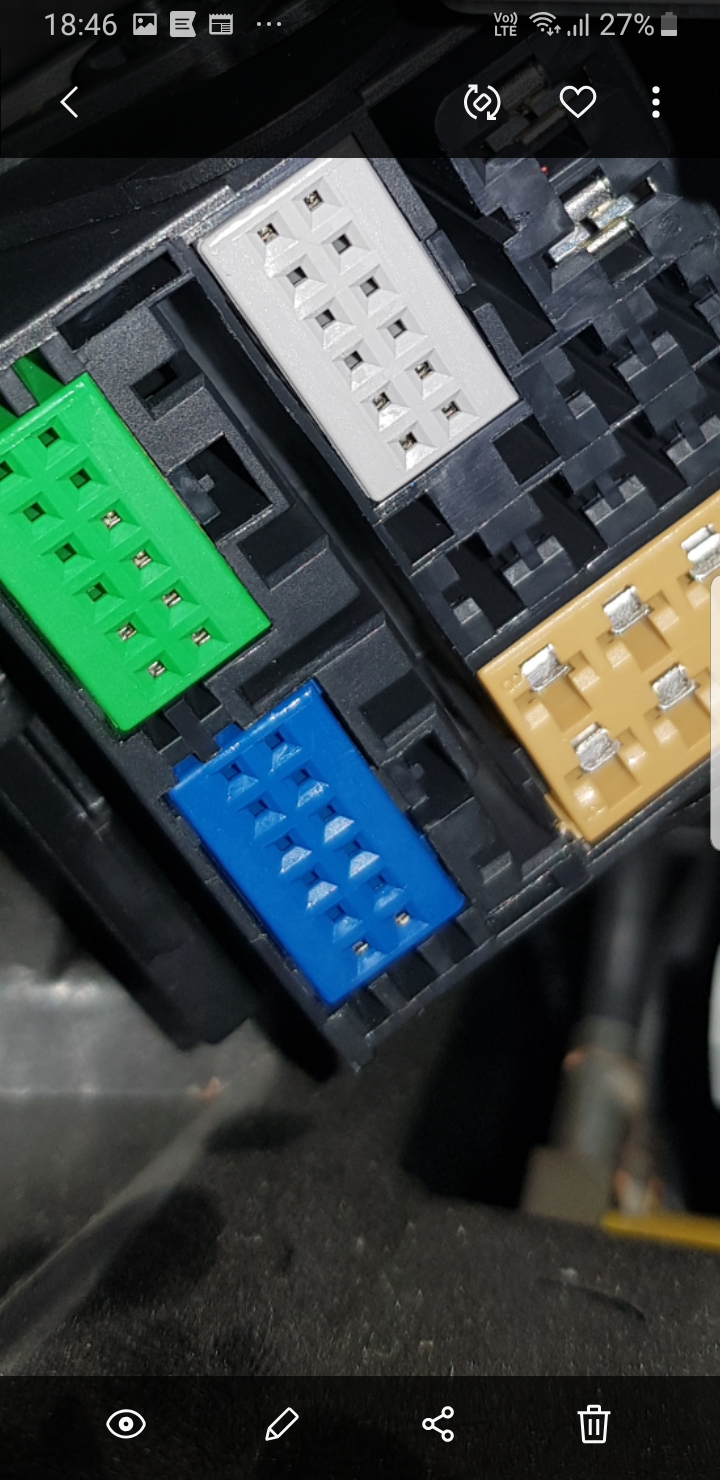

It's all comes to coding with vcds or obdeleven the F5 module to enable rvc. After that, hard reset the head unit by holding the power button. if the camera is not connected the park pilot will appear only once when going in reverse.
Next the camera needs to be connected to the this [layout provided] pins in the blue module, I have improvised pins from a computer fan connector and jammed them into the blue model,
but it can be bought from ali Express
https://a.aliexpress.com/_uJddyd
Additionally I have bought a camera mount for license plate light
https://a.aliexpress.com/_vnQn33
after that I have ran the wiring, the camera can be constantly on or powered from reverse light.
hope it helps some people, because I thought that an rgb converter is a must, and it's not, it's only for adding the guide lines from the can bus.
