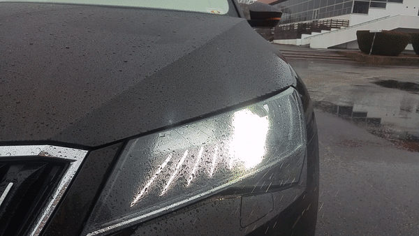

  • New mod:     (9) Central Electronics -> Security Access -> 31347   Left: Adaptation -> Channel: (4) Leuchte16BLK SLB35BLK SL KC9 Lichtfunktion A16: Set = Bli

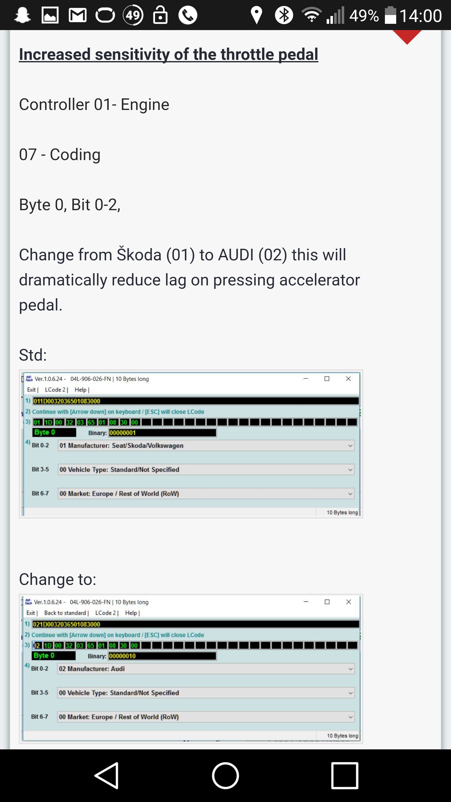

Next thing I did was changing throttle response from Skoda to Audi. Again pretty straightforward and no drama.

Did you notice any improvement with the AUDI throttle response mod? Will try this coming weekend when i recieve dongle from obdeleven.
Yes, major difference.
The car/DSG finally acts like a normal car... ;-)

Excellent!, did you use the explanation by Shahoff?: https://www.briskoda.net/forums/topic/380829-superb-mkiii-vcds-adaptations-tried-and-tested/?do=findComment&comment=4611928

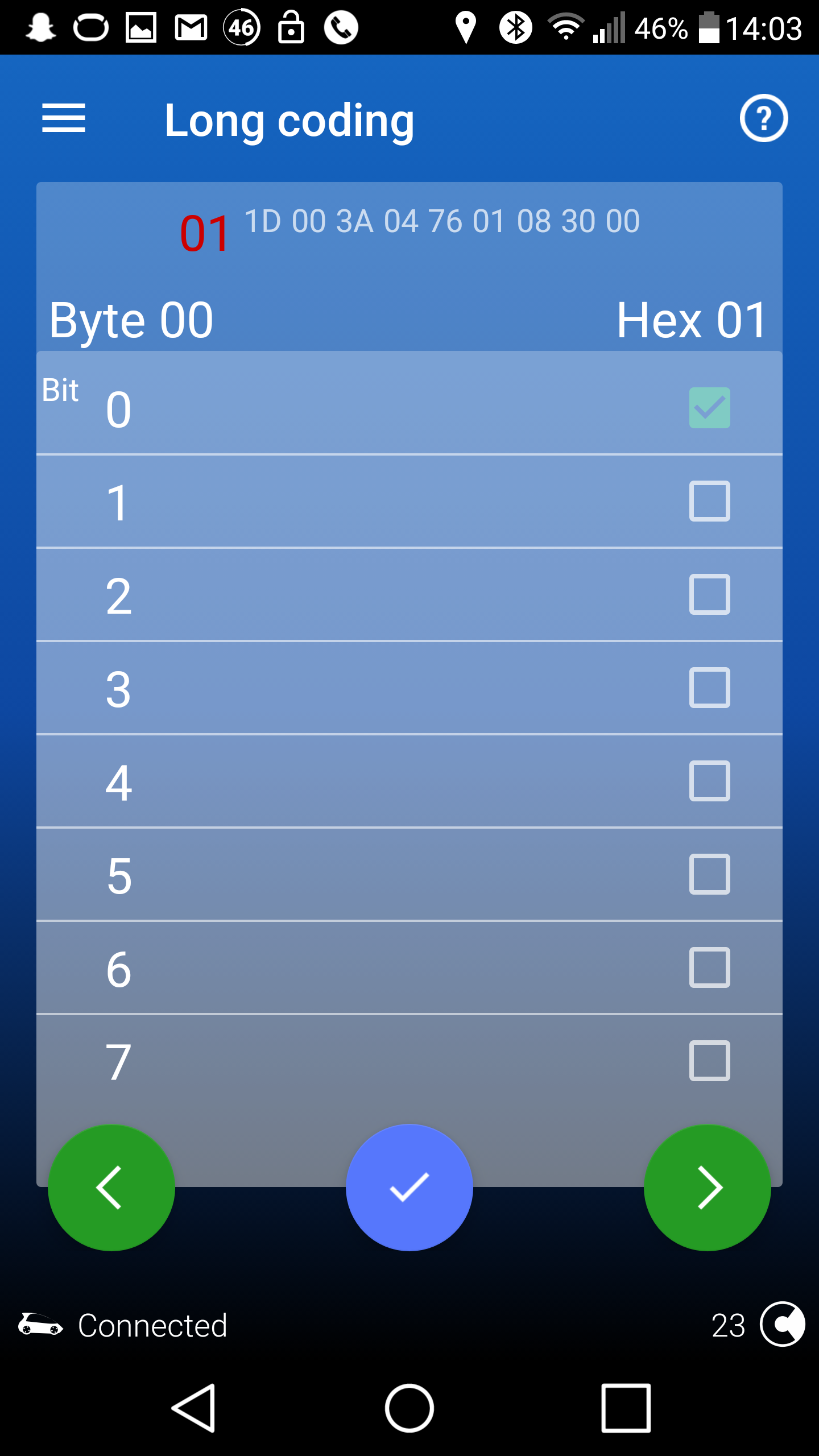

Yes please, any assistance on how to do this along with screen shots. It's the last mod I wish to do with OBDeleven however following the instructions from tried and tested page I was unsuccessful. Any help greatly appreciated. Note I have a 2017 model so I hope it's the same as yours.

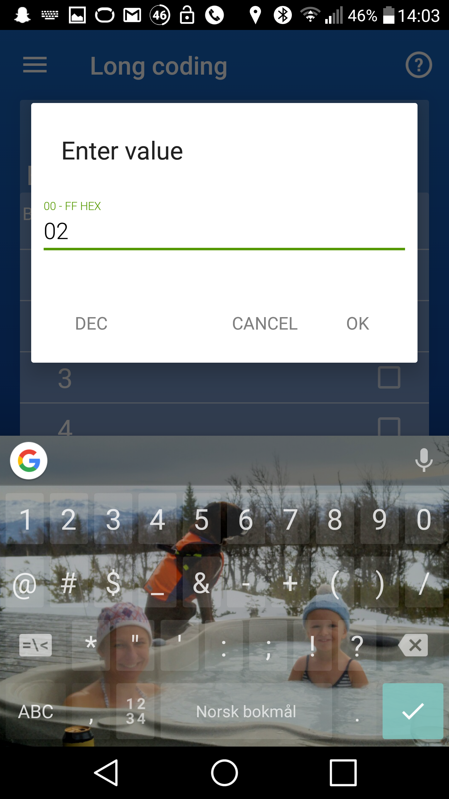

I think these are my screenshots from when I did this, the first one is the VCDS instructions, the two others are from when I actually did it in obdeleven:
Remember that you can just click on where it says Hex 01 in the top right, and edit the value like I did here:
Once again, thank you ever so much for your great descriptions and even better screen shots. I'm new at this game and appreciate the kindness. I've made a few mods with apps and managed to activate TMC with coding but struggled with the AUDI throttle response and Scandinavian DRLS (rear) but have new hope now. :)

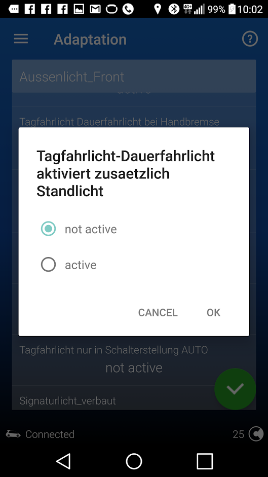

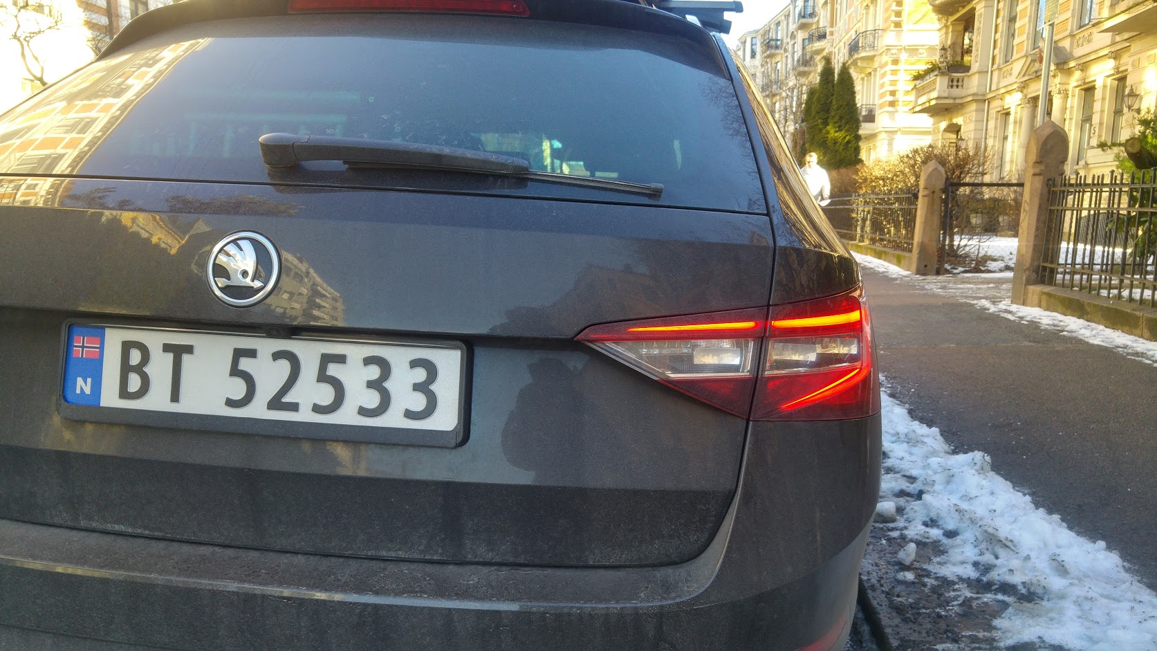

New mod:
Left:
Lichtfunktion A16: Set = Blinken links Dunkelphase
Right:
Adaptation -> Channel: (4) Leuchte17TFL R BLK SRB3TFL R BLK SR KC3
Lichtfunktion A17: Set = Blinken rechts Dunkelphase
Edited by grenness
replaced mp4 video file with animated gif

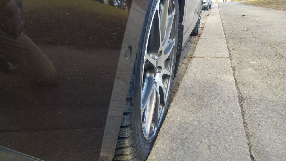

Adaptation
    Control unit: 76 Parking Assistance
    Name: Distance to curb
    Values:
            Old value: 15 cm
            New value: 5 cm
    Mileage: 7598 km

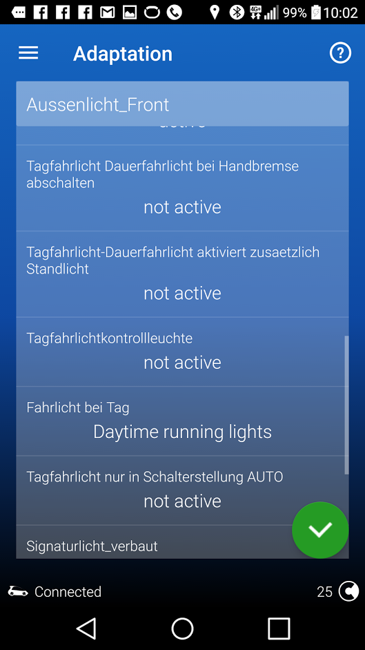

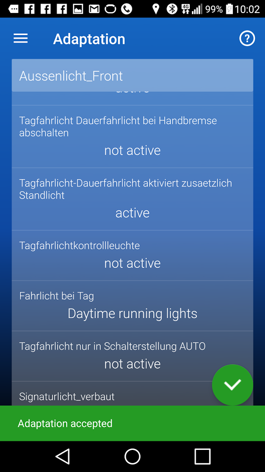

Adaptation
    Control unit: 09 Central Electrics
    Values:
        Tagfahrlicht-Dauerfahrlicht aktiviert zusaetzlich Standlicht:
            Old value: not active
            New value: active
    Mileage: 6565 km
    Date: 2017-03-10 10:02

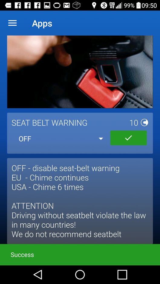

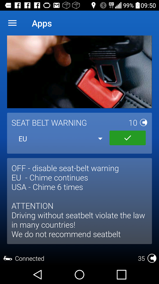

App
    Name: Seat belt warning
    Old value: EU
    New value: OFF
    Mileage: 6565 km
    Date: 2017-03-10 09:50

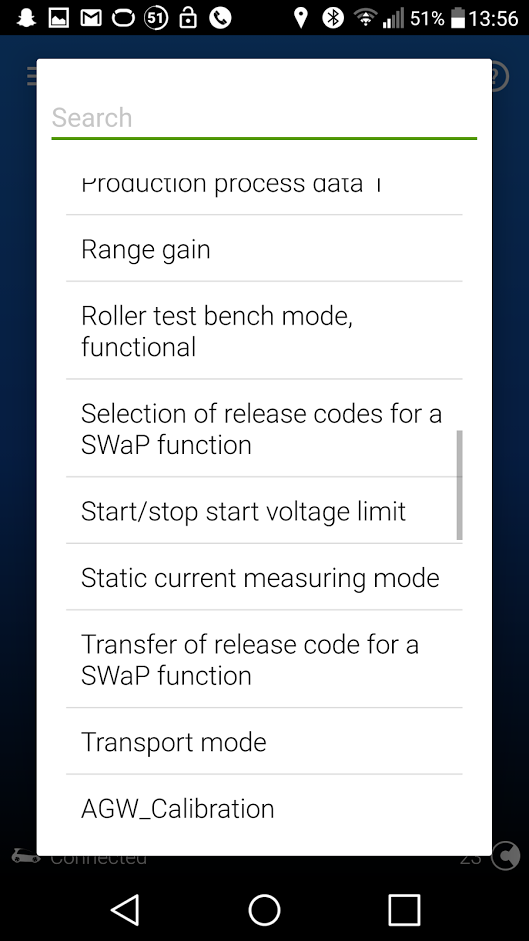

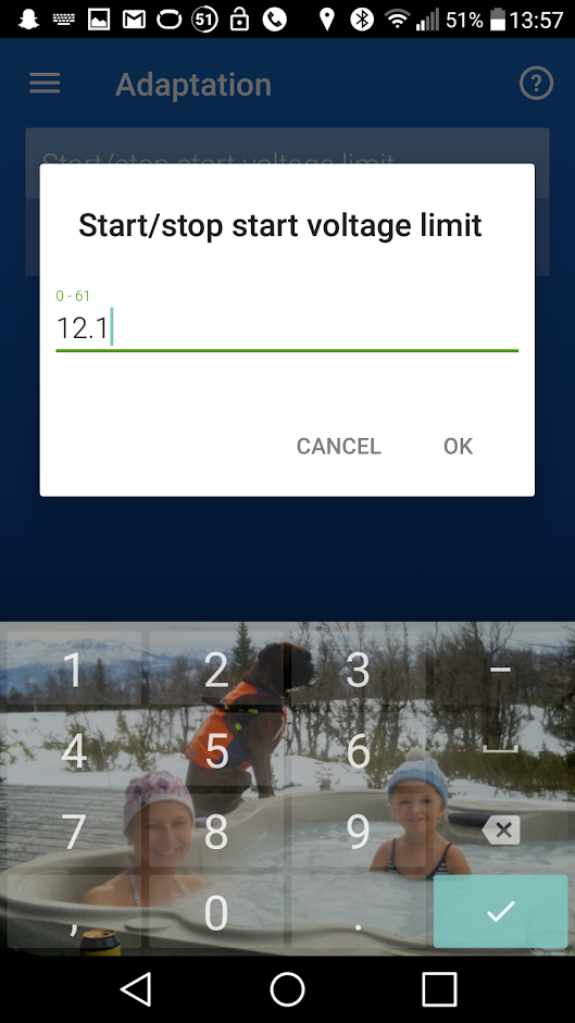

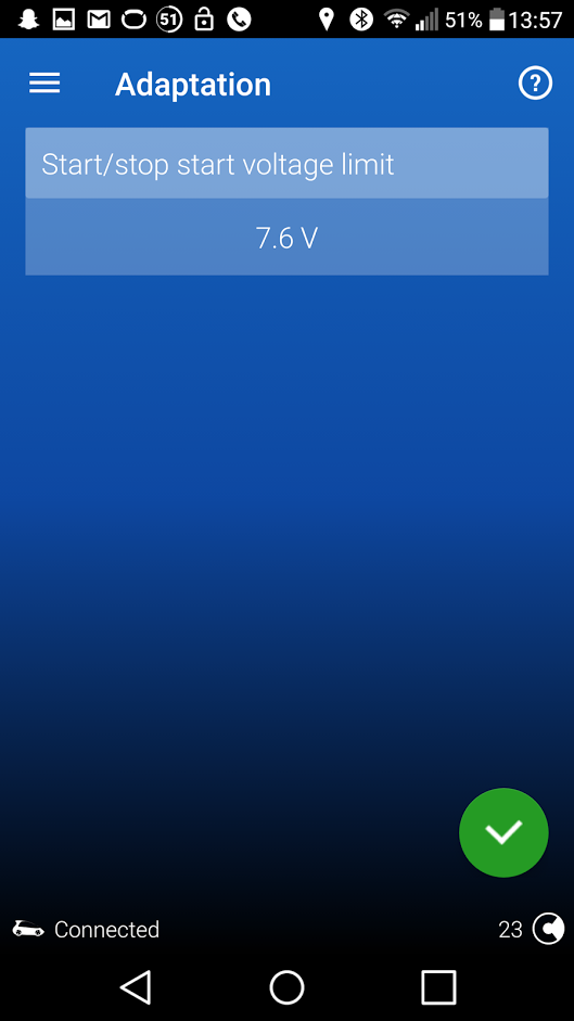

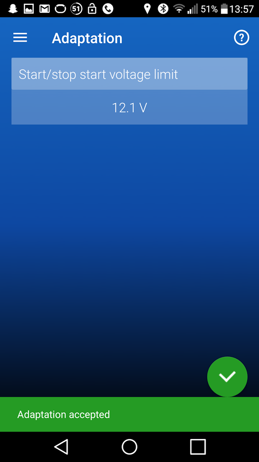

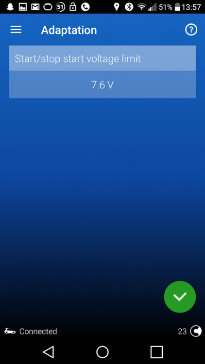

Adaptation
    Control unit: 19 Gateway
    Name: Start/stop start voltage limit
    Values:
            Old value: 7.6 V
            New value: 12.1 V
    Mileage: 6557 km
    Date: 2017-03-09 13:57
