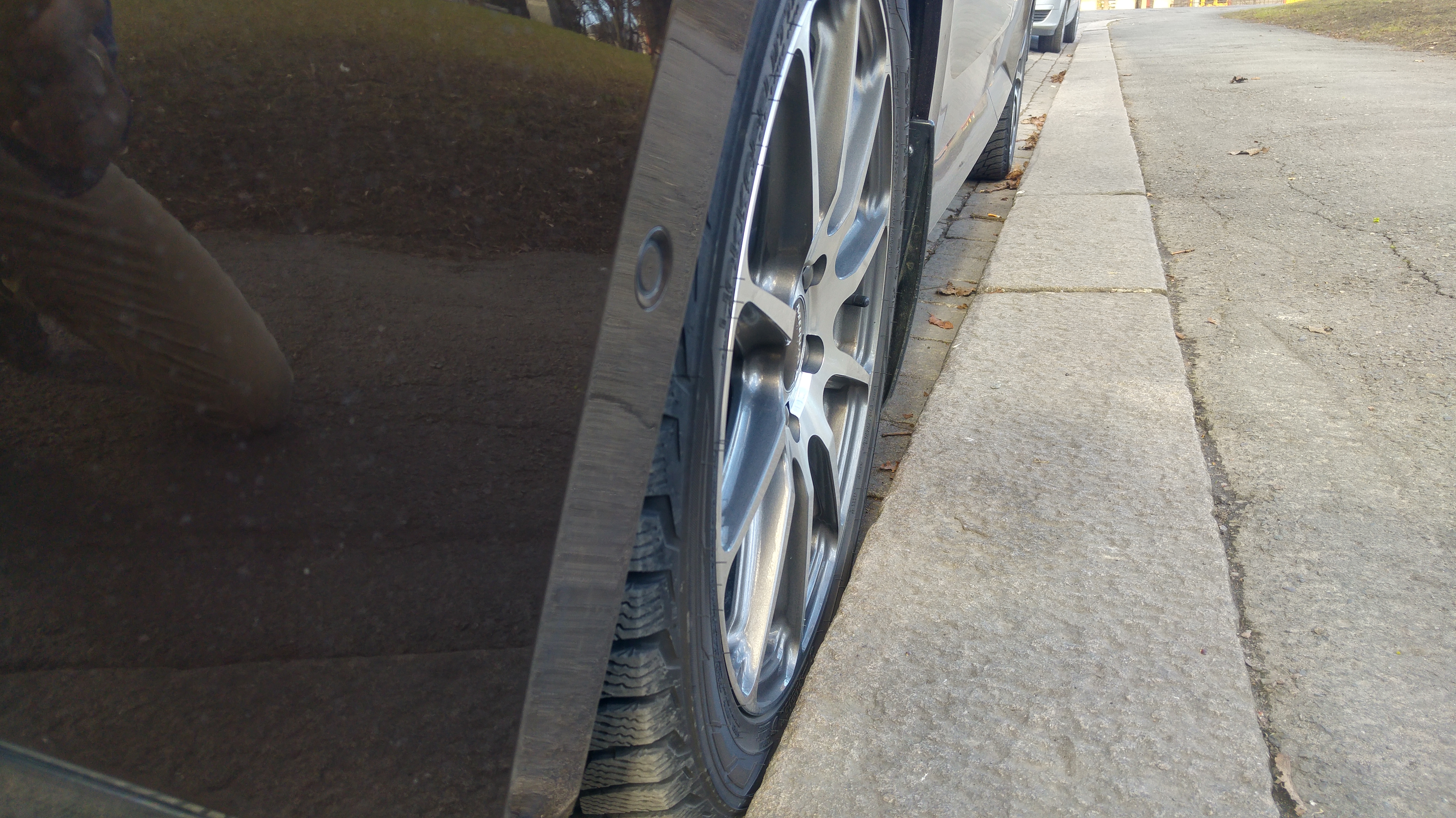

On 4/6/2017 at 13:54, grenness said:
Adaptation
    Control unit: 76 Parking Assistance
    Name: Distance to curb
    Values:
            Old value: 15 cm
            New value: 5 cm
    Mileage: 7598 km
    Date: 2017-04-05 21:56
I think I'm going to revert this back to its original setting... ;-)
Used the parking assistance today for the first time since the modification, almost touched the sidewalk with the rims:
Thats a bit too close for comfort!
9 hours ago, grenness said:
I think I would be tweaking that to about 74.9mm;)
Edited by Bud
:-D
I set it to 20cm now.
