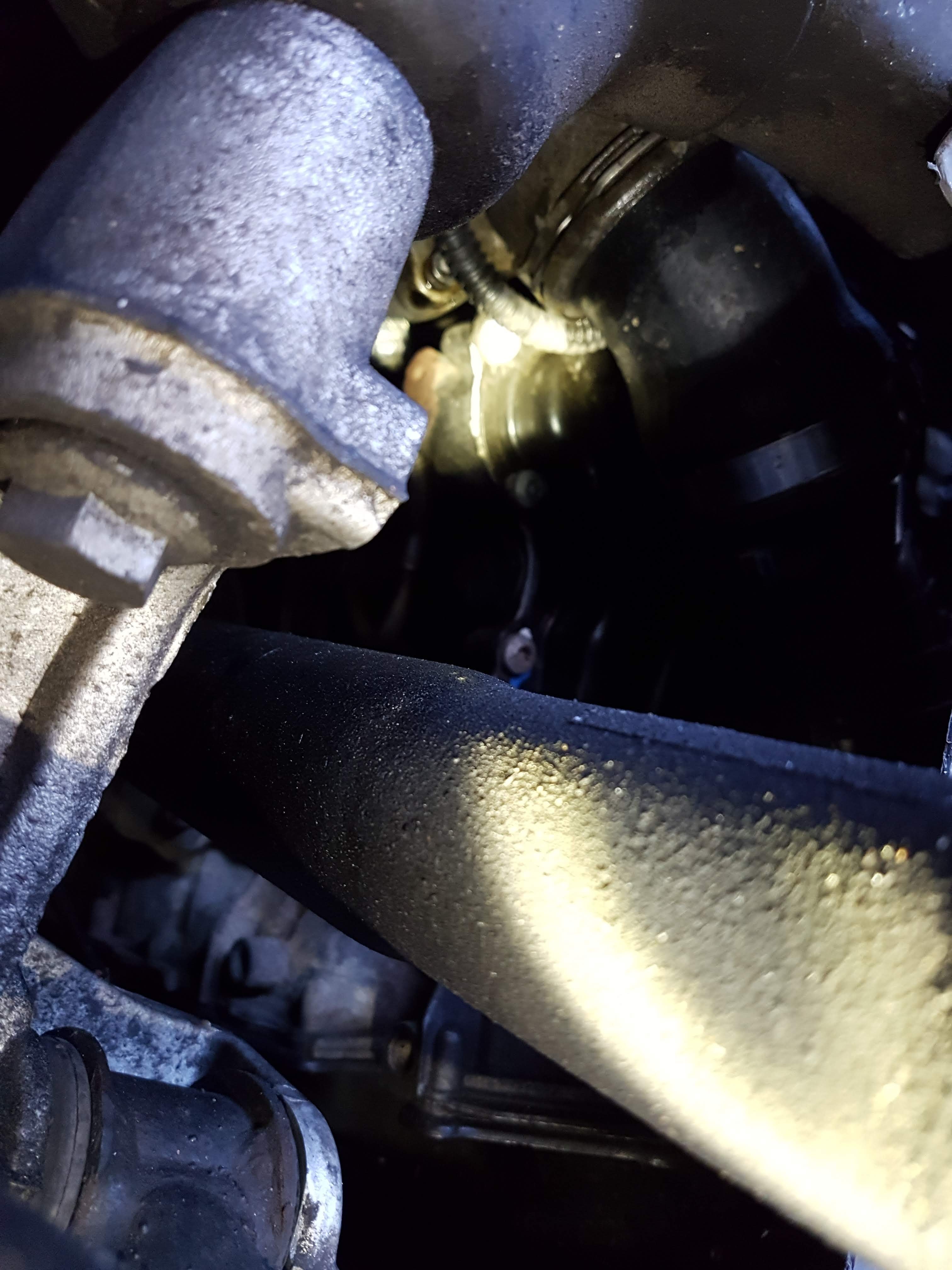

On 19/07/2017 at 12:09, TheClient said:
I still have drops of oil collecting around diverter valve assembly, on the metal connection spigot to intercooler pipework, some on the heat shielding of the oil supply pipe.
It is enough to continue to drop onto the driveshaft and spray over the suspension arms.

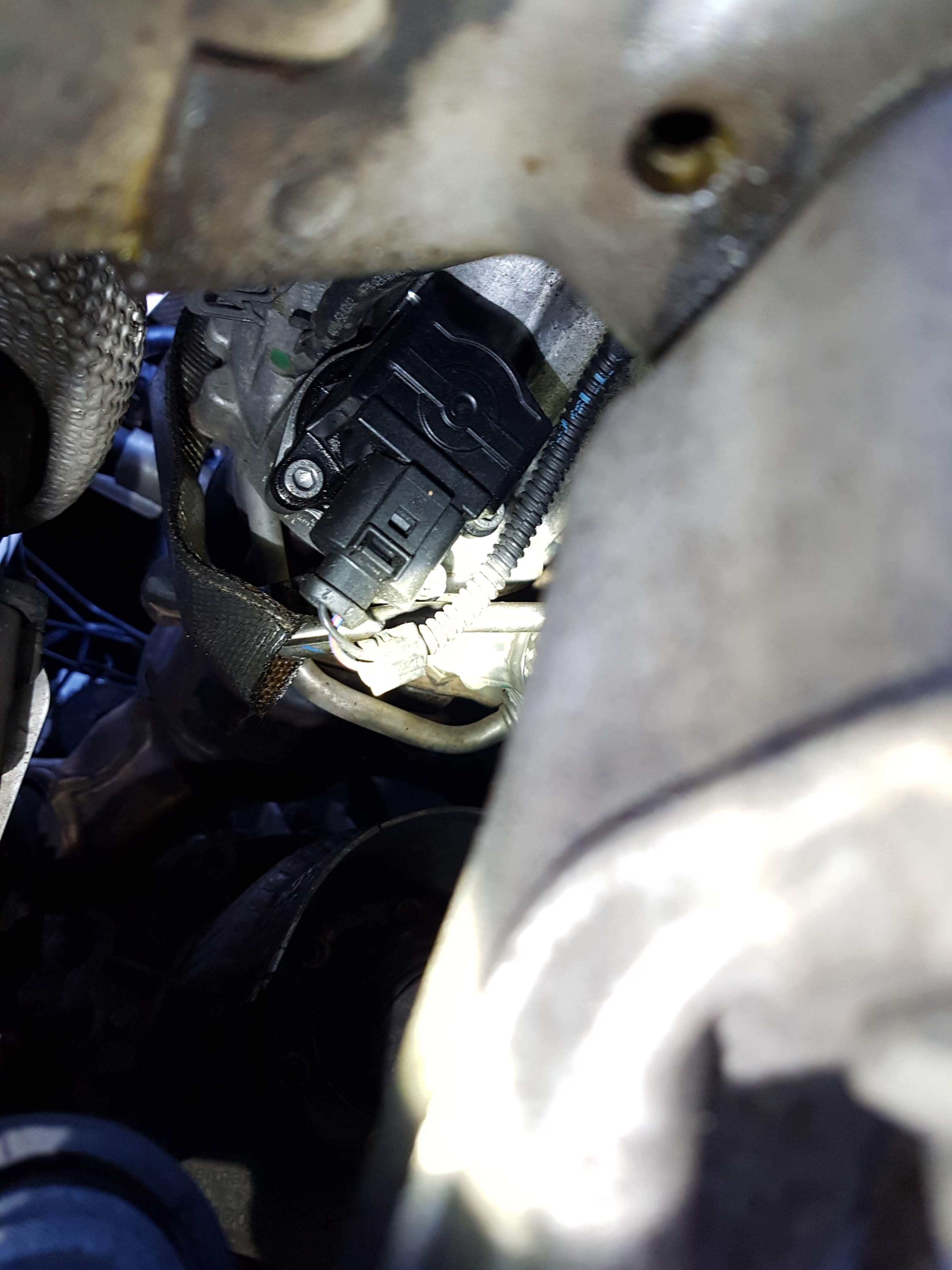

On 21/07/2017 at 17:50, TheClient said:
Checked top banjo fitting for oil feed to turbo with an inspection mirror (saved having to remove intake pipework and heat shield).
It looks fine there is definitely no oil quantity or wetting of oil around that fitting.
Also, looked again at both ends of the oil return of the Turbo and the block connection side of the oil feed. No problems.
There was no split evident in the oil return pipe or the oil feed pipe that was visible.
The only bit you can't see is the last section of the oil feed pipe as it has a unsulation cover slip fitting over it.
But I doubt that would be it as it would all be concentrating at the end of the pipe where the insulation ends and dripping noticeably from there after travelling down.

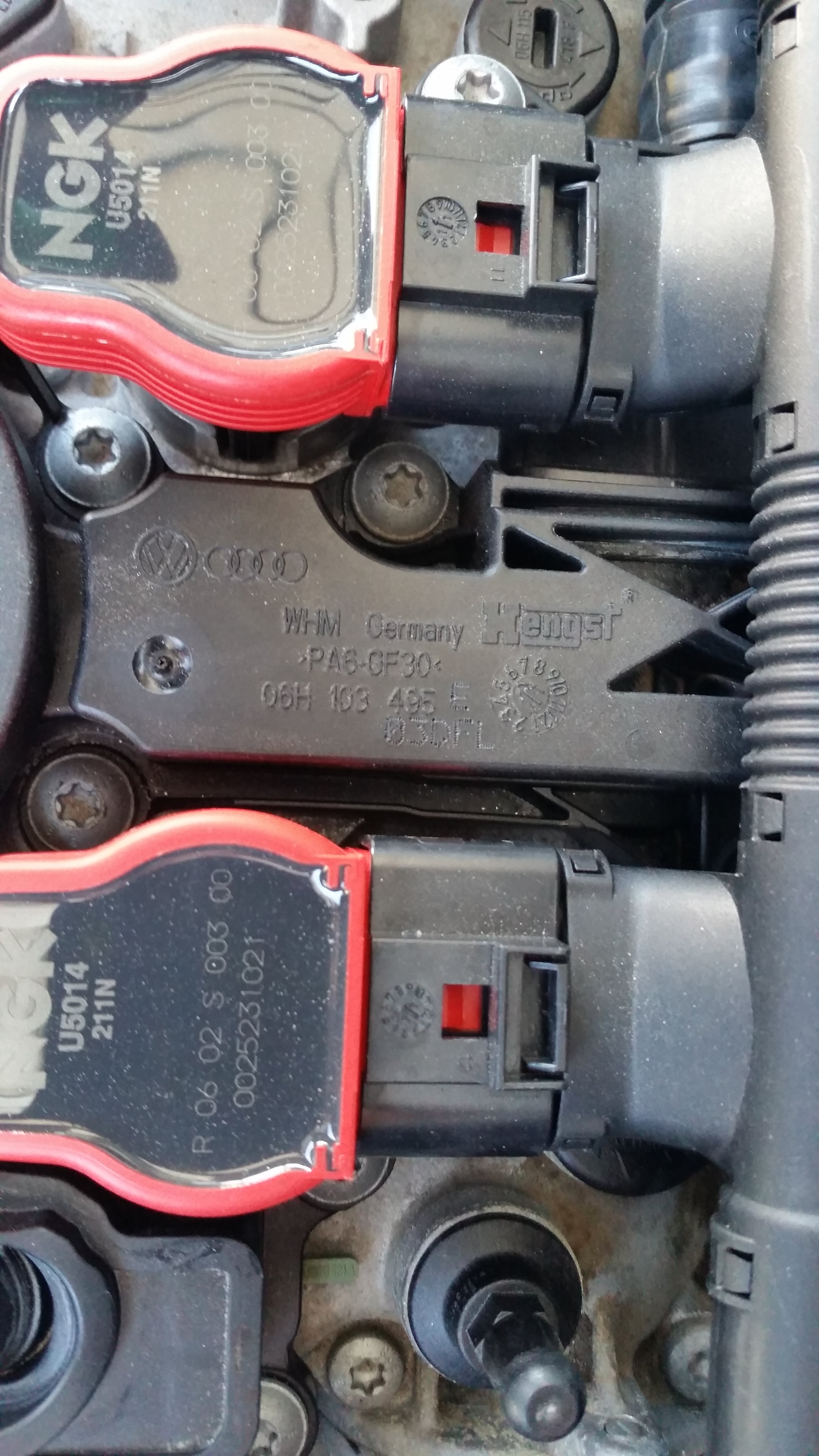

I have the all BLACK PCV version # 06H 103 495 E
Should I replace it with a BLACK or WHITE PCV ?
What part # should i replace it with ?

If E is installed that would mean 06H103495E > 06H103495AC > 06H103495AH with AH being the latest part number (as at March 2017) when the linked thread was written.
But, that does not seem to align with your car engine mfr being 11 Sep 2011, as from 14 June 2010 I would expect the following part journey:
H=> AD =>AJ (most current as at March 2017 original thread detail) .
I've never seen a white coloured PCV on a CCZA engine?
