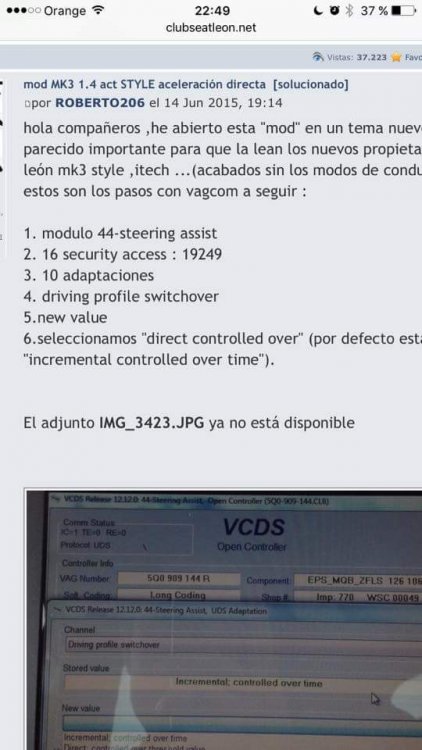

I take 0 credit for this one - just making sure it gets the attention it deserves, since it might be lost on this thread
This mod under, from my brief tests, is the equivalent of enabling the sport button for those who do NOT have a sport button.
At least on my car (which does not have a sport button) it made the steering sharper and a bit heavier (which I like, because it is more precise) and made the throttle response much sharper, almost like the car had been tuned - there is a clear difference in acceleration, with the power being available much earlier on.
I strongly recommend trying this - just post your comments and results under ;)

The complete coding looks like this:
44 module (steering assist)
Security access: 19249
Adaptations
Select channel: 'Driving profile switchover'
Change from 'Incremental: controlled over time' to 'Direct: controlled over threshold value'
Edited by aki78
