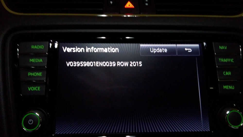

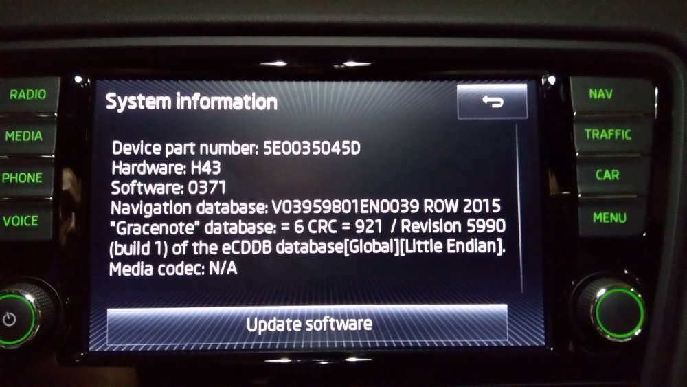

Is there a direct link to ROW ???
Hi, Hi, I bought an Octavia, 2015 from France. I try to update navigation maps to include Israel but when I enter VIN number I have only one choice which is maps of Europe. Can anybody help me to get map of Israel or ROW added to my navigation data?
